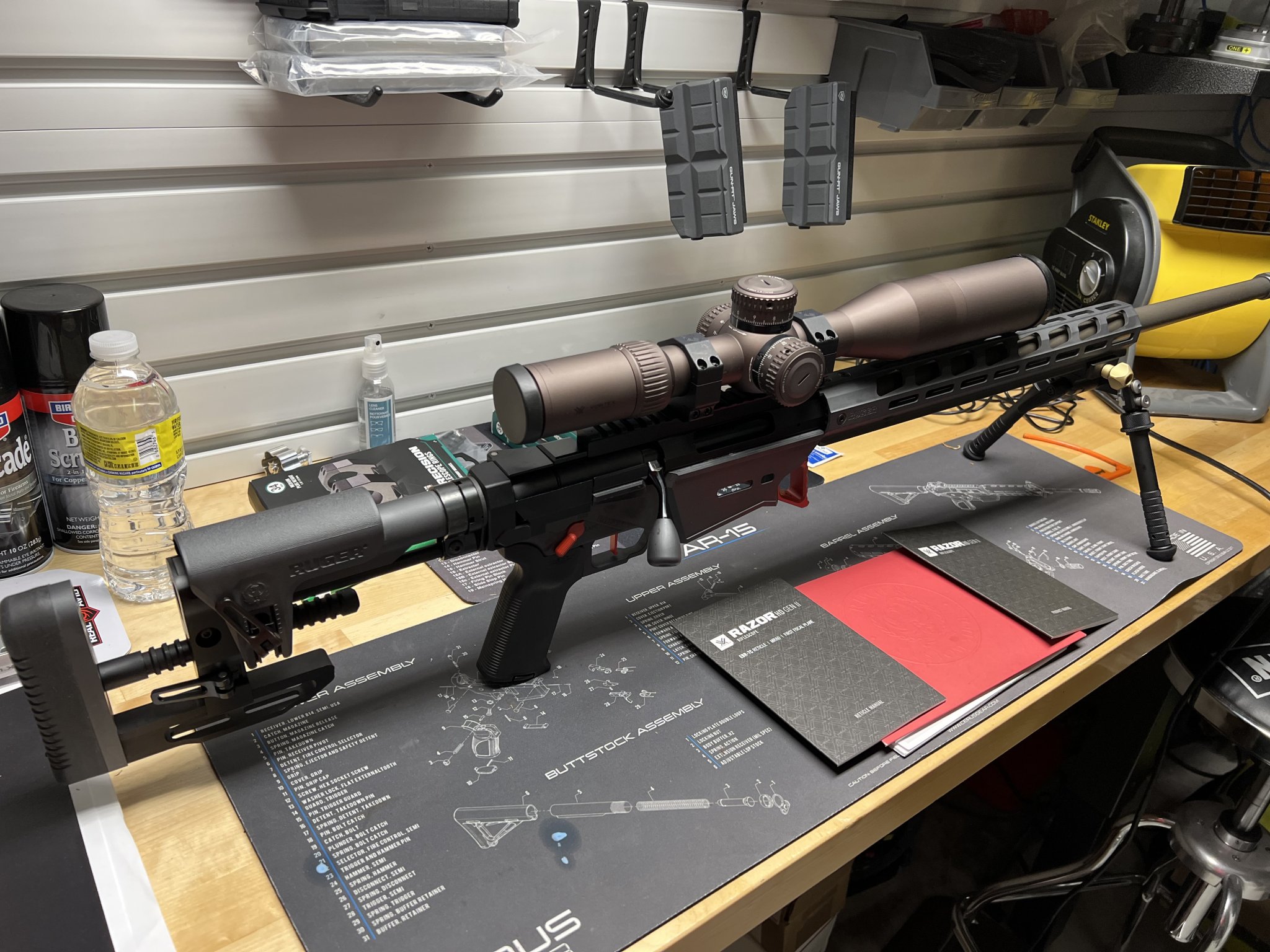

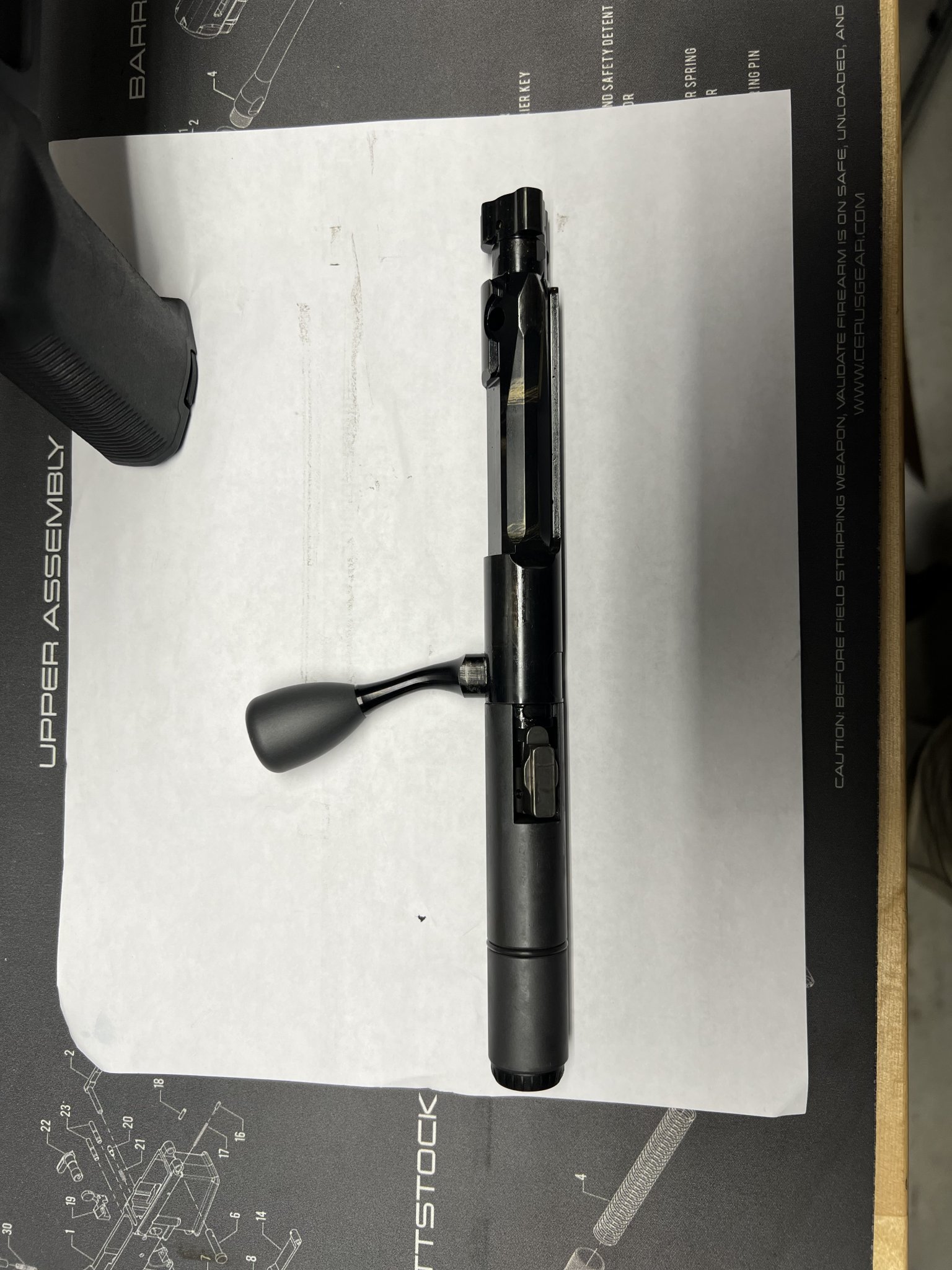

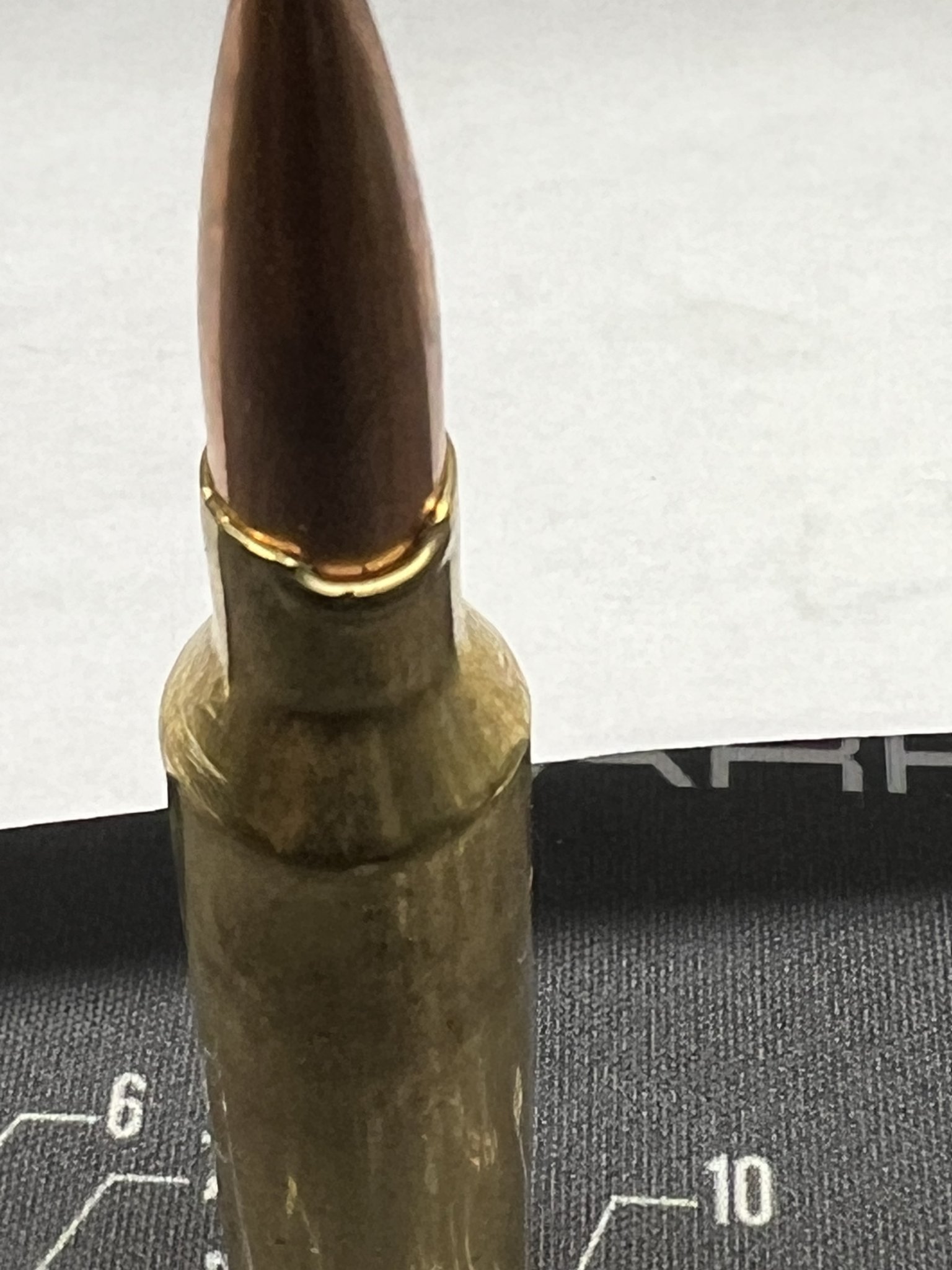

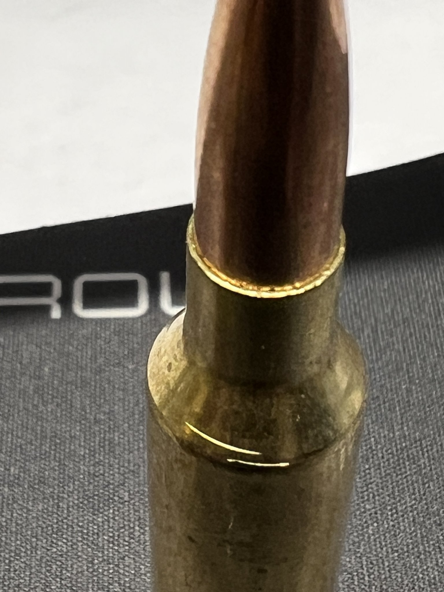

Took it out for first shots and had a really hard time feeding 20% would not feed correctly and would jam not using cheap ammo
When I did get the rounds to feed got many groups .5 inch at 100 yds

That's odd, because the dent looks like it's folded inside. Dents caused by a chamber usually end up with wrinkle lines on them.
It takes a lot of effort to bend a case neck like that while chambering.
Maybe it's just how the picture shows it...

Ejector plunger? That sort of makes sense, keeping the round from centering into the chamber. Waiting to hear.
