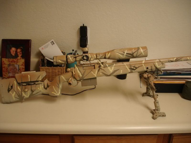

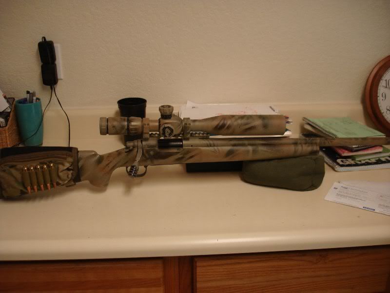

I have IOR low rings rings (steel) on top of a Ken Ferrel 20 MOA base. It sits pretty low. My other one is in GG&G Highs on a seekins 20 MOA base and its pretty high.
IOR w/ Ken Farrel
GG&G w/ Seekins
