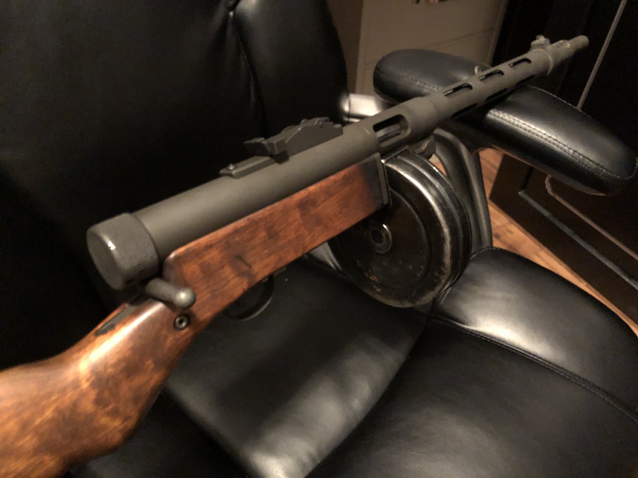

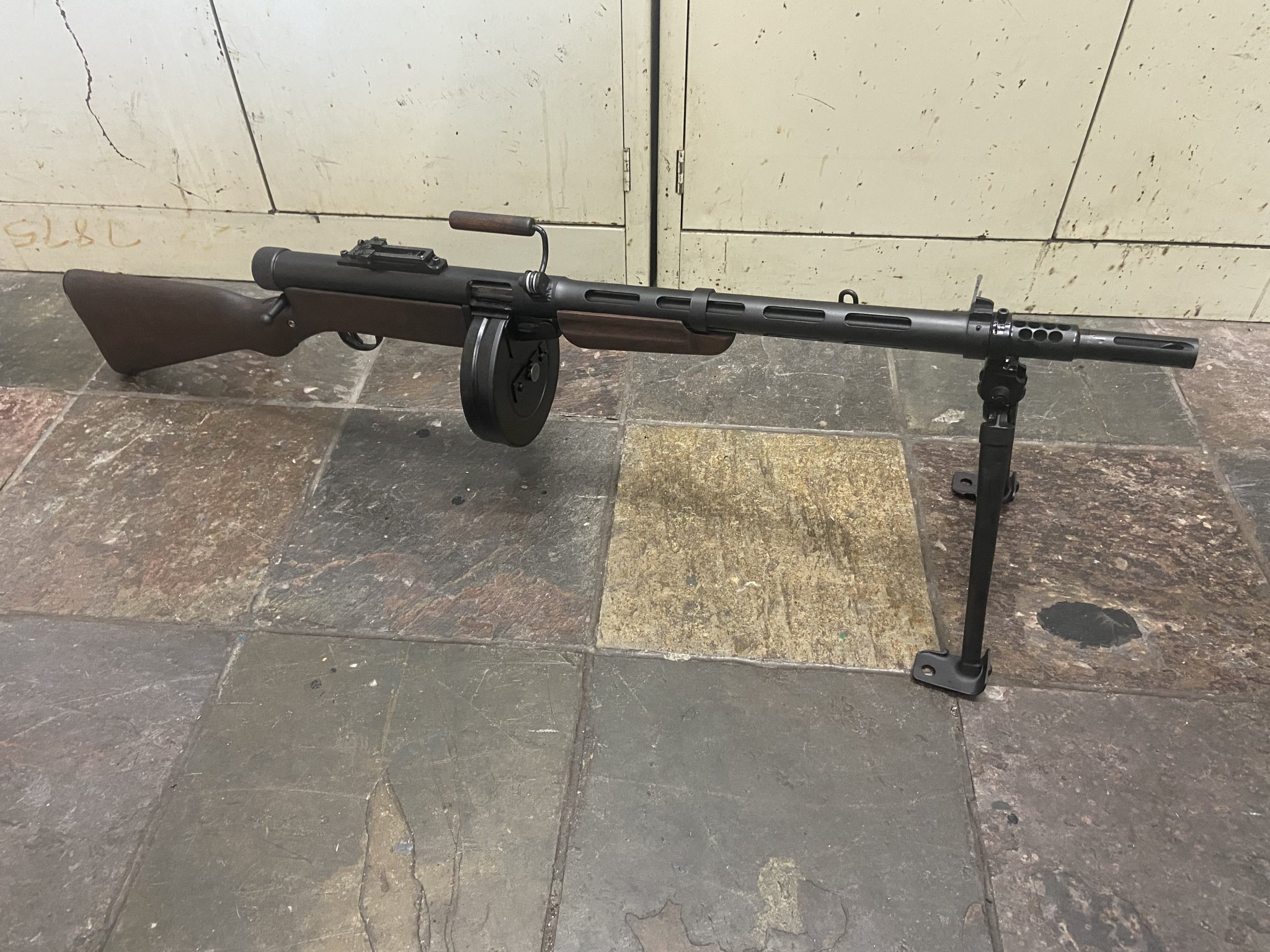

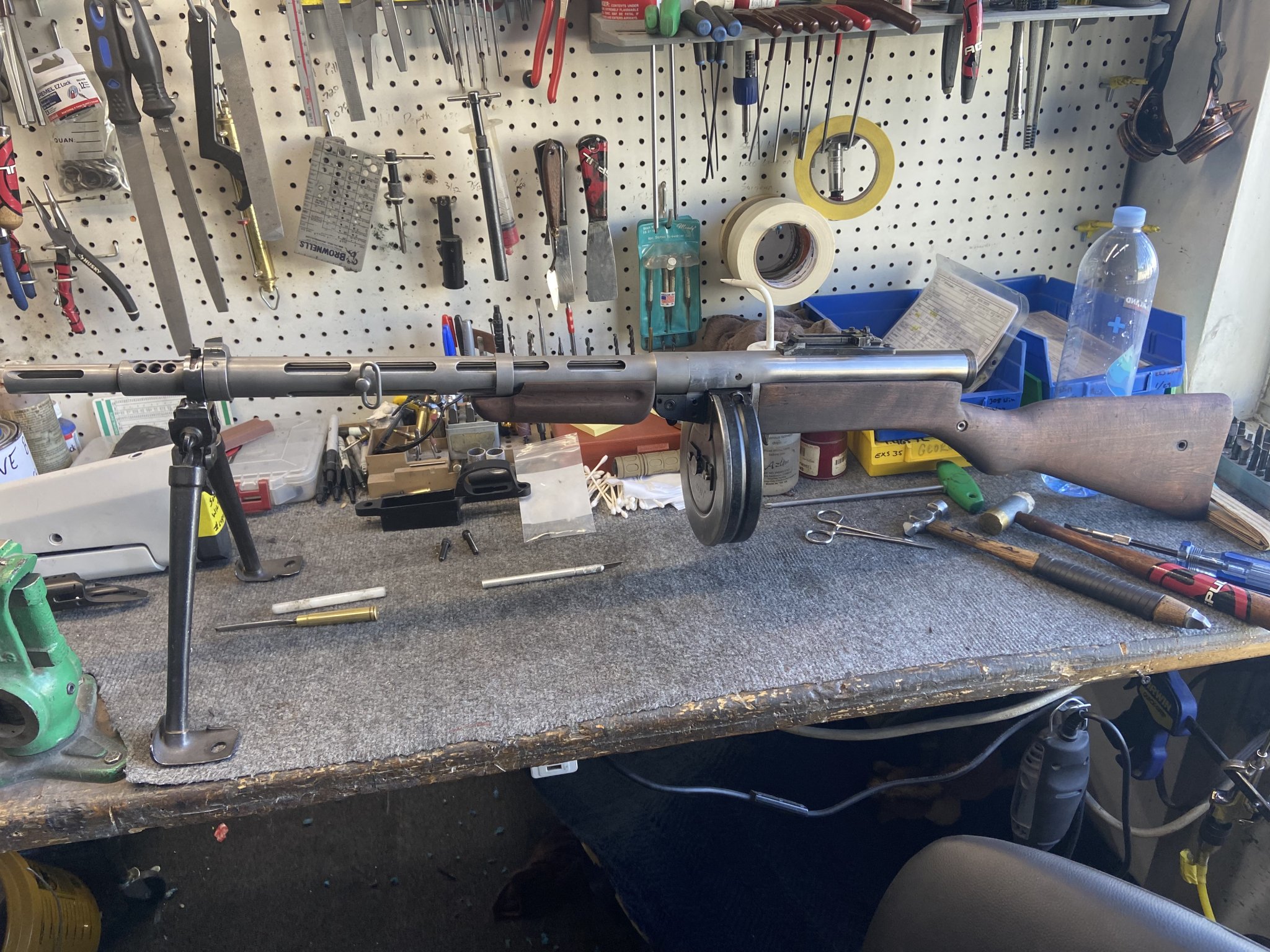

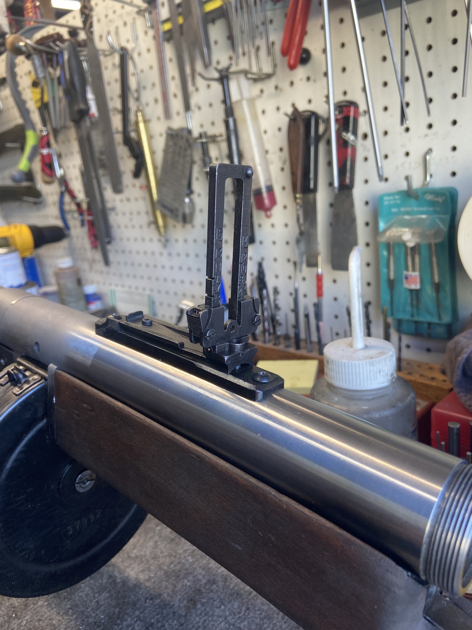

Doin a Suomi kit and figured why not do a light machine gun type of thing that never really existed but could have. Spliced two shrouds together to elongate for the longer barrel, then added a forend, why not a brake to look a little closer to the lmg’s of the ww2 era, of course needs a bipod so modified a Bren bipod. Rear sights on suomi’s sucked so modified an Arisaka rear so it has a stand up adjustable sight.
Not done yet got some small things to finish up and polish out and refinish, just a fun wierdo build that could’ve been
Looks great. Thanks for sharing
Rewelding the pieces from these kits would be a real asspain, I made a whole new reciever tube and saved the front “trunion” section off the kit. Will try and get some better pictures up later
As a fellow Finnish heavy metal fan, I do enjoy the original pattern. But OP's version looks kinda cool, reminds me a little of the Danish Madsen.

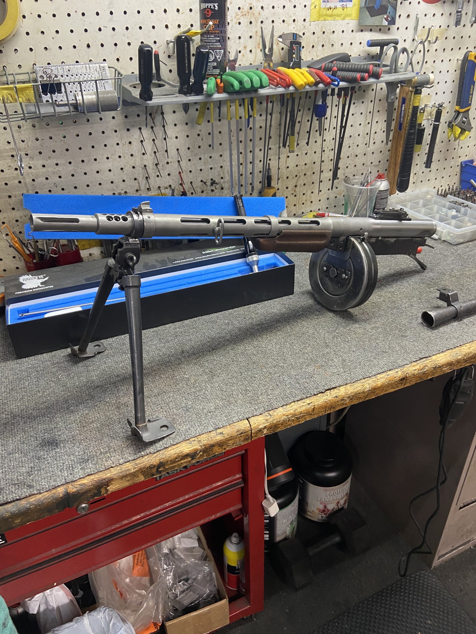

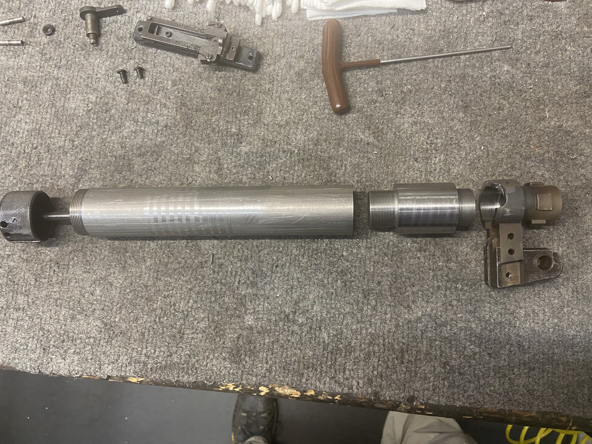

Here’s a visual of how I built a new tube, saving the “trunion”. The center section is bored the dia of the front half of the bolt, the rear of that piece is what sets the headspace. After they are all three screwed together it is welded. Then machine the mag well and ejection port
