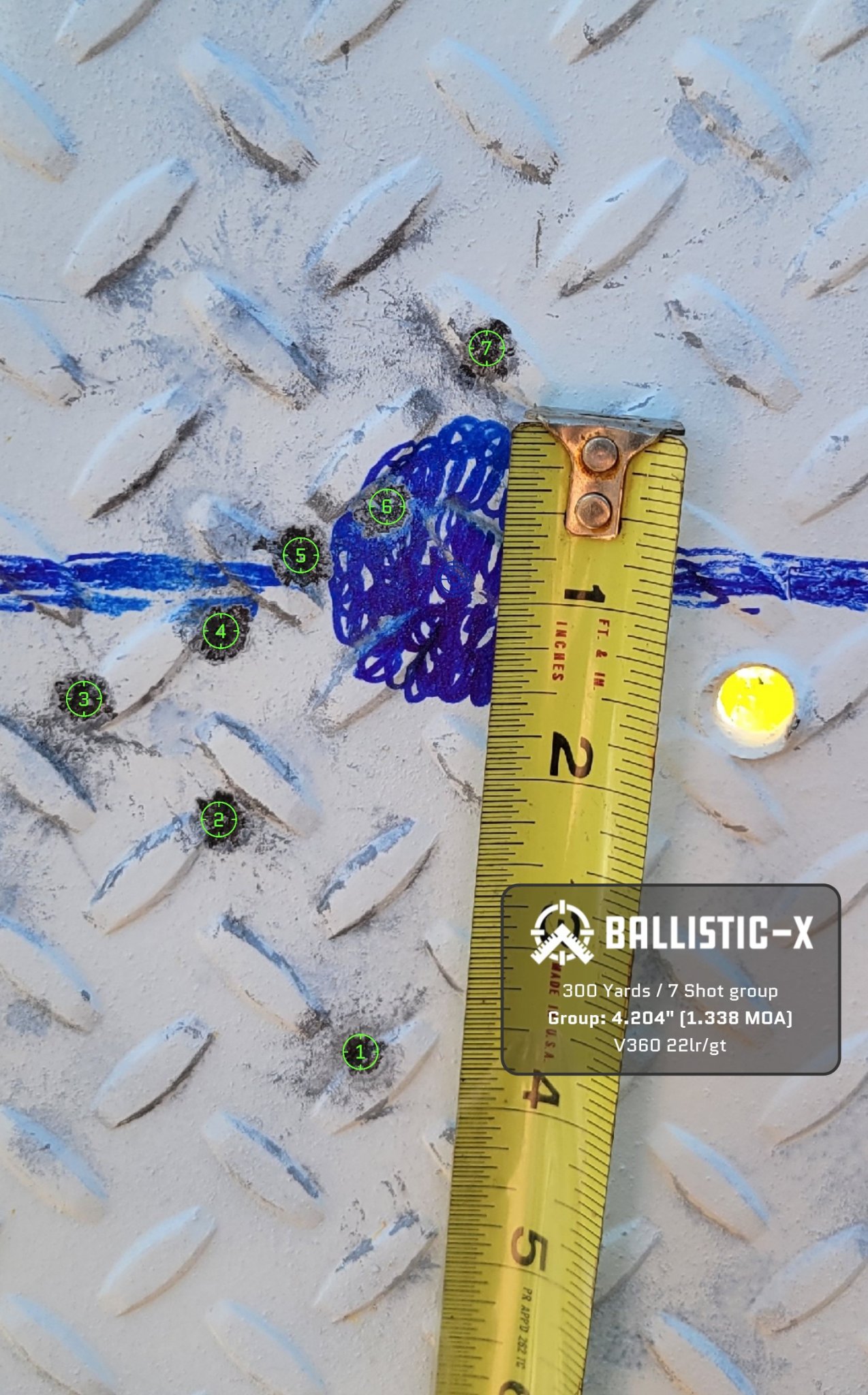

I personally have a 1:12gt and making groups like this.
What do you think is optimal gain for 22lr?
I too like the concept of gain twist, but wonder how it translates into subsonic lead bullets specifically? I guess it would be even more malleable and you could do even a larger transition???
On the group above, is that actual shot order- as during the string- or is that just the way the software notes them? I have a 3groove 1:16 on my 40X that for each string, starts out slow.
No no I have no idea which shot went where because I never recorded it. I just labeled it like so in the app

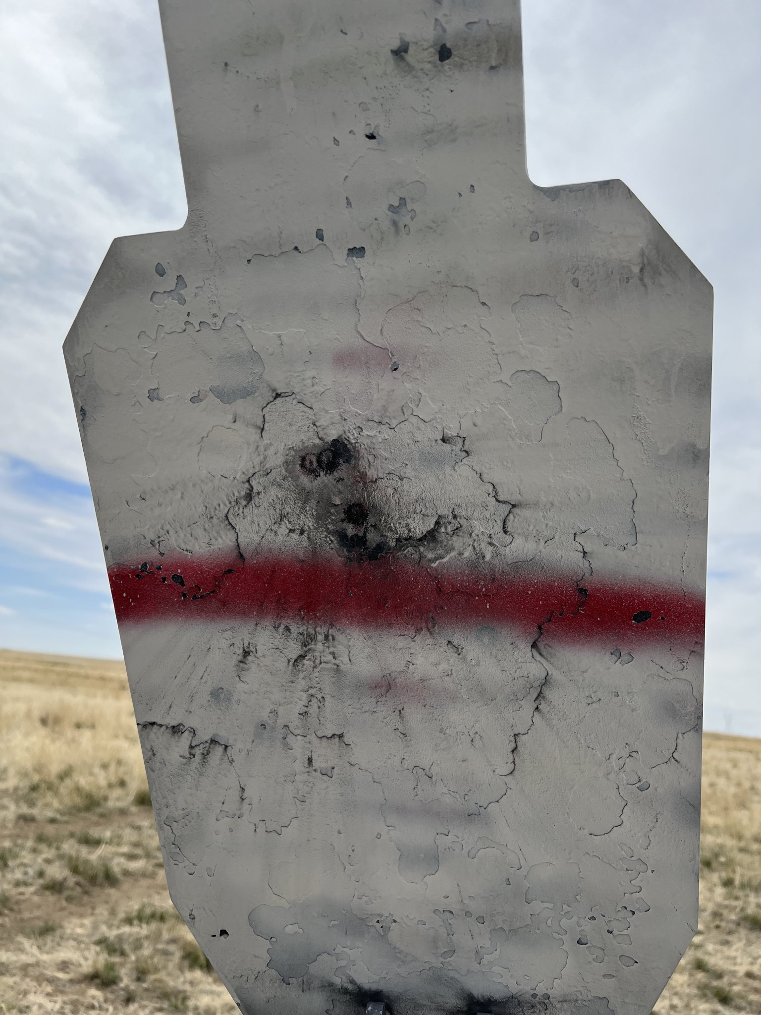

Meanwhile my A224V is doing this kind of accuracy
400 yards,
600
Why cause I went outside the box and use an LH GT Barrel Bartlein Barrel for the .22, centerfire.
Again you're applying centerfire thinking to a round that been around since the 1870s. You don't think every twist rate has been tried since its inception? Rimfire is at the mercy of the ammo manufacturers and solid haven't taken off yet or proven to be any better. Better mouse trap? When was the last time rimfire had a leap in its development action or ammo wise. The hottest barrels in rfbr are muller or shilen and they're all pulled button barrels. Is it monkey see monkey do? I don't know but that's what wins thats for damn sure.. gt may have a place in centerfire but as far a rimfire goes they won't be at the top of the winners list anytime soon.
we're not talking rimfire benchrest here
we're talking 50gr copper solids at 1300fps and 1,000y

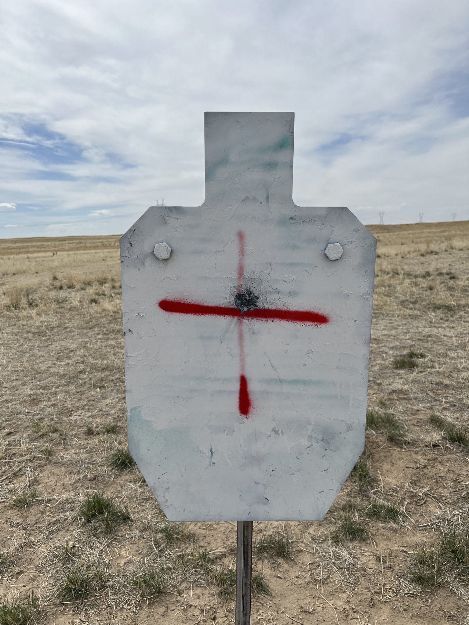

We’ll, got my CZ457/LiljaX9/ETS tuner rifle out today for the CRC LR-22LR match.
Got spanked. Didn’t have dope for past 118 yards, so the warm-up/sighting in was… spicy. 10-20winds from the back and or west didn’t help with the ambiguity when you are having to hold 4 mils at distance. I don’t have much paper on it, just steel. It seems to want to shoot one-hole-ish at 100. Even with the wind, I felt at 200 that I was in control- which I didn’t feel when I shot my 40Xconv/Benchmark barrel. At 400 yards, it still seems like there is a demon flicking bullets off path- but we only had 2 shots per string at that range, so not enough shots to settle it down- plus that much wind is going to add some variation. At 300 in these wind conditions, I felt I had control
And this is with just mounting the barrel tuner and not optimizing it. It did pretty well from the initial position and I haven’t had the right conditions to work it out.
I have my son’s gun which is in a LSS versus my ACC chassis from MDT, and he doesn’t have a tuner yet. Need to get that out with mine and my 40x/Benchmark to really see the differences.
