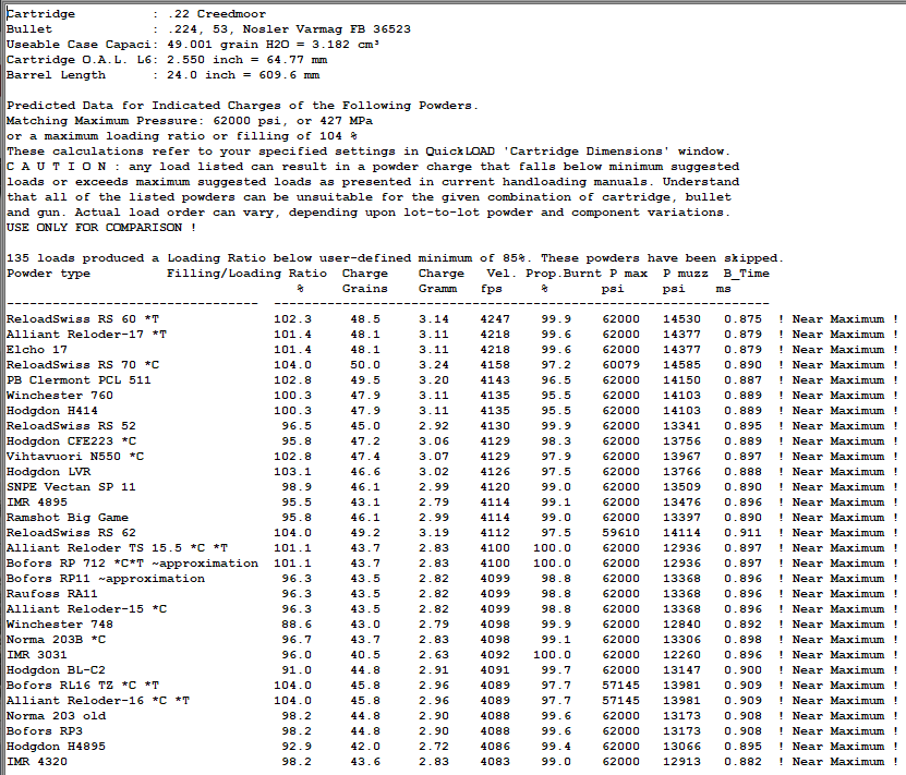

So one thing to consider is while uber fast sounds bad ass, if your engaging out to 500yds those super fast <40gr bullets will have lost alot of steam at said distance. something in the low 50's going ~4k will have more ass and still be eventful. You can play with velocity/bc's to see what I'm talking about.
One bullet I like to play with (not at nuclear speeds) is the 34gr dogtown (also sold as varmint nightmare and shots through other vendors. made by nosler)
I've played with the numbers and if it were me I'd push you towards the 53gr hornady or nosler varmegeddon (best BC for the weight class) for my varmint bullet then run ~9 twist which will get you in to the 75-80gr class of bullets without trouble on the big end. quickload is showing you can still get close to 4200 with the 53gr. Just remember the harder you lean on it and higher volume of shooting is going to play hell on your throat! lol

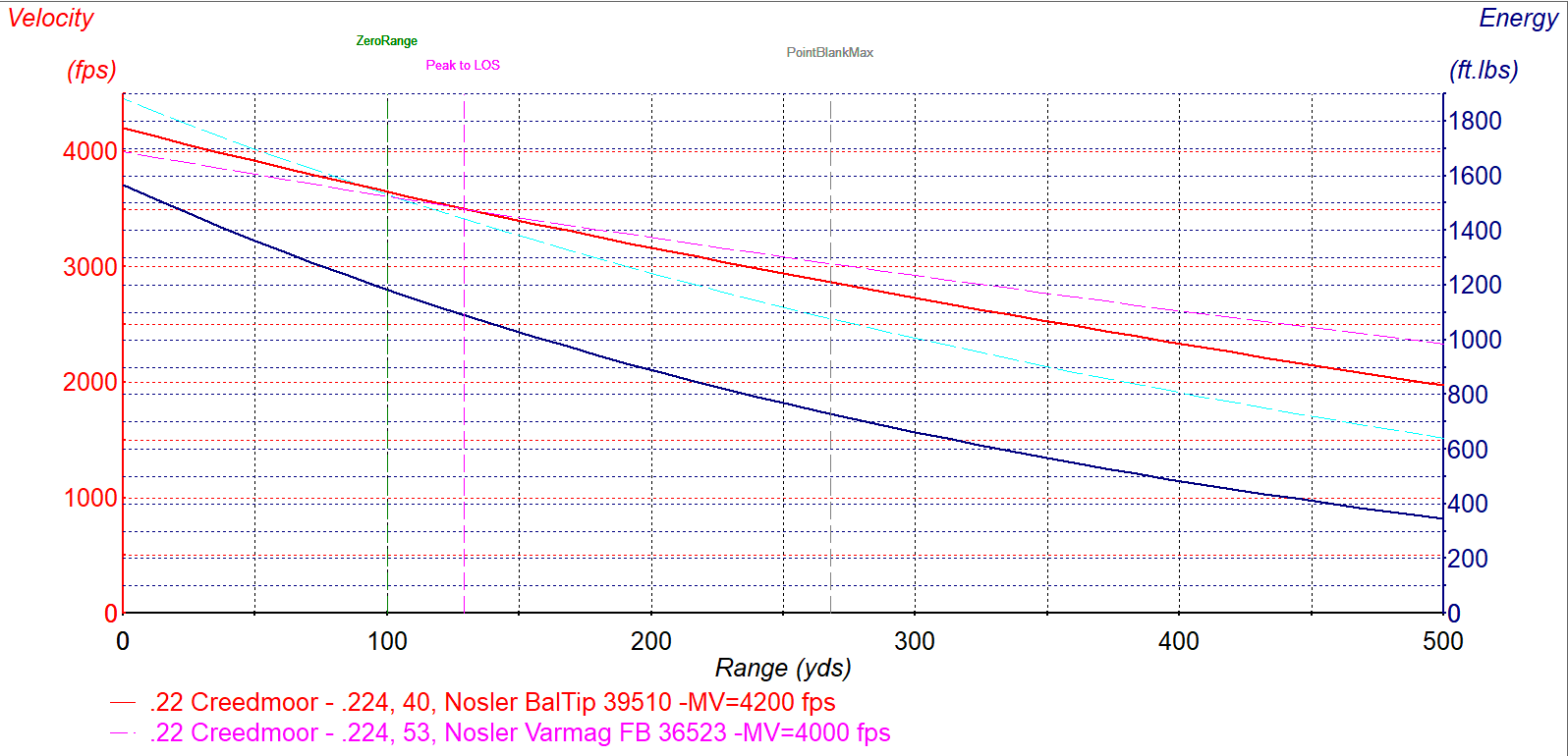

Another visual. Dark lines are velocity/energy for a 40gr @4200. Lighter are a 53@4k. Red is velocity, Blue is energy. The 53 has a 300 ft/lb lead everywehre! At about 120yds it's actually faster than the 40's already. by the 500yd mark it has nearly a 350 ft/sec lead and velocity=splattyness
Hope this helped muddy the waters lol
