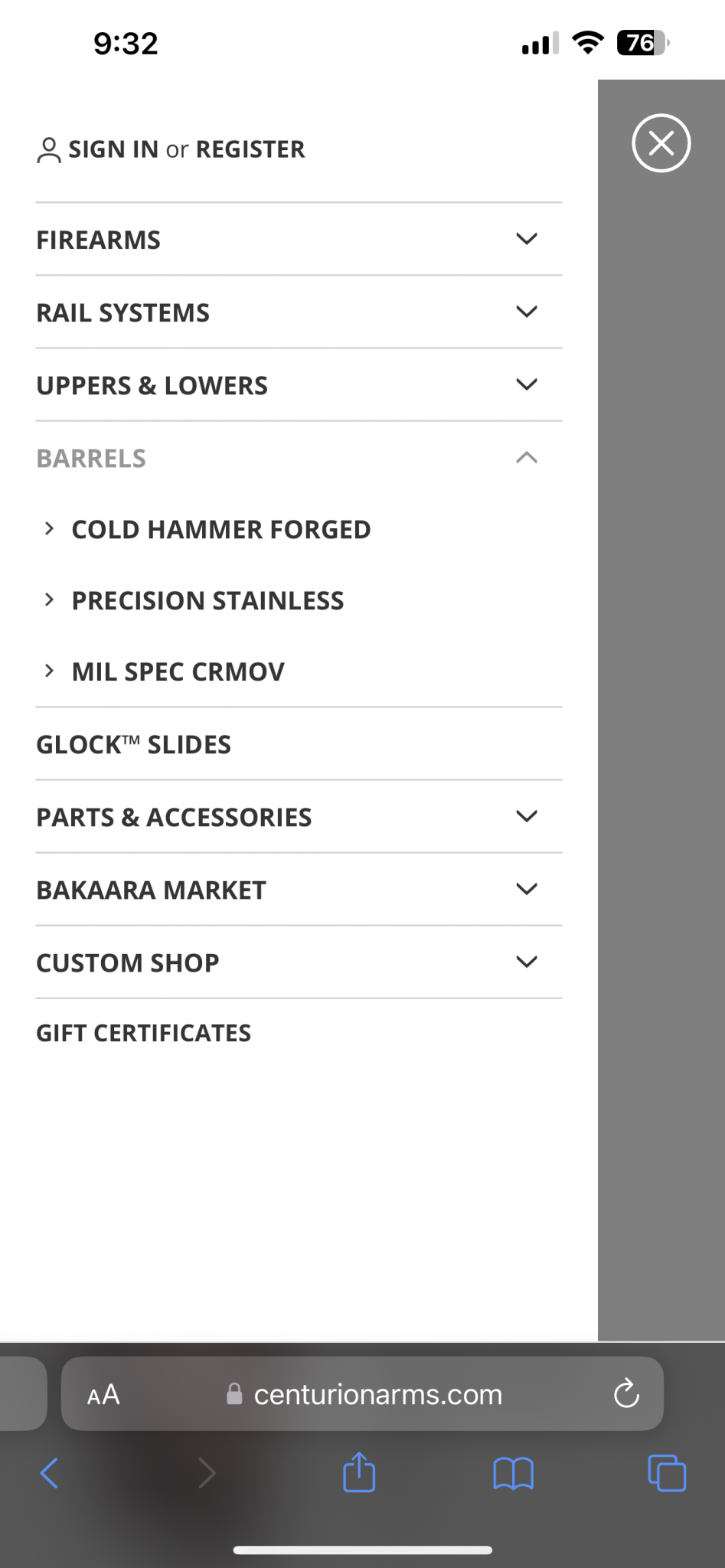

debating between any company microbest will OEM for, or something like a JP or geissele BCG
Is "duty grade" the new "hard use"? Criterion, Centurion Arms, Daniel Defense all had options in stock it looked like.
I've been out of the AR scene for like 8 years so i don't know what terms are what anymore haha.
I've been looking hard at the Criterion Core series of barrels and I love all of Monty's products at Centurion.
What's the consensus on Geissele and BRT? I assume geissele is like Noveske and is good but overpriced for what it is.

Is there much difference between a centurion arms CHF barrel vs a 4150 CMV barrel from the same company? Both are chrome lined
