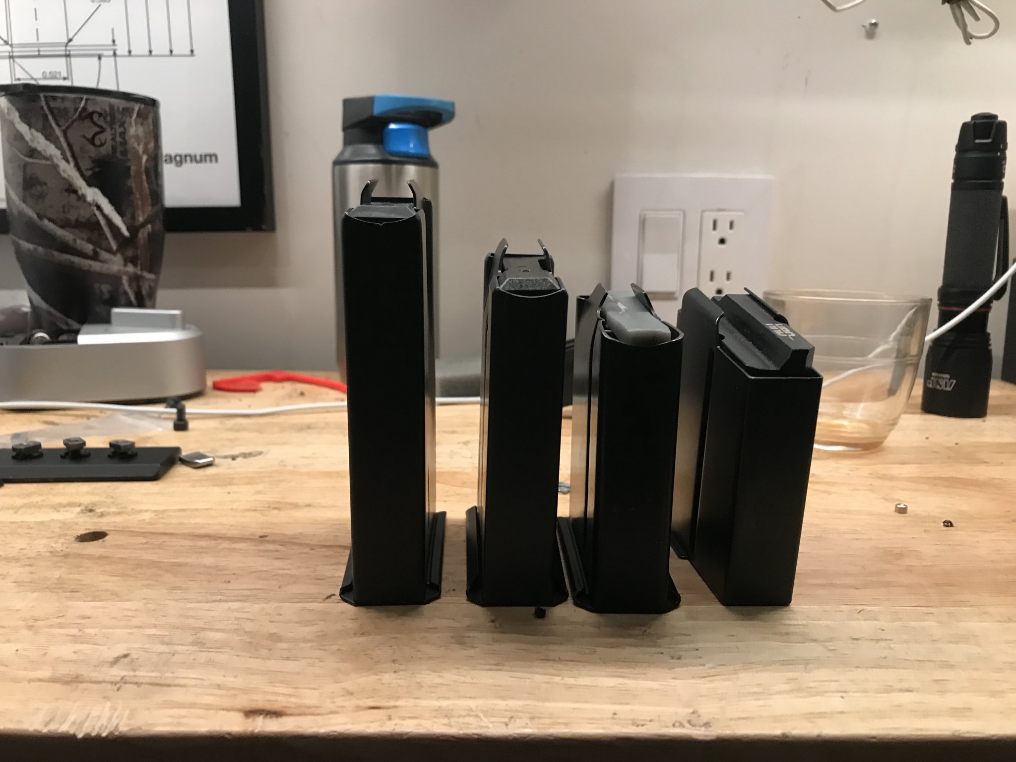

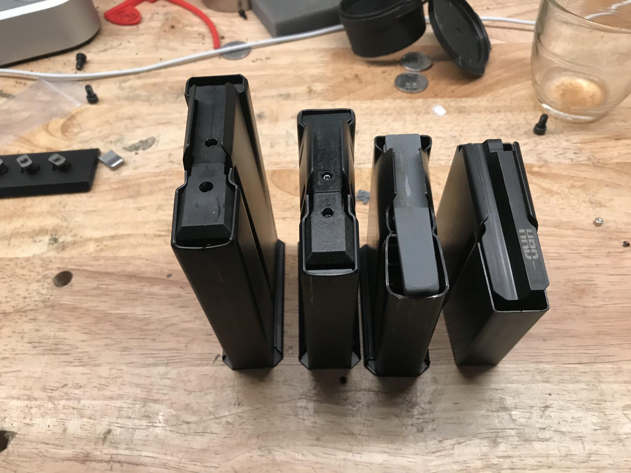

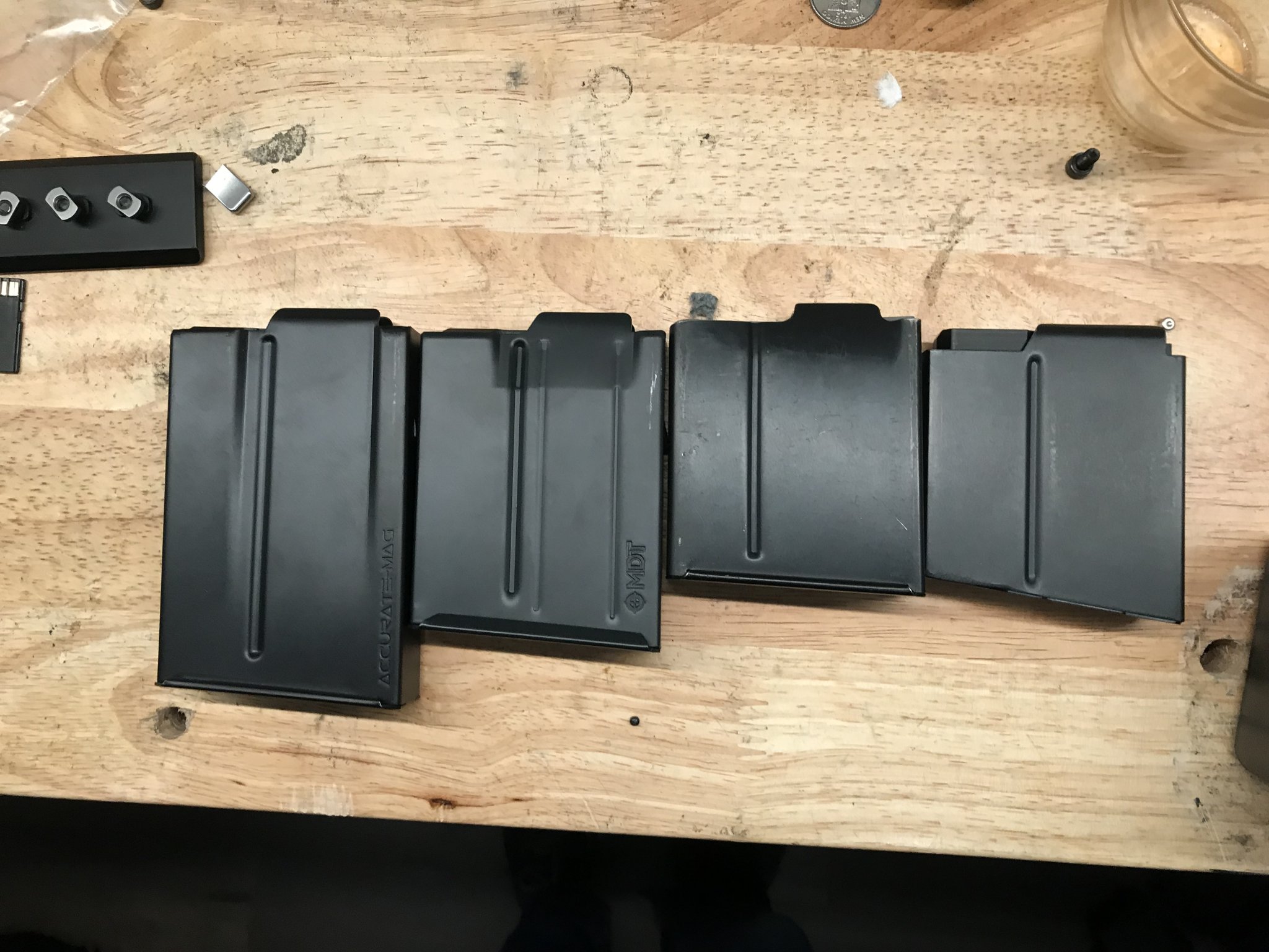

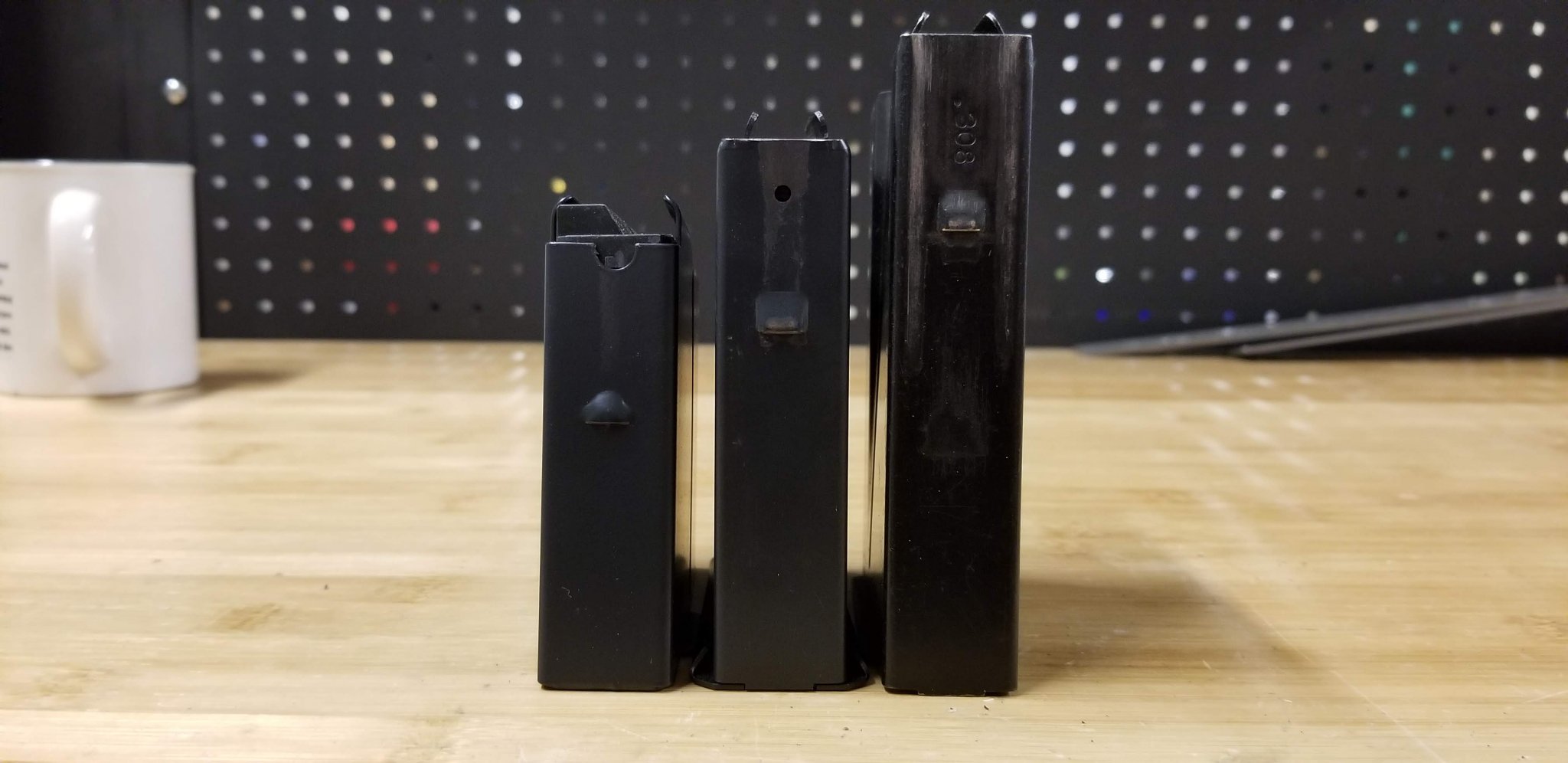

I just (back)ordered the MDT 10-round mags. I’ll post a pic with them, AICS, AW, Accurate, and ARC when the MDTs arrive.
Here are the pics, minus AICS, which I couldn’t find. MDT is definitely shorter than accurate but a lot taller than AW or ARC. I’ll report on reliability this weekend.

I ran 75 rounds through the MDT today. I prefer it to AICS or Accurate. It’s not as short as ARC/AW, but it’s a good deal shorter than The others. It’s also very well made. It feels like AICS/AW quality.
Of the three you listed, it’s probably the best choice if height matters to you.

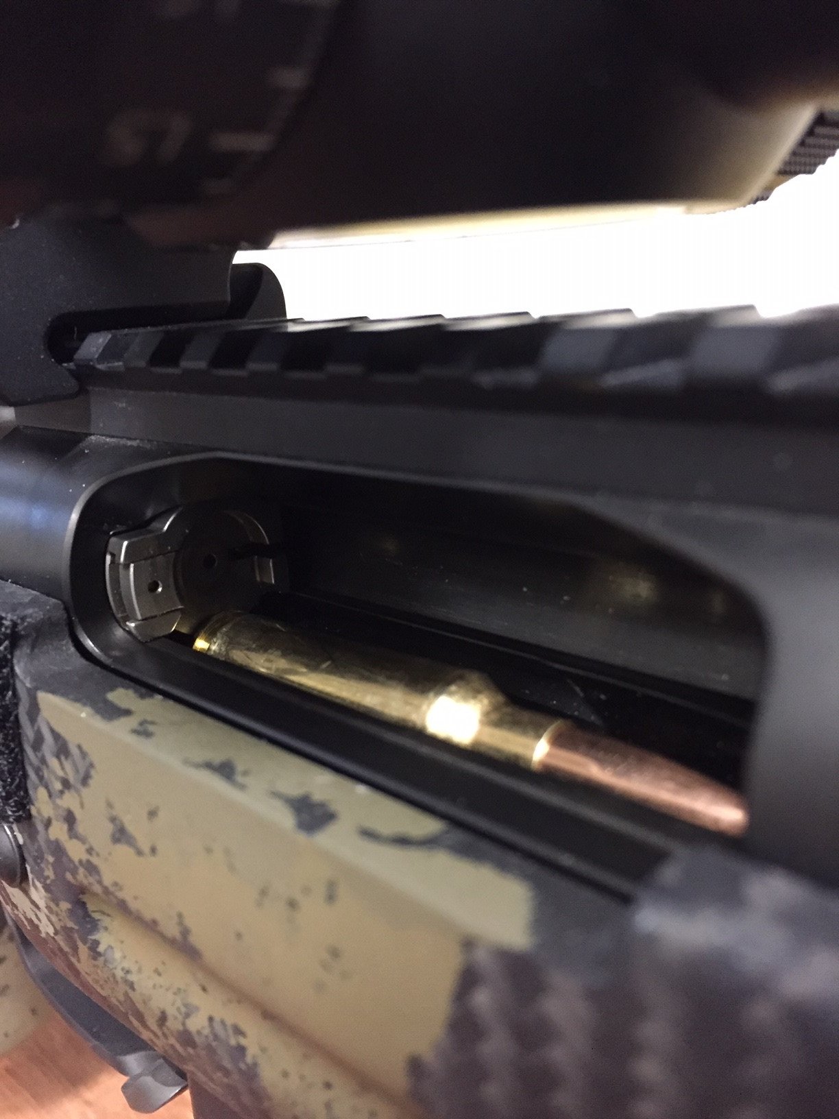

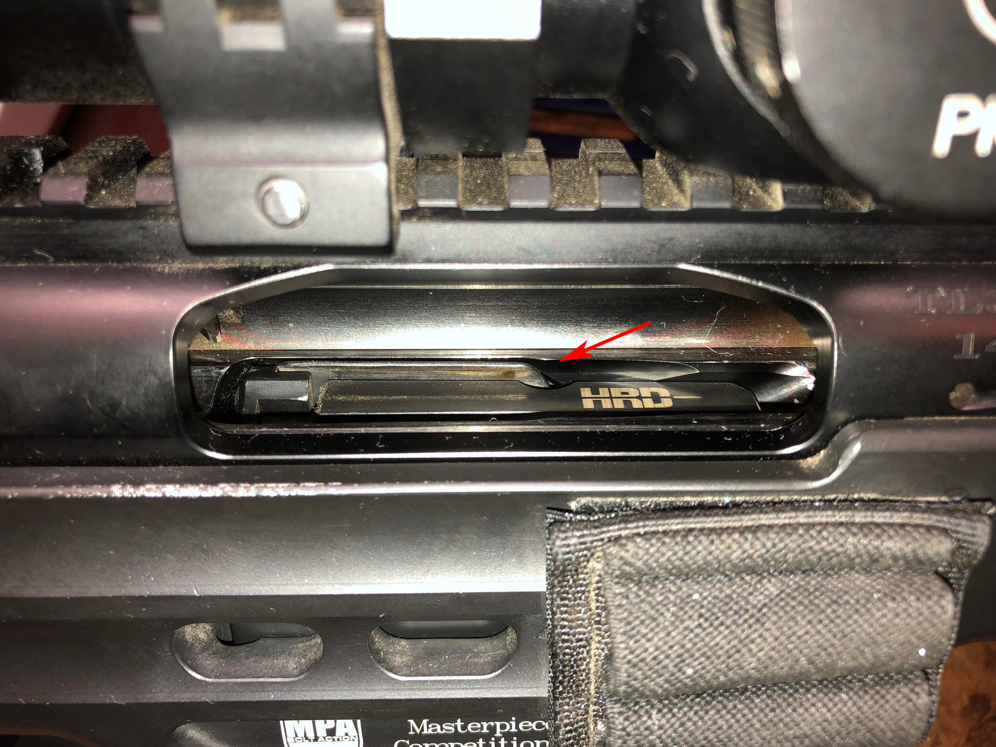

@Sheldon N would you mind sharing how to set the AW mags up properly? I’ve tried them with & without the HRD followers and I can’t get them to reliably & smoothly feed 6.5 CM in my TL3 w/ an Envy.
I just did a little bending of the feed lips with an MPA feed lip adjustment tool, plus a tiny bit of bending of the follower spring.
The feed lip adjustment was to get the case head high enough so there was overlap with the bolt face to pick up a round. When I first loaded a mag there was little to no case/bolt overlap so it wouldn't pick up a round. With bending the feed lips it seems like the sweet spot is where the feed lip closely follows the line of the AW cut in the action. If I opened them too wide the mag wouldn't latch in the chassis. As I've got them now the mag latches in with firm pressure and there's no up/down play once it's seated. You can see in the picture with the red arrow where the feed lips line up with the action cut.
The other thing I did was bend the follower spring to make it a little more "nose down" orientation. In my mag the cases weren't popping up fully parallel with the feed lips and that would make them not feed. By tweaking the follower spring so that it pushes a bit more on the rear of the case it helped my mag to push the rounds up fully into position once the prior one stripped out. This might just have been a thing with feeding short cases like 6BRA, but it's something to look at as a possible tool to help fine tune feeding.
Hope this helps get you on the right path!

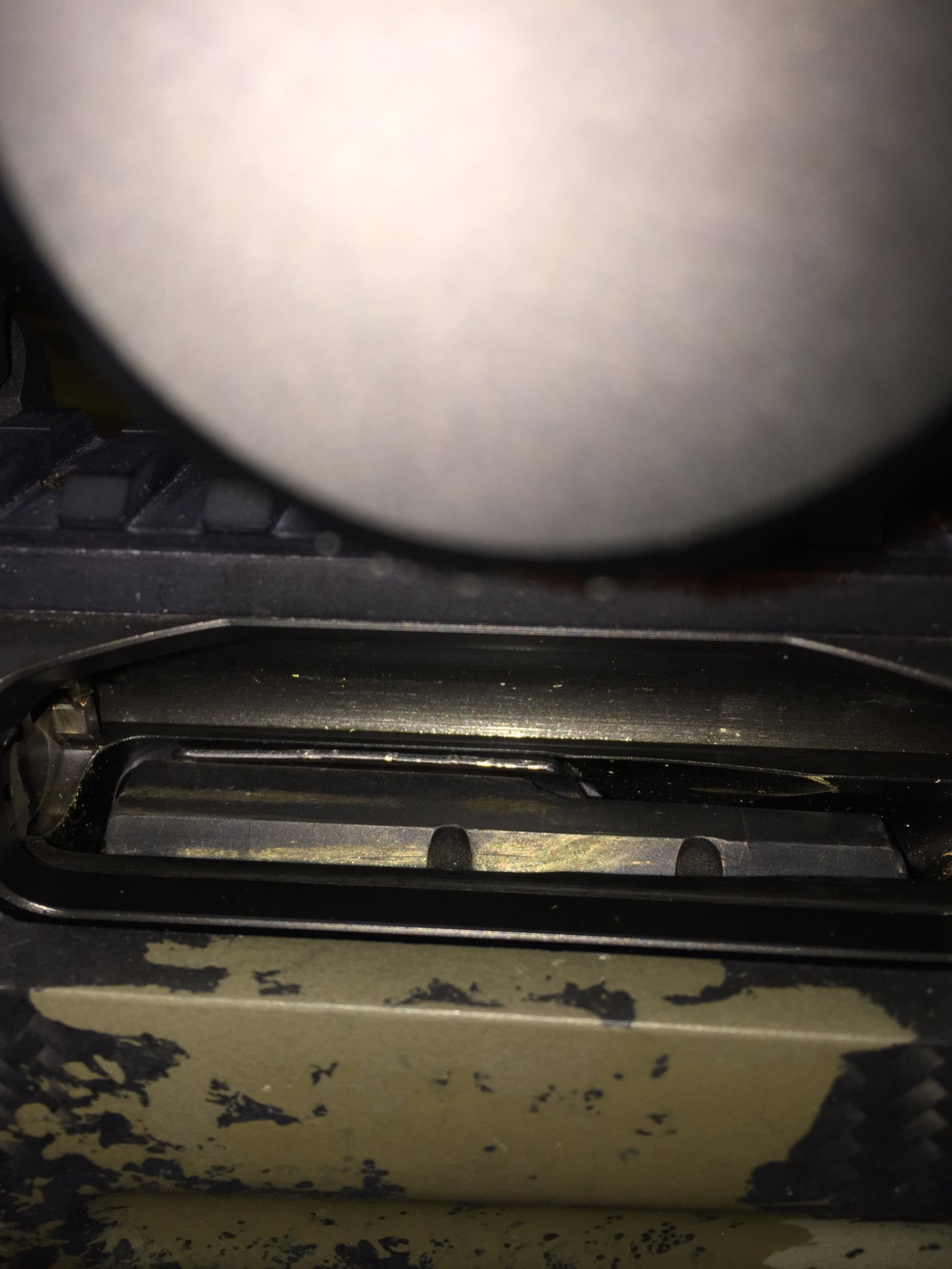

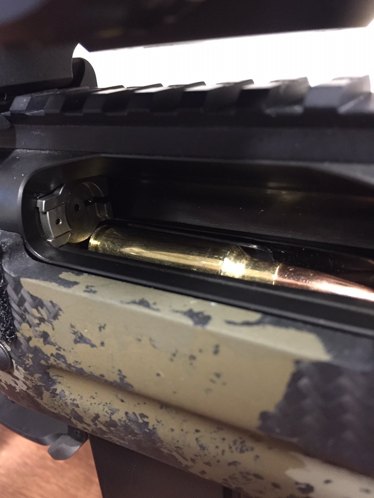

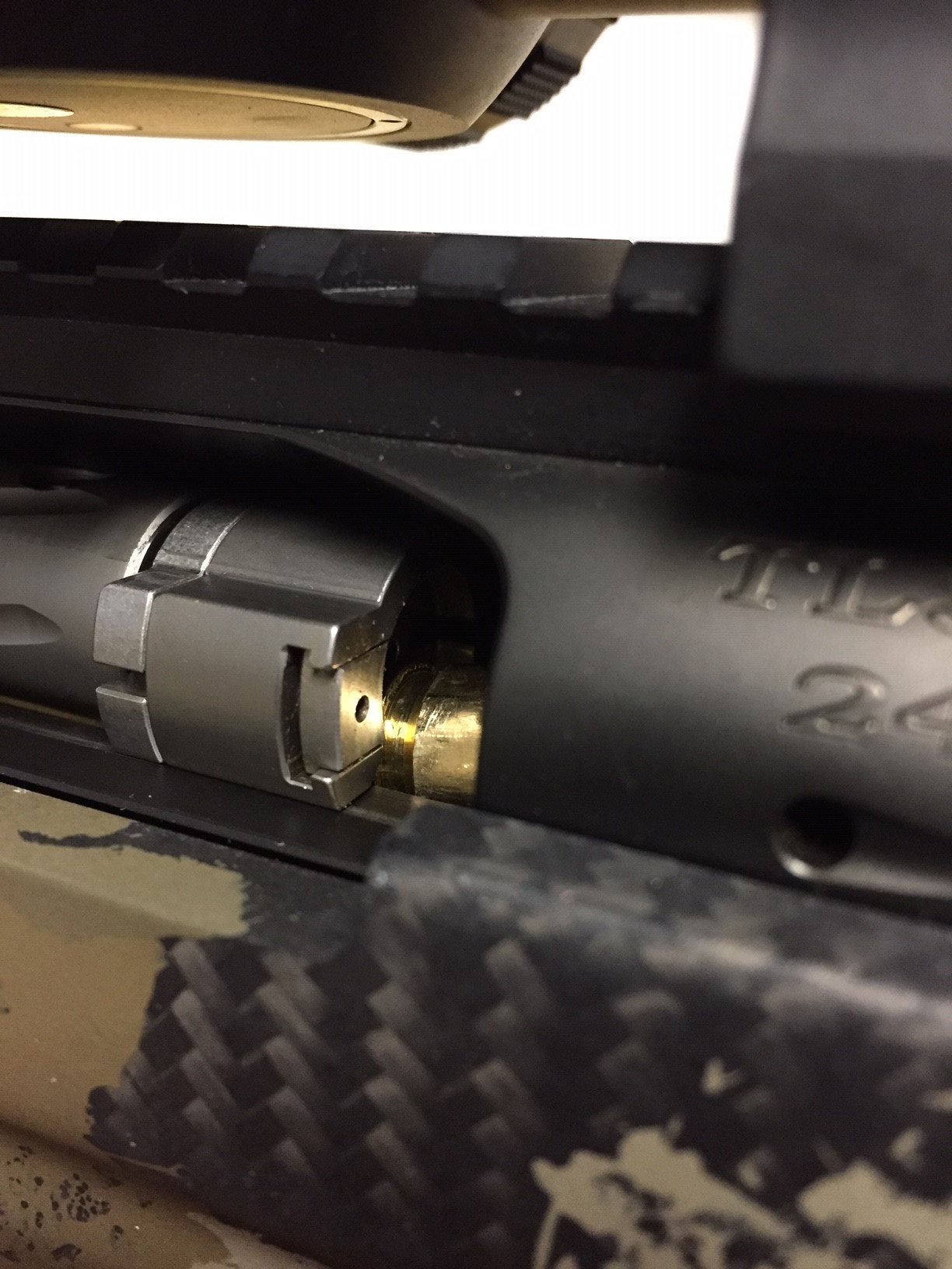

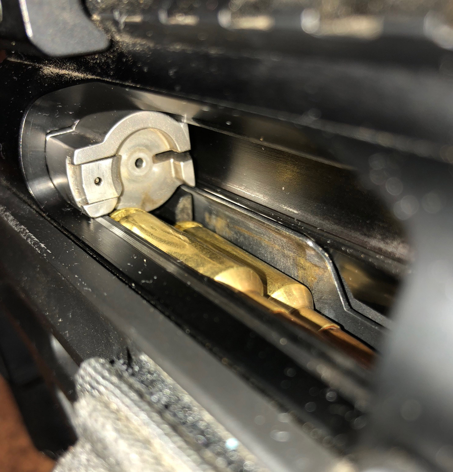

Resurrecting an older thread here but, after spending a couple hours this afternoon playing with AWs and adjusting the feedlips to try and get AW mags to work in a TL3, I think I am going back to ARC mags. I tried 2 different AW mags in both a MPA BA chassis and Manners PSR1 with GEN2 DBM. I am running factory 6.5CM ammo, both Prime 130grs and Hornady 140grs. I left one AW mag default and adjusted only one of them. The AW mags lock up super nice in the Manners GEN2 DBM, even without adjusting the feedlips. There is no play with the mag once it is engaged. This is the only positive comment I have regarding the AW's in a TL3 cut for AWs. Besides that I faced multiple issues:
Issue #1: Bolt sails over top of round
With the mag loaded to 10round capacity the bolt will sail over top of the round. As you can see the bolt did push the round forward slightly as the case is in front of the feedlip, but at some point the round stops moving and bolt sails over the top of it. This does not occur with 6-7 rounds.
Issue #2: Rear end of round drops into front of AW
Bolt engages with round and pushes it forward enough to where the rear end of the round drops down into the front of the AW. Which leads me to my third issue.
Issues #3: Control Round Feed (CRF) engagement
The CRF does not occur until the round is chambered and becomes much like a conventional push feed system

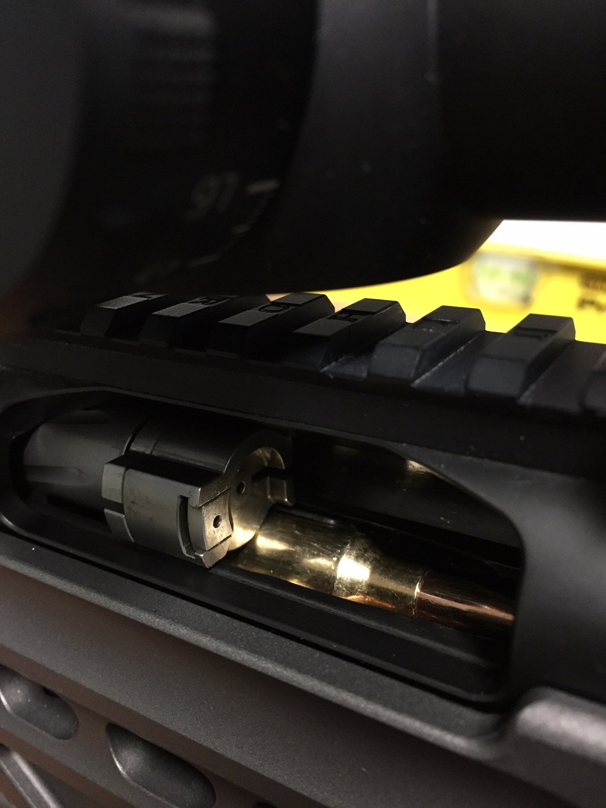

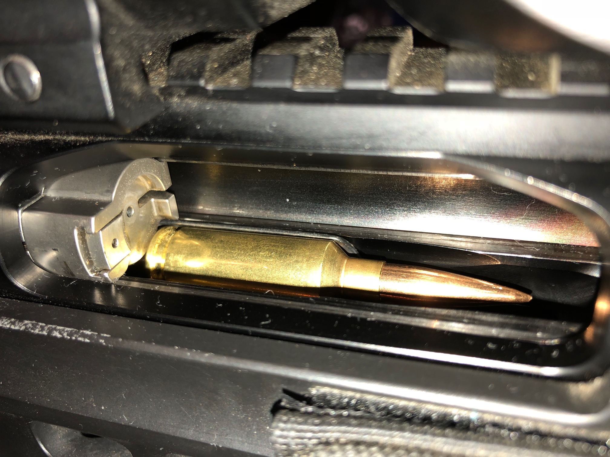

Picture of Bolt and round interface with a AW
Bolt and round interface on ARC mag
For me the ARC mag feeds and feels like butter. Before my TL3 I ran a Tikka and I switch to ARC mags because they felt so much better than AICS mags. The round pops into the CRF on its own and it feeds and feels consistent. The only 2 issues I have with the ARC mags. First is there is a lot of play once you insert them into the magwell. Second is if the front of the mag is pushed into anything (barricade, bag, etc) the round will tend to nosedive

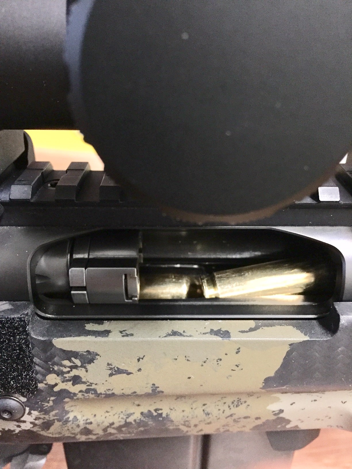

The AW mag on the other hand, even without rounds in it, gets hung up, with the bolt traveling over the follower and pushing it down. With rounds in the mag I could get it to feed appropriately at times but it was highly inconsistent. I adjusted the entire feedlip outward. I adjusted just the front of the feedlip inward. I also adjusted just the back of the feelip both inward and outward. Pretty much the same results in any circumstance. I did not adjust the entire feedlip inward as this would limit the contact/interface between the bolt and the round which is already limited.
I have seen a couple of threads where people have trimmed the length of the feedlip. Comparing the ARC to the AW, the ARC is about 3/4 as long, I feel like trimming the AW back a bit might help.
Any suggestions?

First thought would be to attempt to increase the amount of case head to bolt face presentation so that the bolt can't over run the round. This might be not only widening the gap between the feed lips, but also possibly changing the feed lip angle so that they point upwards, ie taking some of the roll bend out of them. The only limiting factor to how wide the feed lips can go is that the mag ceases to latch in the chassis due to interference so I might try to open them up to the point where the mag won't latch, then work back inwards.
I see a bit of a gap between mag feed lips and action on your photo, more so towards the front of the feed lips. Compare to the photo I posted above where the feed lips are much wider and really pressed up against the sides of the action body.
Beyond that not sure what other suggestions to offer. Maybe a bit of spring stretching to affect how aggressively the rounds are pushed up? I did a bit of that to make sure the rear of the round was being pushed up toward the bolt face. Mine is shorter cases with a spacer so that might make things different.

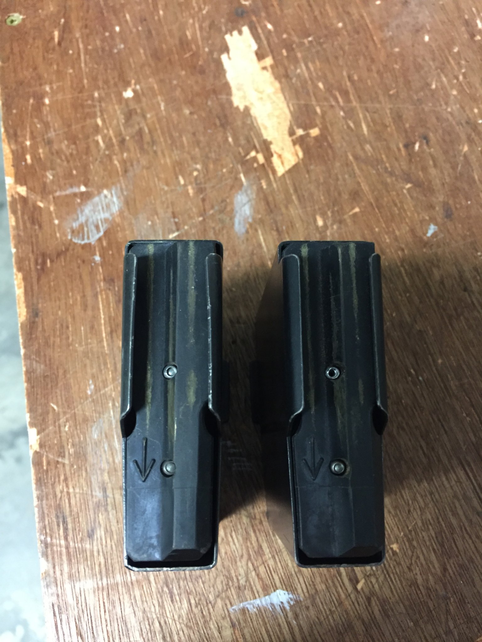

Thanks @Sheldon N . I opened up the front end more and tightened up the back end. I ran about 30rds through it and it fed well.
Left side is the modified AW mag, right side is the default AW
