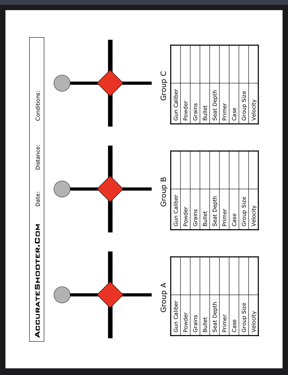

Lately I’ve been looking around for a better target for load development. Lots of good ones out there but curious which you like best.
This one is my favorite:
  • My Load Development Target.pdf

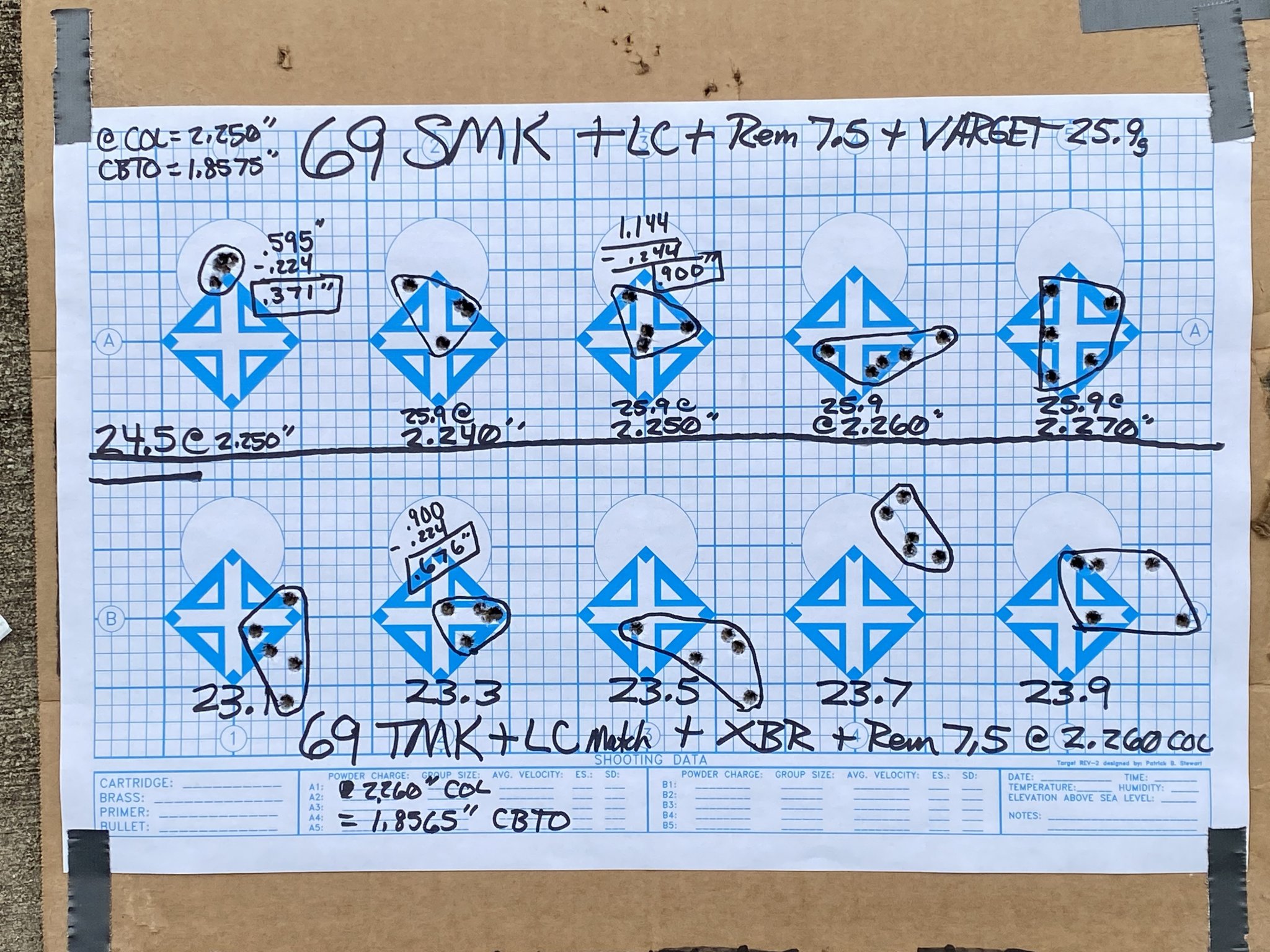

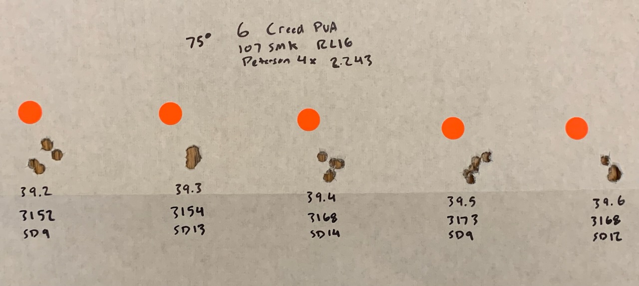

Have been using white poster board with 1\2 grid lines. Use orange target sticker of preferred size. Easy to see bullet placement when doing load development.

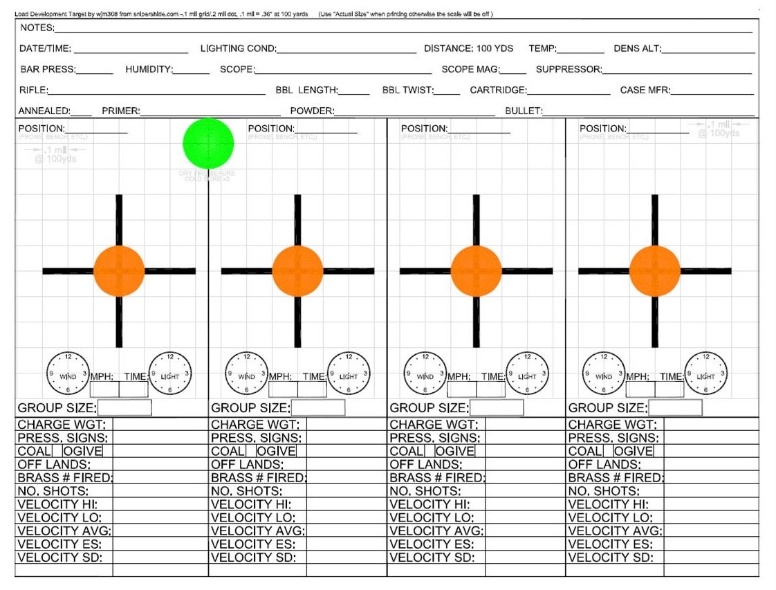

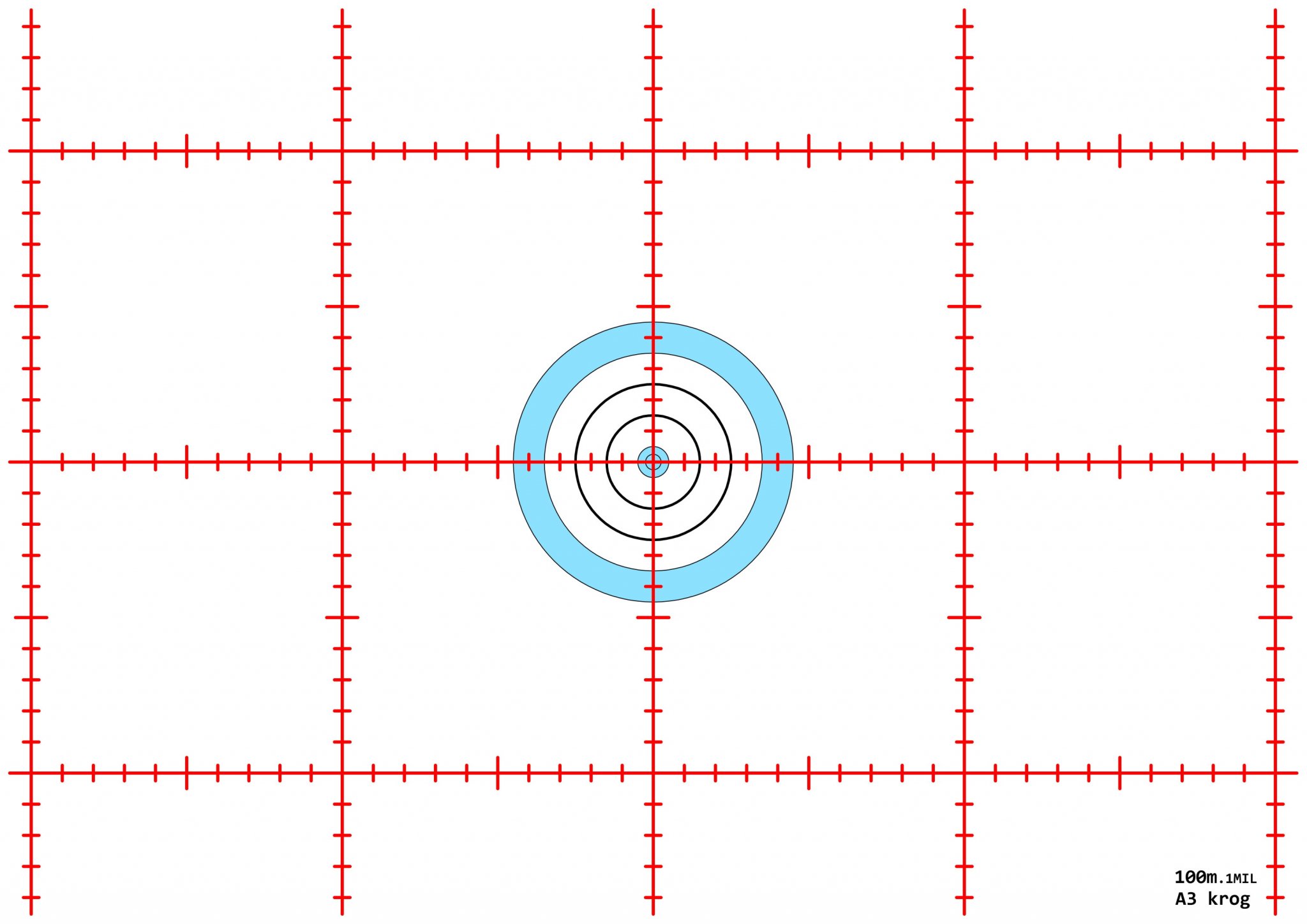

I do photography so I have the software and printer to roll my own. The one below is multipurpose - works for load development.
I print then in 11x17 sheets of thin card stock so the holes on paper are nice and crisp. Everything is scaled in Mils. The red squares are exactly .1 Mil.
I like the first one. 3 red diamonds 1/2"

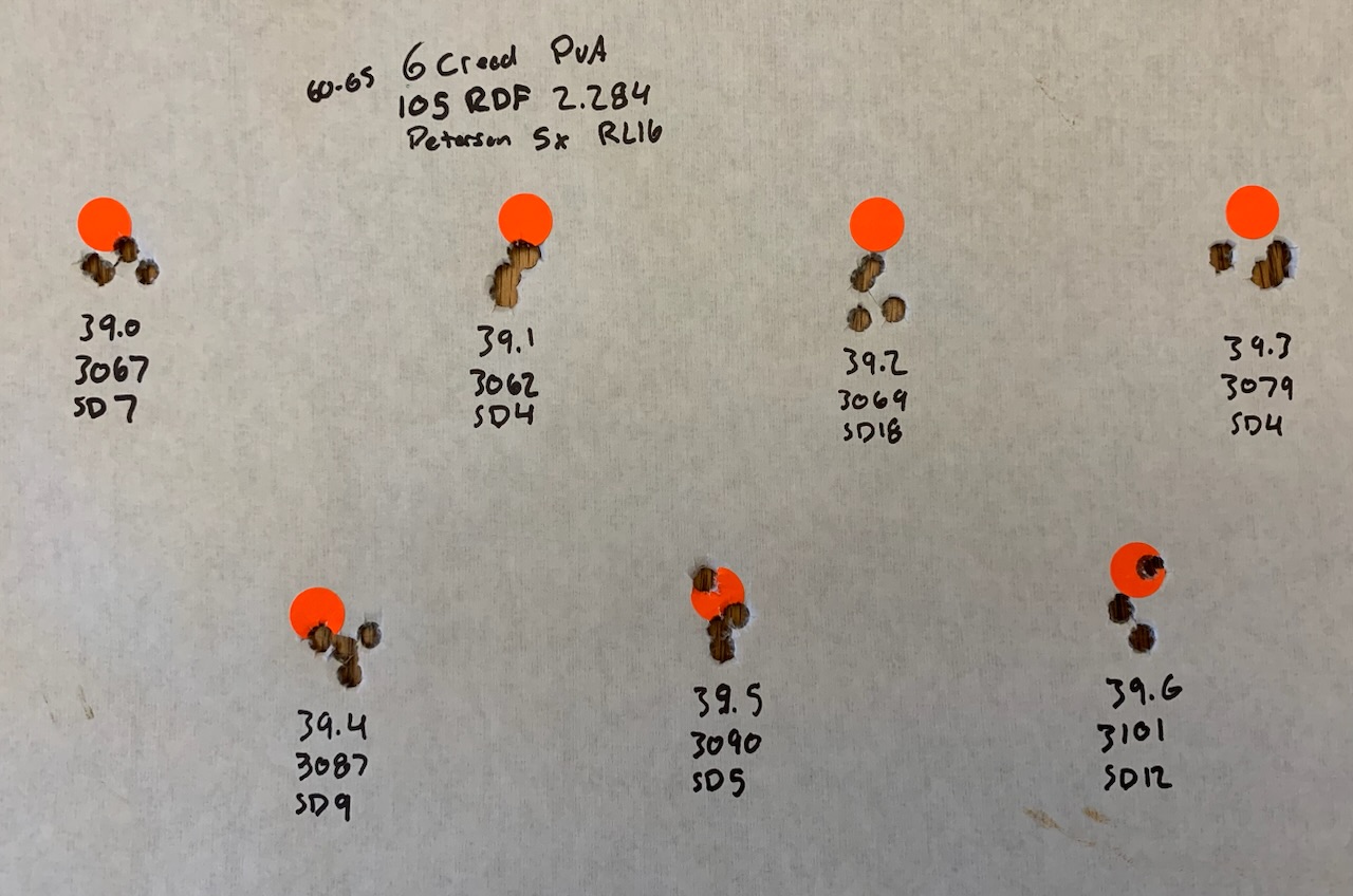

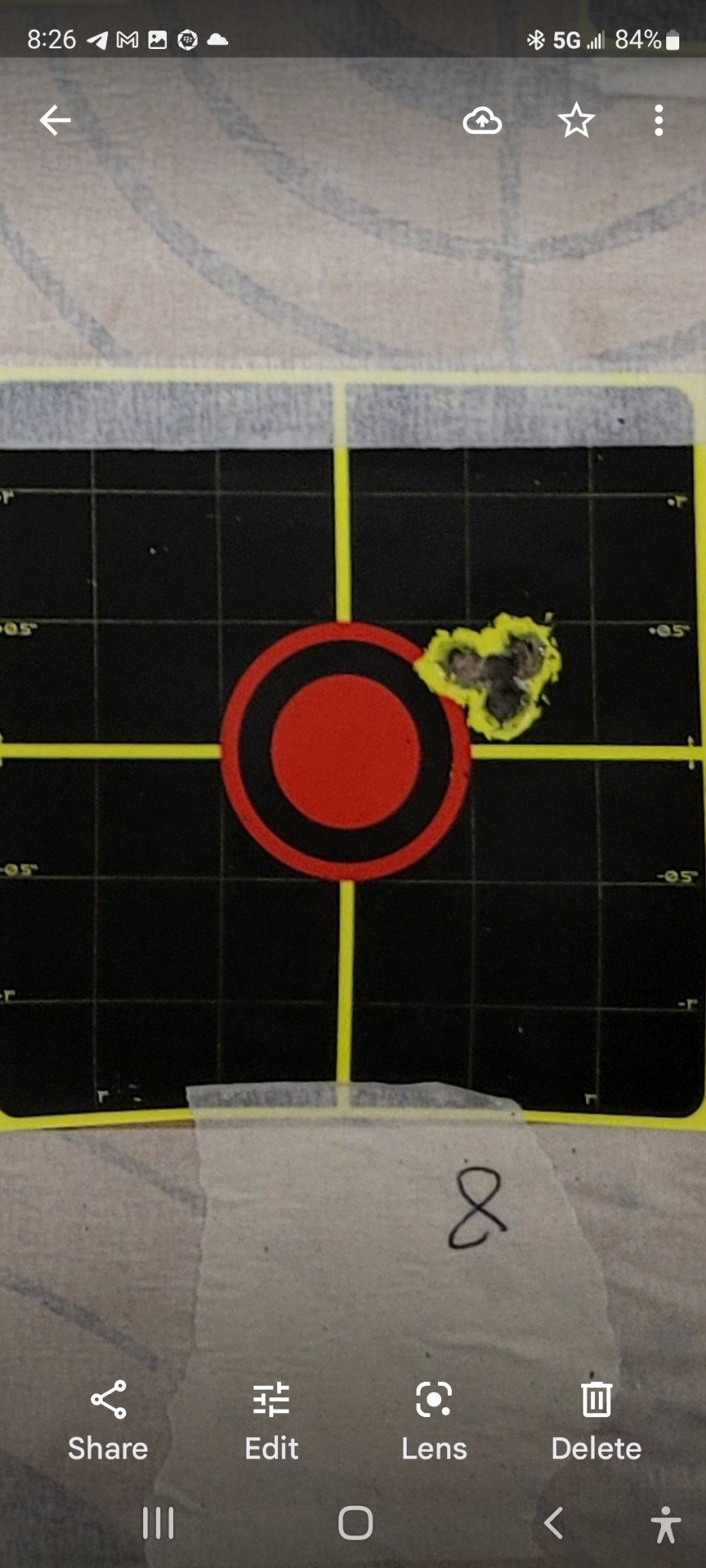

I like these because they are easy stickers, and I can buy them in rolls of 250 for cheap. There's actually another one like it that I think I will like a little bit better because it's just the dot in the middle is a tad bigger and easier to see

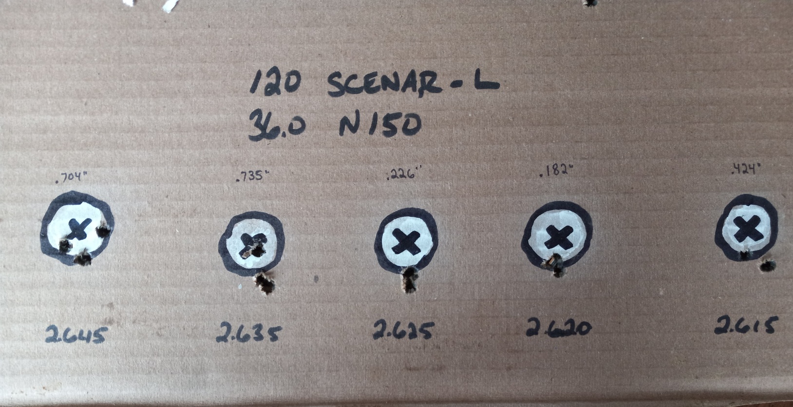

Here I am, white-trashing it up on old cardboard box lids with Walmart white spray paint (use that for my steel targets) and a black sharpie. 😄
Works for me though.

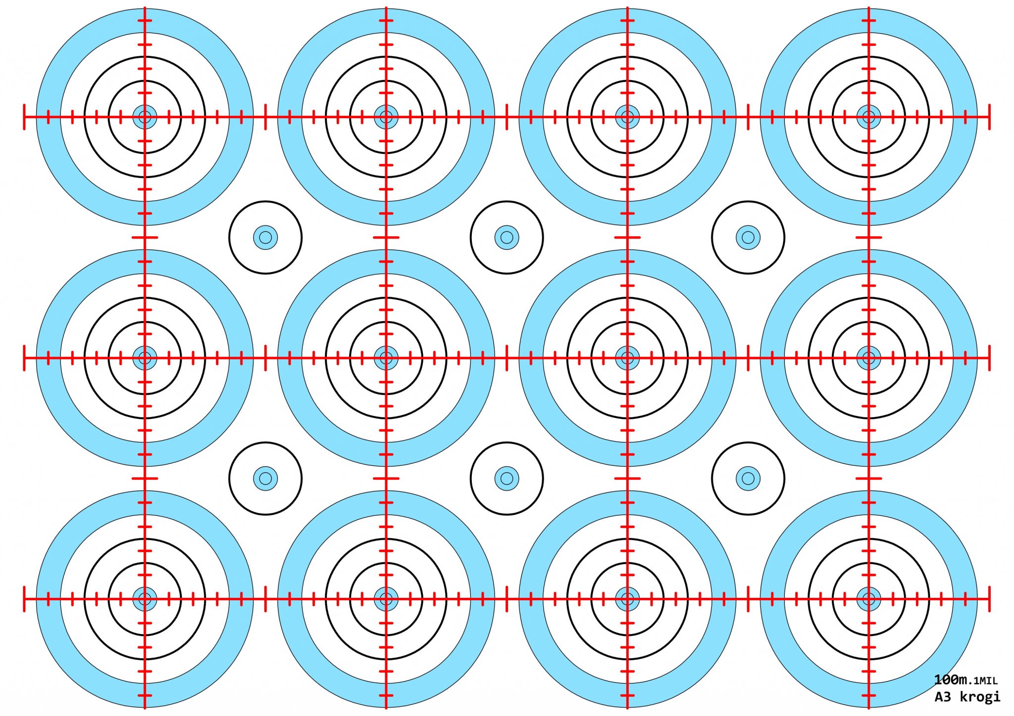

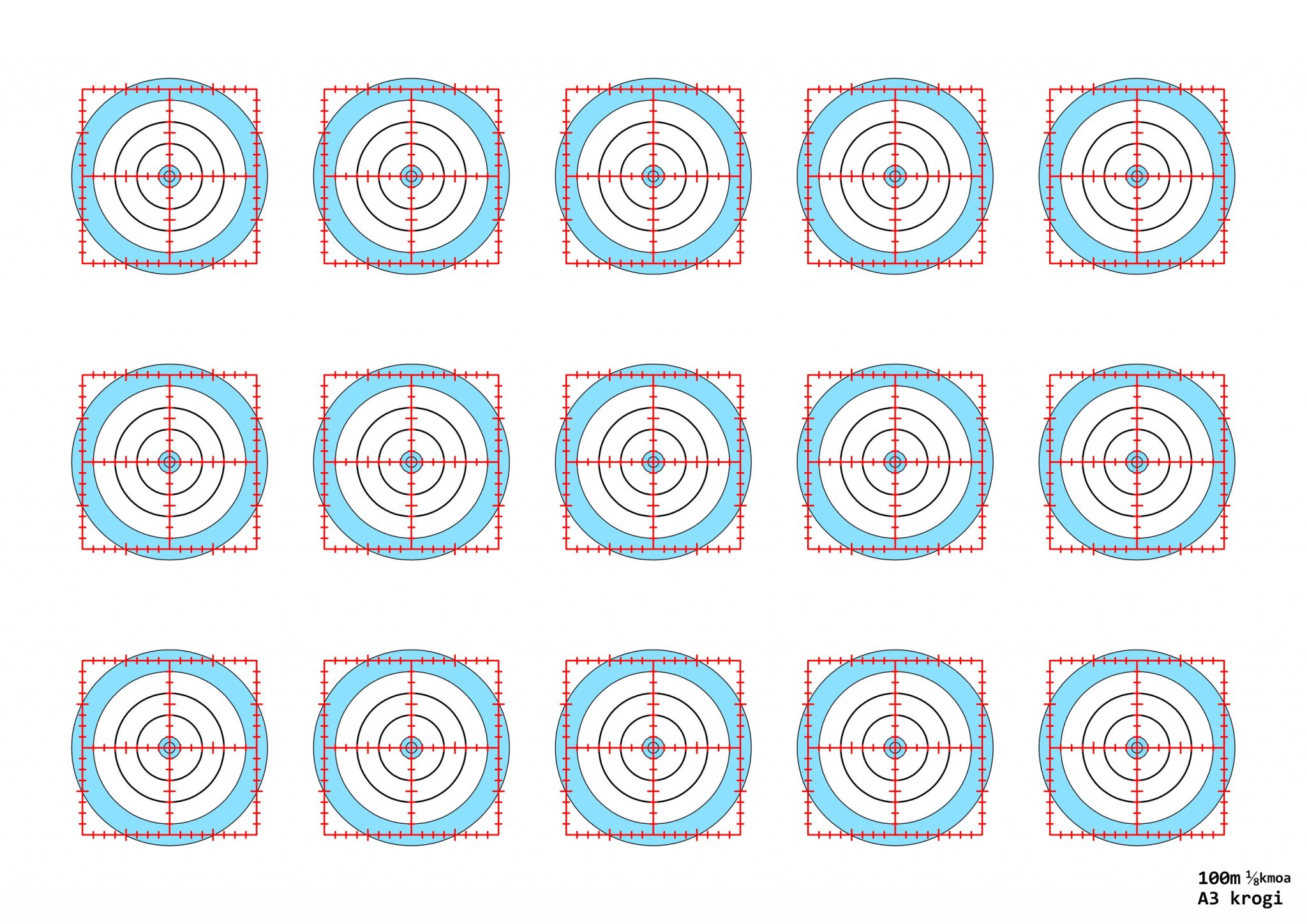

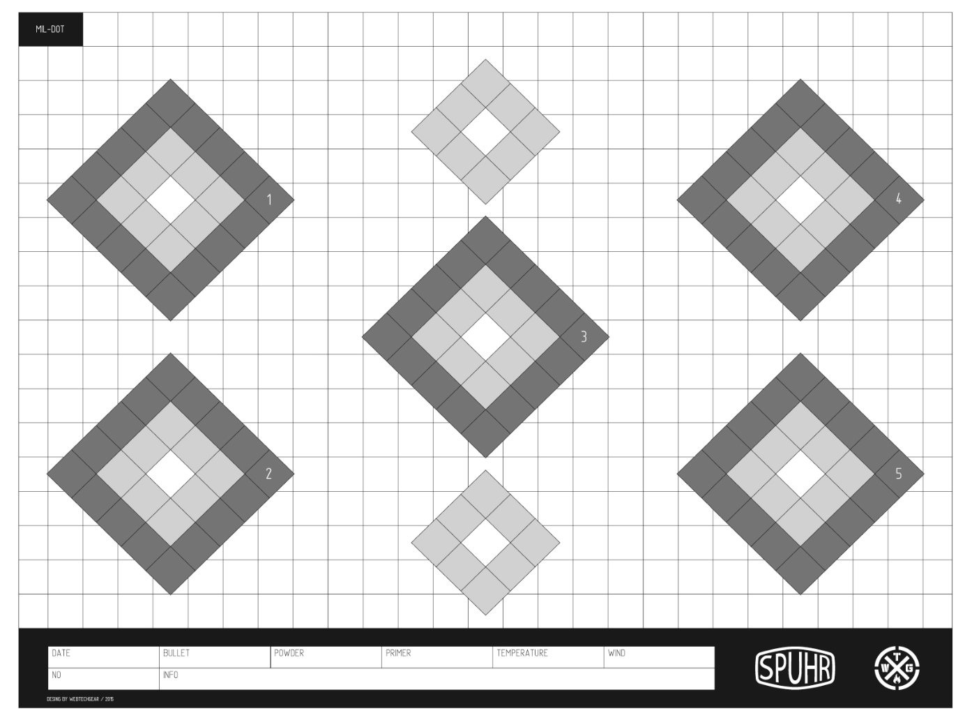

I mostly use the old Spuhr ones, my preferred target is the 45 degree MIL target which is extremely easy to center in the reticle (for me at least, I realize this is highly subjective).
You can download it (and MOA version, and regular squares version) here, on the last page:
