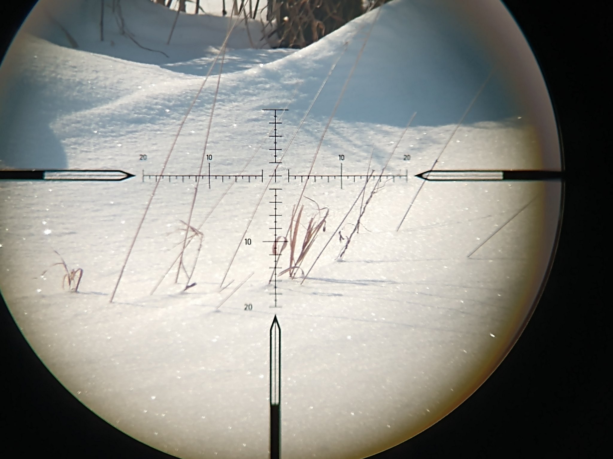

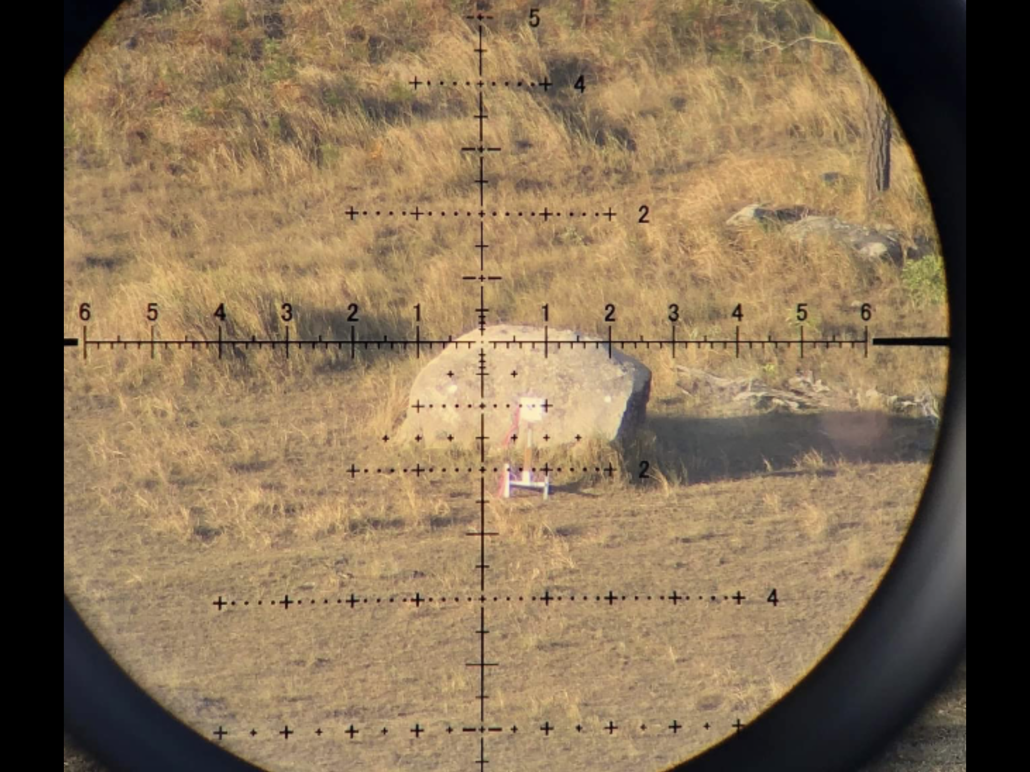

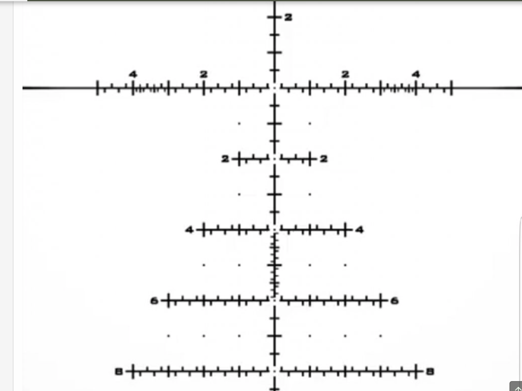

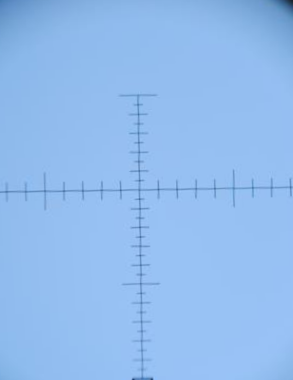

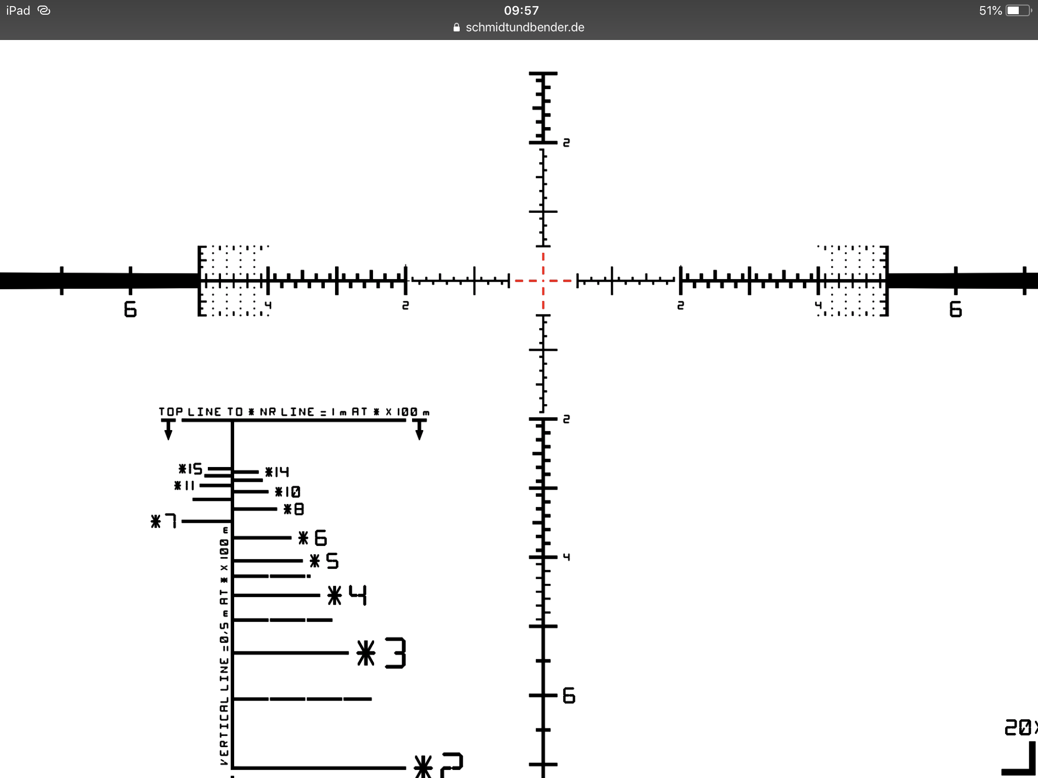

Standard cross with appropriate sub tensions as per S & B LRR , hybrid reticle like March FML MT , US Optics JVCR ( all pictured below )or do you prefer to go ‘ full Horus ‘ ?
I think it's going to be highly subjective to everyone, but I personally prefer the MSR or P4F. Clean, uncluttered, simple. I've tried the H59 at typical ELR distances but I don't feel that it's optimal. It's not too terrible as an observation reticle at ELR.

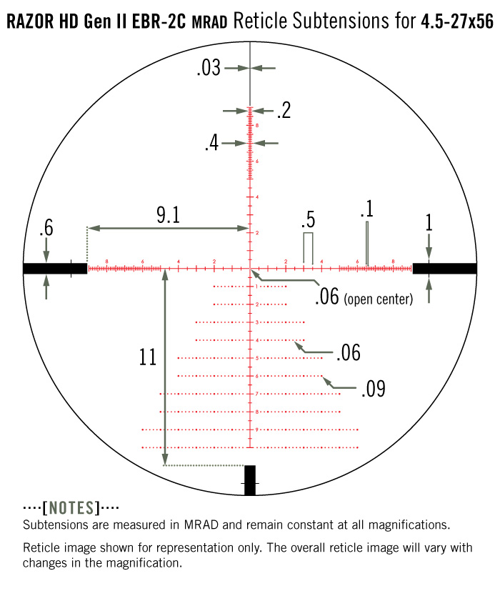

I did have a stint with Vortex ebr-2c. For some reason my eyes did not like the glass in the Gen 2 Razor, so I moved on.
Next was H59 in a BEAST. Here is where I fell in love with the floating center dot. This made it seem so easy to aim. My brain and eyes just loved this small center focal point. Aim small miss small ...the center floating dot seems to jive with this notion. The rest of H59 features seemed like a detriment to me. First was obstruction of view and spotting shots in less than ideal conditions. What I did find myself doing was pulling down the reticle and using the upper half FOV in the scope for spotting. With a 5 second TOF this is very doable. Secondly, what I did find myself wanting was more defining features, i.e less repetitive markings in the reticle. With a glance of an eye I want to be able to intuitively decide with confidence my reference values.
My current reticle is Tangent theta's Gen 2 XR. Going to be shooting with this more this summer. IMO this is a good reticle but I definitely got spoiled with H59's floating center dot. I think a blend of Gen 2 XR and Gen 3 XR would be perfect. Gen 3's main stadia with center dot and Gen 2's tree.

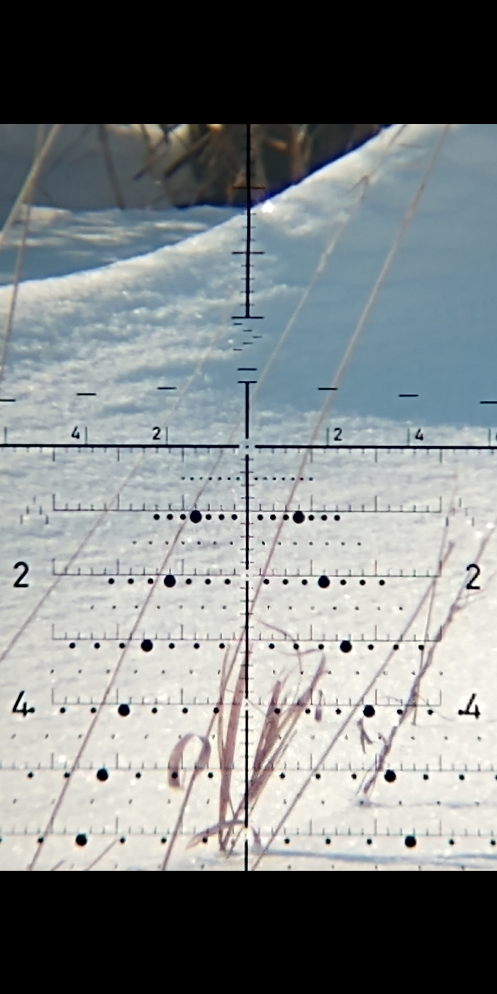

^^ Quite a few units using T3 on the job : personally it’s a bit busy for me with the blobby wind dots.
Easy for the big wind blobs to obscure detail, and they make it harder to see misses in some terrain.
For ELR / ULR , you are unlikely to be milling the target with the reticle, or doing rough wind formulas
off the wind blobs. Accurate ranges and solutions, and very good wind juju is what’s required.

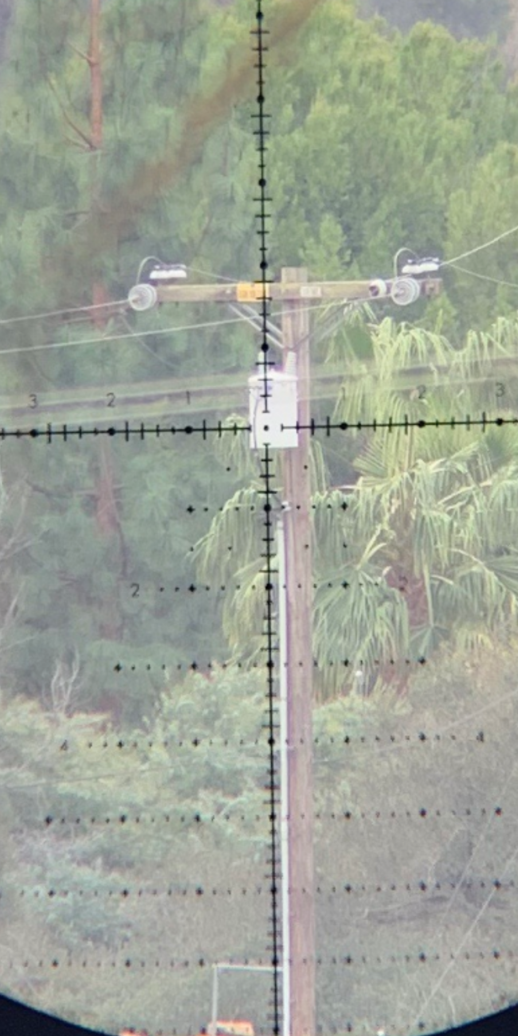

I have used a H59 and Tremor 3 in ELR competitions. I am so fixated on my target that all is see is the floating center dot and my actual target. While receiving wind calls from my two spotters, the shooter shouldn’t be looking at anything other than the smallest ... exacting point of aim. I am looking thru the reticle and NOT at it.
Yes, I do communicate the target height and width in MILS to my teammates behind me.

Looking at the reticle for what it is, IMO, I think there are much better choices for ELR situations. Can it be used for ELR .... absolutely. It really doesn't matter what reticle is used when a shooter has one or more spotters calling his shot. Where it starts to matter is when calling your own shots. This is where as much open glass is advantageous. Toss into the mix environmental conditions that mitigate bullet splash like vegetation, snow, and wet soil. Also add some mirage, which increase the difficulty of spotting shots. Less clutter--less confusion at distance.
IMO the T3 shines in a DMR role (1000 yards and under) with multiple target engagements in dry barron landscape, where bullet splash is more evident. No dialing, relative wind dots for different yardages, the T3 provides speed for these situations.

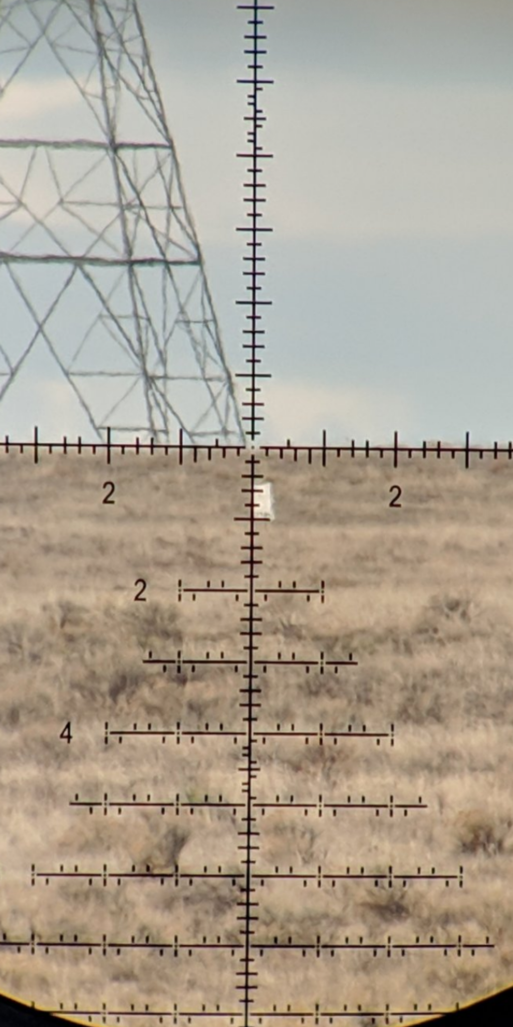

So a non christmas tree / not so busy type reticle would be better for ELR?
IE : like in the pictures posted above ?

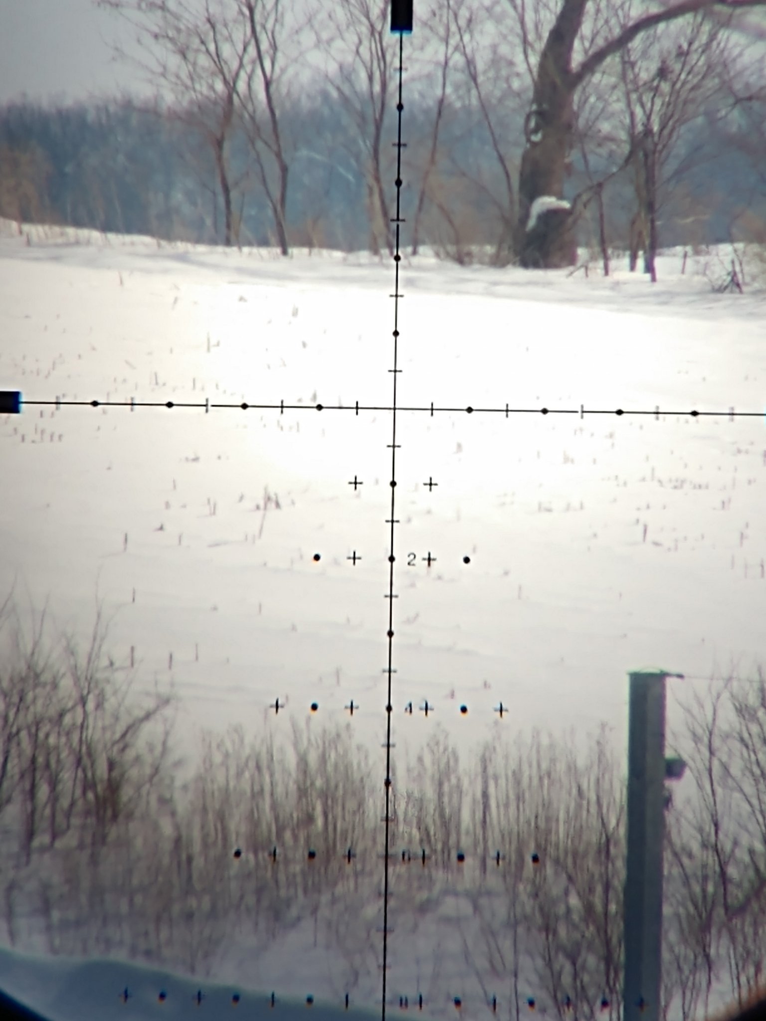

I like that ZCO reticle.
A usable 1/10 of a mil area and clean 0 to 2nd mil down area for spotting misses

For me it depends if you can dial elevation to all your targets or not. If you can dial el all the way there, you
don’t need a tree reticle . As Chris mentioned above, if you can dial all the way , you are going to be focused
on the centre of the reticle so you aren’t going to worry about or be focused on the dots below .
If you are running a 416 with solids , and or a Tacom unit or Genesis optic you don’t ever really need a tree
reticle . Where a tree reticle is great is if you lack the necessary elevation travel to get to your target . Let’s
say shooting a 6.5 to 2000 or so, using a conventional optic on a 20 or 40 MOA base . Depending on bullet
choice and optic, you will run out of elevation somewhere from 1300 to 1600 yards ( ish) .
ELR for me is not just restricted to big magnums : if you are shooting beyond the accepted effective range
of your caliber you are in the ELR zone .
In that situation, holding over is your only option and the wind dots become very useful for wind holds. If the
dots are large, and you are shooting a smaller caliber it can be difficult to see your misses without assistance
from a second or third spotter. I agree with comments in above posts that the T3 reticle was really designed for
DM type role out to 1 k or so. LL did an article on it a long time ago, the wind blobs in the T3 were originally for
308 I think, but someone may be able to provide more info .
EDIT : there’s an instructional video from Horus on You Tube about the T3 reticle if you are interested .
