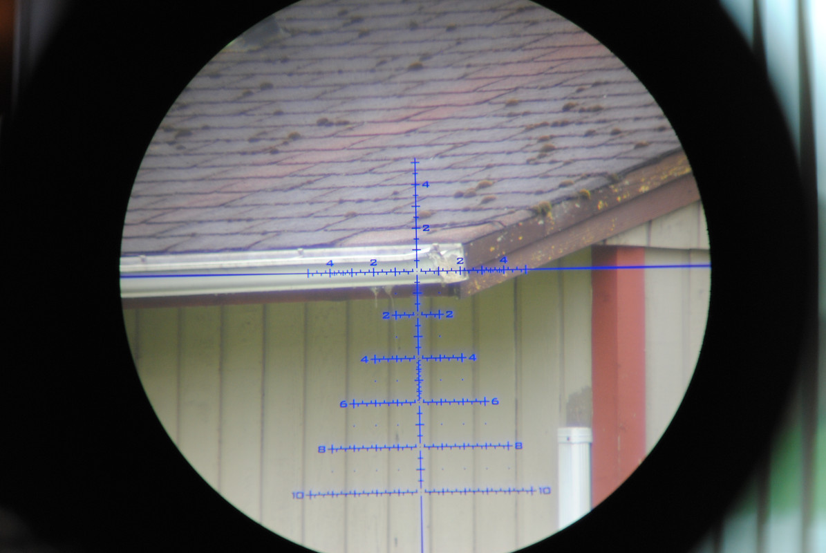

Hello, Ken. Excellent write-up. Precisely what I'm looking for. I have the same experience with the Illum control on my b25. The old "LR" series Illum control was/is much nicer. Definitely more user friendly.
What Ret do you have on your 17? Thank You.

It's a JVCR, with blue illumination.

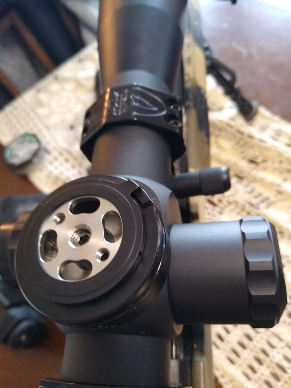

I've already mentioned the zero stop, but here are some pics of the design:
The raised lug at the top in the pic, is the actual stop.
It's stupid simple to set. First zero the scope, then remove the top cap and turret. Position the zero stop against that raised lug from the first pic, and put the turret back on with the zero marking indexed.
When you reinstall and tighten the top cap, the ring part is pinched in place. The raised lug prevents further clockwise rotation. Since the turret is threaded, a full CCW rotation raises the stop enough that it clears the lug after a full rotation.
Reactions: LOS

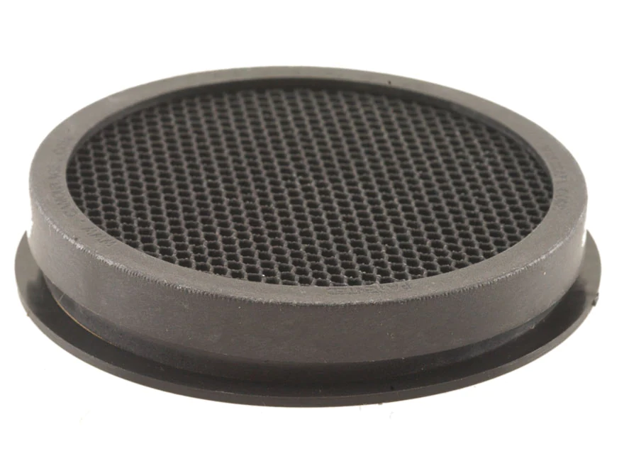

Spring for the sunshade. It comes with a honeycomb ARD preinstalled, but they'd probably remove it if you asked them. It's actually a pretty good ARD; the material is razor thin so doesn't negatively effect the image quality nearly as much as some honeycombs.
As koshkin mentioned, it has some flare. When I first got mine and looked through it, it was in bright daylight, the image was way too bright and a little washed out. I didn't even think about a sunshade at the time.
Then I took it out at night, and the image quality was fantastic. In the dark i could easily see the individual leaves on trees several hundred yards away. The trees themselves weren't even visible with the naked eye.
I called USO and ordered the sunshade/ARD and it definitely improved the image quality during sunny conditions, especially if the sun isn't behind you. The sunshade doesnt seem to have noticeably diminished the lowlight image quality.

What sunshade is everyone using? The only thing I can find on the USO website is the ARD with the honeycomb insert.
ken226 posted (above) that the USO HC shade works great as the HC design doesn’t restrict light as much as others.
Reactions: ken226
That's the one I have. The one from USO, with the ARD. They don't sell a plain sunshade, just the that one.
I usually don't use those ARDs.
I've used the Tenebraex Kill flash in the past, and it always made the image too dark for my liking.
For comparison:
Here's my USO shade.
Here's a Tenebraex Killflash.
I bought the USO sunshade with then intent of busting out the honeycomb with a hammer and punch. After trying it, I just left it alone.

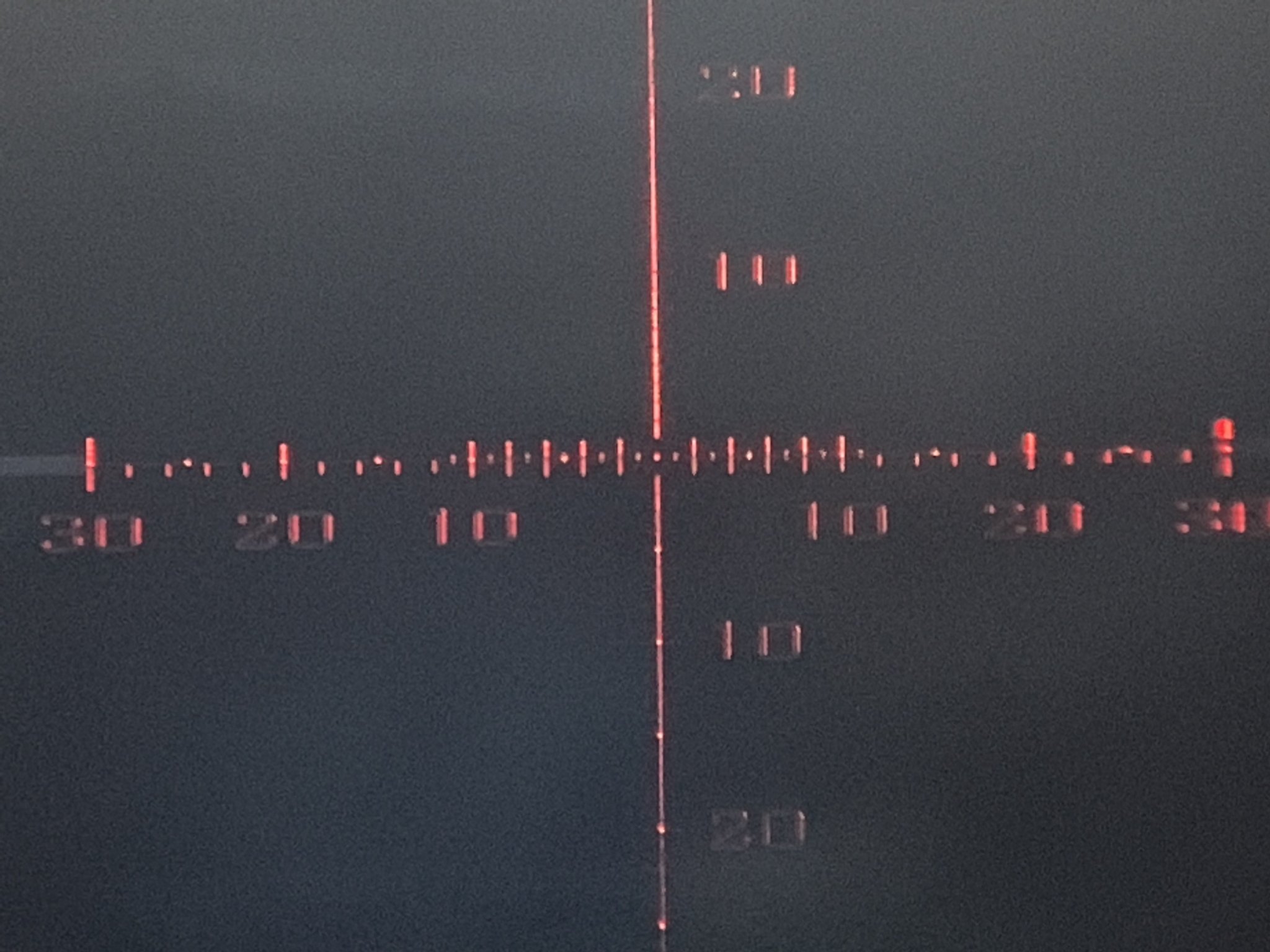

Hi everyone. I'd like to ask if anyone have experienced this on their FDN 17X. Purchased my scope just a day ago and I noticed the illumination
function on the scope is quite funky. I have not seen anything like this on other scopes I have used before. At the lowest magnification. The illumination lights up the entire view circle and made the scope pretty much unusable. To by pass this problem. I have to increase the magnification past 5x. And even then, I still notice the red glow in the view. The reticle I chose is the IGR kind. Is this normal? Should I send back for repair? Thank you in advance for everyone's insights.

Yeah. That’s not normal. It needs to go back.
Thank you for your input. I will contact the seller tomorrow and see if they can arrange for return and refund since I just bought this practically 2 days ago. I have a feeling they will blame it on the manufacture defect and defers to US Optics for it. If push comes to shoves. I will call US Optics and have them look at it. Thanks again. Happy New Year everyone.

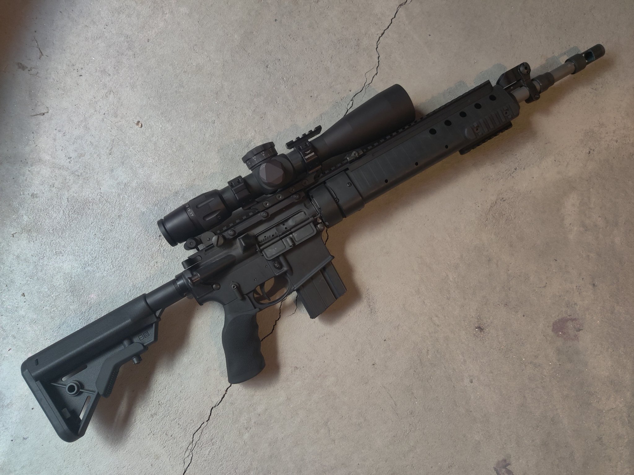

Since the the thread has been resurrected - I've got a 17x on my MK12 pseudo clone. I'll say that the eyebox/eye relief on the 17x is a bit easier than on the 25x, and that the reticle (JVCR) is a smidge thicker to compensate for shooting at lower power vs the 25x. Mirrors what a lot of other guys have said. No CA, clear picture, no weird distortions at low power, turrets aren't loud or "ratchety" and could be mistaken by some as being mushy, but they are tactile and very useable.
Mag ring is smooth and easy to turn, parallax knob is very easy to turn. I like how matte the finish is. FOV on the the FDN is legitimately huge. I've heard people complain about the eyebox, especially before they mount it, and this is true. The eyebox is tight. Generally speaking, you can have a loose eye relief and a small field of view, or you can have a tight eye relief and and a narrow FOV with easier to induce CA or possibly even parallax? Focal lengths are a thing, it's physics. There is far more to good optical design than a large eyebox. Your first impression may be kind of meh when you pull it out of the box, but once it's on your rifle, it just works.

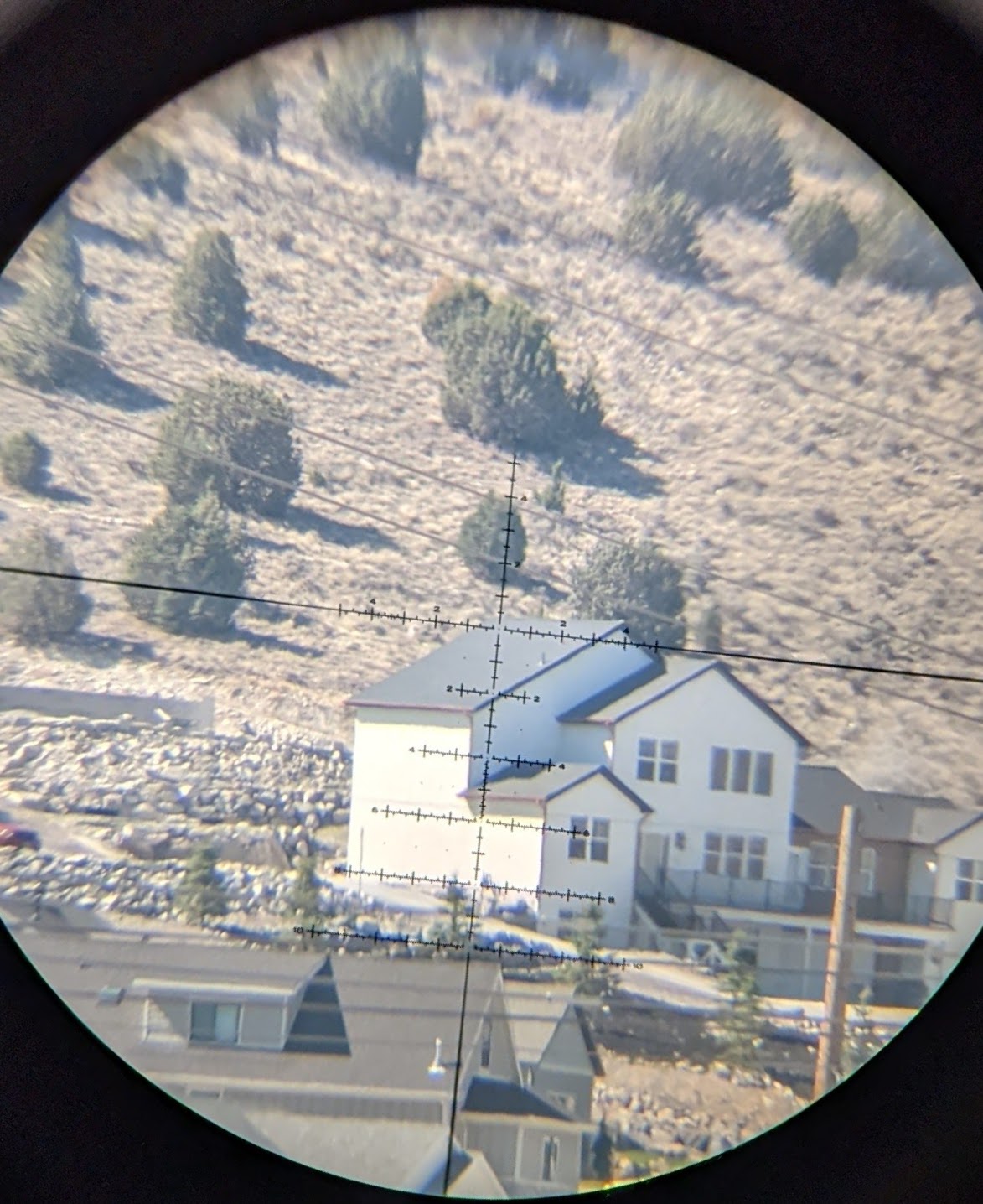

Finally, since pics were encouraged:
And my 25x:
(image looks a lot better with your naked eye. Phone pics through the scope suck)
