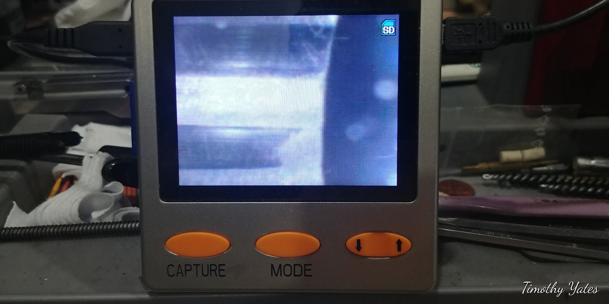

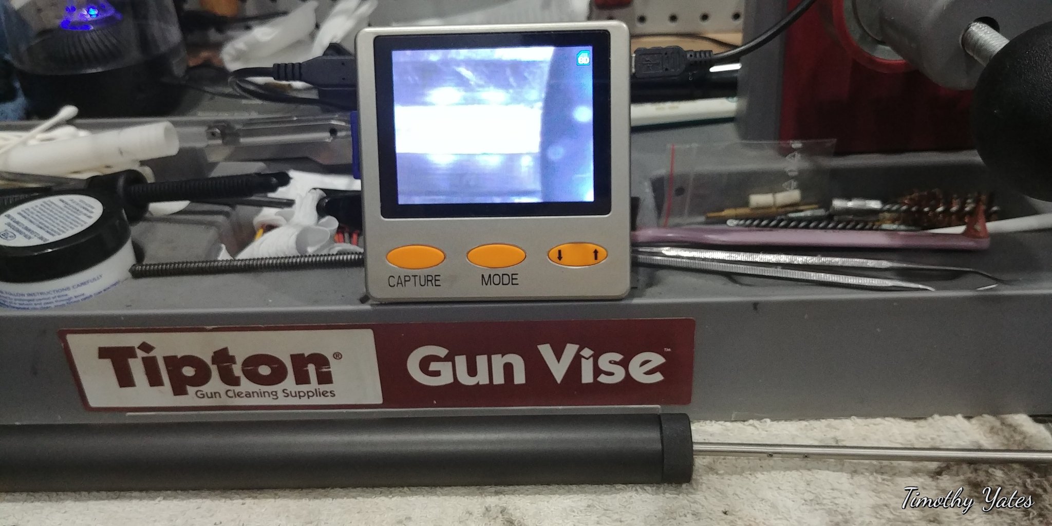

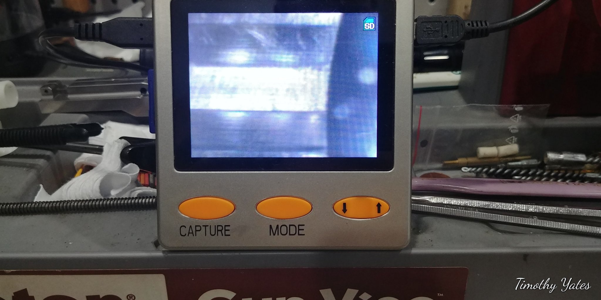

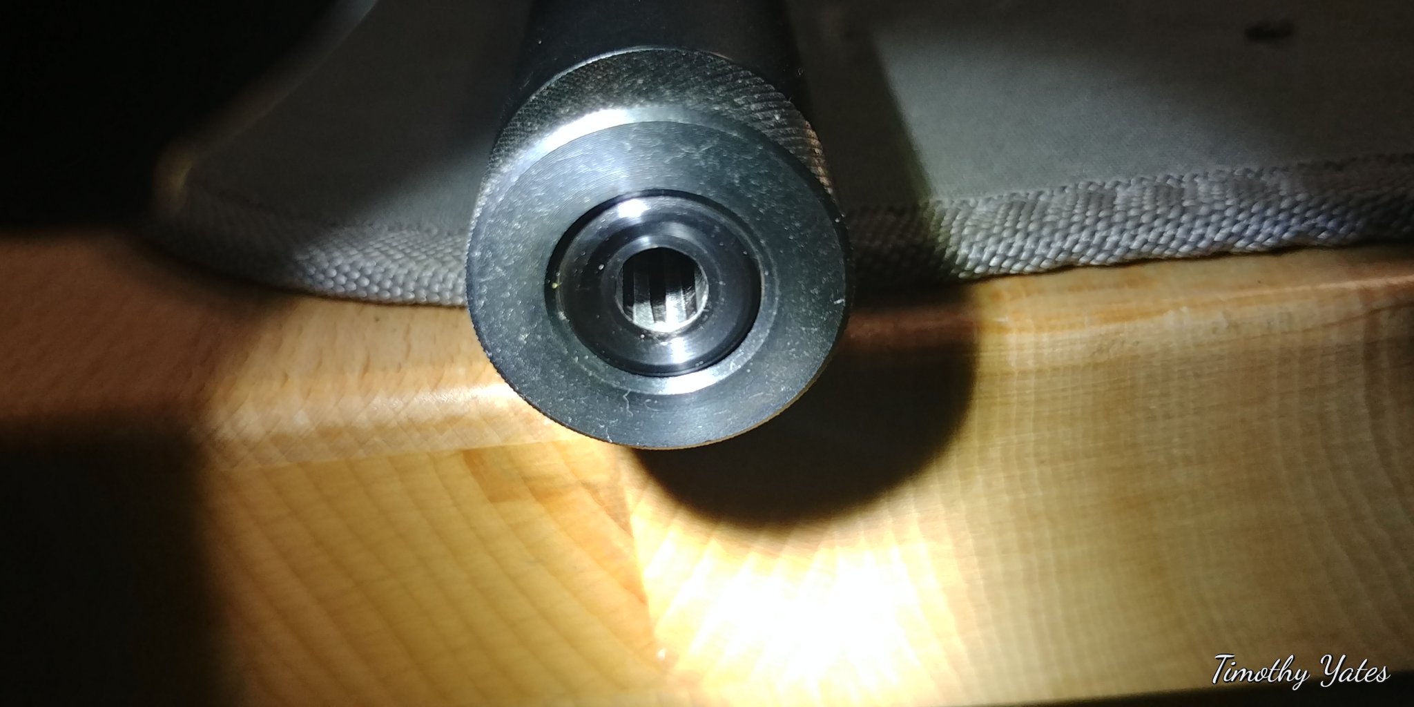

    Well, don't know how many of you visit the crappy, clique member sight RFC but over there I posted about a Fedderson barrel I had that wouldn't shoot and had burrs at the beginning of the rifling. I'll post those photos here later on. I received a replacement barrel today and one of the rifling grooves doesn't extend to the end of the crown. Got photos of that too. I went ahead and mounted the barrel and plan on shooting it in a few minutes.
    Everyone is going to make something bad every once in awhile. But in this case, I would have bet the house the replacement barrel would have been perfect in every way. In the quality world we call this an "escape", escapes are the worst thing that can happen to a company. Having it happen to me twice is really really bad for Fedderson. Hopefully the barrel will shoot good, even if it does it doesn't excuse Fedderson for the lack of their quality control.
    That would be enough for me to ask for a fulll refund and buy a Shilen.
    I was so aggravated yesterday I didn't feel like posting anything. Today I have had a migraine headache all day and just now getting over that. To keep things separate I will post the first barrel photos in this reply. For anyone's information or curiosity this barrel with defects at the beginning on the lands shot the best of the two. On this first barrel every one of the lands were rolled over. The last photo looks different because it was taken with the bore scope rod inserted from the muzzle end. If for some reason someone can't see or recognize the burrs let me know. "Not saying anyone is here" but a couple of idiots on "the cunt" forum aka RFC said they couldn't see the rolled over edges. In reality the idiots were just trying to be dickheads, which they are anyway because they are part of they clique over there.
    Reactions: 6gunner

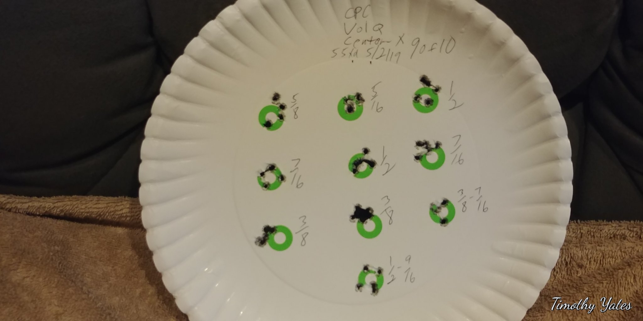

    I have a Volquartsen barrel reworked by CPC. It finally shoots good. I wanted another one just to compare, boy have I experienced that. Here is the Volq and what I can get out of it. Most definitely prefers Lapua ammo.

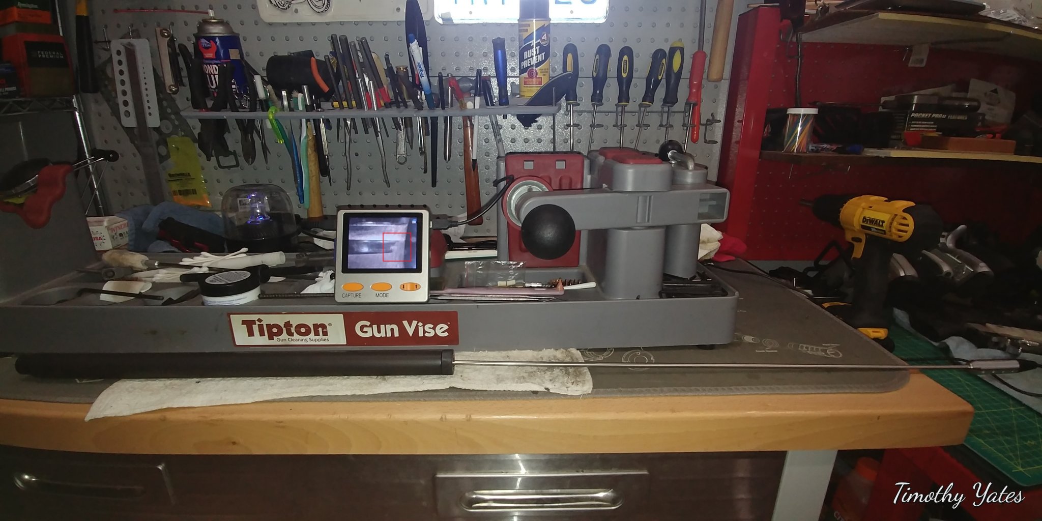

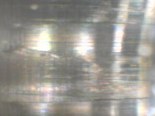

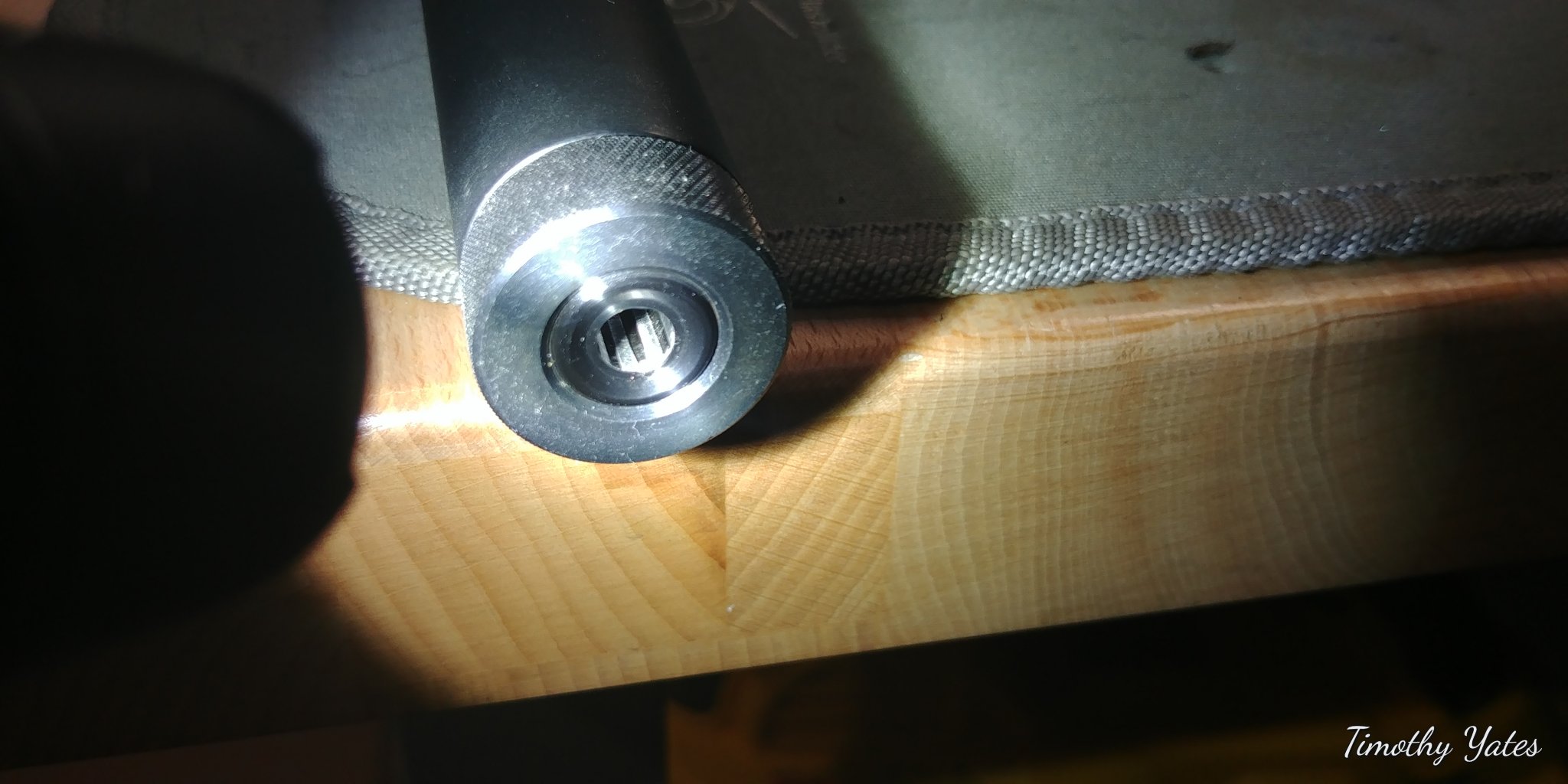

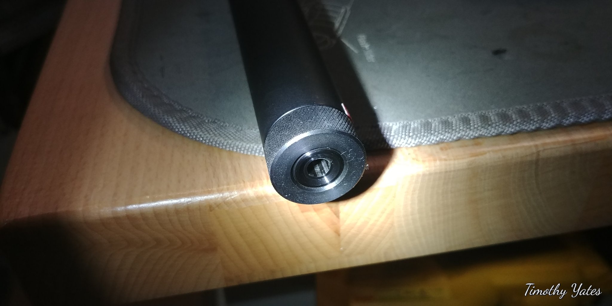

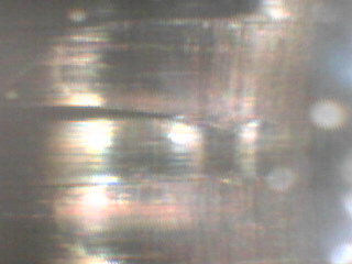

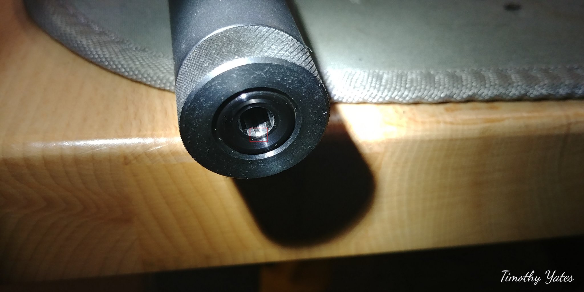

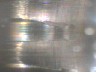

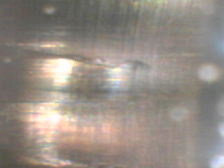

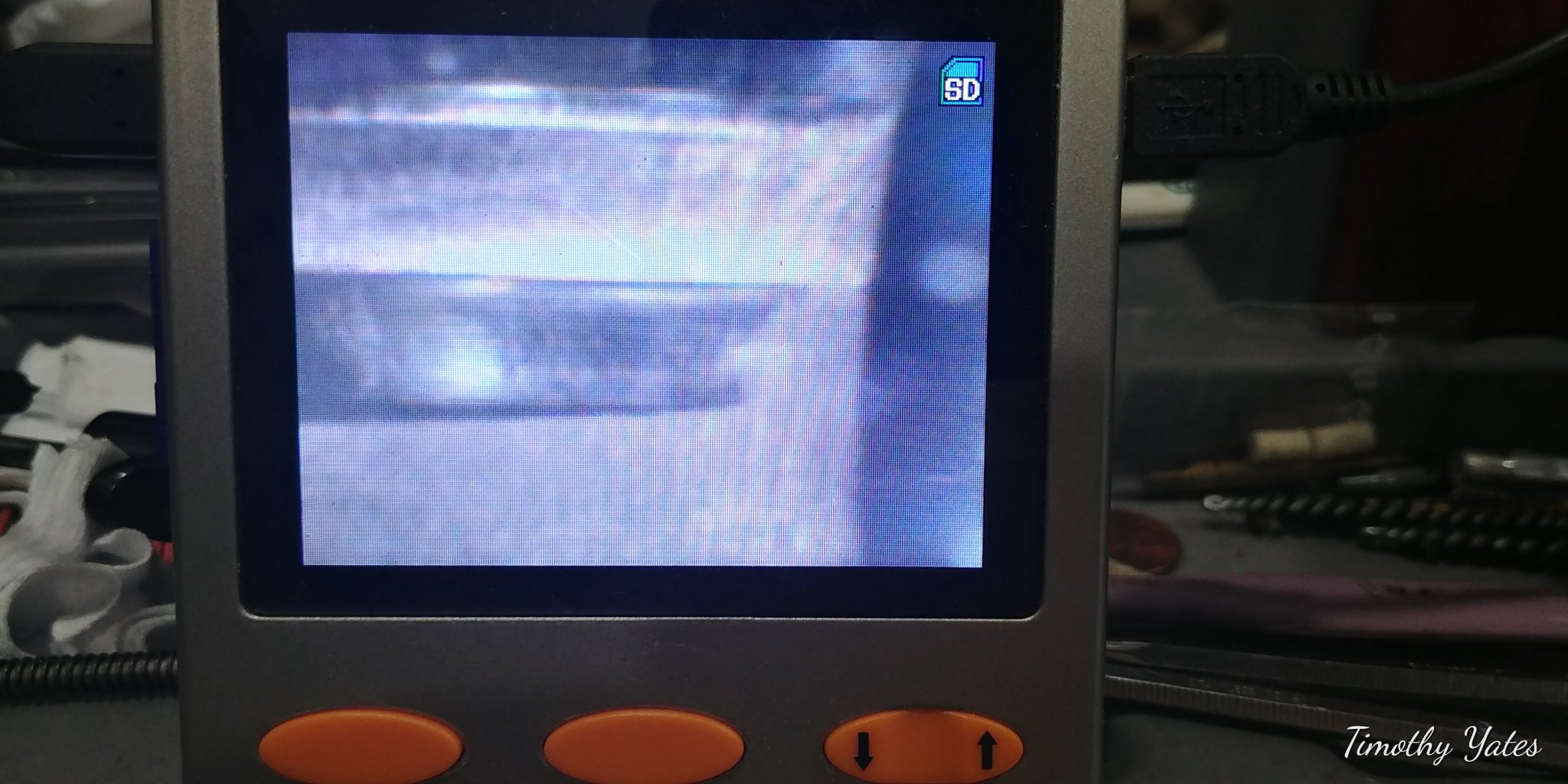

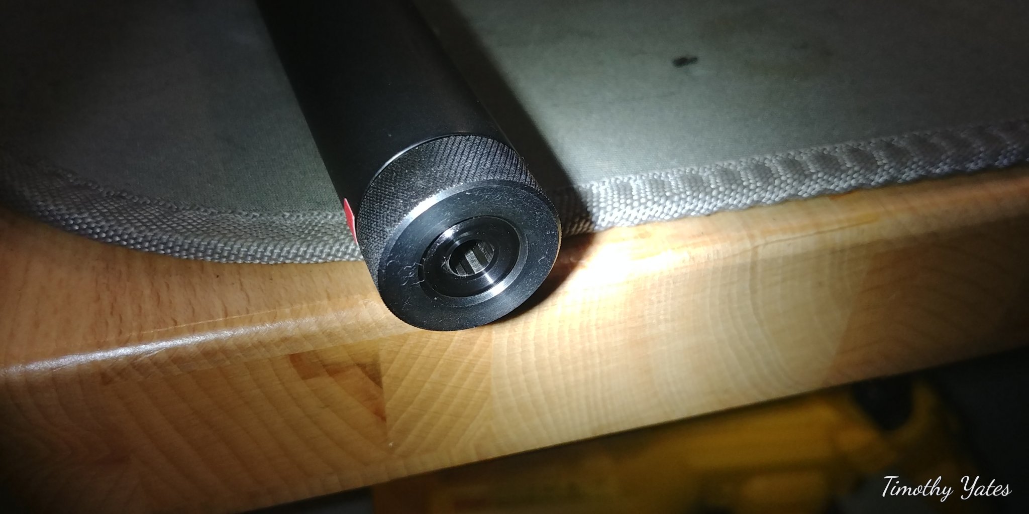

    Ok, here is the second Fedderson barrel. The issue is the crown is screwed because on of the grooves does not make it to the end. The grooves are the black lines, These are the deep lines. If a photo has a dark/black line going to the end then it's a good groove. The others that omit a reflection or blend in with the "lands" is the single groove that didn't make it to the end. Eley Match shot the best "FWIW" with six out of ten 5-shot groups at .5" or under. I do believe Fedderson can make a great barrel. I just seem to be really unlucky at getting a good one from them. I will ask for one more replacement and request a return label again. If I have to pay return shipping I'll just get a refund. I like the black finish and the fitment in the receiver has been really good with both barrels.
    Here are the photos. The very first photo should be enough but I'll show more. FD02, FD03 show the bad area. FD04, FD05 show what a good area looks like. The rest are named.

    I really believe this barrel could have outshot the Volquartsen barrel if it didn't have this defect. I will request one more barrel and tell them (shouldn't have too) that someone needs to inspect the bore from one end to the other and it has to be perfect in every respect. It still amazes me I would get a defective barrel on the second one too.

    Well, I contacted Fedderson this morning around 10 am. I have not received a reply from them. Not good. If no reply tomorrow I'll send them an email telling them I"ll pay for return shipping just give me a refund.
    If you emailed Fred direct, I would be surprised if you get an answer as he gets a massive amount of email daily.
    Call Feddersen via phone at 865-408-1545 or 800-726-7388. You'll likely end up speaking with Sandra initially. Ask her to speak to Fred about the "bad barrel" thread on Sniper's Hide.
    I emailed Sandra. I guess I'll have to call. Here it is after 11 am and still no reply from anyone at Fedderson. I'll probably call today around 2-3 pm just to give them enough time to answer.
    Reactions: 6gunner
    Spoke with Sandra and Bill at Fedderson yesterday. We had a lengthy discussion about "this, that and the other" that I won't go into detail about. It was a good conversation and Bill was pleasant to talk with. He said I would be getting a hand select barrel that would be shot first to verify accuracy. I shipped the old barrel back yesterday after receiving my return label. At the end of the conversation Bill said I would get the barrel at no charge. He said as much trouble as I have had and still have the patience I had, I would get the barrel free. I have already received credit on my CC. This is good example of how a company should respond. Very much looking forward to getting this barrel.
    Glad to see Feddersen took care of you. From everthing I've read in the past, I expected they would make it right.

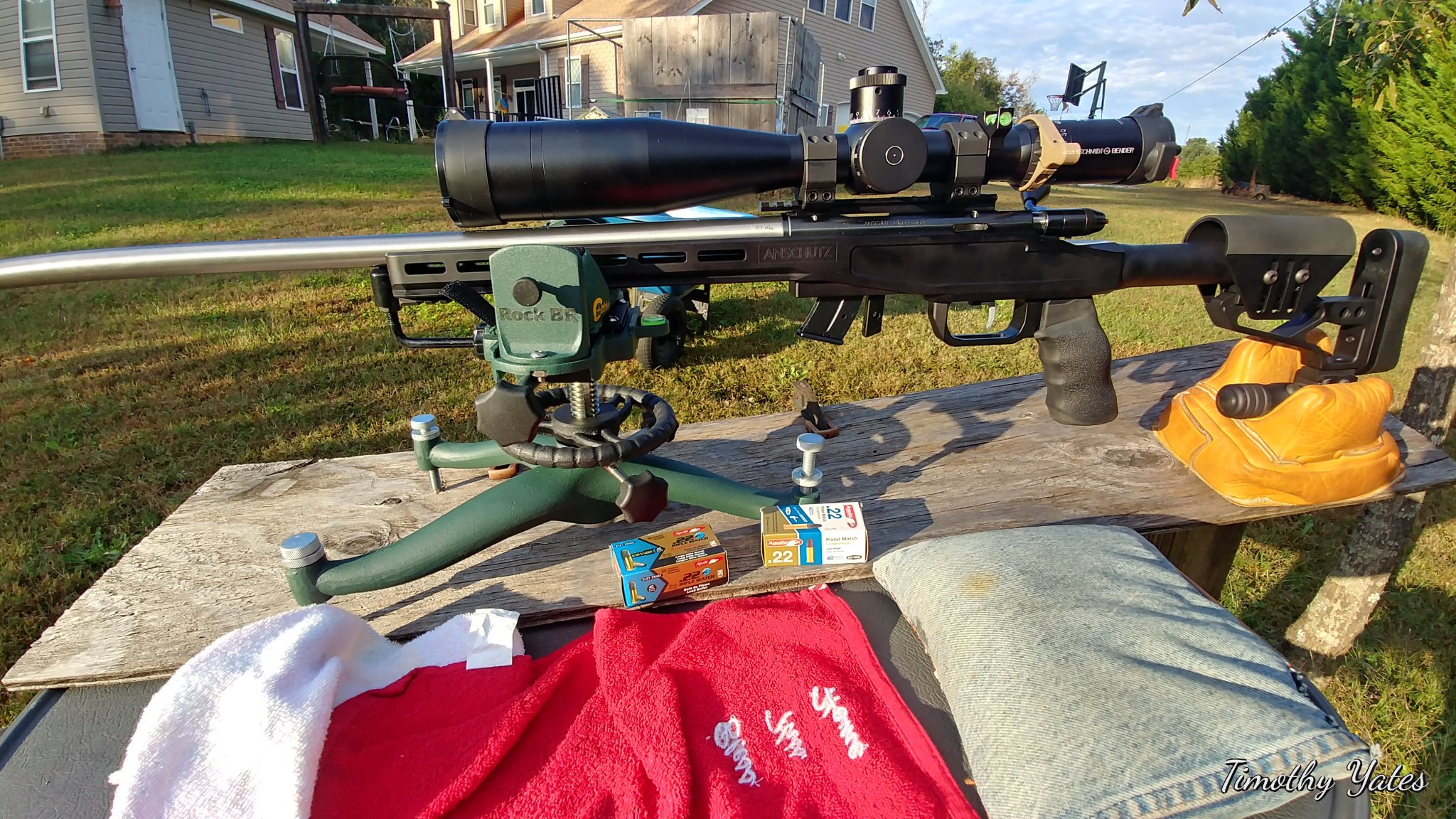

    Got the new barrel in today. Inspection looked good this time. Rifle is ready to go, hopefully I can start shooting in an hour or so if the rain don't start.
    Well, if it's free can you still complain? I think not. I didn't want to say anything at first but the shank on this barrel was so loose it slipped in the receiver without much resistance at all. Not sure if that was the cause but this 3rd and final barrel is no more accurate than the first two. I have another 10/22 still NIB. (Hard to pass one of for $150) I may get it out and try it and see if the barrel has a better fit. (I don't even know if that's the issue) I just wish I had all the money back I shot up.
    I would still recommend Fedderson. Why you ask? Because they did the best they could and treated me right every step along the way. Would I buy from them again, probably not but that doesn't mean anyone else shouldn't. As far as I'm concerned their customer service can't be beat.
    Reactions: Rover31
    My 2 Fedderson barrels are very accurate barrels. Both of them slipped into the Kidd receivers and a T/CR22 receiver with only minimal resistance. I have to wonder could the accuracy issue you are having be something else? For example is the barrel free floated? Is the barrel a bull or contoured barrel? Both of mine are stainless bull barrels.

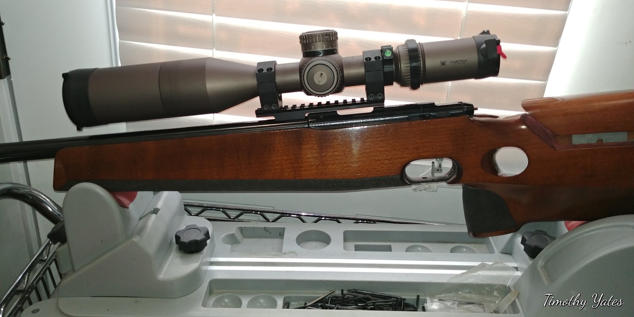

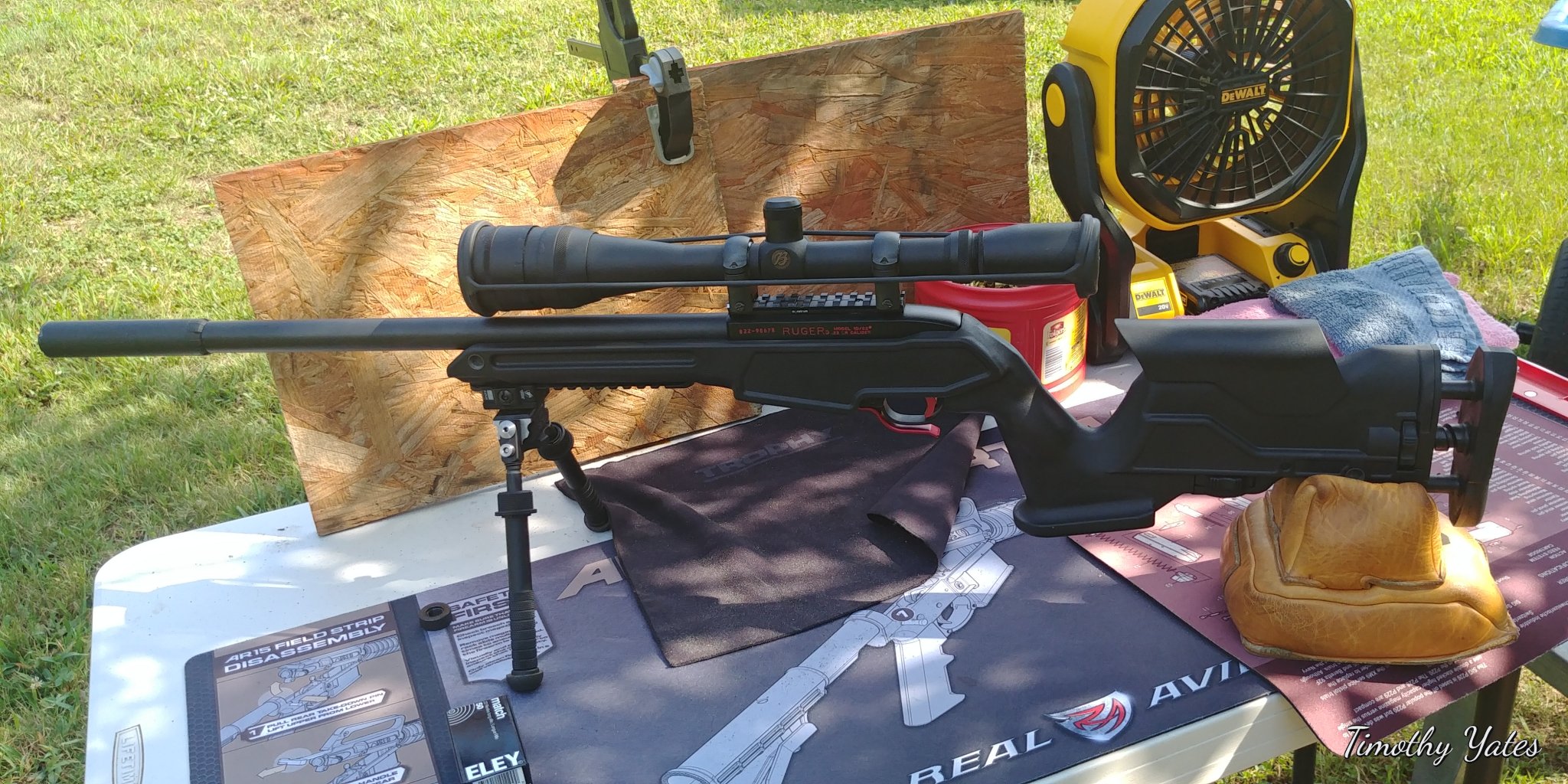

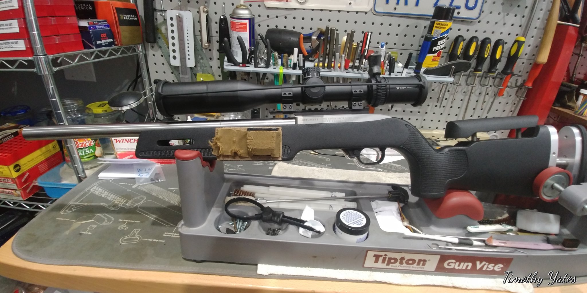

    The barrel is floated, it's in an Archangel stock. That just reminded me the Archangel comes with a pressure pad you can insert at various points. I will try that and see if helps. The barrel is the 16.5" threaded bull barrel. I wouldn't rule out operator error but in all honesty the shots look and feel good, if not I make a note on the target. For now the Volquartsen barrel is more accurate with the best vs. best ammo and more accurate with a variety of ammo.
    Well, I'm no 10/22 master, lol hell I'm no master at anything as far as that goes, so if someone/anyone has an idea to try please present it. Just don't ask me to shoot $15/box Eley Tenex Pistol until it starts shooting good. This was a suggestion by a clique member on RFC. Another clique member said that shooting the rifle more would smooth over the burrs I had in the first barrel. That's the kind of crap suggestions you get on RFC. Burrs can be seen above in Post #4.
    Here is a photo taken the last day it was shot.
    My 10-22 is nothing more than a Ruger receiver in a Boyd's Pro Varmint stock with all other parts being Kidd (including barrel). It shoots very well but hardly comes out of the safe. My Vudoo has gotten all my attention lately but I did take the home-built CZ455, wearing one of the last Fedderson barrels made, out to see if I could find one type ammo that would shoot equally well in either. It was quite a success as I found both guns to shoot Eley Club and Wolf Match Target Extra extremely well and, as a bonus, to same POI at 50 yards. Having spoken to Sandra and to Bill at length before ordering that barrel, I can say nothing but good things about them. Quality and accuracy are why the company is there and seeing how he treated your issue makes that even more apparent.

    Unless you've done a lot of sanding, the Archangel AAP1022 stock itself is a pressure point. I bought one and the receiver had to be pounded into the stock with a rubber mallet. Hell, you couldn't remove the mag without a lot of work. It's sitting in a junk box waiting to be disposed of at this point.
    <end rant>
    If you haven't already, try the barrel without the suppressor. It might be doing something with the harmonics of the barrel. I'd burn up some "expensive" ammo seeing if it got better with more rounds through it; Use CCI SV (well, it is more expensive than Golden Bullets). If nothing else, you can have some fun experimenting.

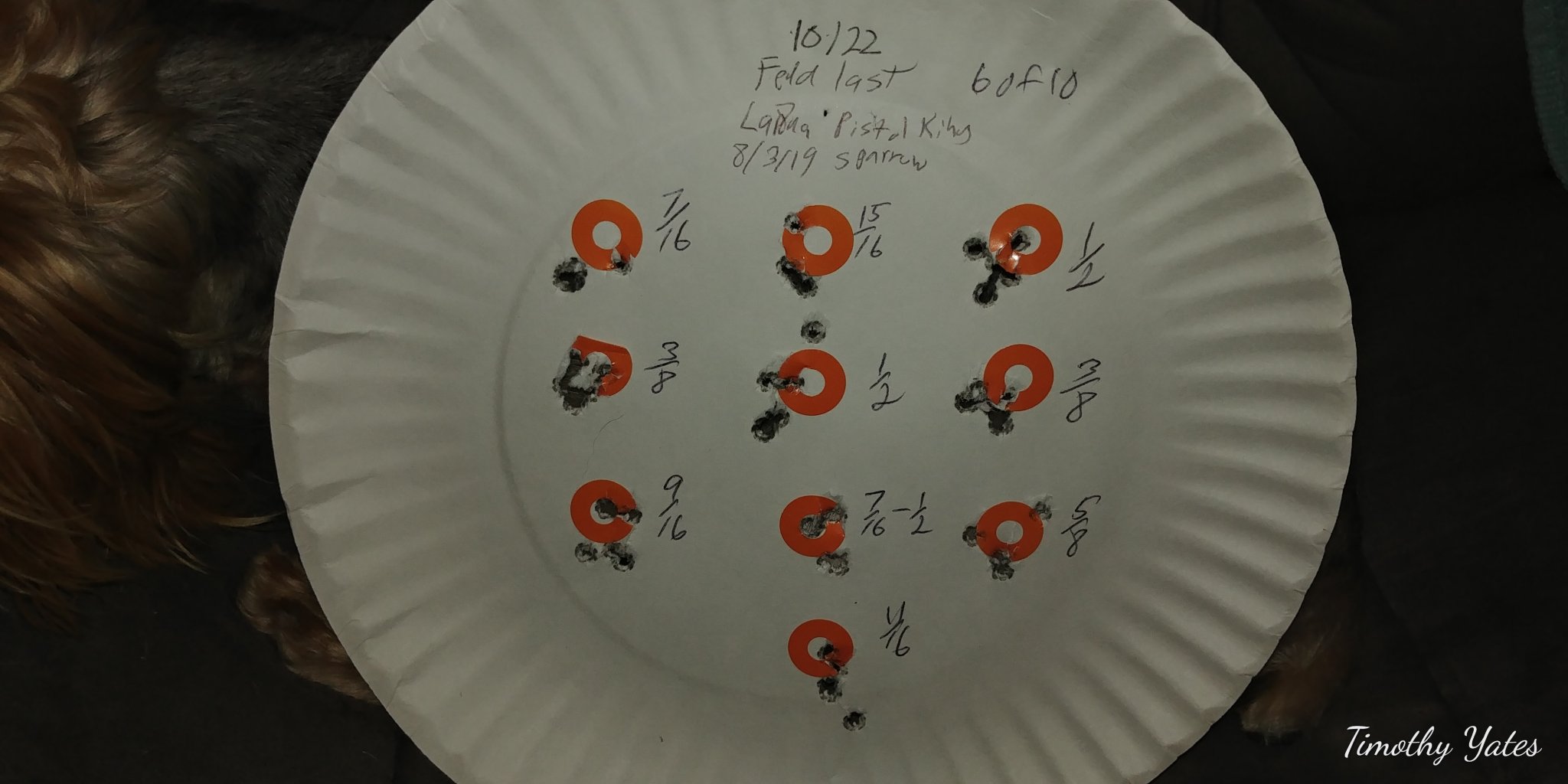

    Here are the two best targets, one suppressed and one not.
    IDK, maybe 10/22's are not my forte.

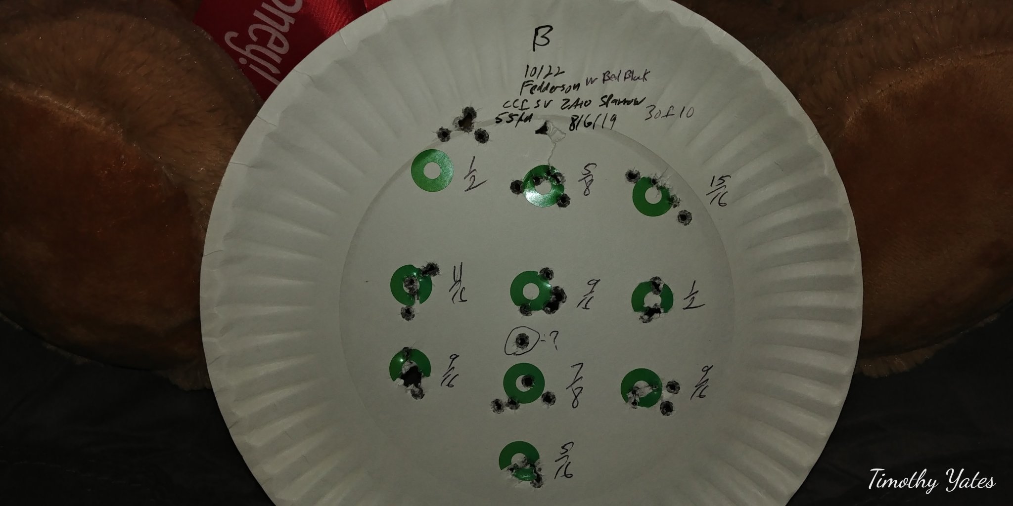

    Below is the same setting and ammo just that I have added the Sparrow suppressor. I want to use the Sparrow whenever possible on everything I shoot. Not really any significant difference in accuracy with or without the Sparrow.

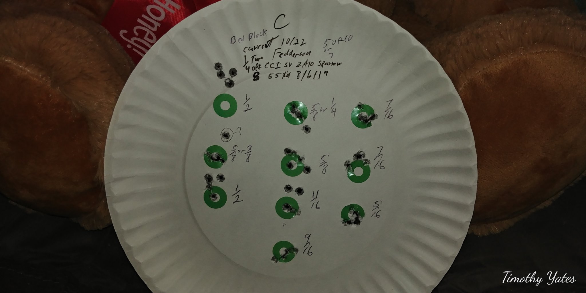

    Next I made only a 1/4 turn on the bedding block screw and reshot, same ammo and Sparrow. At this point I felt I had made an improvement and the flyers could have been the CCI.??

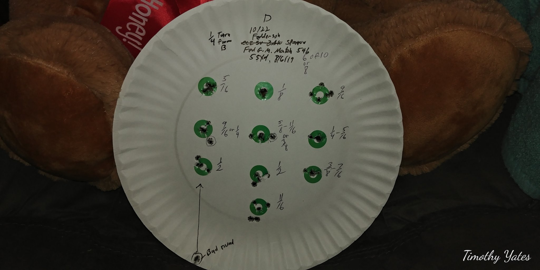

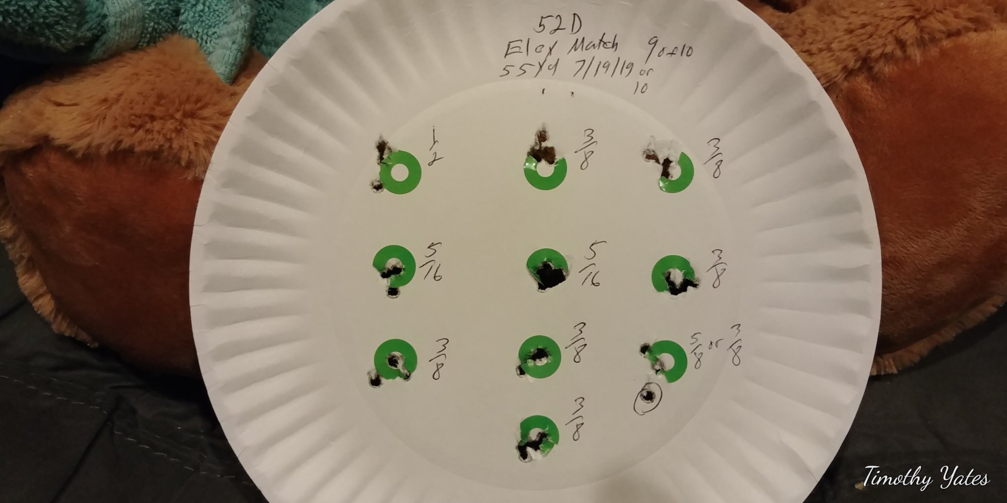

    Next, I wanted to try some known "good" ammo I had already shot. Next target was shot with Fed GM Match.
    Next thing I will try is another 1/4 turn and see what happens. It got dark on me so I quit. I have never really fooled with pressure points I guess because I never had the need to. I sure am glad this Archangel stock come with one. As a side note my Winchester 52D has two bedding screws on both sides of the stock near the end of it. Whoever had it before me has moved the barrel to one side. I never messed with it, just got it and shot it. Here is how it shoots. Of course this is high grade ammo and I will get to that with the Fedderson after trying to find the sweet spot.
