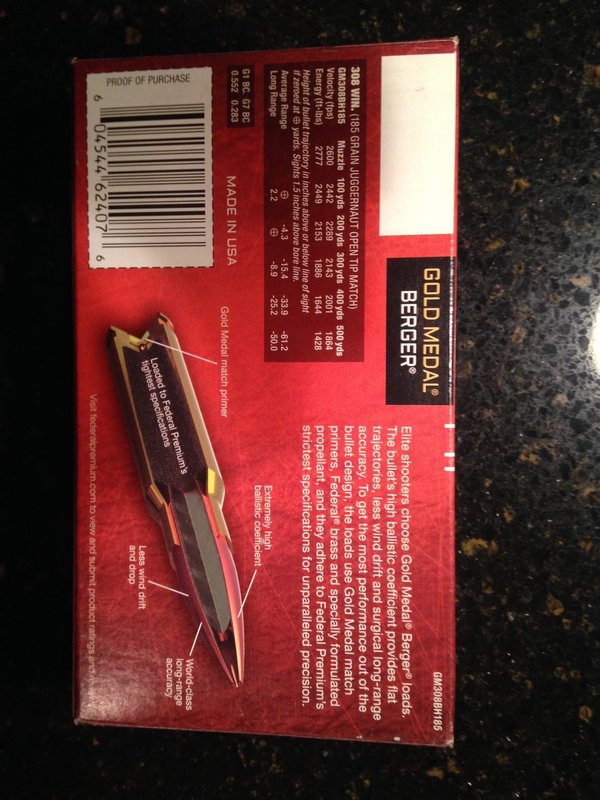

It's a .308 cartridge using 185gr match juggernaut target bullets.
-2600 fps
-2777 muzzle energy
- .552 BC

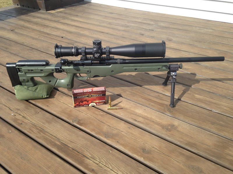

Rifle will be an 20" AIAE with its factory barrel (1:12 twist). Rifle is currently in the low 1300's for round count. Scope is a NF ATACR F1 5-25x56. I checked my 100 yd zero today and it was in the .3's which is where this system typically is with my 175 SMK handloads.
My concern, as always with factory ammo is that most rifles either love it, are ok with it, or hate it. With that being said, I'll give an objective test based on what my rig will do. YMMV. This system has been very much sub 1 MOA solid with several factory loads except one, that being the Black Hills offering with the tipped 175 MK. I suspect some fiddling with seating depth in a handload may have produced different results.
Have to admit, I'm a bit excited to test this stuff. I'll run it at 100, get a baseline, and then take it out to to distance.

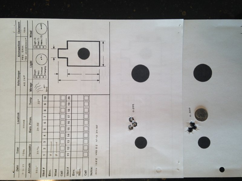

Just a quick preliminary report. UPS delivered with enough time to shoot a couple groups at 100 to establish a good zero. I'm pressed for time, so here are a few quick pics and thoughts.
Shot 2 three shot groups at 100. For honesty sake, I absolutely tanked #2 in the first group, called it, and covered that mess up with a dime. Group 2 was solid. Conditions were noted on the data sheet. Mirage was terrible. Looked like I was shooting through flowing water. With cloud cover I could possibly tighten those up a little. Both though we're in the .3's which is common for this rig. IMG_3250.JPG
I feel this quick outing is promising in my rig. I've made the appropriate adjustments for zero and will take them out to distance hopefully Sunday afternoon.
I'll pass along more details and information (measurements) as time allows. Unfortunately, I have a very busy weekend ahead so I'll do my best with the time I have.

Nice system you got there

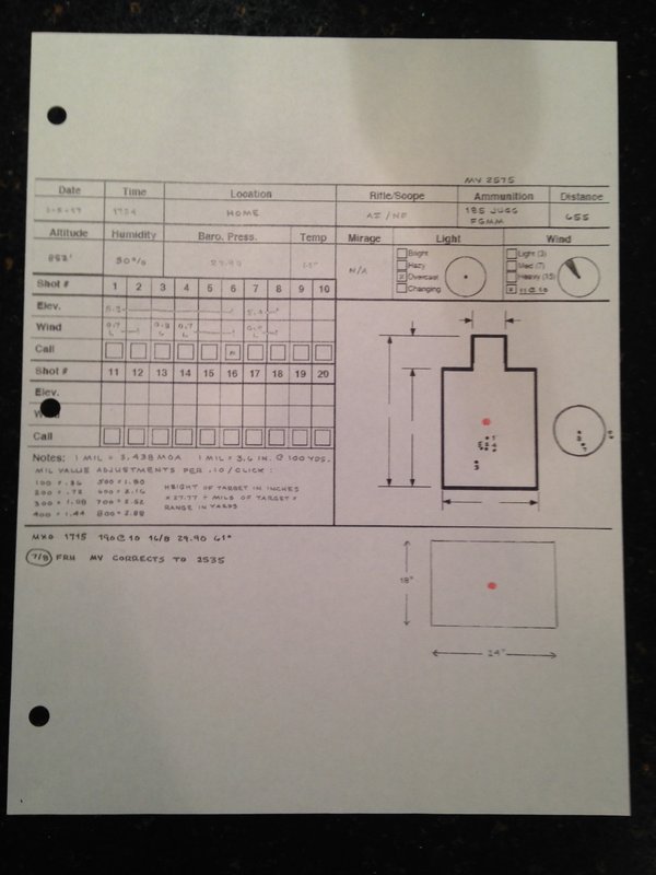

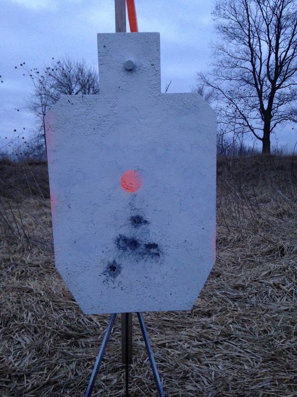

Another quick report. My Sunday commitments allowed just a snibit of time to get this offering beyond 100. Loaded the 185 Jugg numbers into Ballistic AE along with my rifle and zero data. For those that are trying these for the first time, a quick google search gave me a projectile length of 1.353". I took a WAG at the MV and used 2575 fps knowing that at 655 I'd be on steel with that number and true from there. Federal's numbers from the box are shown. I looked quick but didn't see their barrel length, but I'm guessing a 24".
Conditions shown on data sheet. Easy 11 o'clock wind at 10mph. As per the target pic, there was some vertical (could have been me), but measured the 3 on the water line and trued at 2535 fps
Shot 3 more at a 10" plate to the left of target in pic with new come up based on the trued MV. Did have a miss (shot #6), just off the right edge. Other 2 centered up nicely.
Some quick notes/thoughts. Recoil impulse was just a touch more than my standard 175 SMK load doing 2590 fps. Primers were a bit flat, but bolt lift was "normal". Under today's conditions, the 185 Jugg would go transonic at 1120 yards, my 175 SMK load, transonic at 994 yards.
I plan plan on taking these on out to 1K soon as time allows. Should be able to test more this Tuesday, but "wind" is in the forecast, and in our neck of the woods means 20-30 mph, not the best, but we'll wait and see. Hopefully between now and then I'll pull a bullet and get some measurement data for you guys.

I shot at 1310 lcl today. Was 3/6 with a first round hit at 695 yards. Wind 12:30-1:30 at 28-29 mph, gusts to 40 mph. With a low hit percentage like that, I didn't go further out. I'm down to 19 rounds so I'll try again tomorrow with less wind. That kind of wind buffets the gun and shooter enough that being fair and objective is a stretch. I have a case of these on back order through Midway. Supposed be shipped a week from today.
I did get out to a 1K this morning with the 185 Juggs. As always, I was a bit pressed for time. I put a few on steel at 765 to verify my MV, which slowed a bit more :-( , then went 3/4 at 1K. I was just off the left side on #1, then followed with 3 impacts. Target was a basic 18"x24" rectangle. With today's conditions, I was into the transonic at 1K, but not by much.
