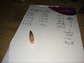

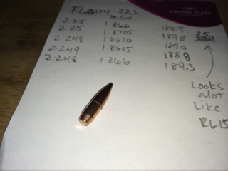

Hi I'm new to the forum, (registration anyway) but have been following for awhile. I pulled a bullet the other day to try and dupe some FGMM 69SMK and noted the following. I know the total weight of the cartridge means nothing, but didn't feel like pulling all the rounds observed: see more at the end
COAL OGIVE TOTAL WEIGHT OF ROUND POWDER CHARGE
2.25 1.866 188.9g
2.25 1.8705 189.8g 25.0g
2.248 1.8620 189.0g
2.249 1.8605 188.8g
2.248 1.866 189.3g

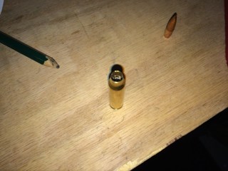

I will attach some pics, but the powder looks just like RE15 but slightly shorter cut. (i know it means nothing) but looking at Lees Reloading book, this powder and bullet weight shows 25.5g as a max load, and the load I pulled was 25.0g. Amazing amount of crimp they place on the bullets too. Not like a Lee FCD, that is very cannelure, this crimp totally crimps the whole bullet that is in the neck of the case. Look at the deformation. I almost broke the kinetic bullet puller slamming this thing out. Surprising to me it does not affect accuracy....or maybe it does?????
LOT V33 W542 in case anyone cares...it's probably 2 years old..pre-ammogeddon
I've shot this load before out of a 16 inch RRA rifle, with excellent results of 8208 XBR, but at lighter loads and only about 2450 FPS....not enough for a longer range 223 round accommodating a 1:9 twist....so want to push it up. Headed to the "range" in a few days with 5 FGMM, 5 8208 23.8g, and 5 RE15 25g..all with 2.25 COAL, 1.867 OGIVE, heavy Lee FCD.....we'll see
pics ImageUploadedByTapatalk1409616734.783500.jpgImageUploadedByTapatalk1409616757.531531.jpgImageUploadedByTapatalk1409616769.382221.jpg
