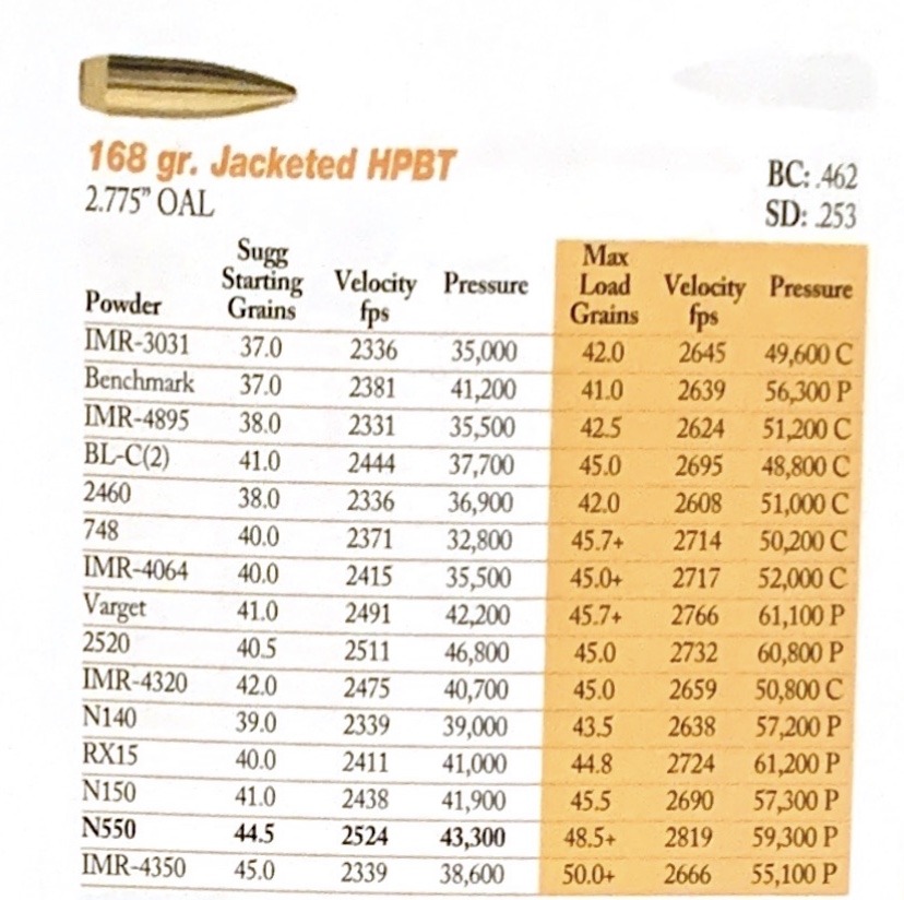

That’s from the Lyman 50th Edition. It shows the OAL of 168 gr BTHP at 2.775 vice the 2.80 that is the book OAL.
I would measure OAL and see if it compares to the 2.775 OAL. I’d do it but I currently do not have any 168’s on the shelf. Just 175/178.
Normally, in my experience factory ammo is very, very close to book data.
