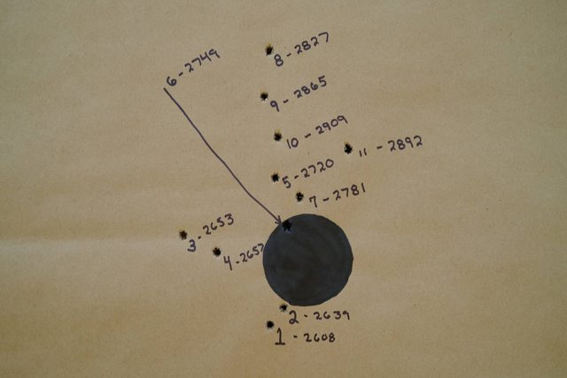

    300 yards, same loads, two "ladder" style targets with velocities marked on targets....
    Target 1
    Target 2
    Individual velocities in notes....

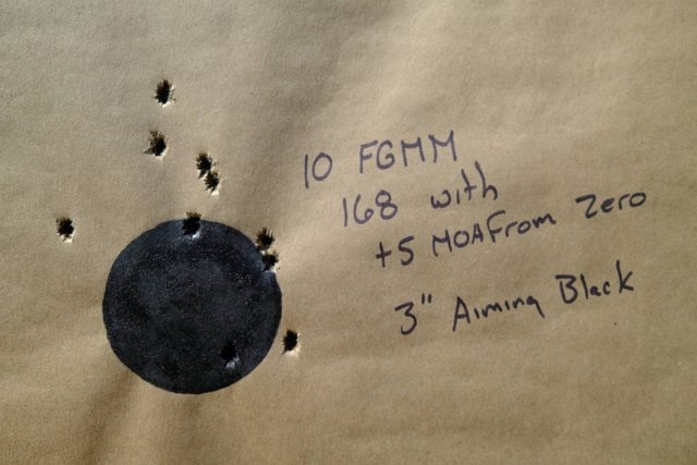

    The 168 grn FGMM target for reference.....

    At 300 getting velocity numbers shots 1-4 are close to MOA and they are in that sweet spot for 175 SMKs velocity wise.

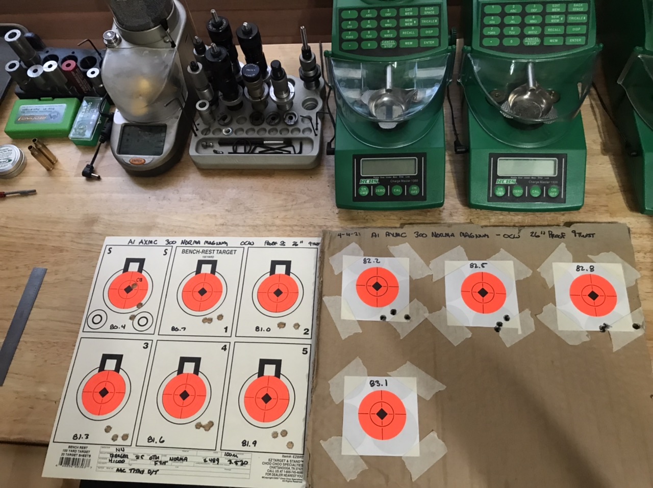

    here is my AXMC 300 Norma OCW using the 215 Berger. Look at 81.9, 82.2 and 82.5. What do they all have in common?
    At this stage of the process I’m only looking for ttheee things: muzzle velocity, impact patterns and pressure. I’m not concerned about group size or sd/es at this initial stage.

    You have consistent POI from 55.5-56.5 and also from 53.5-54 and possibly 54.5 would be in the same dispersion. When over layed the groups would be a little over 1 MOA for the three charge weights. I would run OAL testing @54g or 56g if those didn't show any pressure.

    In that case I’d be looking around 3&4. That’s where she wants to shoot. I’d expand the range by bookending those loads by a tenth or two and splitting them. So five rounds of five different loads total. I’d shoot those 25 rounds round robin and find the middle of the sweet spot. I would verify and tune seating depth using the two closest to the center.
