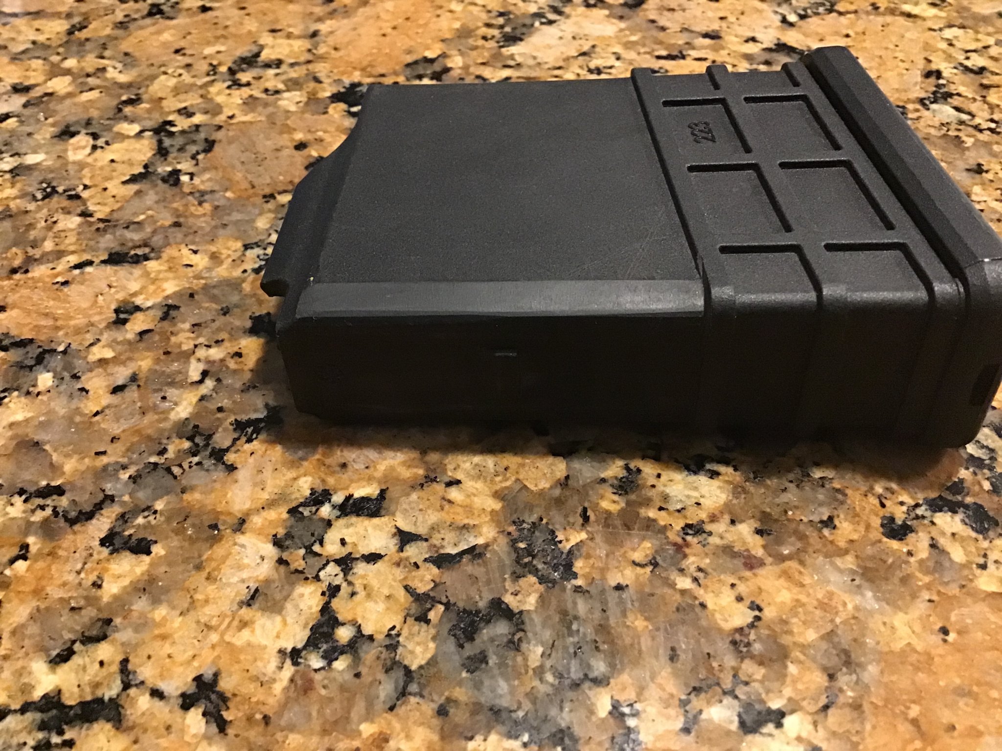

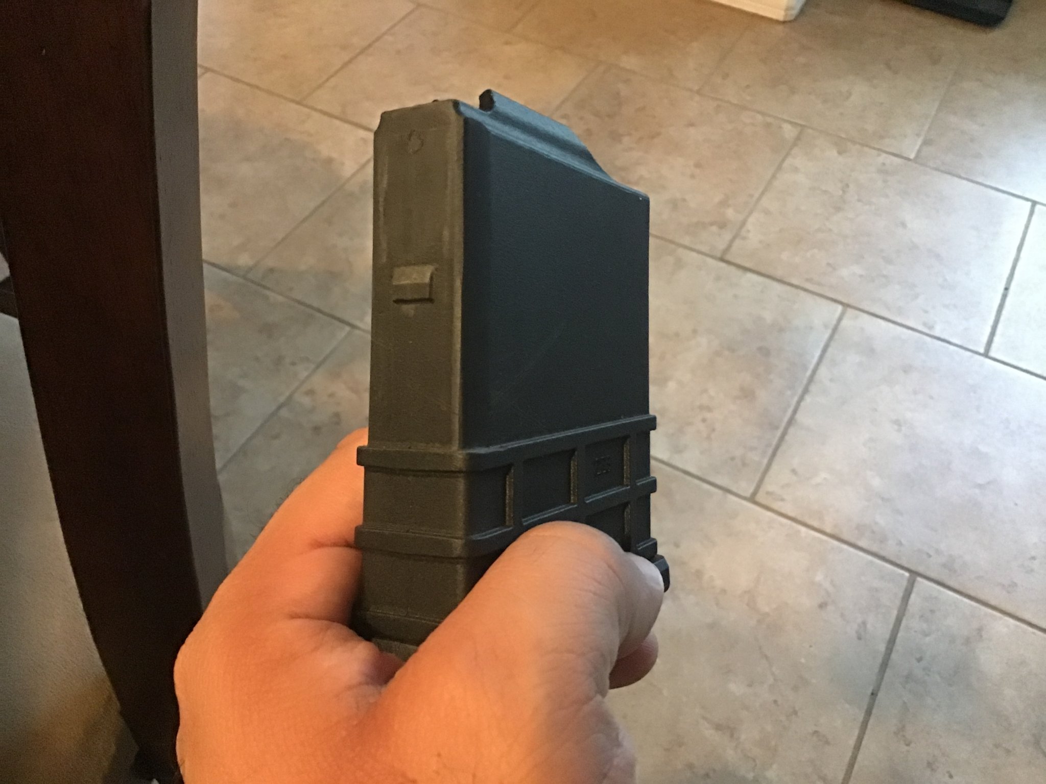

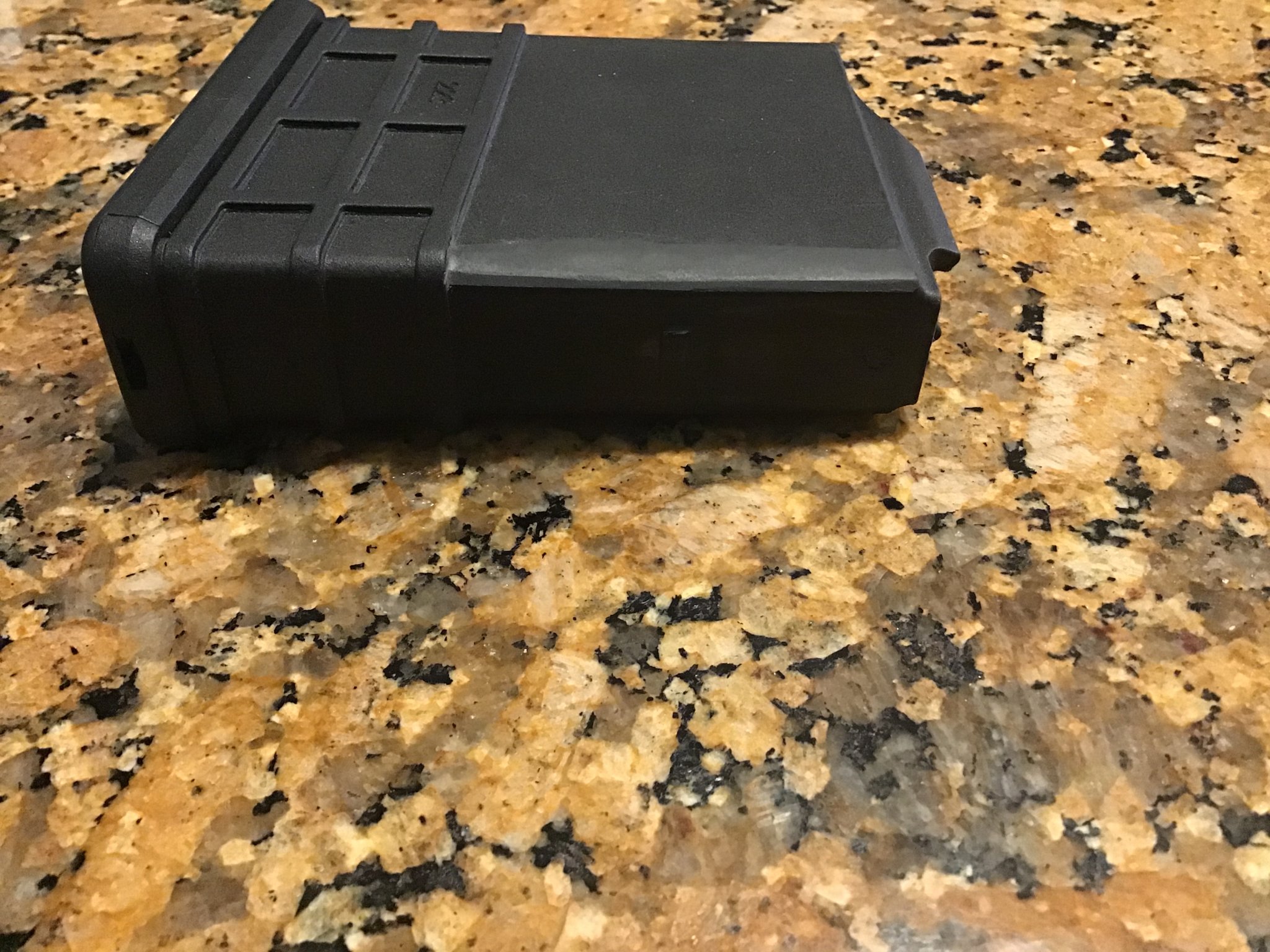

I had problems with my MDT mags and my JAE chassis, was an easy fix. I just took a file to the corners of the rear of the mag and kept removing material till it would fit, took me a little while but it fit perfect. I will see if I can find the magazine I was using, and send you a pic.
edit found magazine, this may help or not but it’s a 223 MDT magazine that was used in my JAE.

Thx for the advice. I'll try to file off a bit more then. Your magazine adjustment looks similar to mine so I shouldn't be that far off.
How did the magazine feed once you made it fit?
