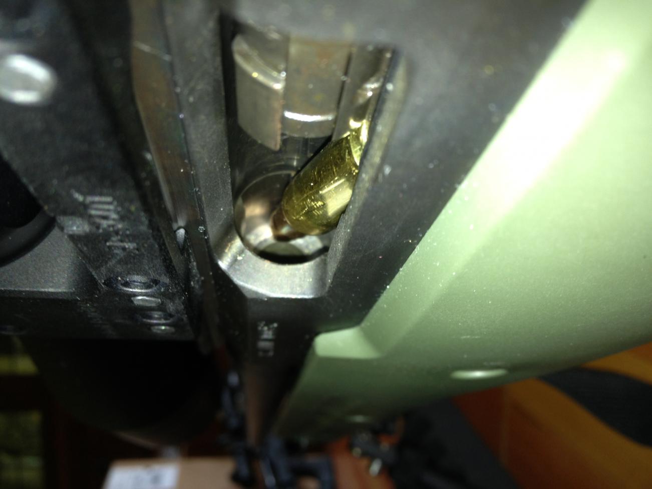

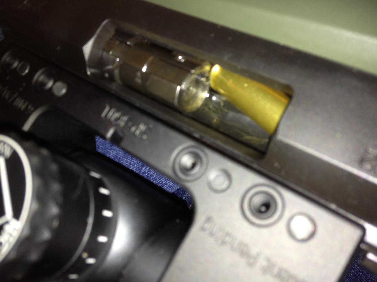

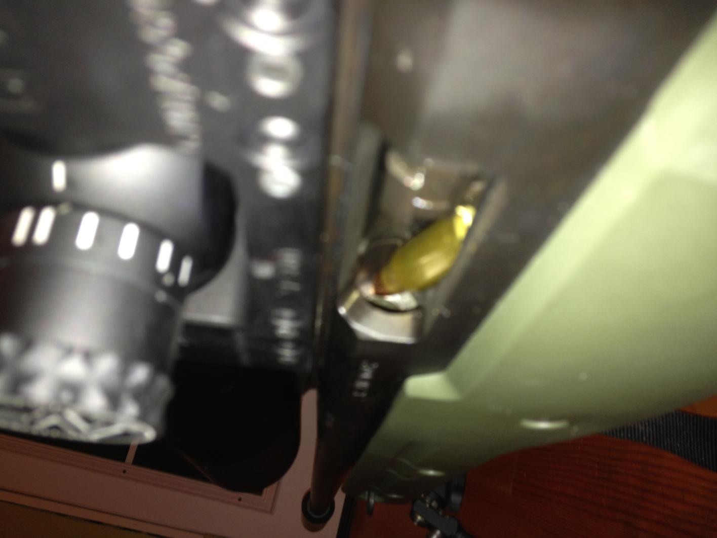

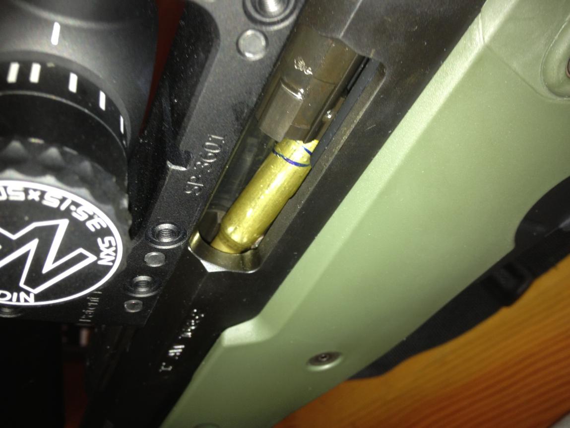

Hello,
I have a new AI Arctic Warfare (left hand) that is jamming quite a bit. Every 20 rounds or so, the tip of the cartridge jams against the intersection of the barrel and receiver as shown in the attached photos. Cartridges are Lapua brass, Sierra 175 SMK, COAL 2.820. I played with the cartridge overall length and the shorter ones jam even worse.
Any idea what's going on? Is this to be expected with the AI rifles?
Thanks....

AI magazine ? Is it random where the jam comes in the stack or is it always last round ?
If You can get another mag,try that. Mabye somting wrong With lips on Yours ??? We have several AW`s. No problemo on any kind of ammo !
Hope You can sort it out. cheers
I had a 5 rounder that also jammed sporadicaly. Bought a 10 rounder and never had a problem with it. Probably a feedlip problem, try a different mag as said above. If it works take out the calipers and see if you can measure the difference between the two mags.
AW only have 10 round double stack magazines, there is no five rounder.
There where a few actions over the years that needed work, GAP can tell you if you don't want to contact AINA. GAP did a lot to fix those old ones, though I never heard of a left hand action doing it.
Try a different mag, and you can also back the bolt off a 1/4" the round will more than likely pop to correct t it's self. The pictures are too blurry to say but appear more mag related it looks like it is pushing the round high.

I have an old 03 springfield and the mouth of the barrel is like a big funnel right to the edge of the receiver. Needless to say it doesn't jam. Surprised that the AI design has such a prominent ledge to allow the cartridge to get caught up on it.
Here are some additional clearer pictures:

The only time I've had a jam like that was from a sticking follower in the AI magazine due to sand that had gotten into it. I would look at the magazine closely. Even pull the follower and make sure it is riding smooth and the lips are not bent. I would also pull a bore snake through the chamber to make sure nothing had gotten onto it.
If you only have one mag, then you can;t blame the rifle yet...
Try another mag... as I said I have never heard of a left hand action having an issue, but that doesn't mean something is off.
Magazines are the weak link in any system,

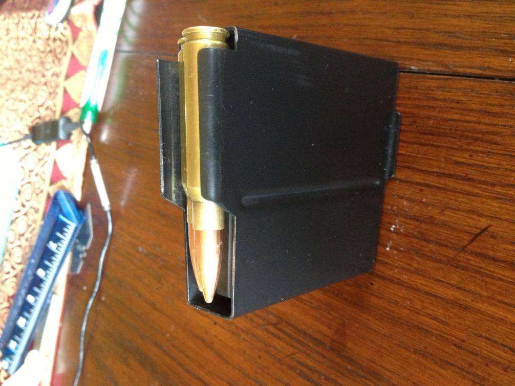

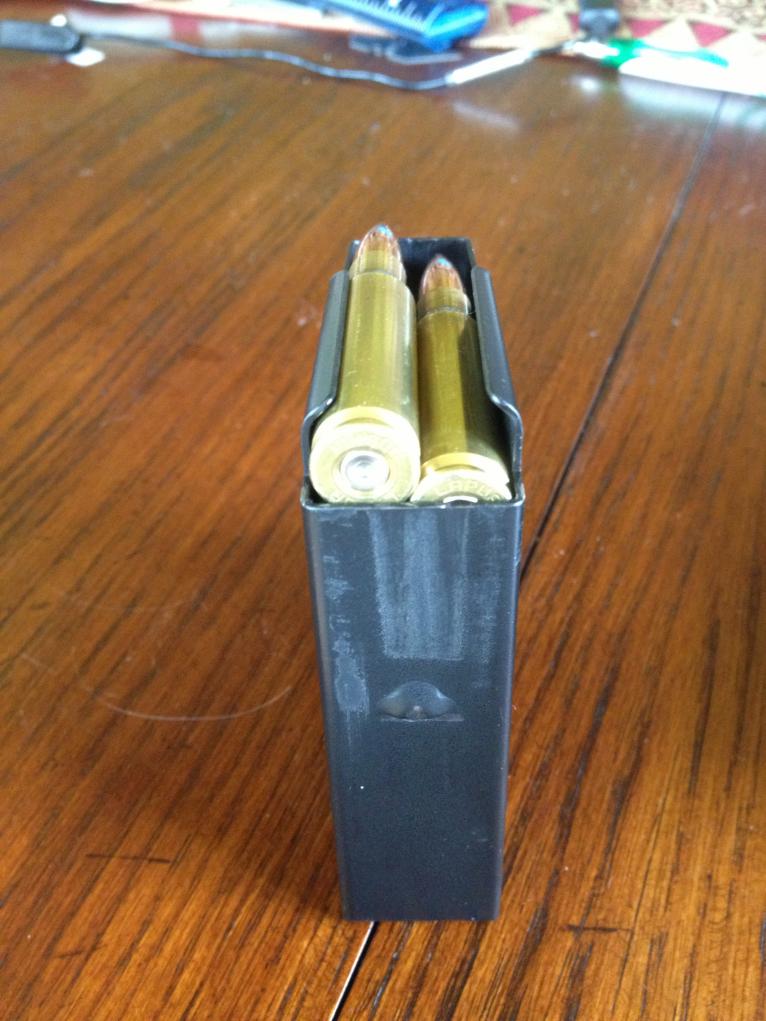

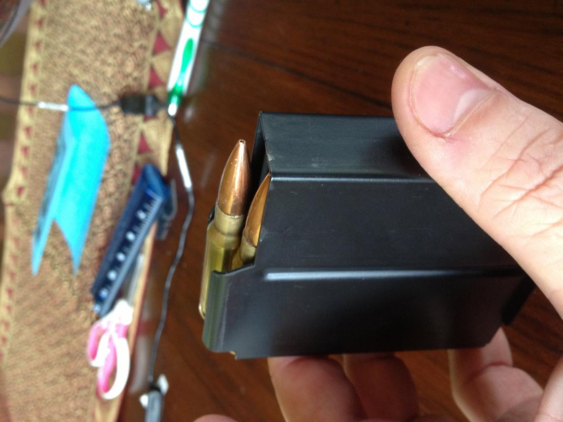

I've also attached a picture of my magazine with dummy rounds inserted. Does anything look wrong?

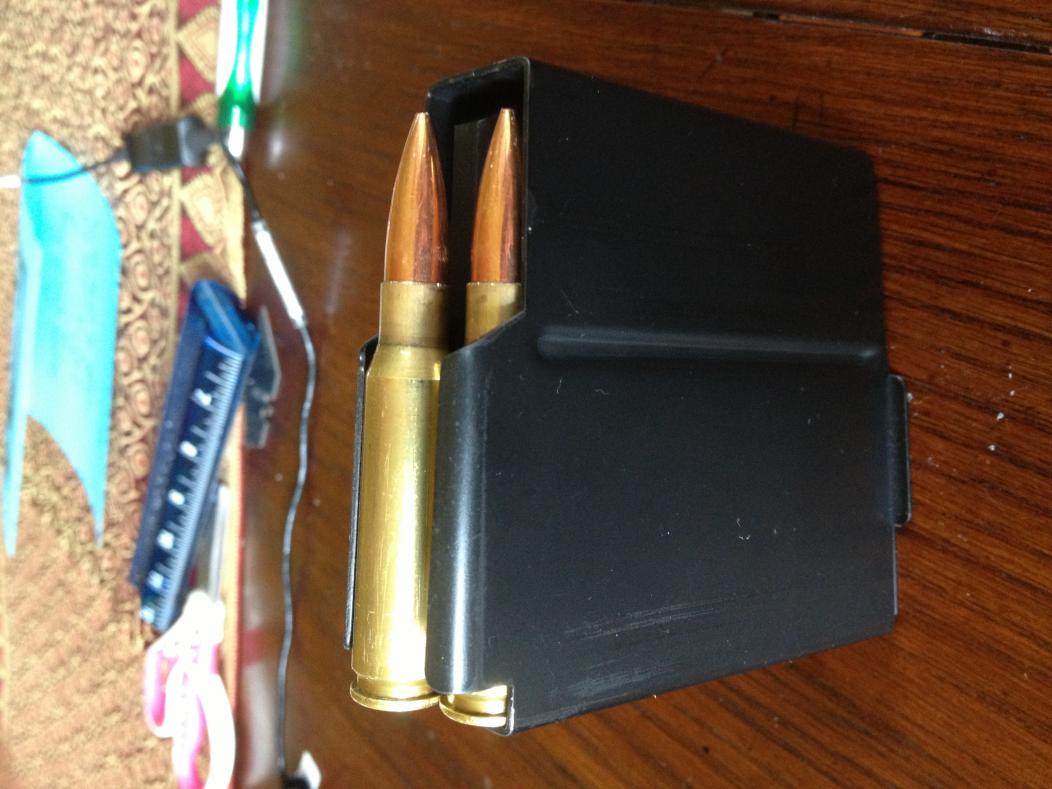

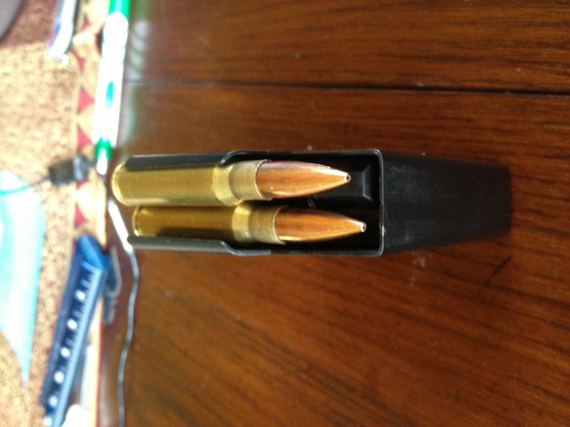

Have you tried putting pressure on the bottom of the magazine while working the bolt. Perhaps the mag catch is a little short?

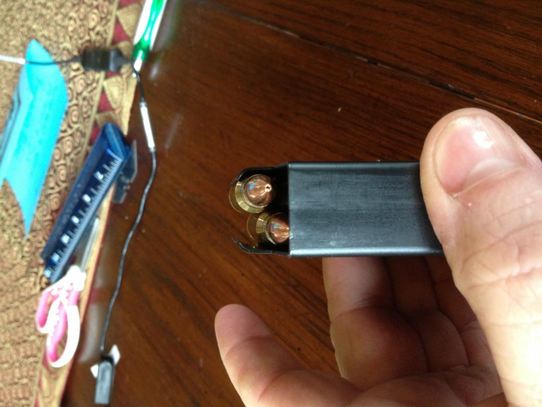

Please can you show more pic's of the mag. from all sides & bottom
thanks.

I made up 10 fresh dummy rounds from brand new never fired lapua brass and 175 SMK seated to 2.80. I got a really clear picture of the jam. It catches right at the outside edge of the barrel radius. If I pull the bolt back as suggested by Lowlight the cartridge just stays in place - it's wedged in. I'll see what AINA has to say tomorrow.

Maybe the magazine was having an issue and now it is loosened up? Again the only time I ever had a jam like that on my AI was from a sticking magazine follower due to a lot of fine sand entering it. The follower was tilting and allowing the round to tip up too far when the bolt was stripping them off. The nose of the round would jam into the upper part of the receiver before the chamber causing a feed failure. Only cleaning the magazine was able to resolve it.

What I saw is the round was stripped off at such an angle that the bolt face was hitting the case wall. I don't think a feed ramp 2x the size would have solved it. The magazine follower was just too far tilted and sticking. I swapped magazines and cleaned it to fix it.
