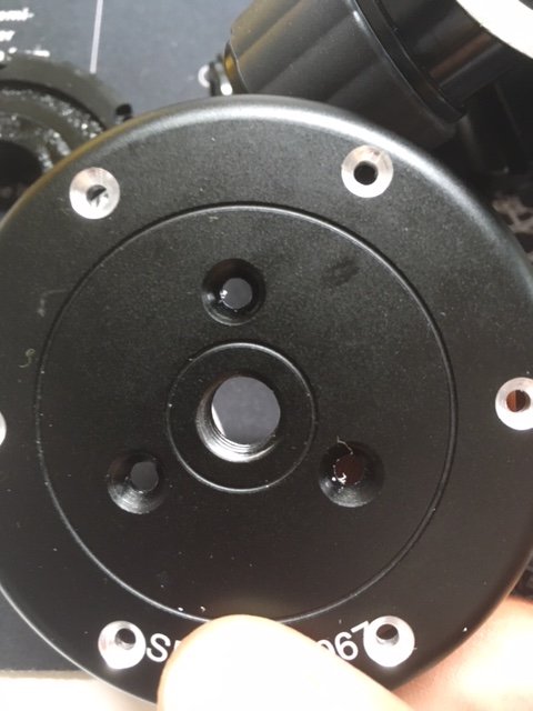

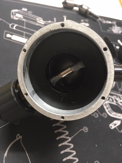

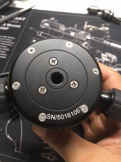

By taking apart the three screws on the bottom of the ball head exposes the internals and panning base plate that can be removed. Drilling out the panning base and reusing the threaded screw holes, I was able to install longer screws countersunk in the panning base which mates the panning base to the ball head assembly with (6) 2.5mm screws. I also made sure to make the screw holes in the panning base so the 0 degree mark lined up with the arrow on the ball head for aesthetics. The relation to the threading of the 3/8 screw hole in the ball heads to the tripod isn't necessary to take into account as the apex on the feisol 3372 legs spins 360 degress and can be adjusted instead of being dependent on the panning base timing. However, if this ball head is mounted to a tripod without an adjustable apex then you will need to take this into consideration before drilling out the panning base.
Here are the screws needed. I believe I used the 10mm screws.

One concern I had was regarding the little 2.5mm screws that may fail given the aluminum body of the ball head but most of the force in loading the tripod dosent correleate too much torquing force on the panning base as the force is applied mostly forward.
I have been working with the mod for sometime now and what I initially discovered that, as of course the ball head didnt pan any longer, the torque transferred to the 3/8 tripod screw would work out now from the ball head. I was thinking on using locktite but instead went with a rubber o-ring in between the tripod and ball head and havent had an issue since.
