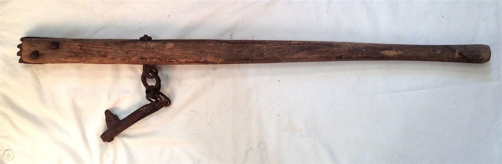

Anyone know where to get one of these?
Need to replace a worn out one and what I'm finding looks like it takes twice the work to do the same job.
That was just a pic I found online. Jaws worn out on mine although handle plenty strong 50+ years later.

That thing looks like it was made around the time of the Civil War. Maybe check antique shops.

They were made well after the civil war. My brother bought one as recently as 20 years ago for a farm he was working on.

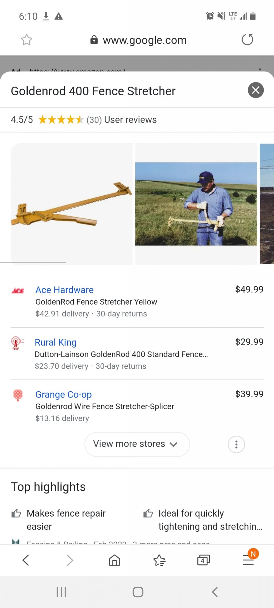

You ever use one of those?
Built/repaired many a fence with those. They used to be ~$15 in the mid eighties. Not my favorite fence stretcher, but they were light (relatively) and idiot resistant...which worked out good enough, especially for the hired man...he would tie it on the back of his saddle along with a hammer to ride the fence where a wheeled vehicle couldn't get to.
Reactions: Ravenworks

Not the exact brand, but the exact type on nearly a weekly basis. I probably have somewhere between 6-7 miles of fences to look after.
Nothing better for wire to wire repair, but the one I have the hooks aren't big enough. It's just barely hanging on if pulling to a large (~8"+) corner post. Scares the shit out of me cranking that last bit.
Reactions: diggler1833
I was thinking about weight because I didn't enlarge the picture and thought it was one of those Hi-Lift jacks.
Those things are heavy and obnoxious.
I think mine is a TSC or Atwoods blue light special. It still hooks, but I know what you're talking about. All of my new corner posts are either 8"x8" or 2-7/8" drilling pipe (around the house)...then again, I've used cut cedar trees in a pinch too.
