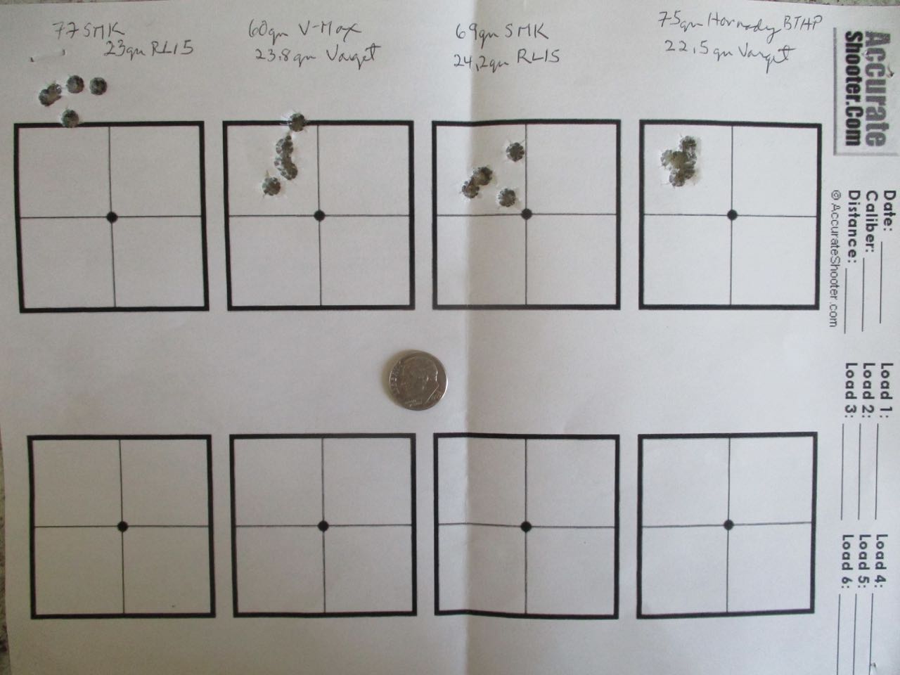

Didn't have much time but took a quick trip to the range this morning to try out some reloads and see if I would blow myself up. Kept to the conservative side on powder amounts since I'm a rookie and don't know what I'm doing. LOL There are way too many powder and bullet choices and gets confusing.
Luckily, this barrel doesn't seem to be very picky. The 5 shot groups at 100 yards went from around 3/4" to around 3/8".
7112028
Lookin good Brother, happy to see more accuracy geeks getting involved in Precision AR Shooting. Past 10 years have been huge as far as people seeing the true potential of ARs.
For me personally, its easier to shoot consistent good groups with a bolt gun, than with a gas gun. So I choose to focus on the cheap and easy thrills. :)
6x5s tell the real tale.
Is it the indian or the arrow ?
Yes, it is. :)
Thanks Big Jake. It's just confusing with the almost limitless combo of bullets/ powder+weights/bullet jumps and on and on.............

That barrel is made for the 77gr SMKs, pick a powder, Varget, XBR, TAC, sort and prep some LC Brass, and get yourself some REM 7/12 or CCI BR4s primers.

Thanks Big Jim for the tip. I have a box of the 77 SMKs, a bit of Varget, XBR, and a bunch of LC brass ready to go. I need to get some TAC and only have CCI 400 primers. I'll try out some combos and see how it goes. Thanks again for your help.
