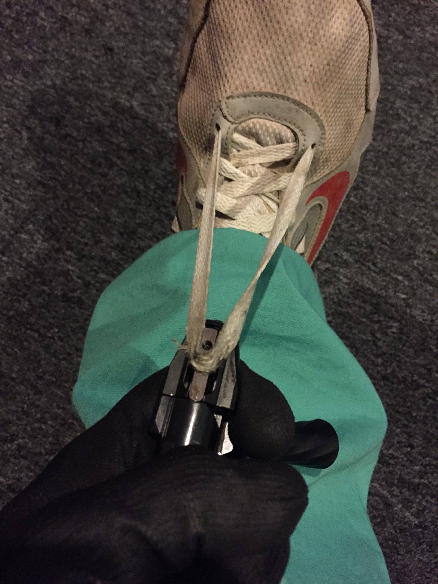

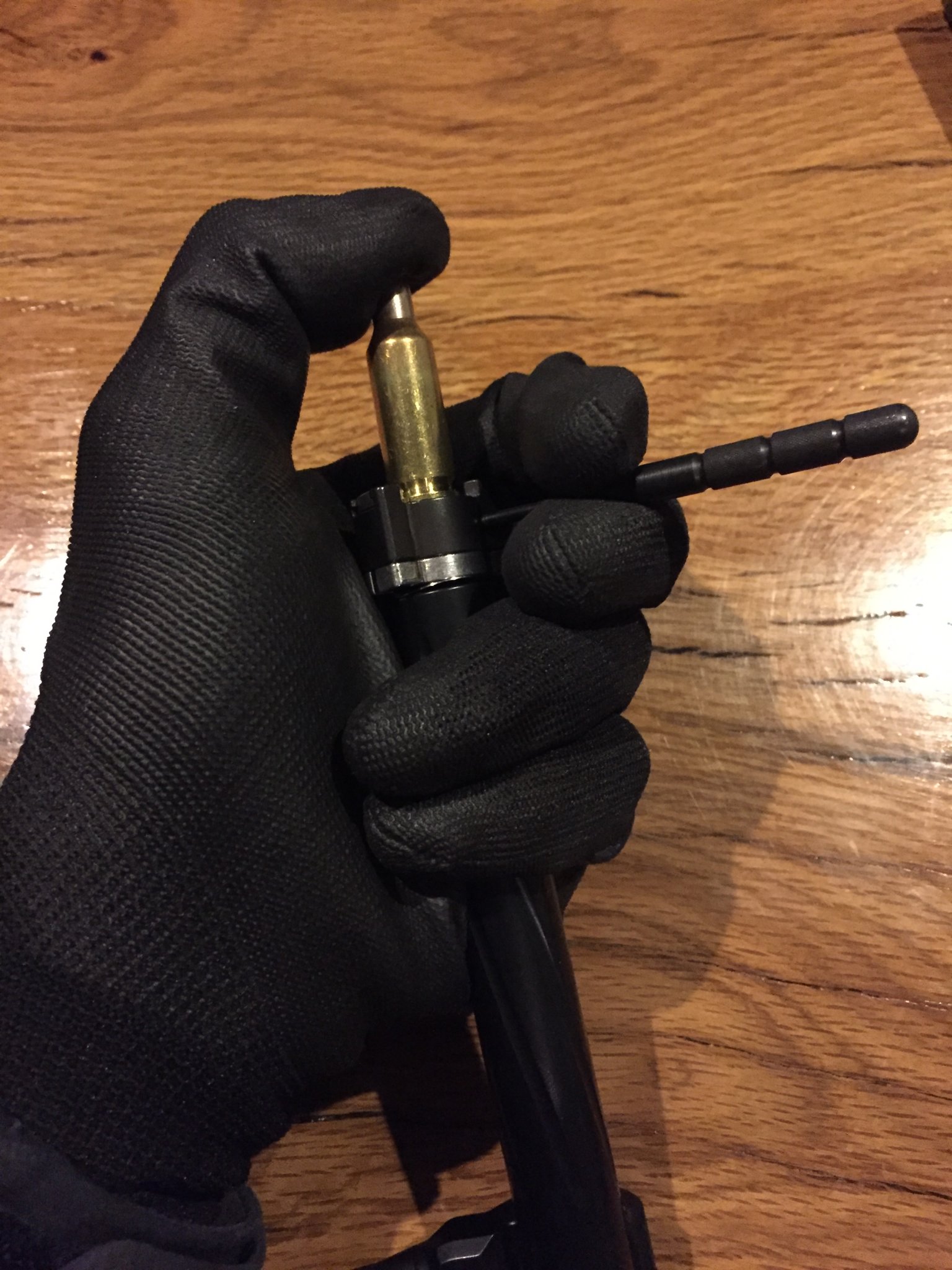

    Severe runout could effect it slightly but it will still be pretty good. And you can still candle it too. But with a micrometer top seater you can work it down .001 at a time to find it exactly. Leaving the ejector in will influence it way more than anything by forcing the entire side of the case into the side of the chamber. And once you’ve stripped the bolt a time or two you get good at it. Mines broke down in like three minutes including putting on the old shoe for pulling the firing pin spring. Glove in my left hand since my chamfered brass is sharp, bolt across my palm, use a case under the extractor to cam over and push the ejector in, punch between you fingers and a few taps with a hammer and the ejectors out.
    7034390
    7034391
    (Displayed on a bolt that doesn’t have either of those issues present though but it’s a demonstration of how I do it with all I have at hand this moment)
