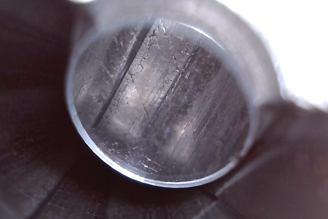

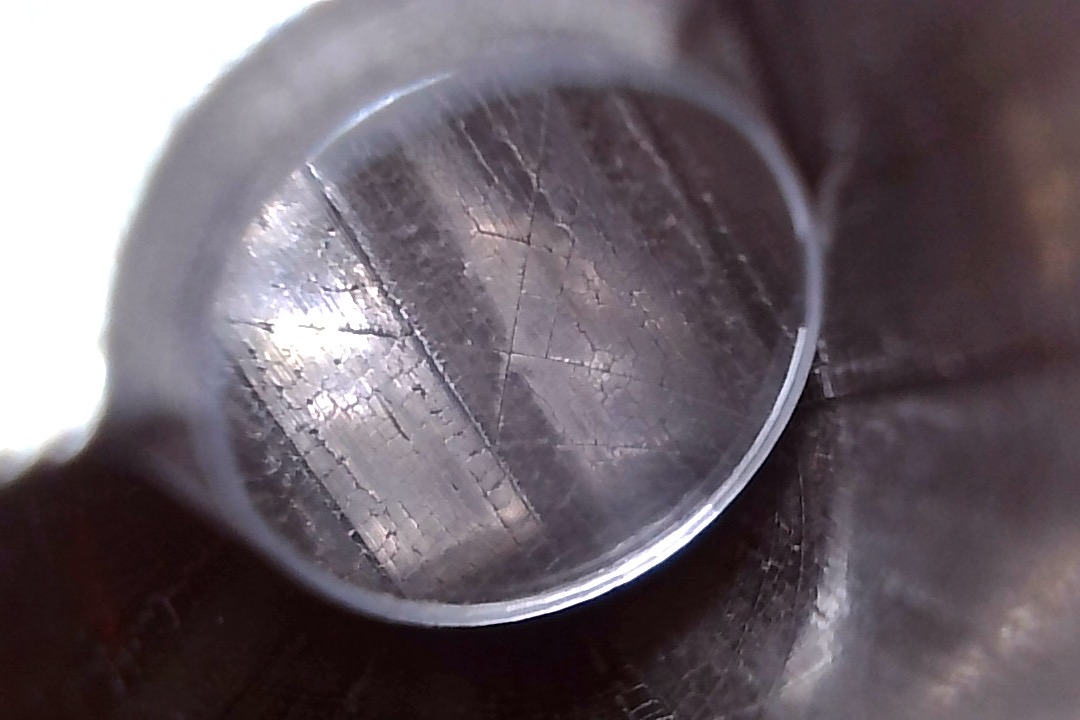

Newbie here. Tikka factory barrel, 6.5 CM, roughly 2000 rounds (I lost count). I started getting fliers after my normal cleaning routine (about every 150 rounds clean with BoreTech Eliminator patches and nylon brush. Alternate until clean patches. Clean neck with one size over bronze brush and eliminator and patch dry). On my last trip out, I also started seeing pressure signs and heavy bolt lift from factory ammo. I was curious if I had a carbon ring problem that had been slowly accumulating on me, so I bought a borescope and decided to check it out before and after cleaning. I didn't find a carbon ring, just very faint carbon build up that cleaned up easily with my normal routine.
However, I did notice these cracks that run across the lands at about 45* to the rifling. There were a handful of them within the first 3-4" of barrel. Are the cracks that run straight continuously across the lands and grooves normal? Is something in the cleaning routine potentially causing them?

It would be bummer at 2000 rounds for it to be shot out already, but its possible. I have seen much worse fire cracking in barrels that still shoot. Have you run it down well to make sure there is not another cause for the fliers?
Reactions: lash
Yes, the fire cracking isn't too severe. I was curious if the x-shaped cracks were a normal part of fire cracking or maybe something I created inadvertently. I don't know if they're related to the fliers or not. There is a decent bit of hard carbon in the grooves through the first 5-6" of barrel that may be causing the fliers.
I did check torques, dis-assembled/re-assembled, different ammo, etc. I have another barrel on the way, so I'm not too worried about stretching every ounce of life from the factory barrel. Just curious if this was a known phenomenon that I could avoid in the future.
Maybe the hammer forging of the barrel results in this x like anomaly.
Nothing you are doing cleaning wise would contribute to this.
If anything, I’d work on that hard carbon further down the barrel. A short soak (1/2 hour) of CLR) and a good scrub with a brush might do it . If not repeat, but don’t leave the CLR on there too long.

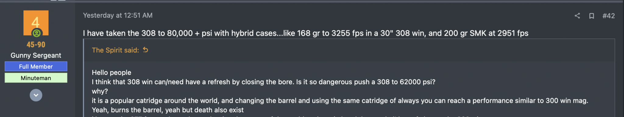

You never answered a question in the other thread. How do you know what PSI you're running when you post the PSI your ammo has?
What a gotcha question...
I never gave the exact pressures of any ammo, general discussion in the area of...same as everyone else.
Are you that stupid?
What psi is your ammo running? Exactly?
Every shot fired is different, factory or handload.
Obviously, most do not have expensive test lab equipment, setup in the field.
Those tools available to the public such as strain gauges and QL are only a suggestion of an approximation.
I use QL, loading manuals, and a chronograph. Compare the results with pressure signs on the cartridge case, bolt lift, & velocity. QL will give an exact pressure figure, but that is only an approximation.
No one has the exact psi pressures, as every powder burn, is not the same...its all averaged out. Average chamber pressure is...as quoted by the testing facility.

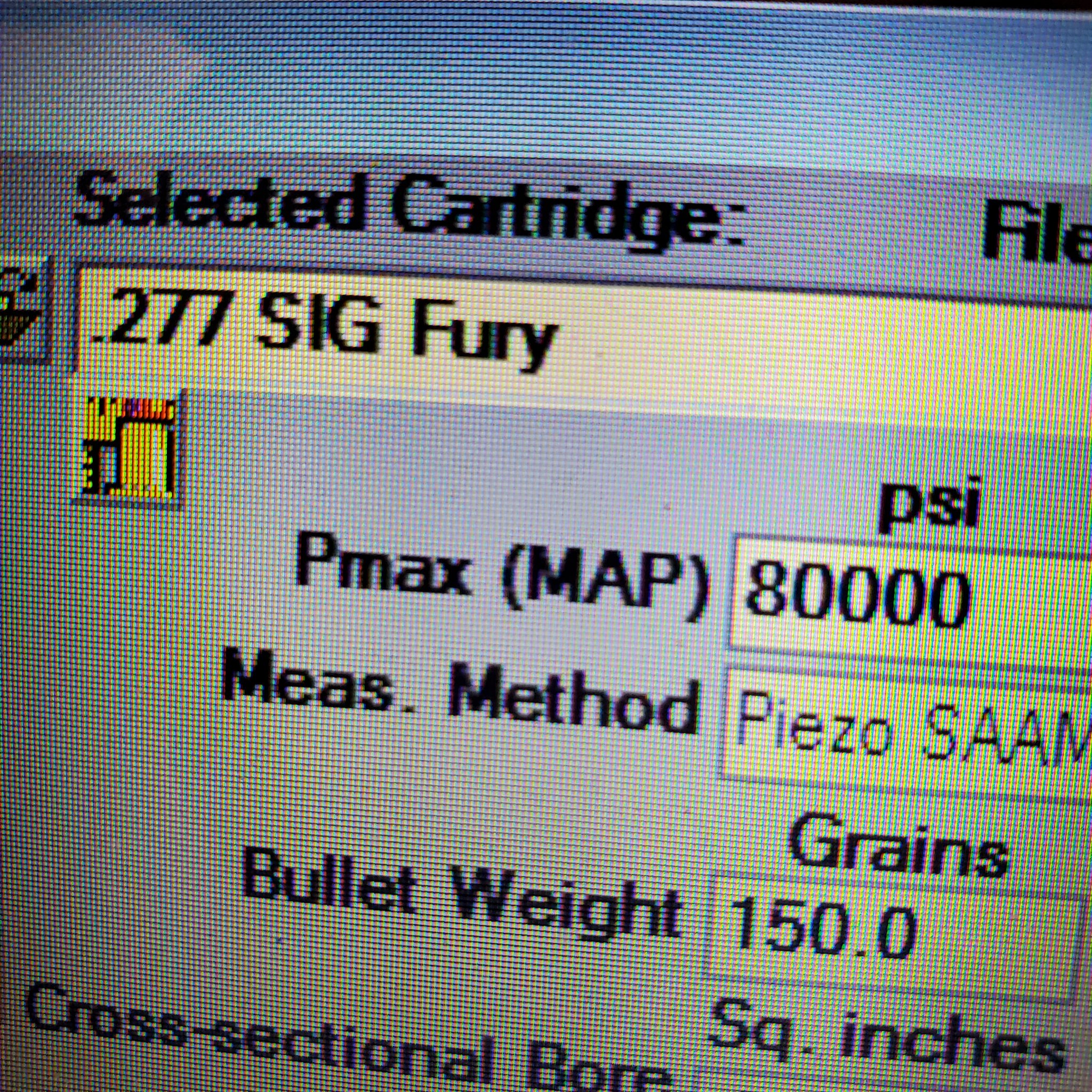

Did you really just say that you can compare and measure pressure signs at 80k

......I literally posted a screen shot you saying you ran over 80k PSI.
So, how do you know you ran over 80k PSI? I'm extremely familiar with how this works and how to measure it. So, we don't need some long winded explanation on how pressure works. Just an answer to the question.
If you're just guessing, assuming, or using quick load....say so. Nothing wrong with that.

Quick load, 277 Fury at 80,000 psi if ya want to play ..as a reference.
150 gr Nosler 2.825" 3147 fps 79,271 psi 22" barrel. With available powder, and exact numbers ...reference only. But that'd be a good hunting load in a light bolt gun, and 2925 fps on a 16" for a 150 gr is good.
