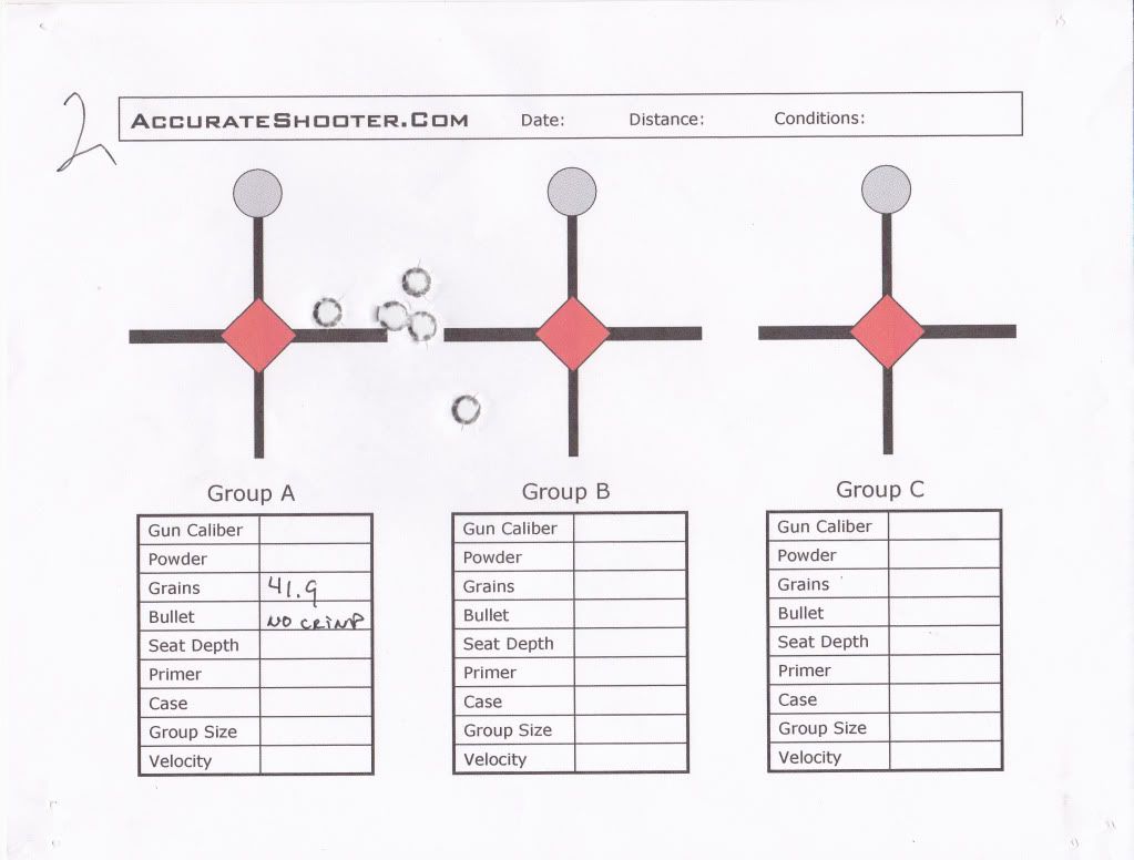

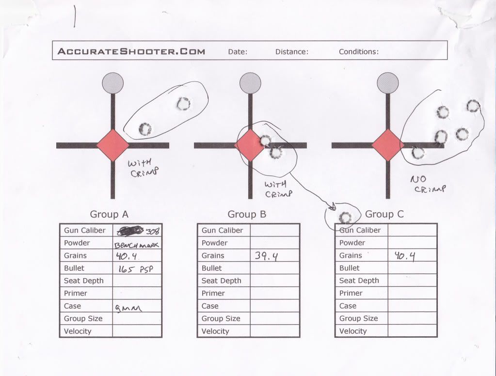

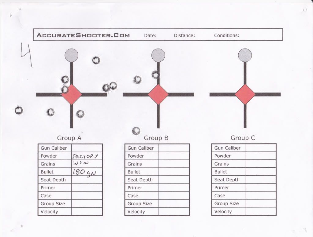

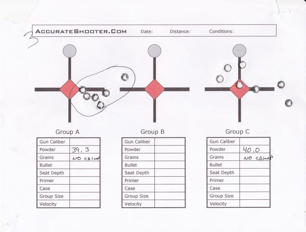

went to the range yesterday finally, with the sole purpose of checking the second batch of loads for the LAR-8 .308 Manrifle, and here is what i got
target #1 2 loads with crim, last without. 39.4 is winning here as i think i pulled the 3rd shot altho, the 40.4 with no crimp proves promising.
target #2, 5 shots at almost max grains and no crimp, the recoil was strong on these
target#3 39.3 gn, no crimp and 40.0 no crimp this is the area i am going to explore more, the gun seemed to like these
target#4 was factory loads Winchester super x 180 gn, not liking these at all, i was holding on the left diamond, and they went all over the place
it looks as if i got my press figured out, and i am making loads mor accurate than cheap factory loads.
next step, im gonna start with 39.0gn and work up to 40.0gn by .1 and see what looks the best.
thanks to everyone here who helped me figure this one out!
