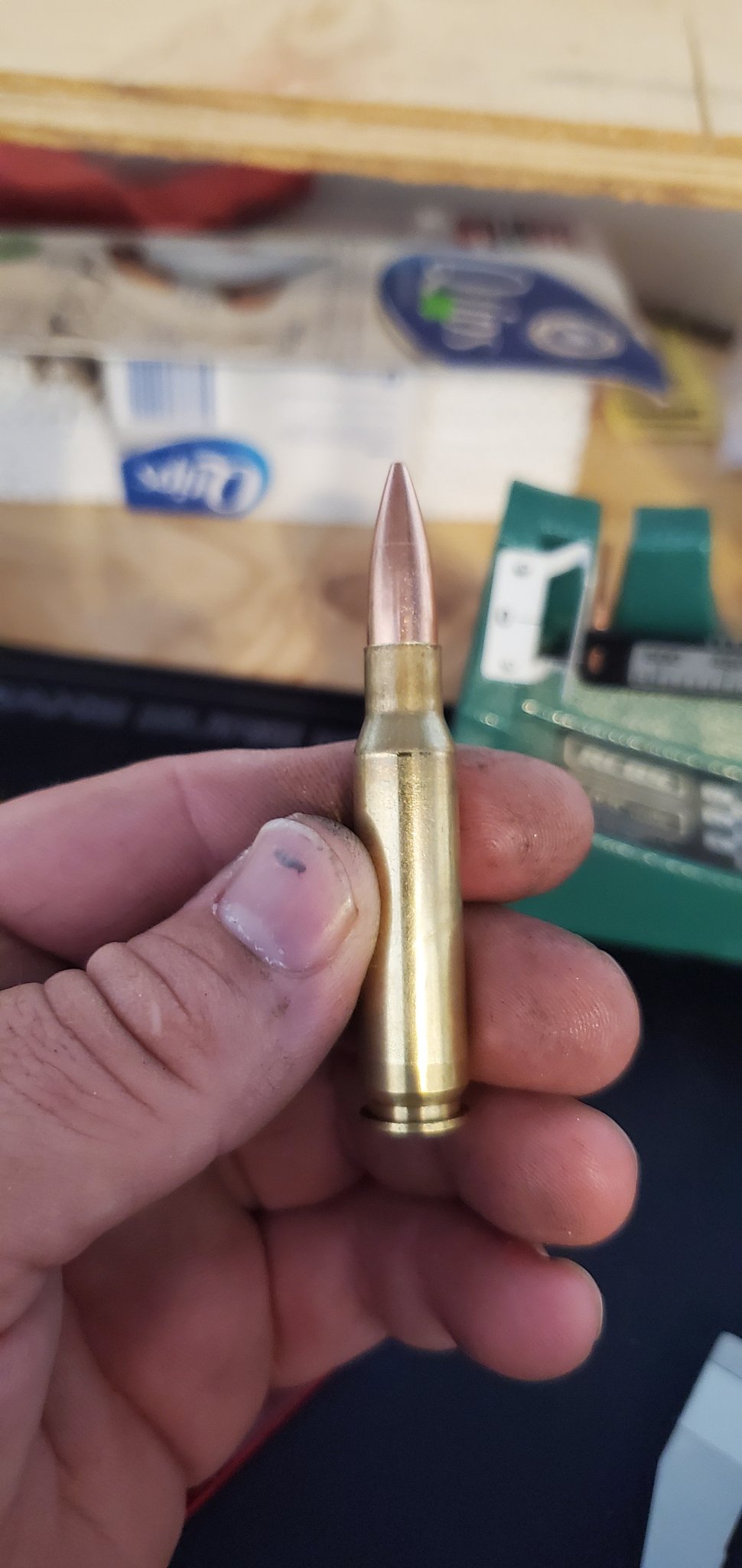

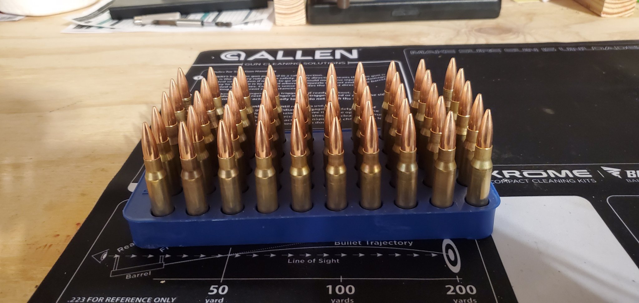

Today I loaded my first ever hand loads. Im still extremely new to this but I loaded Hornaday match cases with Federal gold #210 primers. 44gr of Hodgdon Varget. 168gr Sierra MatchKing HPBT .308. Paid super close attention to detail and trimmed every case to 2.005 and annealed. Full length resized and set each bullet as carefully as possible. Getting 50 rounds all at 2.800. Now off to the range tomorrow to see the results and adjust where needed. Any tips would be helpful.

Nice job. And as mentioned, be sure to document all this with your target, including things like jump distance, ambient temperature, altitude, humility and keeping a log for your brass to keep track of loading procedures you've done each time and know how many times you've fired them. Be sure when you reload, to inspect the brass for any anomalies (like impending case head separation signs and primer pocket condition for holding the primer firm).
Note, just be aware that your 44 gr. of Varget is a pretty hot load with a cartridge at SAAMI spec dimensions. It's substantially hotter than factory Federal Gold Medal Match's. I estimate your MV to be around 2700 fps +/- depending on your barrel length the temperature conditions.

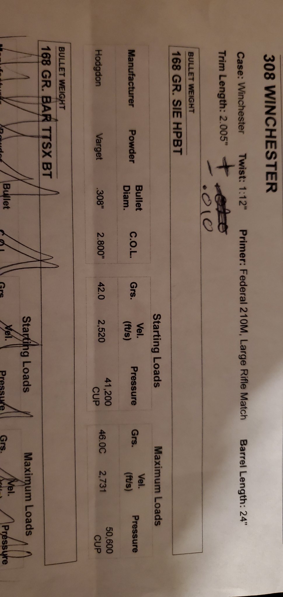

On the hodgdon spec sheet it said for that round that min is 42 grain and max compressed is 46gr so I went in the middle. Should I be worried?

No.
Just don't let the cartridges sit in hot direct sun.
I've use up over 46 grs . . . though I seated my 168 SMK's longer, like out to .010 off the lands.
Reactions: RichardCranium
I generally work up loads, starting at the minimum charge, load three cartridges per charge weight, and go up .3 grains at a time until I start seeing pressure signs. Don't get in the habit of guessing.

Yeah, either that or have the bullets seated at various depths (like at .010 intervals from the lands) to find what seating depth give the best results.
With 50 rounds at 44.0 grs, I'd expect to see not so good groups and not know why after shooting them all. :eek: ;)

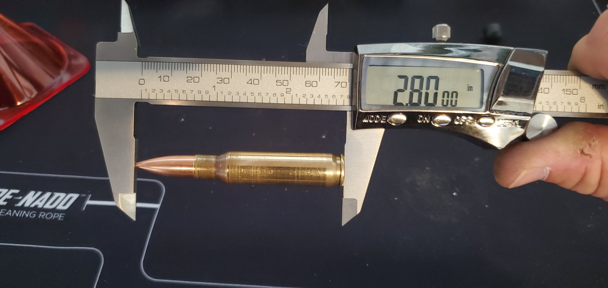

If you set each individual cartridge to 2.800" OAL exactly there will be some small inconsistency in how far the bullets jump to the rifling. The tips on those bullets are not completely consistent. You will get better results measuring length with a comparator at the ogive.

So measure from the ogive to the tip then seat the bullet to the difference?

Measure cartridge base to ogive.
Have some fun learning and take those rounds and measure the difference in base to ogive. You'll probably find some variation you weren't expecting, and this is more important than the exact overall length.
The exact overall length needs to work in your gun for magazine length restrictions and feeding purposes. If you have perfectly consistent base to ogive measurements but have a spread of .015" oal and they still all fit the magazine then run it.
If you have a kinetic puller you could give a single whack to each to get them longer, and reseat to a consistent BTO length.
