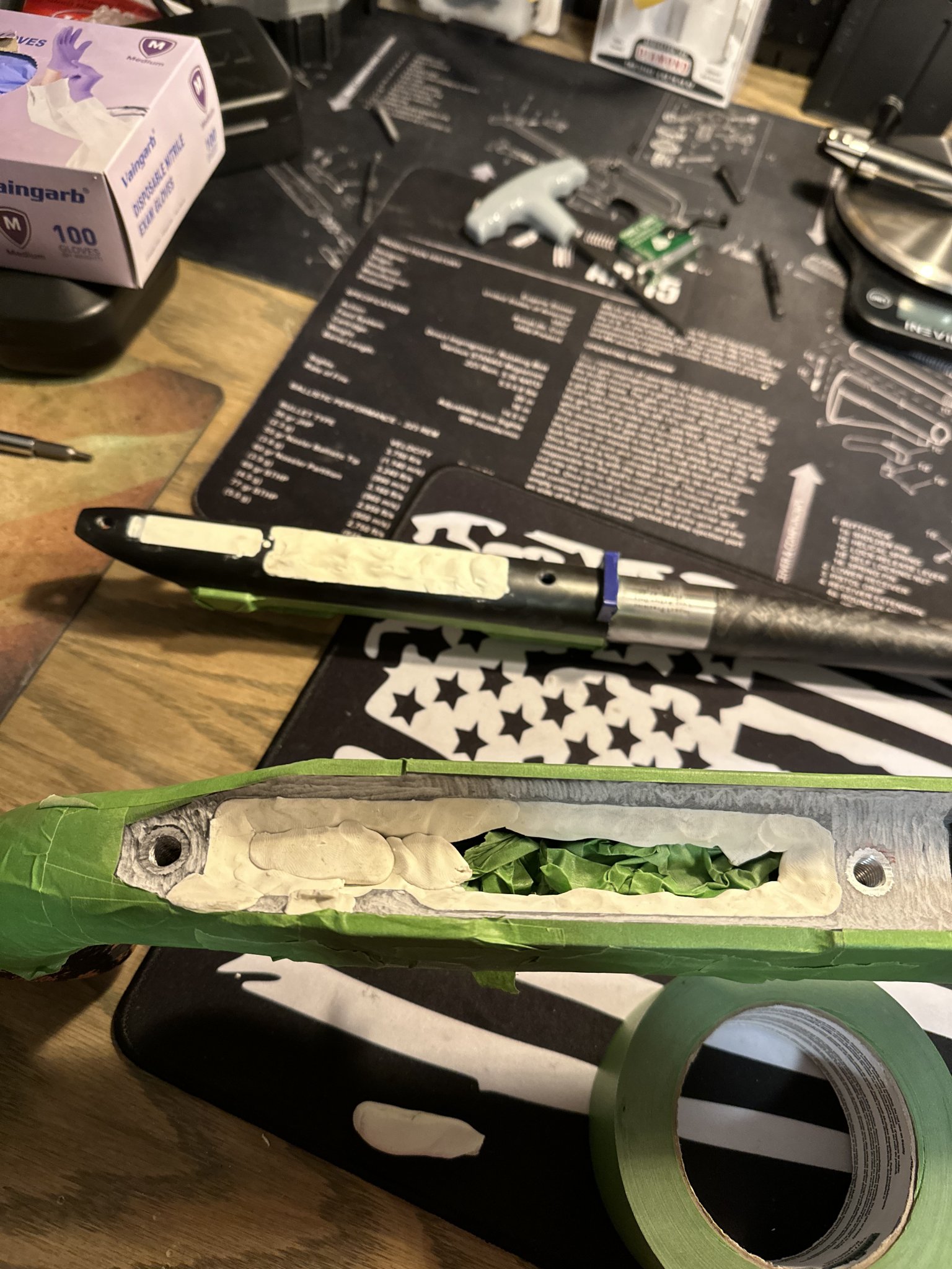

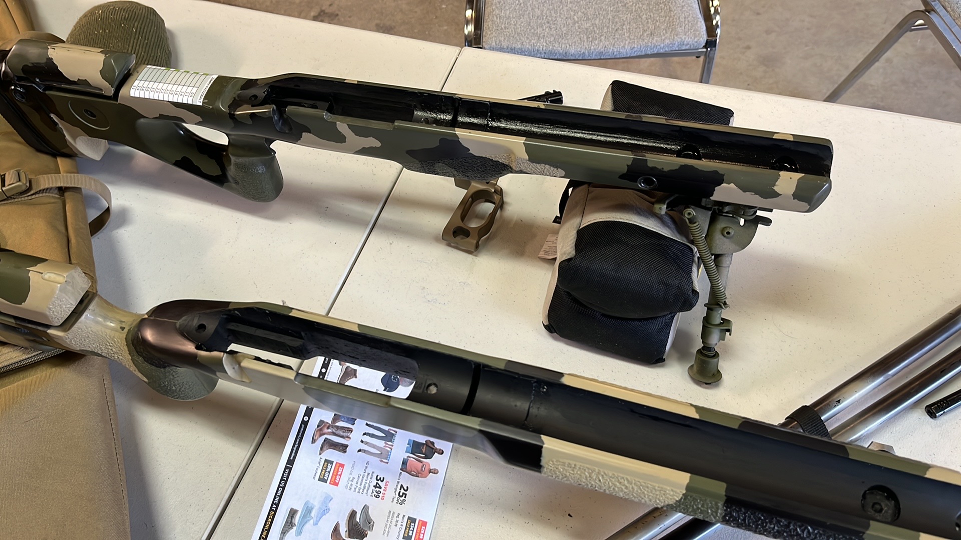

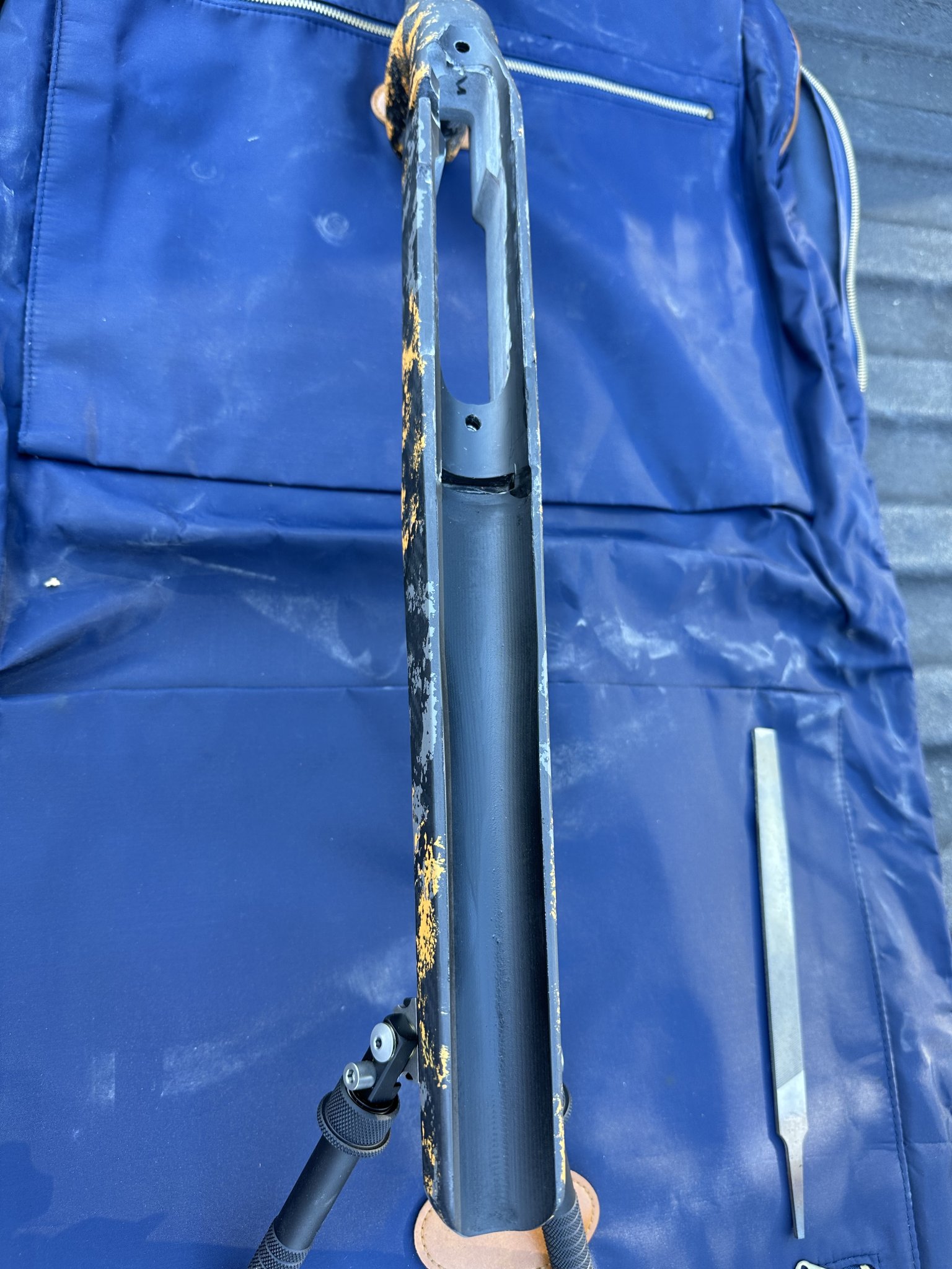

I just did 2 last night with JB weld and Hornady one shot case lube.
Have used marine Tex before and it is much easier to use than JB weld. (Runny). But I was in a hurry and didn’t have any on hand.
Over release agent everything!!! Your first time is terrifying..
Don’t forget chamber and bolt holes and bolts.
I Didn’t tape a thing. It easy enough to clean up with a knife and a dremel.
Stocks were already pillar bedded.
They came out with no issues after about 4-5 hours.
I do not tape recoil lugs either.
Both stocks hold barreled actions upside down with no bolts.
Prep work is key. Overflow is paramount
I paint the barrel channel and the greyJB weld with black paint afterward hence the wet paint on the stock in back.

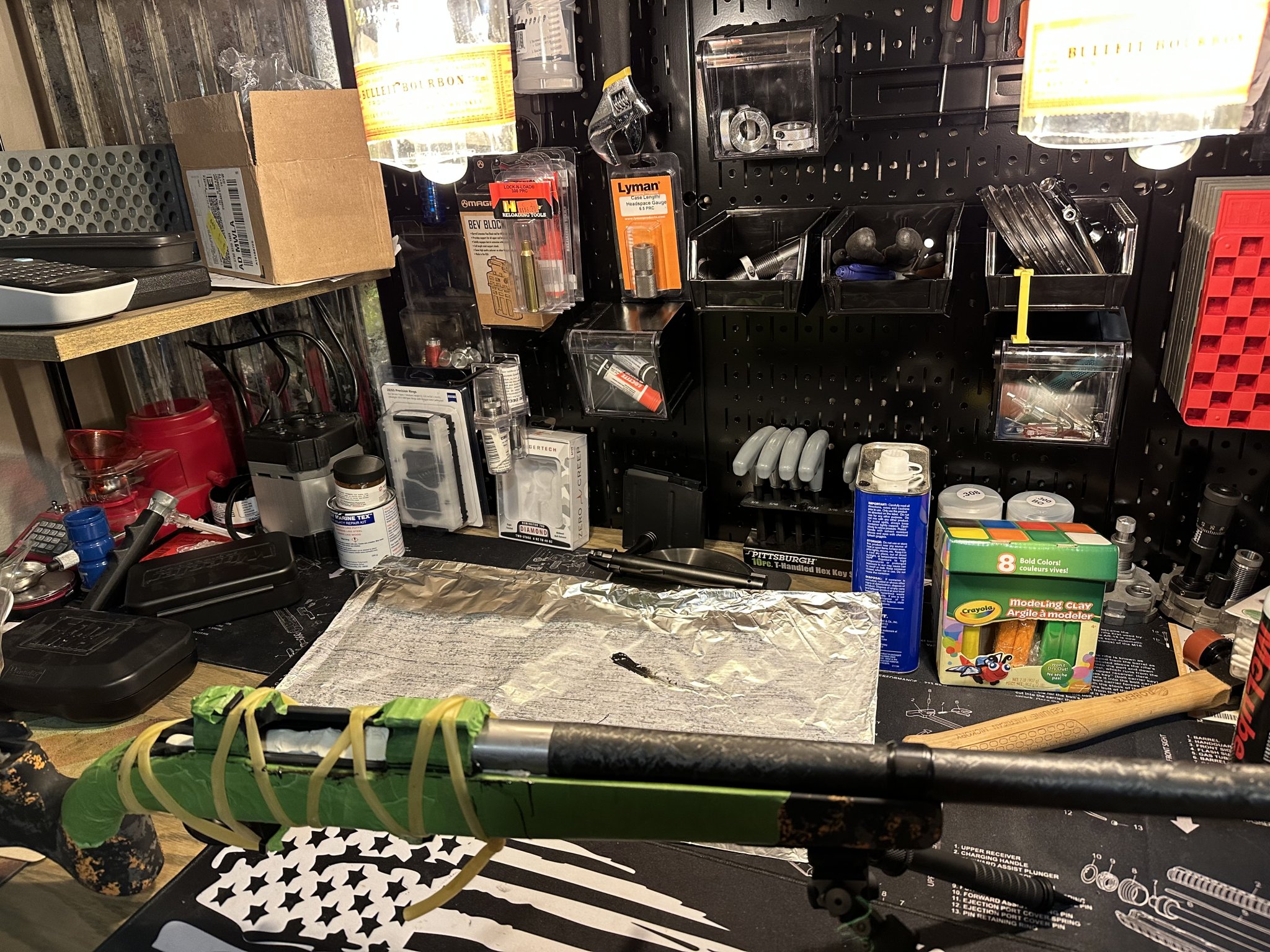

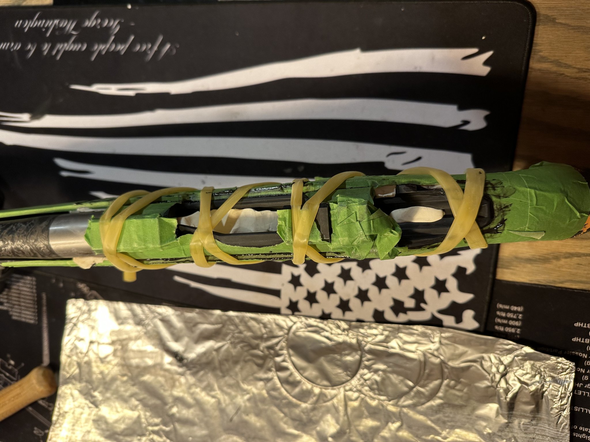

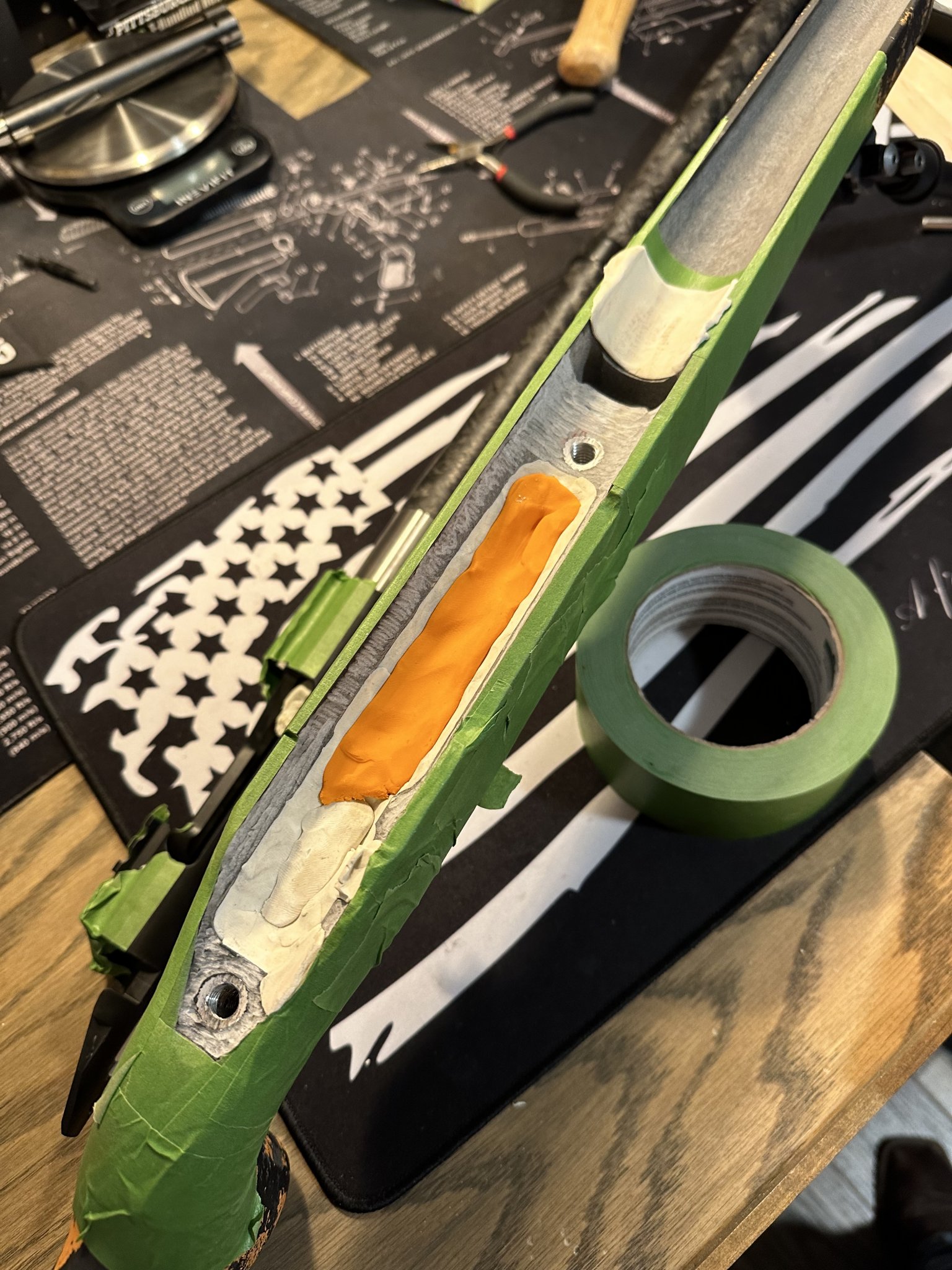

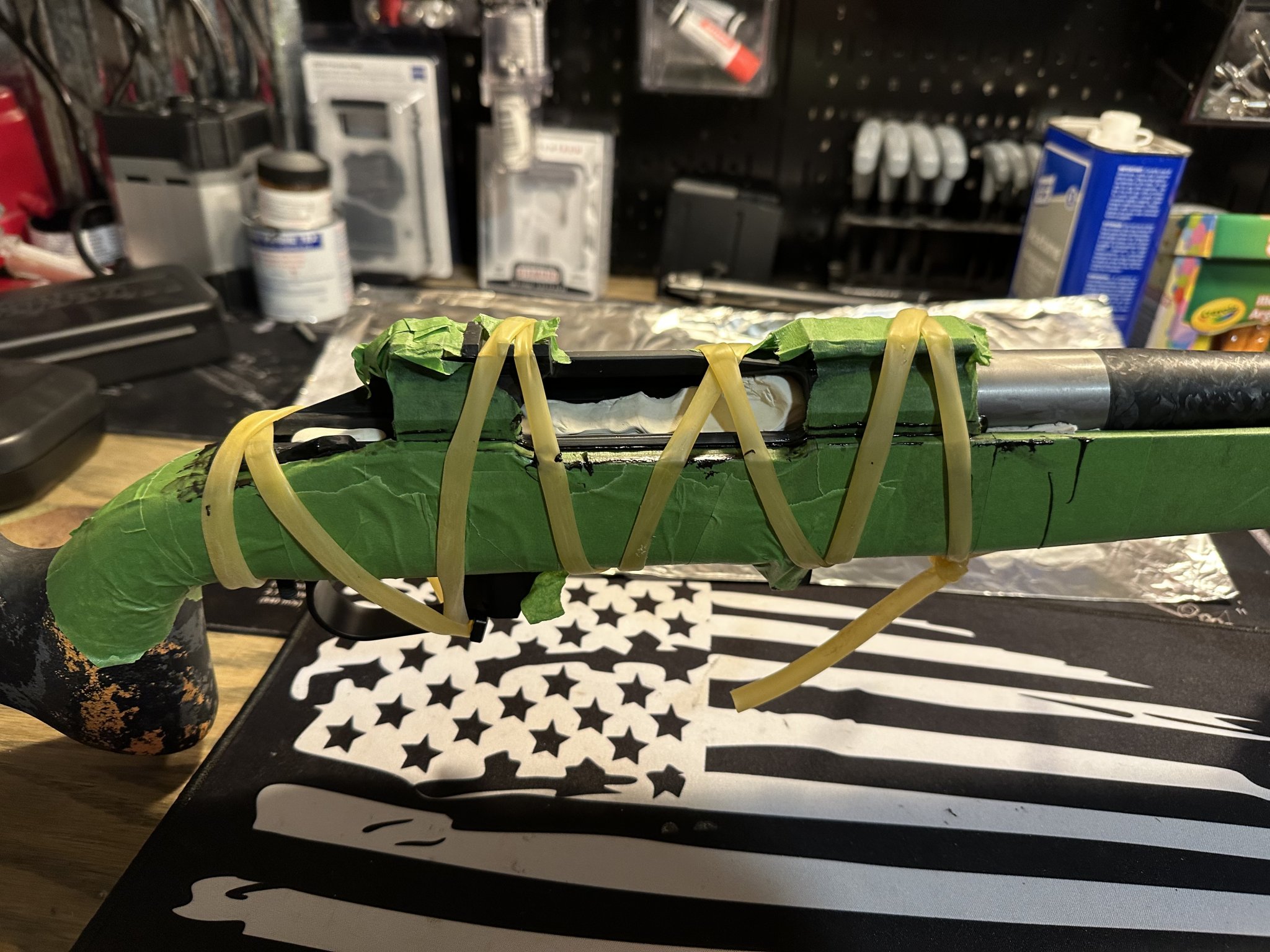

Well, we’ll see in 24 hrs.
I probably over did it with the clay, but I’m a bit ocd.
It looked way messy and a lot, but from what I’ve read and seen on YouTube university, if it looks messy and looks like too much, you used the right amount.
Quick tip - if you wipe away all the excess with alcohol and Q-tips you wont have anything to sand or grind away along the top edge of the stock. Also id you use this method, you do not need to mask the stock at all.
Gift wrap scotch tap is good to put along the action right to the stock line. If the action above the stock is not covered, wiping with Q-tip and alcohol will polish a line along the action (especially if using devcon as it has metal particles in it.
You may have wiled excess before it started curing, but I didnt know when the pic was taken.

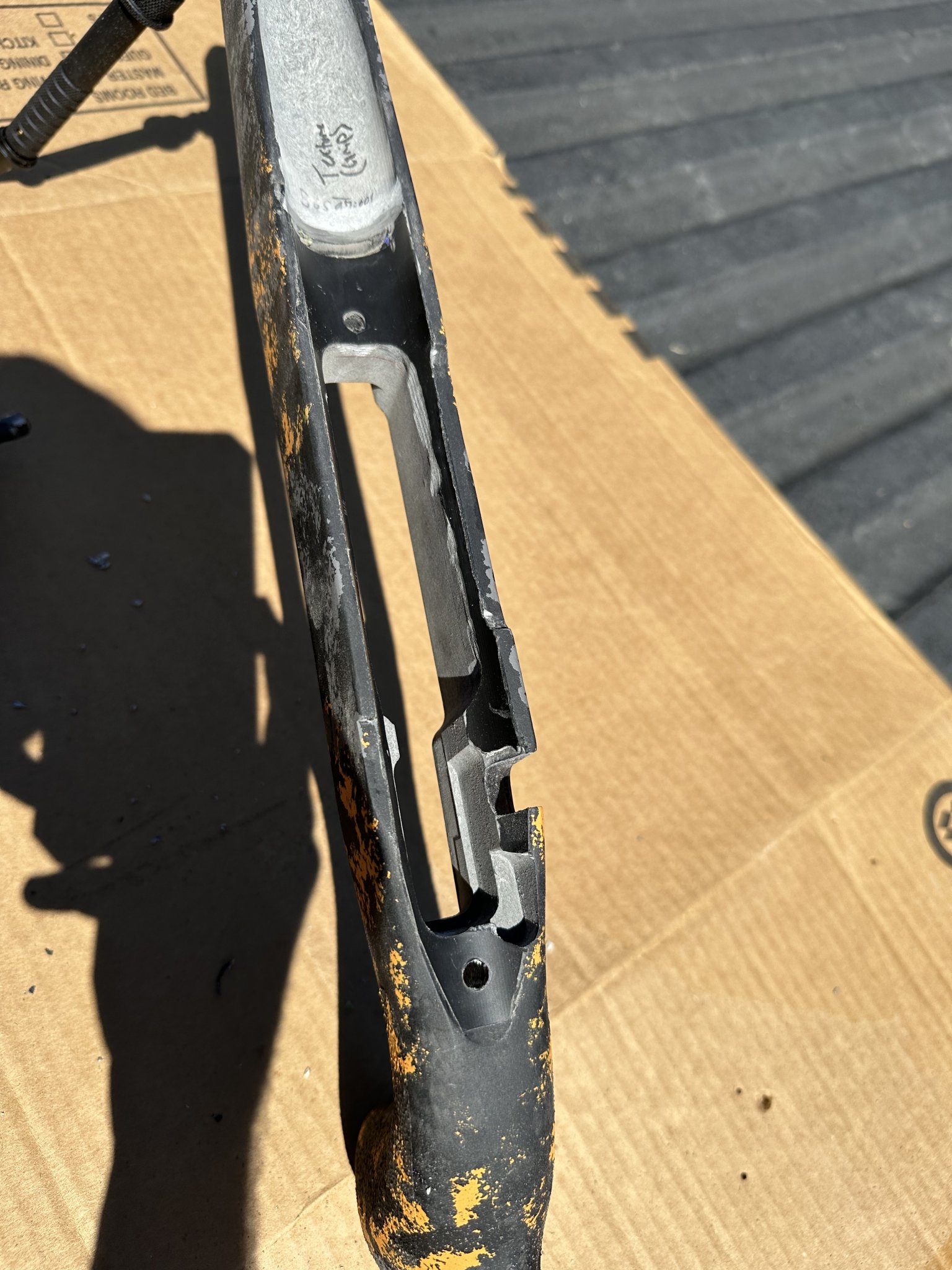

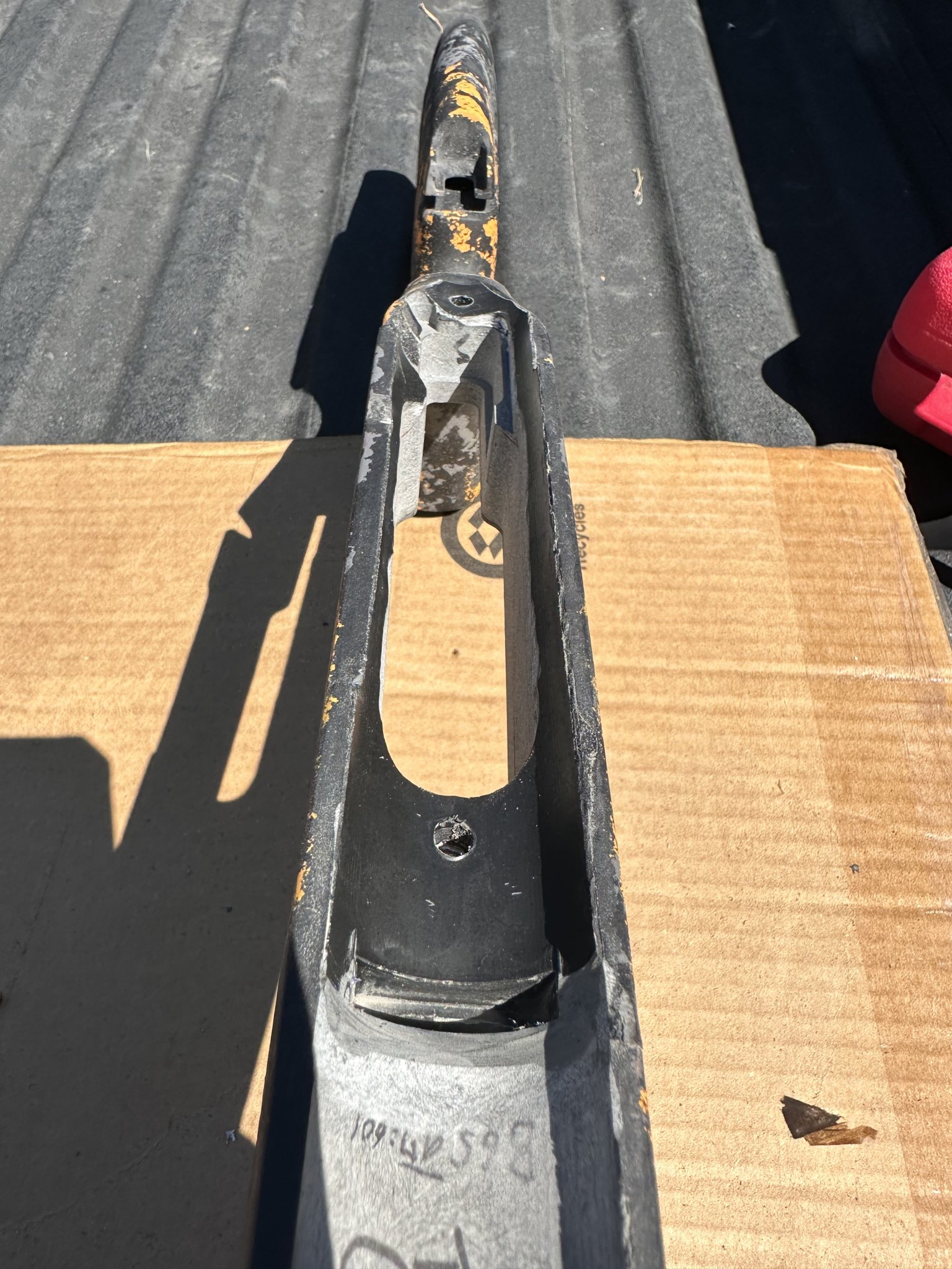

I probably won’t bed another stock.
First, Travis Stevens (TS Customs) has such an amazing stock in the KS1 for Impacts that it really is the “easy button”. It is like getting your favorite AG Composites stock with a better paint job and a perfect bedding job for basically free.
Second, for a non Impact action, or a stock other than his models, his bedding work is well worth the $375 price. It took me probably 2-3 hours to bed my last Manners LRH (all-in—taping, putty, mold release, bedding, cleanup), not to mention the $30 or so for the best bedding compound on the market (Score Hi Pro Bed 2000). I’d rather tinker with something else than do another bedding job for this kind of money.
I noticed that you ground the tops of the pillars, and they don't look to be proud of the rest of the stock around it.
Keep in mind, the pillars are what locates the receiver in the stock.
When I dry-fit a receiver into a stock that has already had pillars installed, I want contact only on the pillars and nowhere else. I'll take a round body receiver and "spin" it on the pillars, to confirm I'm not making contact anywhere else; and the pillars need to sit at a height that allows clearance for minimum epoxy depth everywhere.
When I pull the receiver, I expect to see the center of the pillars exposed, that shows me the receiver was making contact at those two points only.
JMO, YMMV.
JMO, YMMV.
Actually I didn’t touch the pillars. That was the way they were installed by AG composites.
In my opinion, having pillars installed in the stock before bedding, is of little benefit. Are they the right height or are they spaced correctly? I'd rather install pillars attached to the action as I bed the action.
But it may be good for marketing.
Ok, so I honestly couldn’t wait the 24 hours, but when I pulled it apart it was at 15 hrs.
I should have used more McLube 1700 and cleanup using more q tips than I did and also use toothpicks. Instead of alcohol, I used acetone for cleanup. My dam ahead of the recoil lug had epoxy on it from squeeze out.
I had to use some needle files and gently sanding with the drum sander on the dremel to clean up squeeze out.
Overall, I think it turned out well….we’ll see how she shoots once I get my hands on that new Zeiss glass.
It does pass the “dollar” test on free floating and the electrical tape wrapped around the barrel kept it nice and centered, plus didn’t allow barrel droop.
Edit: masked it off and painted the barrel channel flat black.
That’ll do just fine, good work
Looks good, you passed the audition first try . Congrats !
Reactions: FTW_RPR_6.5prc

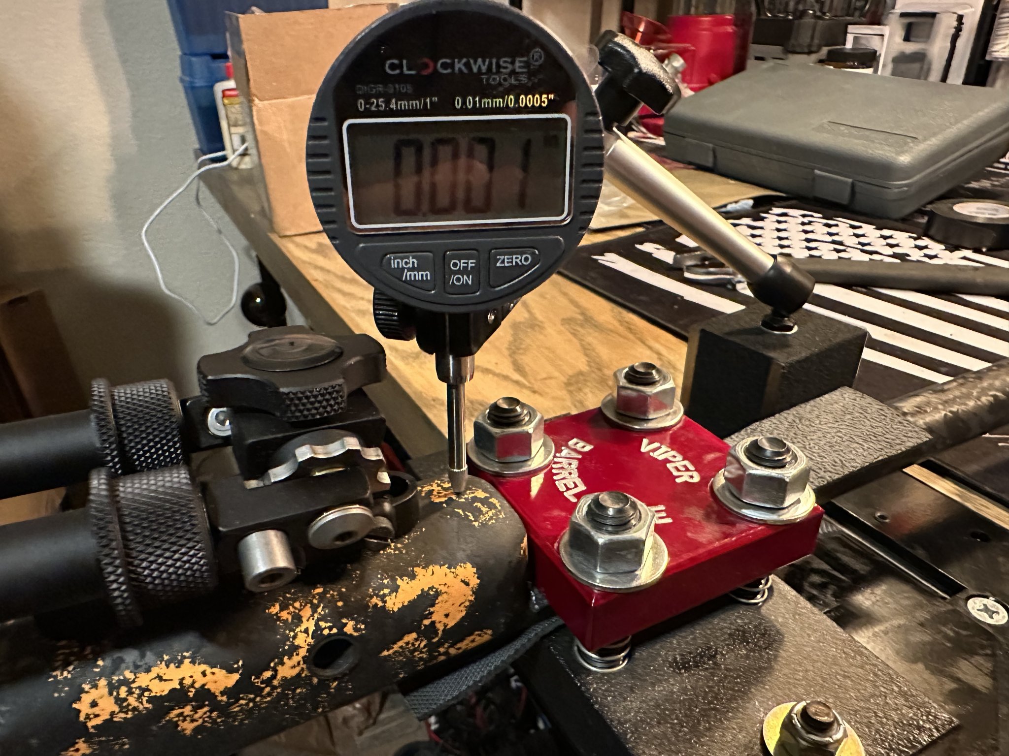

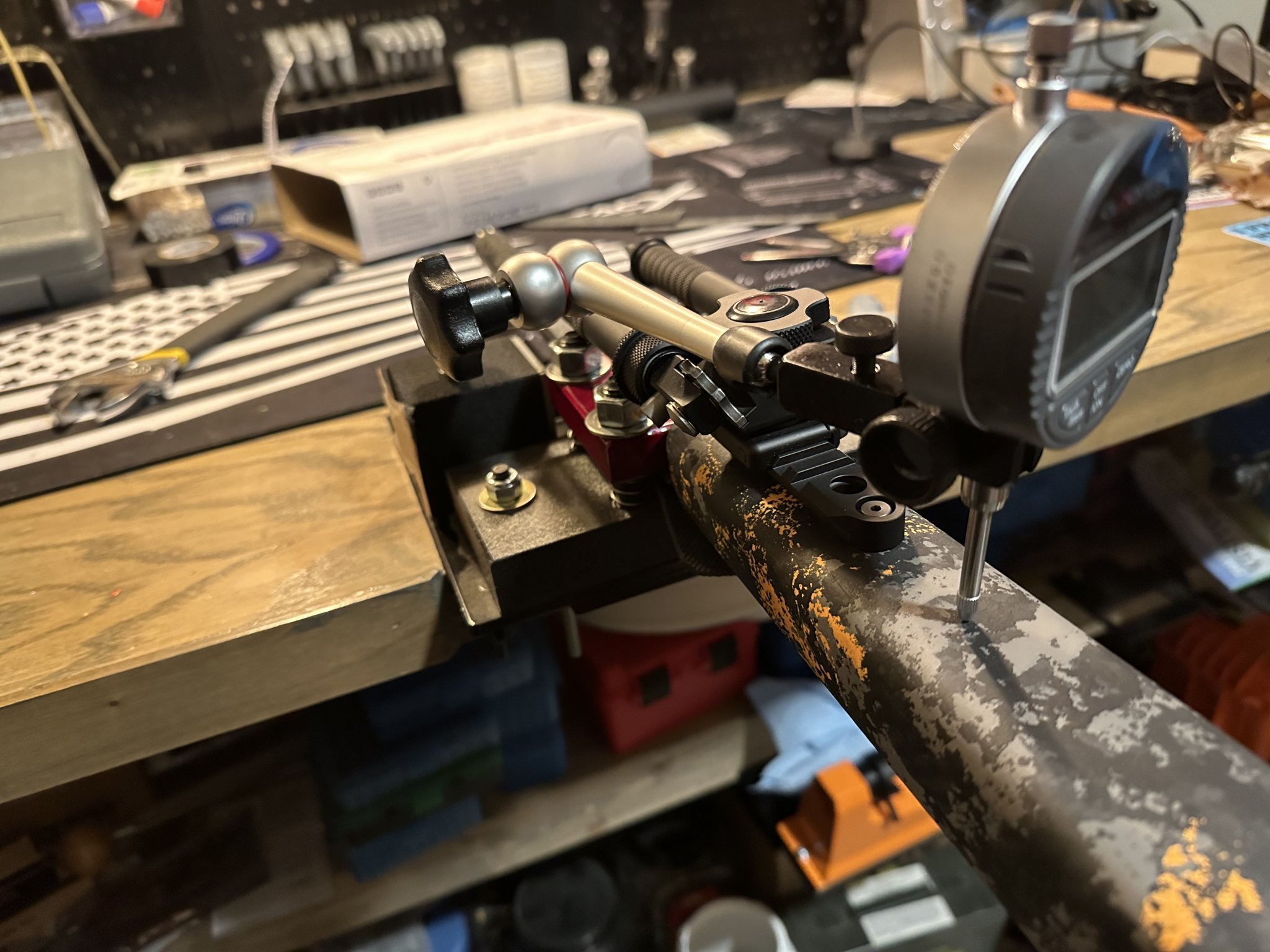

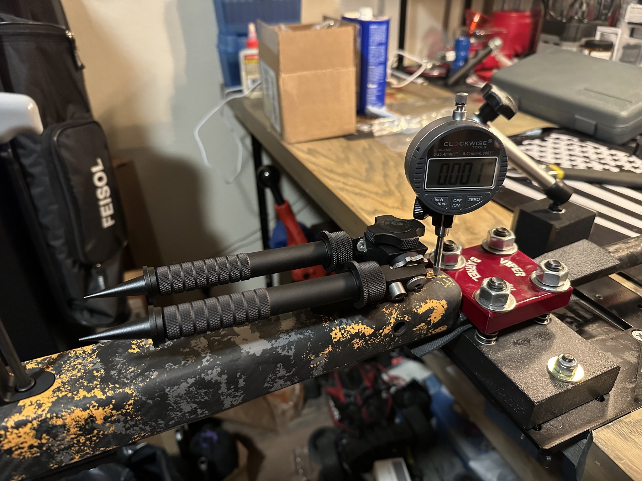

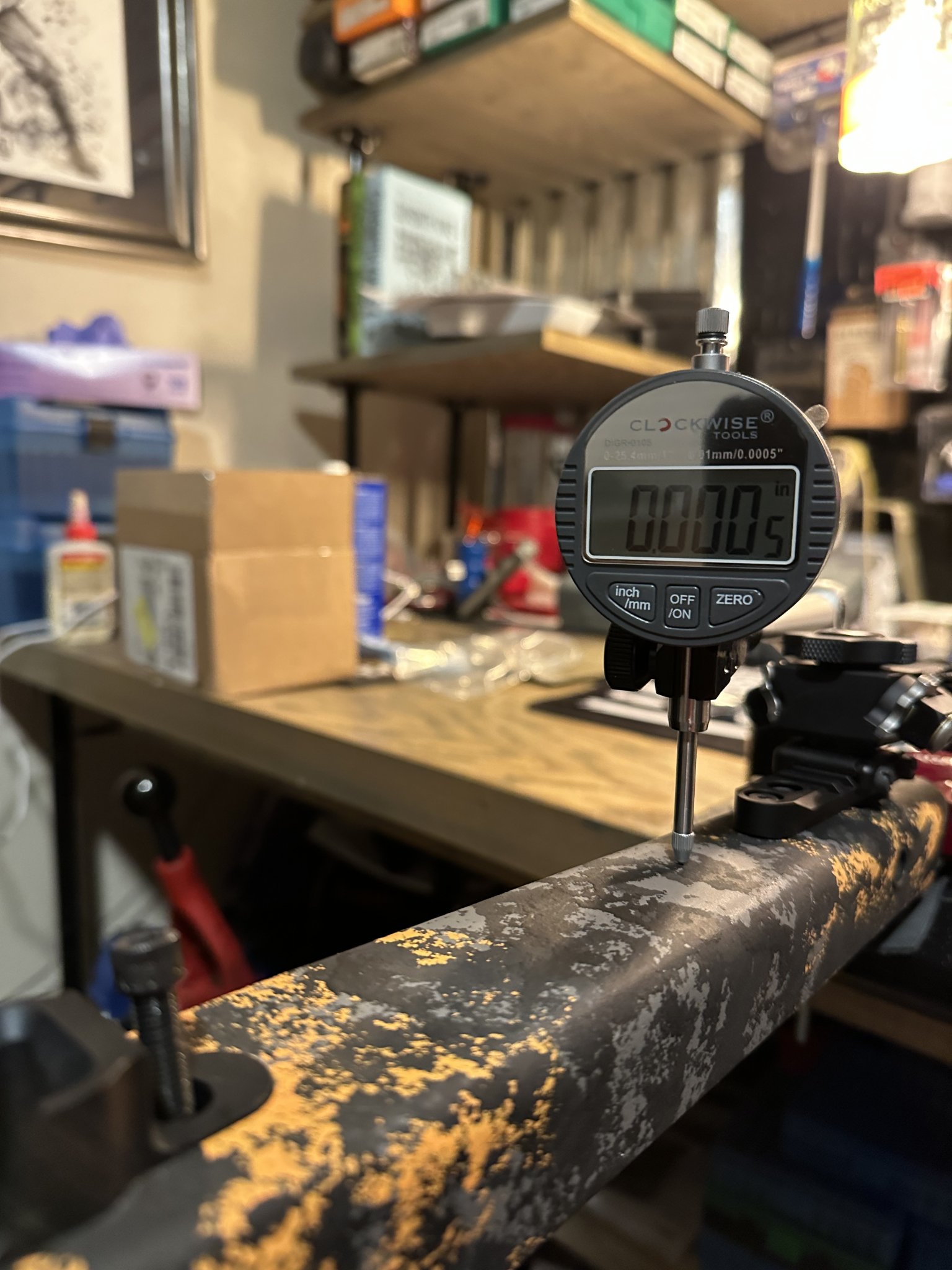

Get a dial indicator with magnetic base. Put the stock in a vise. Put the magnetic base on the barrel near the stock. Put the plunger on the end of the stock near the studs. Have the stock screws snug and zero the indicator. Slowly unscrew the front action screw and watch the dial. If it moves more than .002 the job was sub par. Do the same on the rear, if it moves at all it’s no good. I did a Bergara HMR Pro I bought last week. It moved .220 at first and after bedding .0015. Had a custom a few years ago do about the same. Your on the right track, just don’t let looks make you think it’s good Measure it.
That’s next on my list to get and check
Torque those screws and shoot it .
Should work fine. Post results, good or bad, it helps us all. If bad, we’ll help.
Thanks again for the link with pics of the dial indicator.
Here’s my results for all to see.
Again, many thanks to everyone for their input, help, and critiques!
I’ll have to edit my process in my first post about what I learned.
View attachment 7960430View attachment 7960432View attachment 7960433View attachment 7960434
Other way..
Stock in the vise. Rifle right side up.
