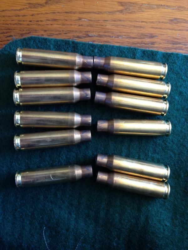

Ok, ran a competition this weekend with the gun. I'm seeing accuracy increase. I took a stab in the dark again with a powder charge. I went with 41.7 grains of IMR4064. I had 35 rounds. I did finally get good crony data at the end of the match. I double checked every load against a 55gr Sierra Game King .224 projectile. So, I'm pretty darn certain that I was getting 41.7 grains of powder about every time. Here are my last 9 rounds of the day. Also, I did get a peak at the Sierra manual and IMR4064 max load was 42.6 if memory serves. I missed one somewhere in the 10.

And for the pics of the brass:
I'm still thinking the scratch is something that shouldn't be there. I called my smith and he said not to worry about it. I'm getting a different stock in the next week and if the barrel channel isn't open enough, I'm taking it back to him to open that channel back up. At that time, I'm actually going to write down every damn detail I can from him, to make sure I can dial in the accuracy. My COAL is still at 2.8 or with in .002. I did do a full length size this time around as opposed to the first 17 rounds.
Let me know your thoughts.
-JD-

Here's a few more cases. The Winchester case was from last season, 42.5'ish.
The brass all measure 2.005 to 2.008. Maybe 2.010. I only loaded 25 rounds, I still have 76 that haven't been touched except to debur the inside of the neck.
-JD-
If you look at the primers they all look different, some good and some bad. By chance are you applying a Crimp to you brass? I learned the hard way with a collect neck die, brass looked just like your's. Now I run a redding comp die bushing set and I can control neck tension on all different type brass. No more crimping for me ever again.
Do what you want, but any one of the pressure signs you have would cause me to start corrective action.
First step would be to back off powder charge. Years ago, I had a Remington .308 that was a hammer with IMR 4064 and 168s. But at 2 full grains under max I had pressure signs, but nothing as severe as what you have.

Your hand loads are still not running in the sweet spot. That is way too much difference in FPS.
Your first loads were extremely over pressure. The very first indicator of too much pressure is erratic groups, and erratic differences in FPS between rounds. You blew all the way past that and got the mother load of ejector marks, cratered primers, and blown pockets.
I was wondering if the bullet is being seated into the lands. New barrel, is the chamber cutter of a standard design, a hybrid or unknown? Try loading a round then eject the round without firing it. If the bullet contacts the lands, it should show indentations on it.
The scratches on the neck can happen with any bolt with a plunger type ejector. When the case neck clears the chamber the ejector pivots the case towards the loading port, right and up. Angle is dependent on extractor type. Depending on case length and the speed at which the bolt is operated the case will hit the upper inside corner of the bolt raceway. Sometimes it's just below the shoulder body junction, sometimes it's the neck. There are several remedies. Reduce the spring pressure on the ejector and/or chamfer and polish the upper corner of the bolt raceway.

I learn from experience and sometimes having someone put things the way you did. Thank you for the lesson. I'll check the other cases to be sure everything is ok.

Cerrocast the chamber.
Verify chamber length against SAAMI spec. Verify case length against actual chamber length.
Verify neck diameter with bullet seated against actual chamber neck diameter.
Somewhere, expected clearances are likely not present.
Try trimming cases to a shorter length, and turning necks to a lesser thickness; see if this alters the apparent pressure indicators.
Greg

I'm far less concerned about primer craters as I am about those ALARMINGLY obvious ejector swipes (gouges, actually). At least one of two things are happening here.
A) that load is TOO HOT! in your rifle.
B) Something abnormal is taking place in that chamber neck area, resulting in severe pressure spikes.
I have seen this before. Shortly afterward, the rifle blew.
Stop what you're doing, verify those chamber neck/chamber length dimensions, and don't fire that rifle again until you are CERTAIN the chamber and neck are sized correctly.
If the Smith used a tight necked match reamer, or failed to ream that chamber and neck to proper length, the net result could end up turning nominal ammo into bombs.
You must take pressure indicators like this seriously.
