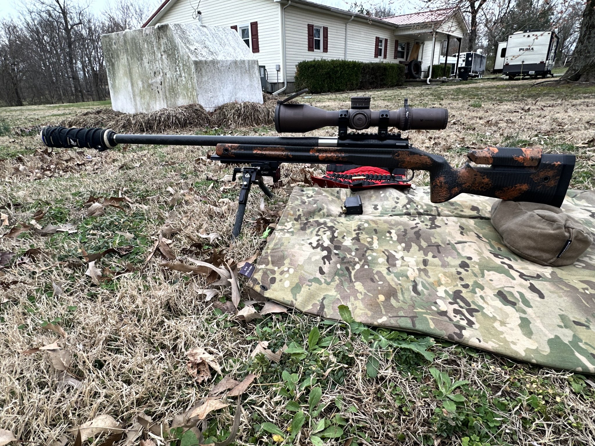

I built a rifle for NRL hunter Open Heavy division back in Dec. ZAI Origin action, TT Diamond trigger, 24” Proof CF barrel in 6.5CM, A419 Hellfire Match brake, XLR Envy Pro chassis, Burris XTR Pro scope, and currently running a double pull Cykepod. Comes in at 14 lbs 8 oz.
Doing load work up I didn’t see any issues with the Proof CF barrel and haven’t seen any stringing or other issues as the barrel heats up. I’m rationalizing that in a NRL Hunter stage the most we’ll shoot in a row is 8 shots (hopefully only 4).
Having shot a match I can definitely see the benefits of a triple pull bipod on some stages but yeah the price point is making me pause. I’ve even looked at leg extensions to get a few more inches of height out of my double pull.
