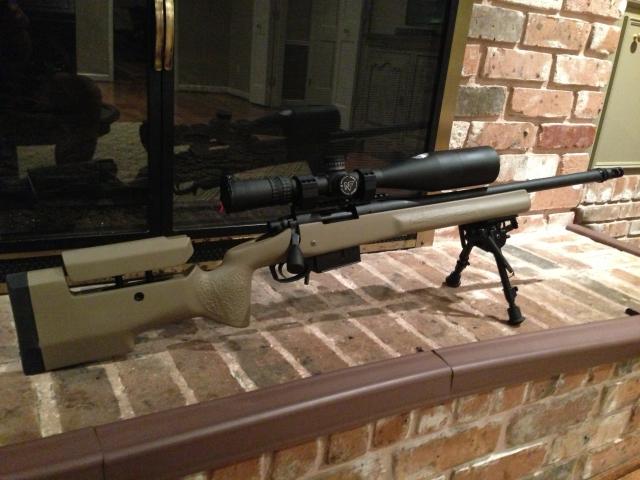

Alright I got my rifle back a couple of weeks ago and am really pleased with how it turned out. Attempting to attach a pic here. Sorry for the iphone pic.
A special thanks to Tom Manners for such a quick turnaround on my stock and to Mark at SAC for the great work and quick turnaround as well. Will include a short range report shortly.

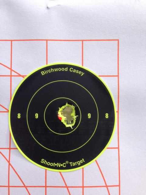

So I finally got out last weekend to sight in the new rifle and see how she shoots. I am so excited for how great this gun shoots. I read a bunch here about barrel break in and cleaning and such (all new to me I might add) and ultimately decided just to clean it before shooting and take it to the range.
After I got the gun on target and fairly dialed in with some PMC 147 gr stuff I had, I got out some 175 gr FGMM and really took my time with the gun at 100 yards. This is my best group, which I think measures right at 0.25 inches. Yes it is only a three shot group, but it looked so good that I couldn't bear to screw it up! (I am a loser I know!)
My other two groups of FGMM measured 0.50 and 0.55. I don't consider myself a good shot by any means, so this is probably the best shooting I've ever done and the best shooting gun I own. I really couldn't be happier.
