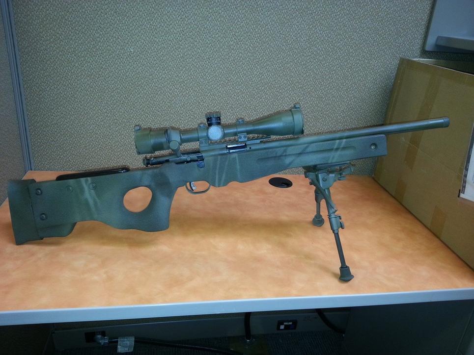

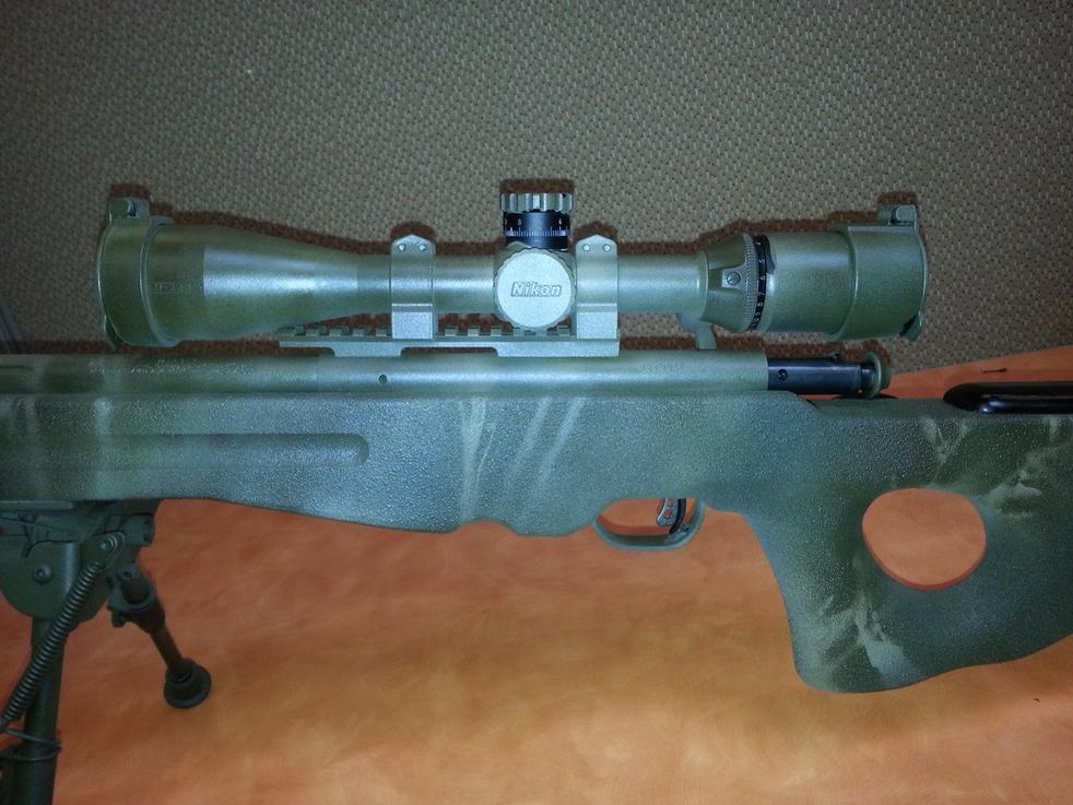

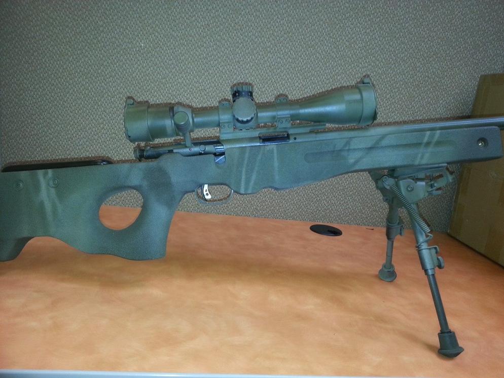

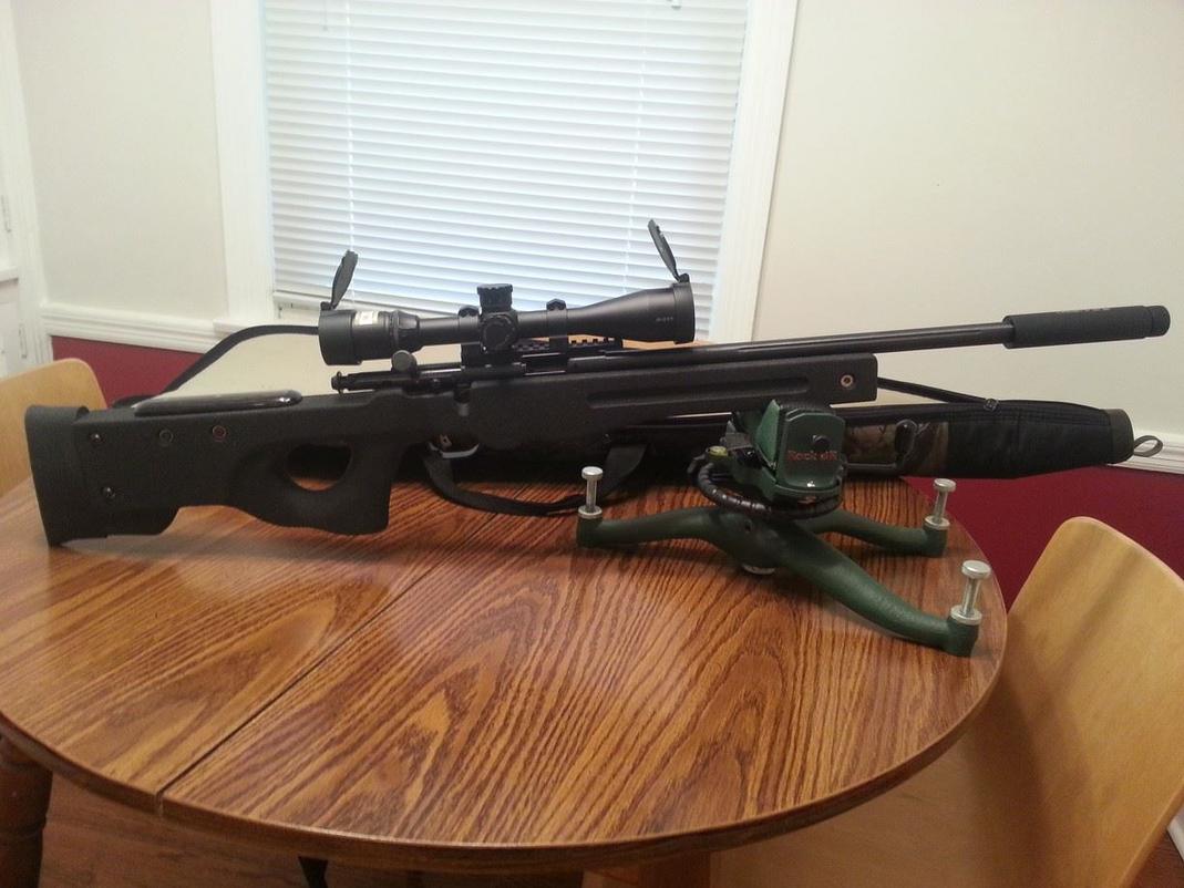

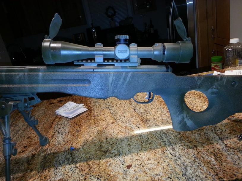

First camo job. Used some Krylon camo, tan, OD, and brown. Then some Brownells matte clear coat. Nikon M223 3-12x42sf BDC with Warne PA rings low height on there. I can slide a dollar thru the stock EGW rail and bell, dont get much tighter than that. Rhineland Arms Savage MK II stock with a custom cheek piece and a Harris S bipod. Using CCI quiets in there mostly. Great for easy and quiet plinking and pest hunting. Sighted it in with those quiets and then marked the turrets and sighted it in with Winchester HV and M22 as well. 3 22 LR loads on 1 rifle. Was a fun build and a blast to shoot.

Looks good. I do like the, 3 - .22lr load zeroing on one scope idea.
Check out Trevor's last two sentences in his post. I think that's what he's referring to? Marking his scope turret for 3 different loads so he can dial in depending on which round he is using at the time? I think that's it?
Now that's a looker! I like that the camo isn't overbearing, nice and subtle. Enjoy it!
Just one question though, what do you think of the LOP on that stock? I have the same stock and it seems just a little to big for me.

Thanks! I wanted a subtle pattern to work with my terrain, north west Illinois and Wisconsin, spring and summer. I'll have to measure the LOP to confirm. I almost needed ext. rings to get the scope far back enough because of the MK II platform and rail. I didnt need to extend the butt pad at all though.
