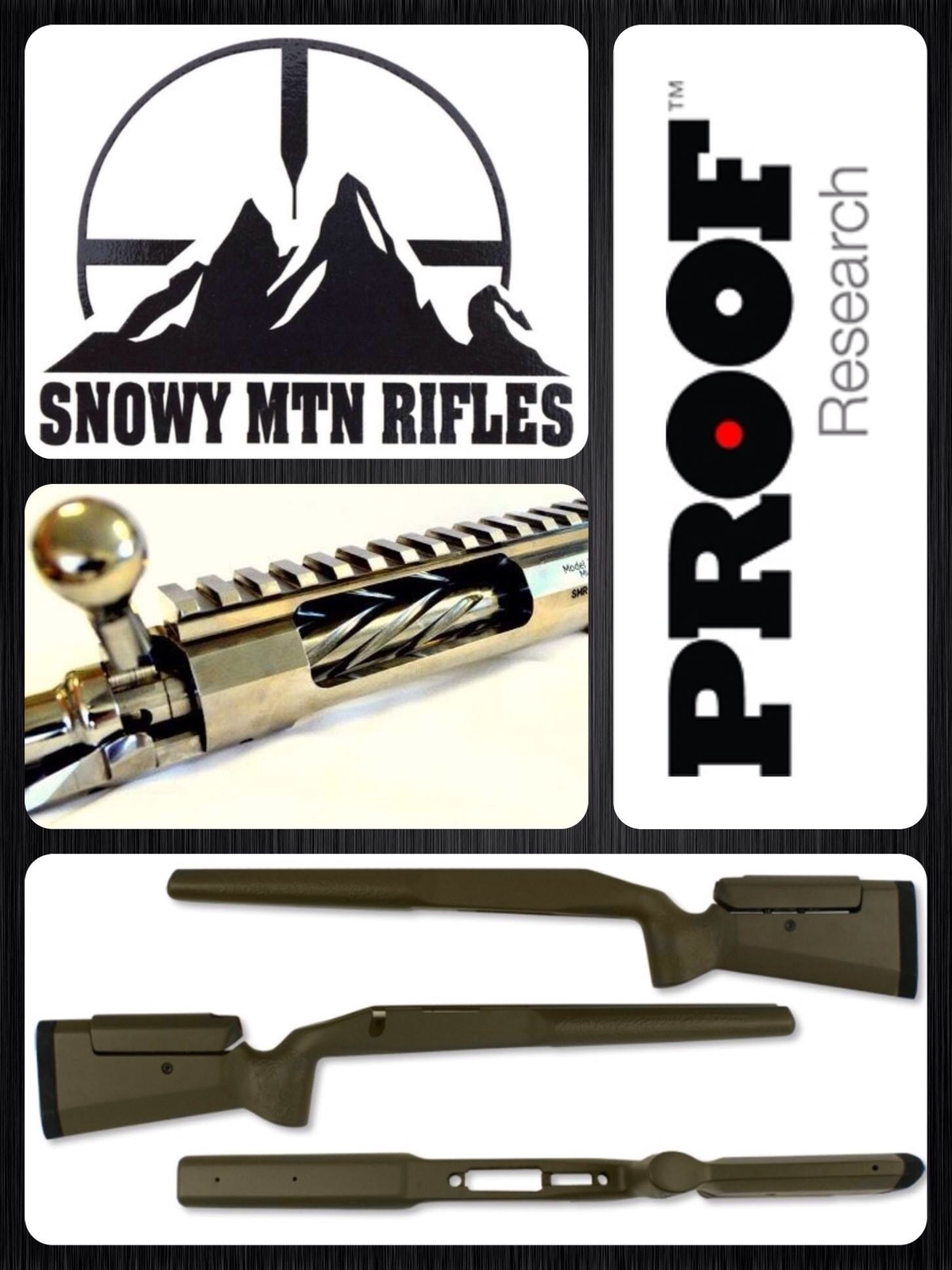

Here is what I've got Penciled in for "THE BUILD"
Snowy Mountain Rifle Company - SMR
6.5x47 Lapua
PROOF Research 1:8" Twist / 24" Carbon Wrapped Barrel / Sendero Profile
MANNERS - T2A Full Carbon Fiber Stock w/ Adjustable Cheek Piece
SMR - ELITE Action w/ Integral Rail & Lug System / Fluted Bolt
SMR - Detachable bottom Metal Accepting Accuracy International Mags
Timney Trigger
Top Safety
Tactical Bolt Knob
SMR- Muzzle Break
Vortex Optics - 4.5-27x56 RAZOR HD Gen. 2 / FFP w/ EBR-2C Reticle
Vortex Optics - 34mm PMR Rings
I am beyond Stoked to fill out the FINAL BUILD SHEET for this Rifle, but I want to hear you all out to hear your opinions and make sure everything is perfect!
I met with Snowy Mountain Rifle Company and took a tour through their facility to check out their actions and be fitted for a couple different stock options and discussed a lot of different options. Jason, Greg and Jim are incredibly knowledgeable and their passion for their work is unmatched. I know that there is no better hands to put this build in than theirs!
I also took a tour through the PROOF Research Facility and can tell you that there is no other Barrel that I would use for this build or any build for that matter. Their superior carbon technology and premier manufacturing practices opt for unmatched barrel life and accuracy!
LETS HEAR YOUR THOUGHTS. I greatly value your experience and opinions, Thank You
