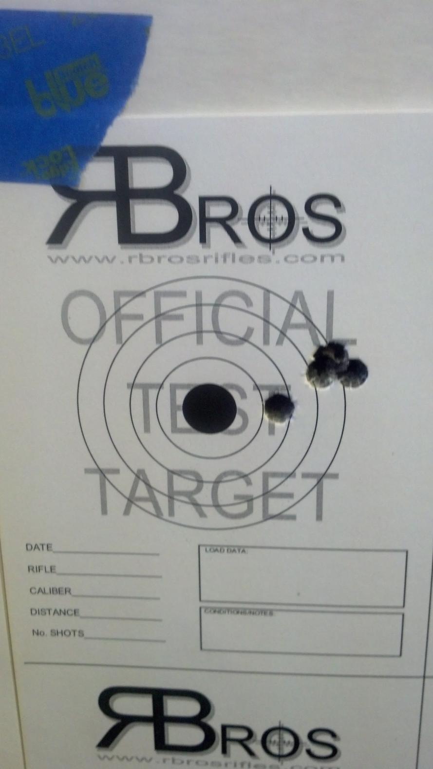

I am envious of your shooting location. Hoping to visit it this fall! For those wanting groups, this was rounds 6-10 out of the gun. The low left was a clean bore fouler, then the following 4 are the group. All breakin and testing is done prone with bipod and rear bag under field conditions for those wondering. I imagine she will settle in nicely :). This was with virgin brass, 180 Berger at 3130 Forming loads.

Travis sends the load data with all his rifles. I shot 4-5 shots to get zeroed @ 100 & started trying to stretch it out a bit. I don't see the point in spending much time shooting @ 100. I've shot it out to 990 so far, she's lookin like she'll be a hammer. I've shot 1200+ rounds through my old Sendero in the last 7 months. I'll definitely be sending it to Travis when it's time for a new barrel.

I measured the 4 shot group Travis sent with the rifle. It measured .511" outside to outside, or .227" center to center. That's the only 100yd group I have. I shot it last night & this morning @ steel @ 520 & 645yds. Looking through the scope, it put 3shots into one blob. I'll try to get a couple pics when I repaint targets. I think I might be the weak link with this one lol
