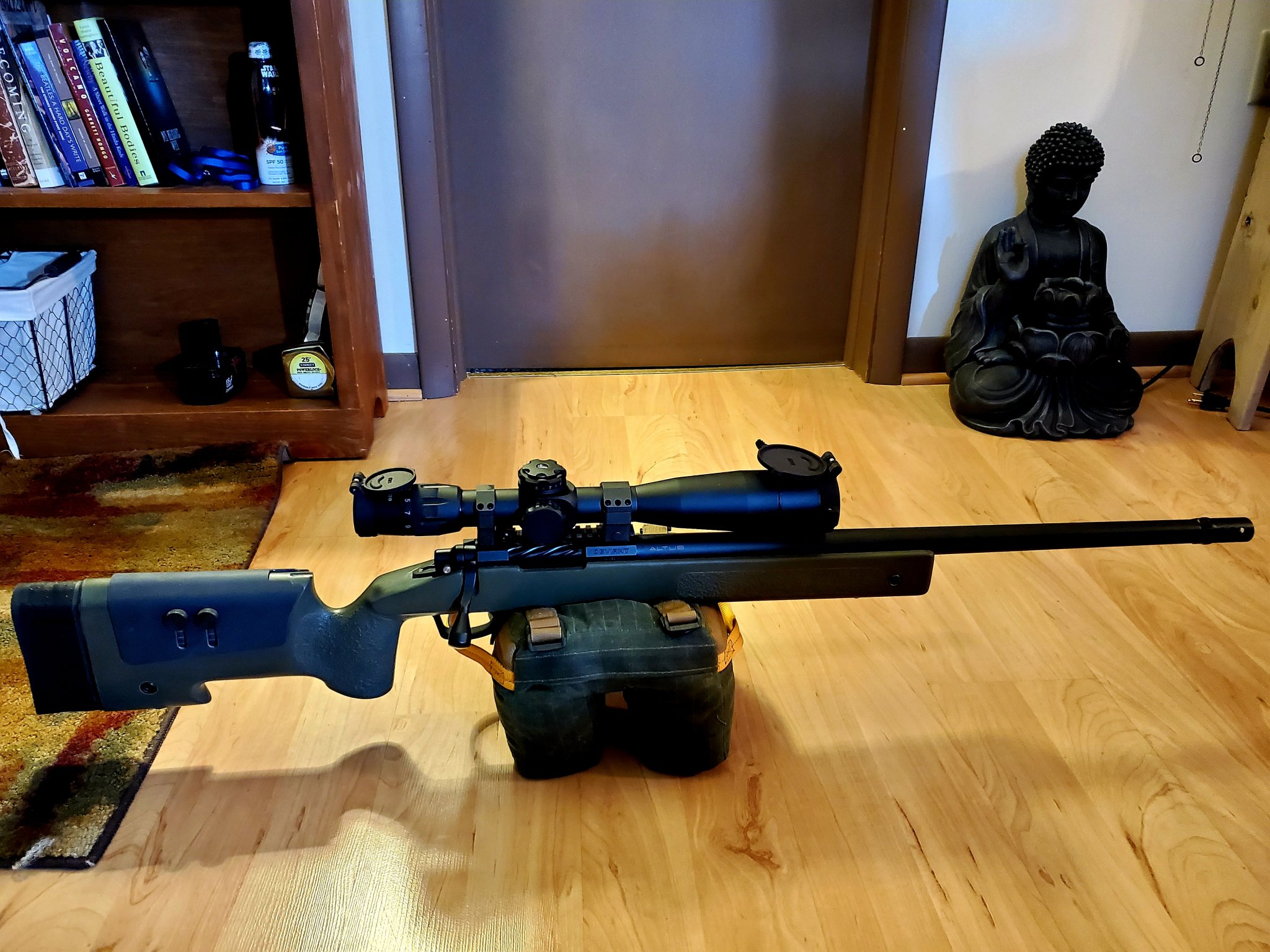

The barreled action finaly came in from altus this afternoon. Extremely pleased with the feel of the action being my first custom ever. and altus machining job looks to be top notch finish wise.
I had to relieve the stock a little bit for the bolt release, only took a few minutes with a set of jewelers files. The steel usmc badger rings seem to be built heavier than my 2nd gen dodge diesel. Tried the plumb bob trick to level the scope it seems to have worked pretty good the range results will tell.

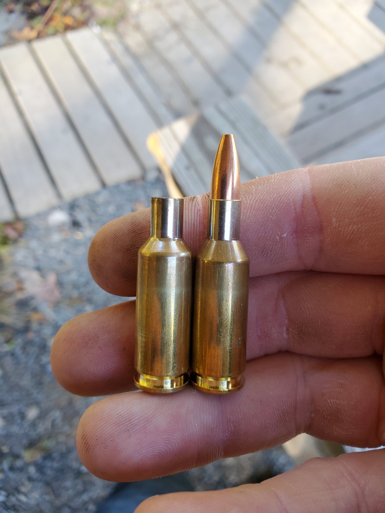

I got all 300 rounds fired this afternoon, the extra grain and a half definitely helped sharpen the shoulder. They might need fired one more time to fully blow it to the 40* but there close enough to start load development.

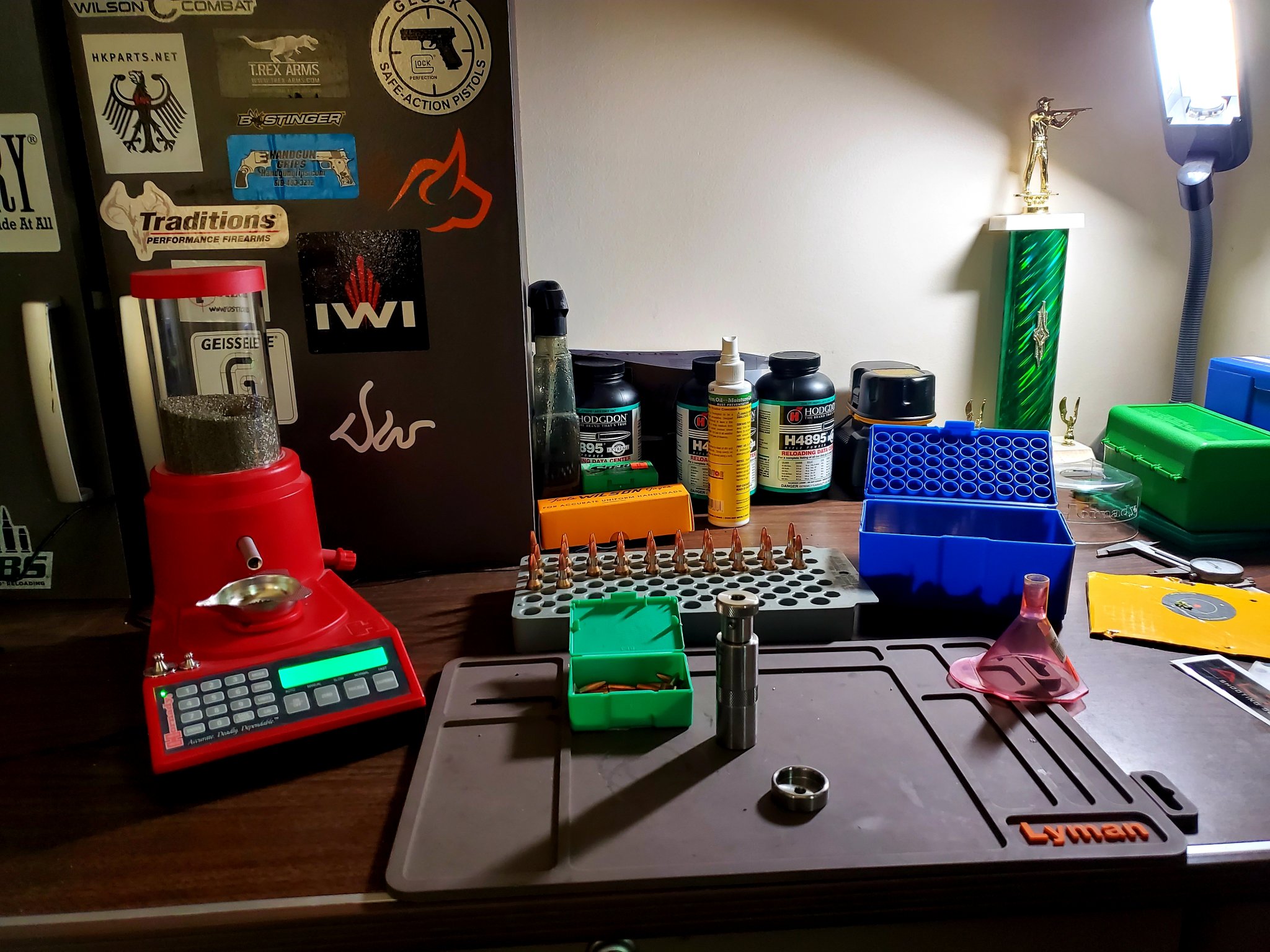

Getting some loads done up for testing tomorrow. using cci450 primers, 107smk pills. Making 5 rounds of each charge to shoot groups. Starting with 29.5gr of 8208xbr going up .3gr at a time to 31.6. Rinse and repeat with h4895.
Note to anyone using Wilson inline seaters buy the arbor press, it gets old quick seating a few hundred bullets by hand.

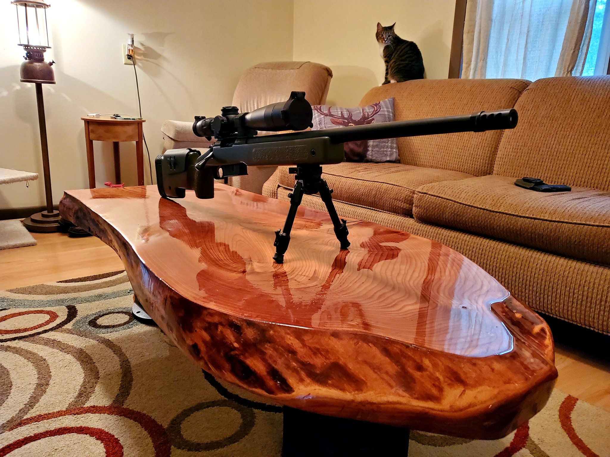

Nice kitty!
Nice setup. I also love that table.
Thanks it looks nice but it sucks to move around it's every bit of 400lbs. I got the slab of wood from the amish saw mill down the road from my house used the pour on epoxy bar top finish on it, the wood is catalpa about 6" thick 5ish ft long. legs are pistons I got from the boat I work on after we repower packed one of the main engines with all new cylinders pistons and con rods. There about the size of a 5 gallon bucket 130lbs each.

Nice rifle. Now tell me about that awesome chunk of wood it's sitting on!
Edit: Just read the above post.
Reactions: brianf
It was a slab of live edge catalpa wood I got from the amish fellow down the road from my house. About 6" thick a bit under 5ft long it's a HEAVY sob, finished with pour on bar top epoxy, it's got some tiny air bubbles on one end but it was my first time working with that stuff so I think it came out pretty decent. The legs are pistons from the boat I work on we rebuilt one of the main engines they were going to scrap the pistons so I snagged 2 of them. They are from an MTU 8000 series v20 quad turbo roughly 11,500hp engine.

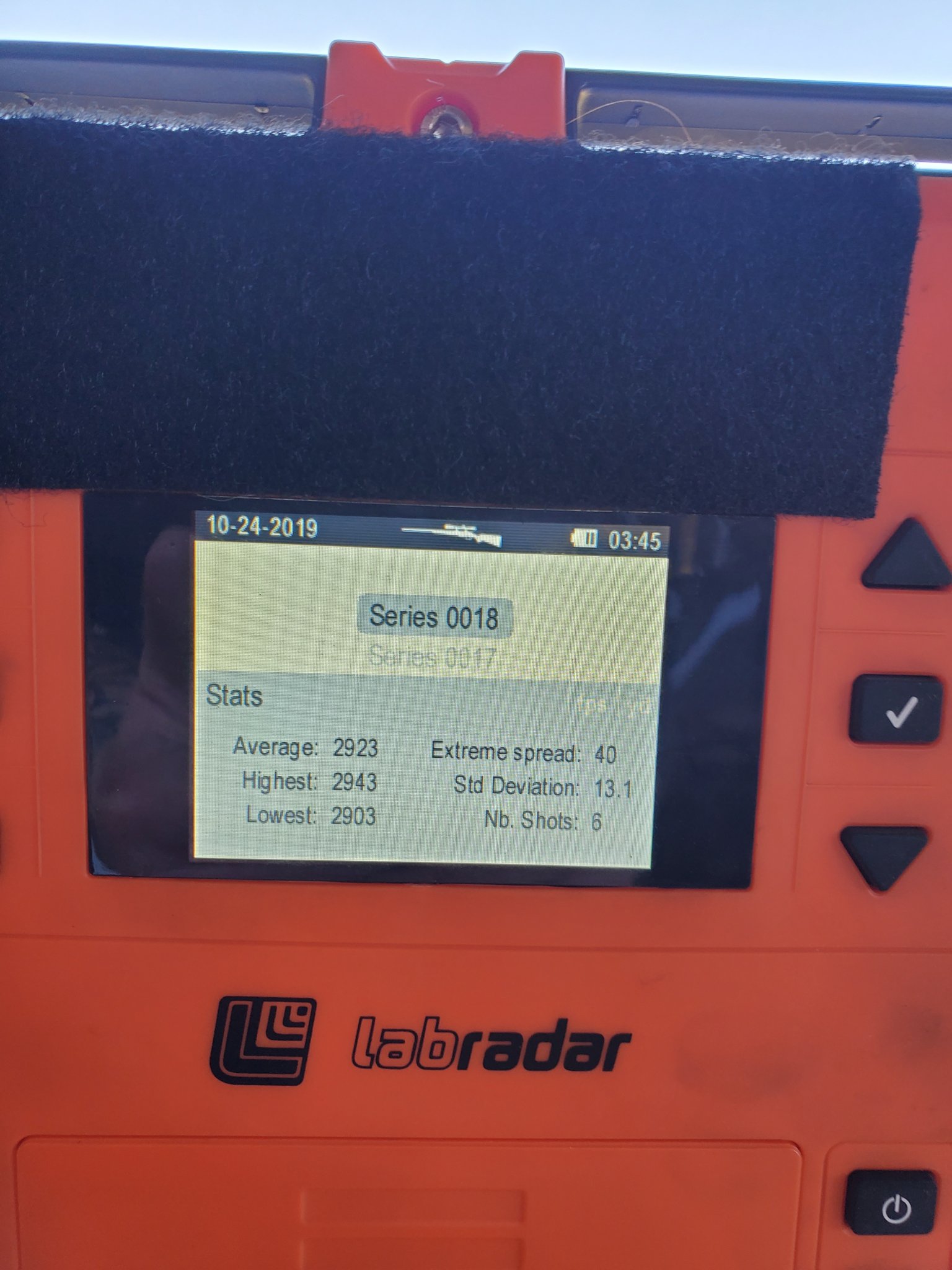

One of the instructors had a labradar there so we found out what my loads were actually doing. I will say I was pretty surprised to see that velocity, most of the 6mm guys say you need a 26" barrel. This is with a 24" 31gr of 8208xbr and 107smk. I'm thinking I need to mess around with the neck tension a bit to get those numbers a bit lower.
