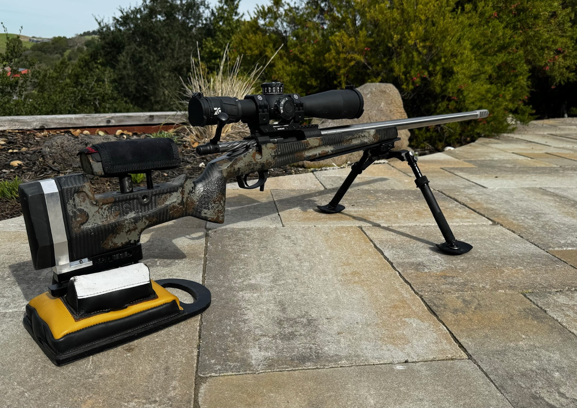

You were asking about cost - something similar to this would be:
- This is a Defiance Deviant action, but any of the higher end customs would work fine: ~$1600
- This has a Triggertech Diamond, which would be ~$300
- Manners stock ~$1400
- Custom Bartlein barrel (1:9/8 gain LH twist, 400MODBB) - I forget exactly how much, but call it like $500-$600
- Get barrel cut: ~$500
- Mags @ ~$100 per
- Arca rail and misc hardware, ~$150
- Bedding and assembly I want to say was like $1000
You could do it for less by getting prefits, a chassis, putting it together yourself, etc. - I prefer stocks over chassis, and prefer barrels that I won't get in prefits.
