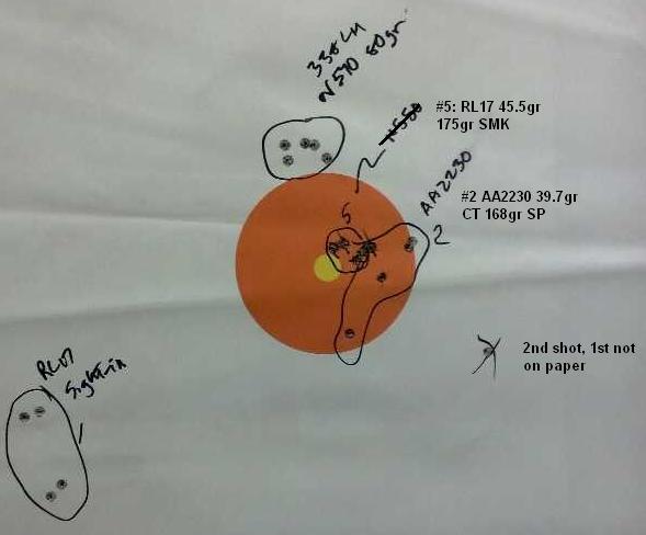

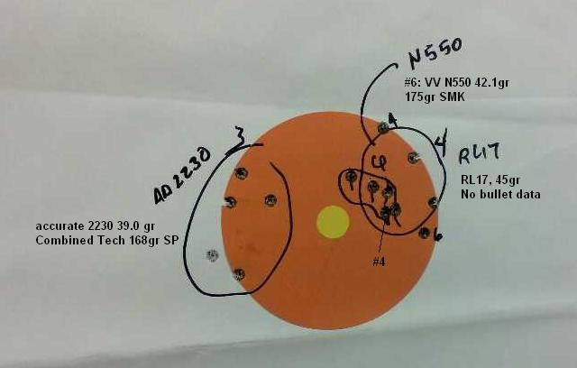

Gotta admit I need to keep better records. Some of my loads were not marked well
DPMS LR308, 1:10, 16" barrel. 100 yards. All loads COL 2.800 (mag length)
Late evening, so no chrony data. Shot from a bench using Harris bipod.
Scope wasn't level so I leveled it, then sighted it in, then did the shots. All aiming at the yellow dot.
IMO the 2230 produced chit. Too bad I still have 6# of it.
The N550 and RL17 look promising, need to do more accurate workups.
Supposedly VV powders burn the cleanest, but I found them to be the smokiest of all. Perhaps too slow.
The RL17 seemed the loudest, which to me would indicate incomplete burn in the barrel. However, I think I'll use it to test out my heavier bullets (180 & 200gr BTs)
A ladder test is not done at 100yds. More than likely you won't be able to tell anything from a ladder test at 100yds. Were you using increasing charges for each particular powder or what? It looks as though you just chose random charges of each powder and shot groups.
It's pretty simple, really.
I'm making up numbers here, simply to illustrate the concent. Say you have a start / stop of 37.0 / 40.0 grains. So load up one round each, starting at 37.0 and stopping at 40.0, in .3 or .5 gr increments (or whatever floats your boat).
Take a tall target (at least 2 feet, preferably 3), and put it at at least 200 yards (preferably 300), and shoot at it, aiming at the same spot every time, without adjusting your scope between shots. Pay very close/careful attention to which bullet hole on the target is from which charge weight. Label them all, take a picture, and post it here. You'll get plenty of help interpreting it then.

I had worked up a bunch of .4gr increment loads but when I started shooting, I just grabbed 5 of a load at a time.
