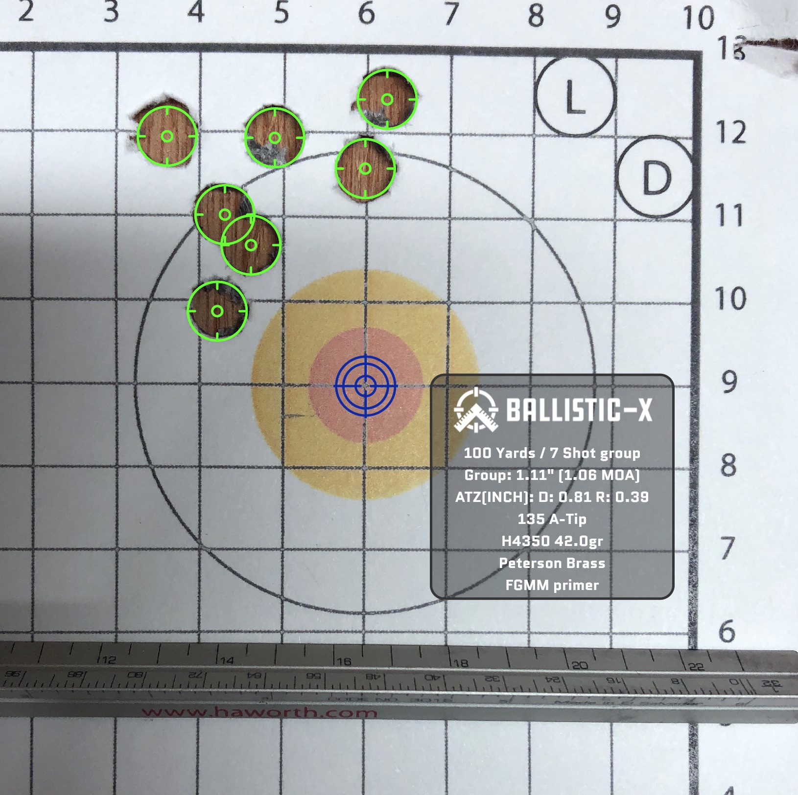

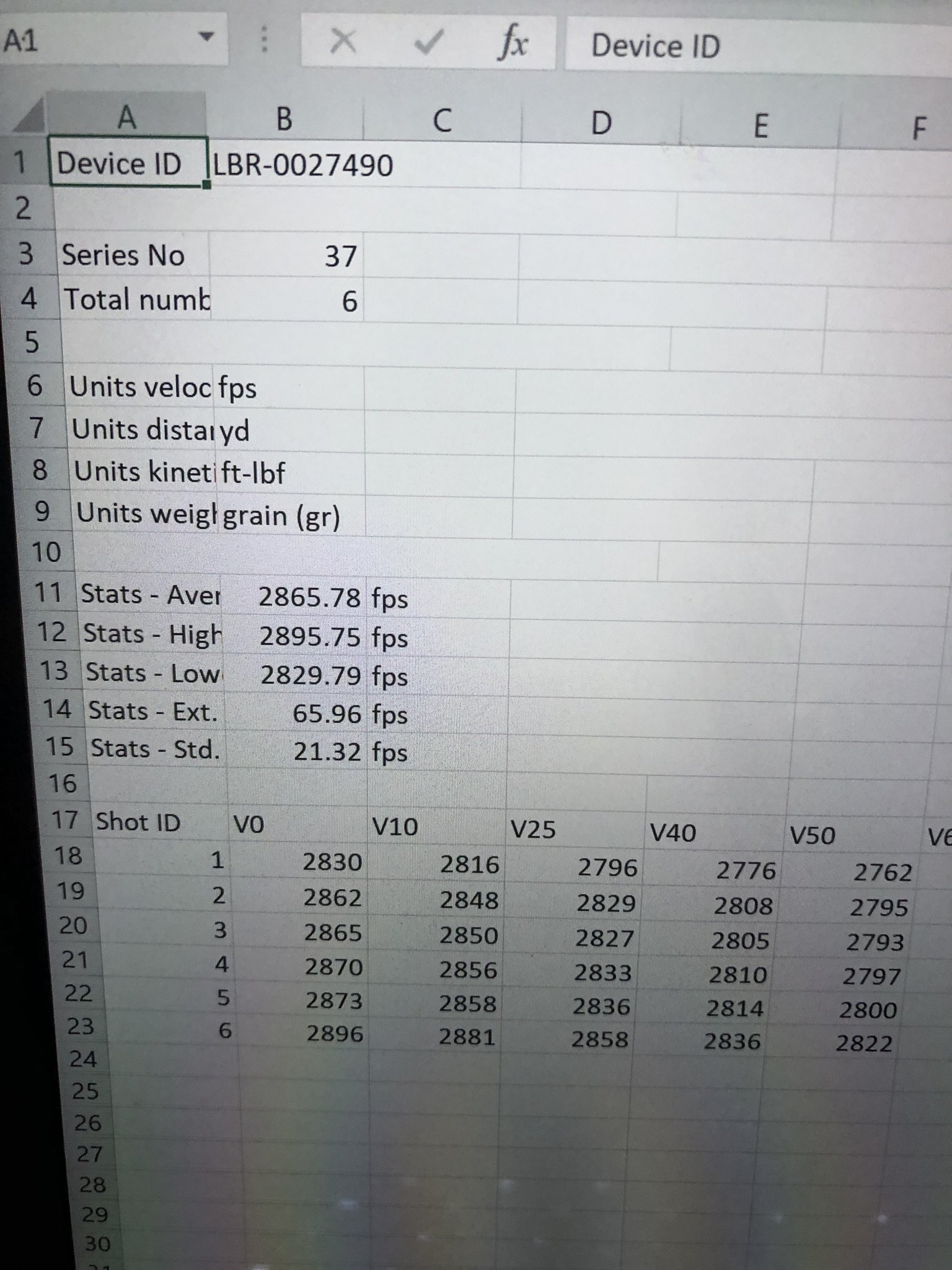

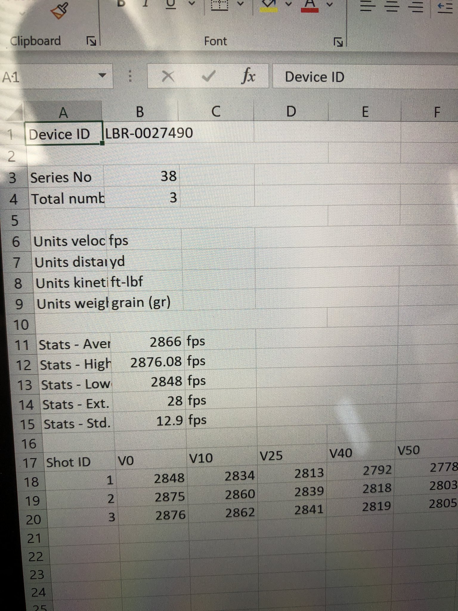

Finally got around to loading some of the new 135gr Atip bullets. Accuracy was decent, was not happy with SD/ES
thoughts and input on where to go from here would be greatly appreciated.

So couple of things where would you focus your load development on charge weight?
And suggestions on tightening up SD/ES? These were my first loads on the new balance. Prior to this I had been running a charge master and my 6.5x55 routinely were single digit SD
these were fired over about a 3hr window. In between I was helping another shooter. Although not super high ambient temperatures the sun was intense and over head and I didn’t think to shield the ammo would you attribute the heat to the SD at all?

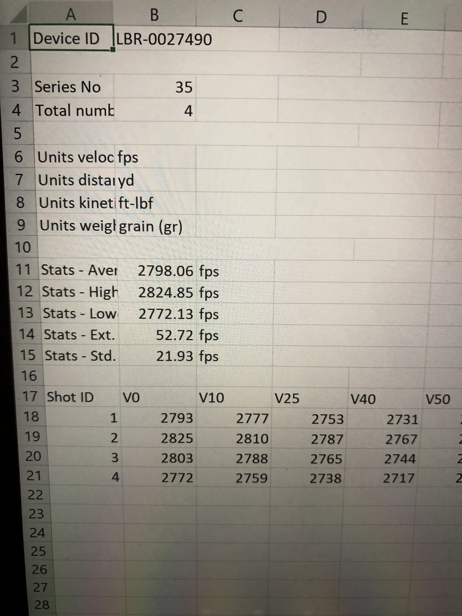

although my SD was not where I wanted it, I’m not sure that I would agree that the velocities are all over the place. Largest SD was 22fps. Am I not seeing something I should?

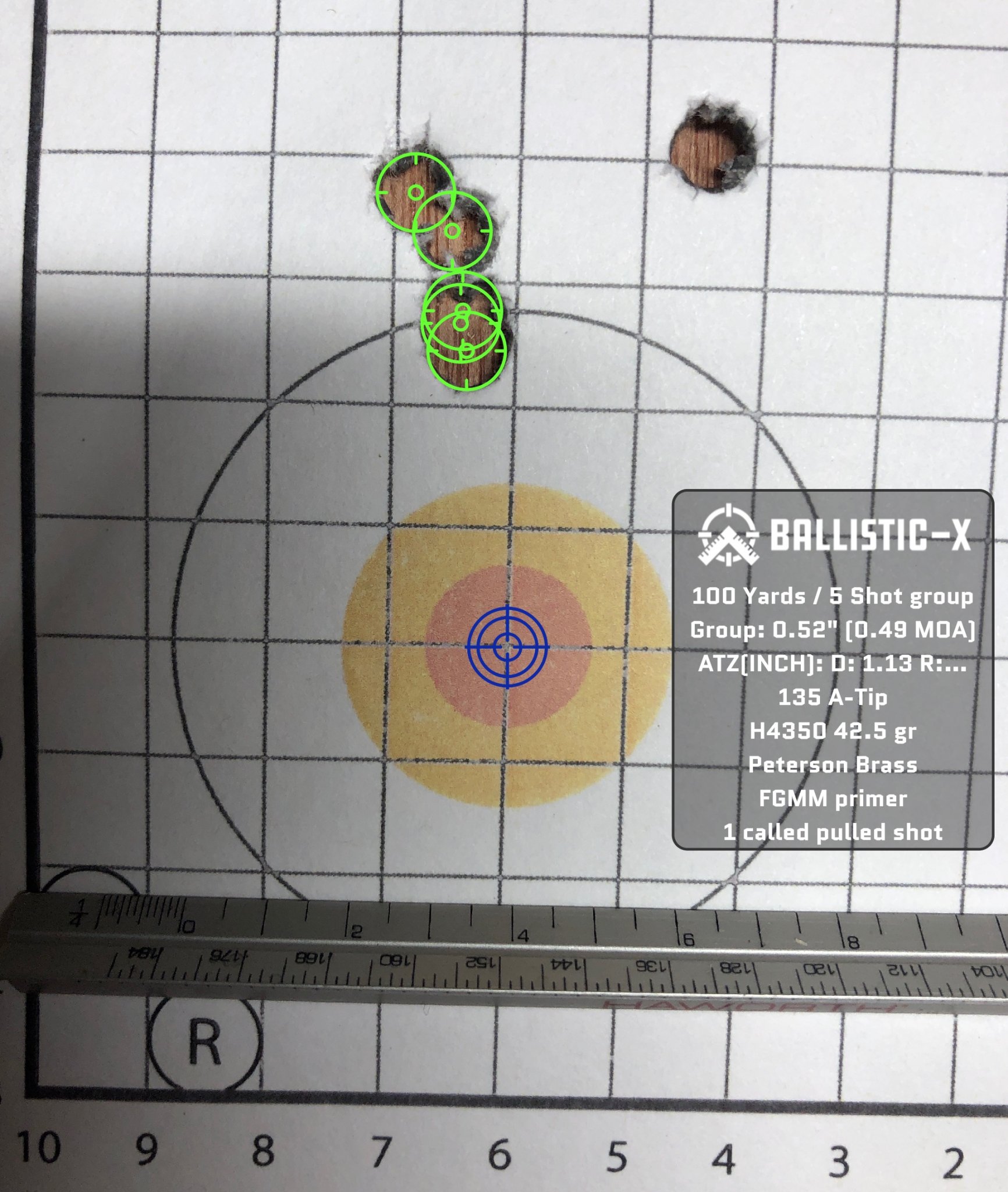

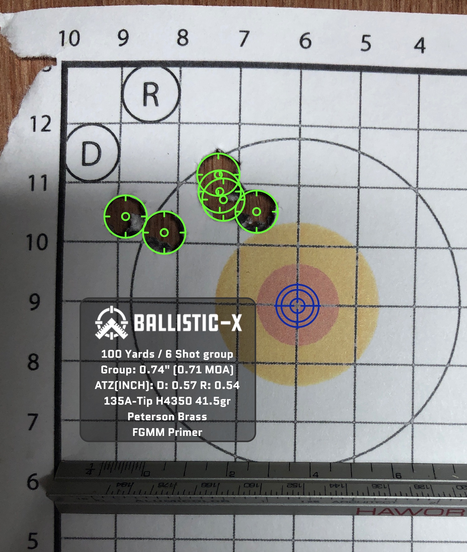

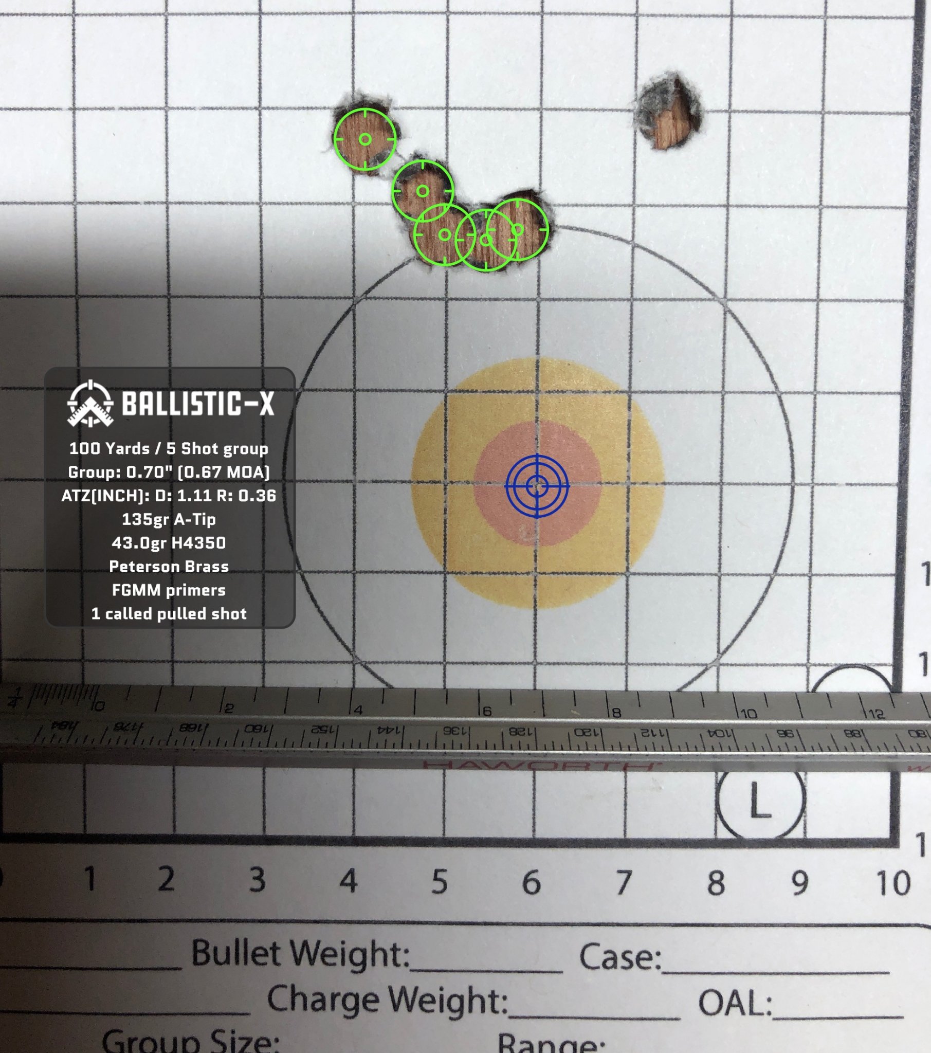

just in case it went missed please keep in mind those are 4 Separate loads 41.5 - 43.0gr

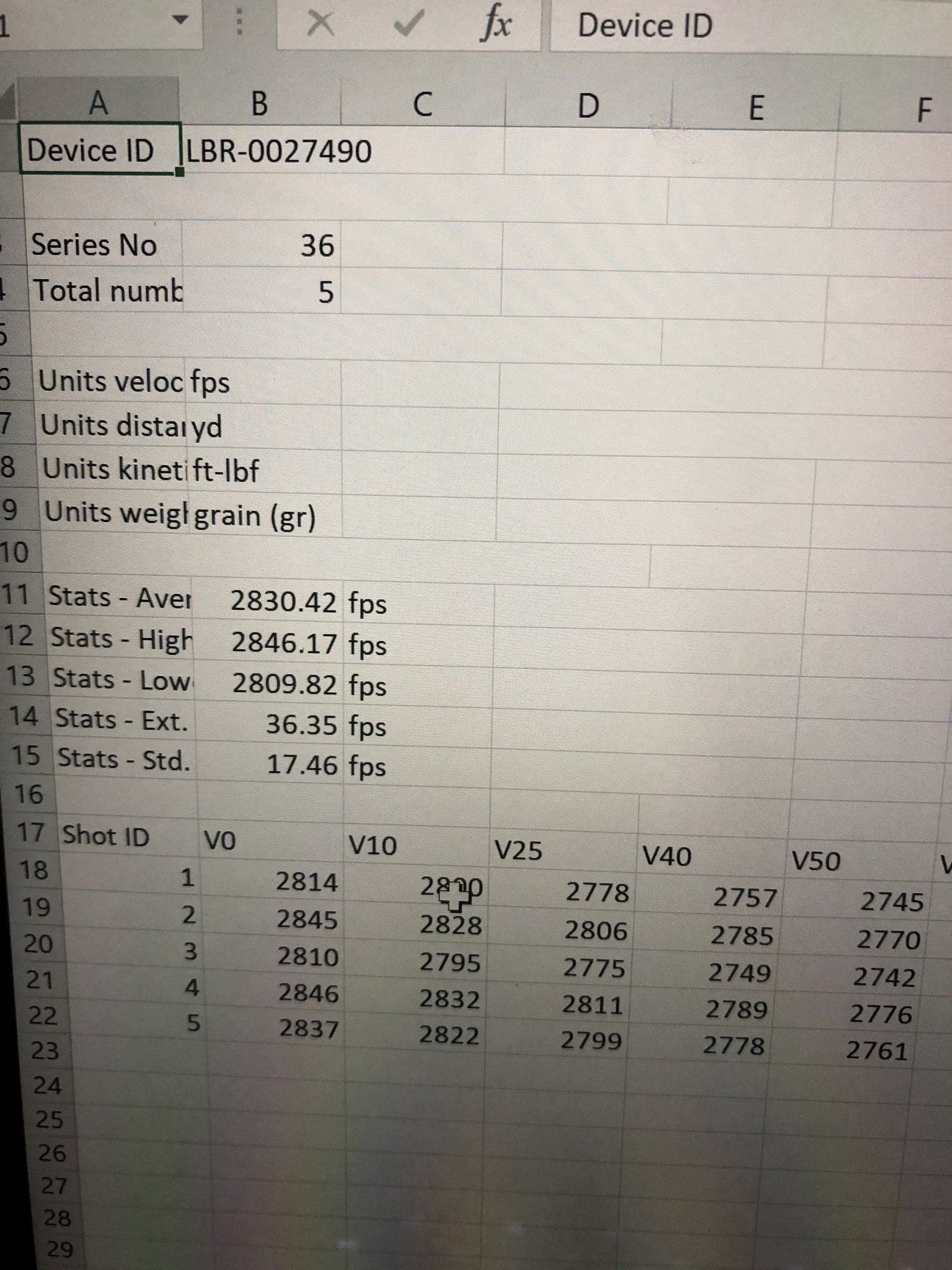

2830 to 2896? Is that one charge?
yes one charge. Charge 3 42.5 had the largest ES
7 shot string 6 recorded shots
It was a slow string. You can see the velocity increase over the string. That’s why I questioned if the ammo backing in the sun may have been a factor
A temperature swing resulting in 66 fps difference with H4350 powder? Possibly, but uncommon with my not so scientific experience 😉. I would get down to going over your brass prep routine again. Repeat.

I would work between 42.5 and 43. I’m suspicious of your velocity data. You ES is driven by first shot each group except the first.
