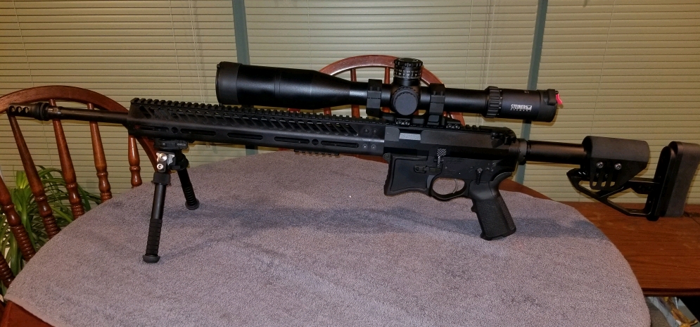

Looks like a good plan/ list. I have the upper combo you're looking at. It's rock solid. My barrel is 20". It's been very accurate. The stock you listed is nice as well. I like mine more than the PRS that was on it a while back Had the rifle for a while and really enjoy it. Only thing changed in the pic below is that I went back to an Ergo grip.
