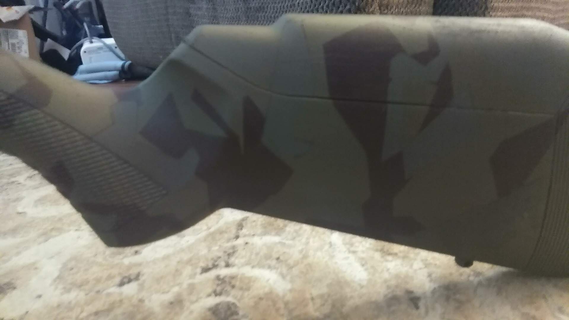

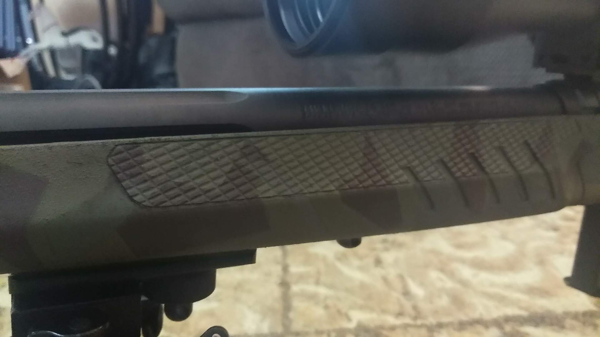

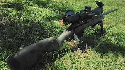

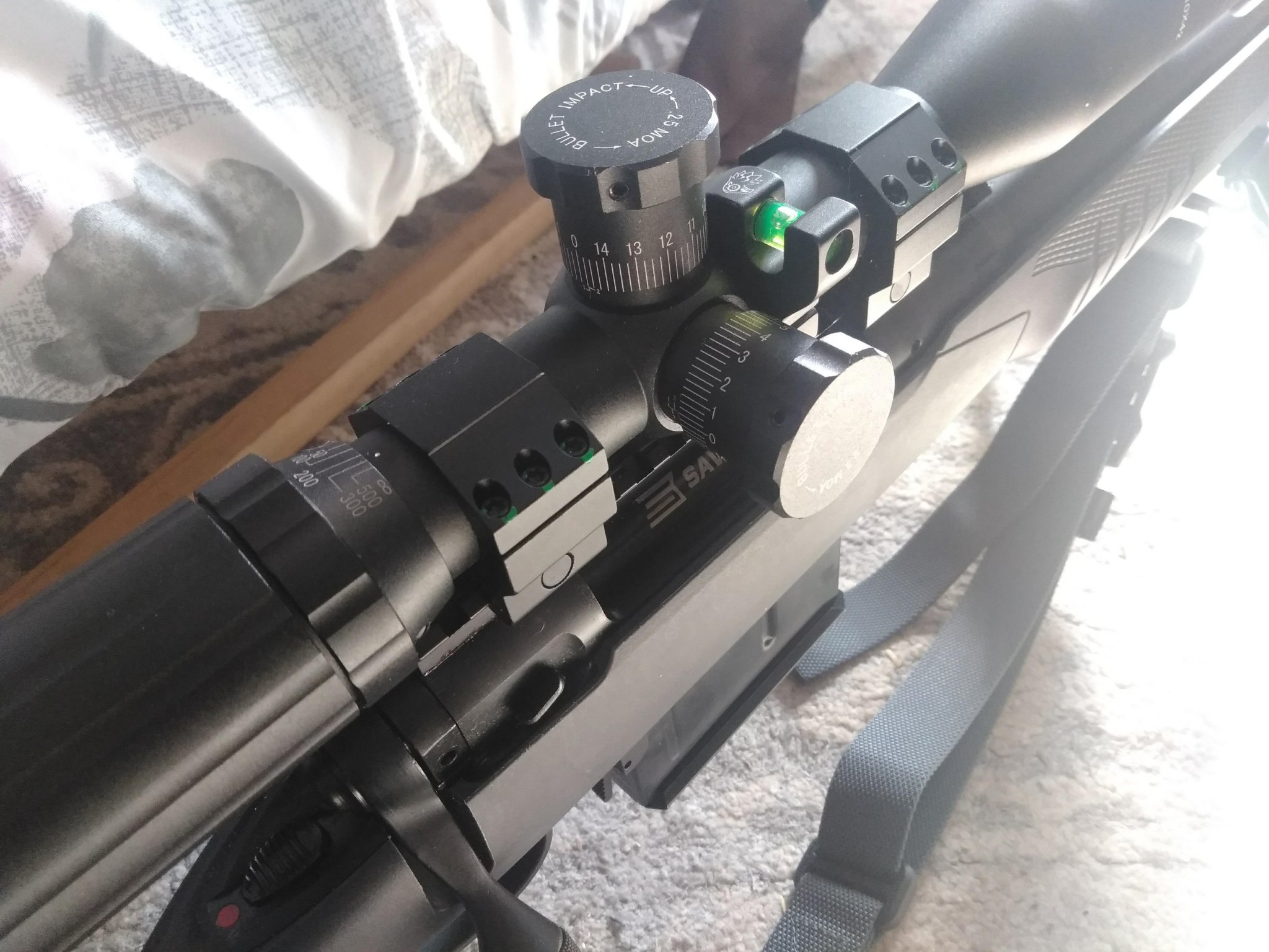

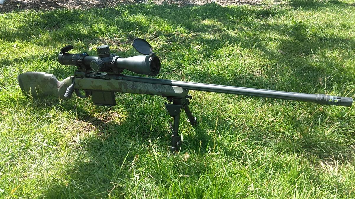

This is my first Magnum Rifle Build. Just an inexpensive (generally speaking) rifle.

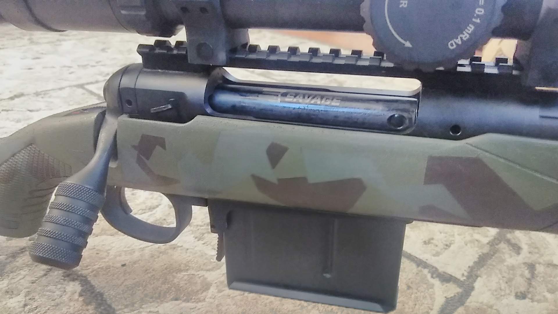

Savage 110 Tactical Chambered in 300 Winchester Magnum.

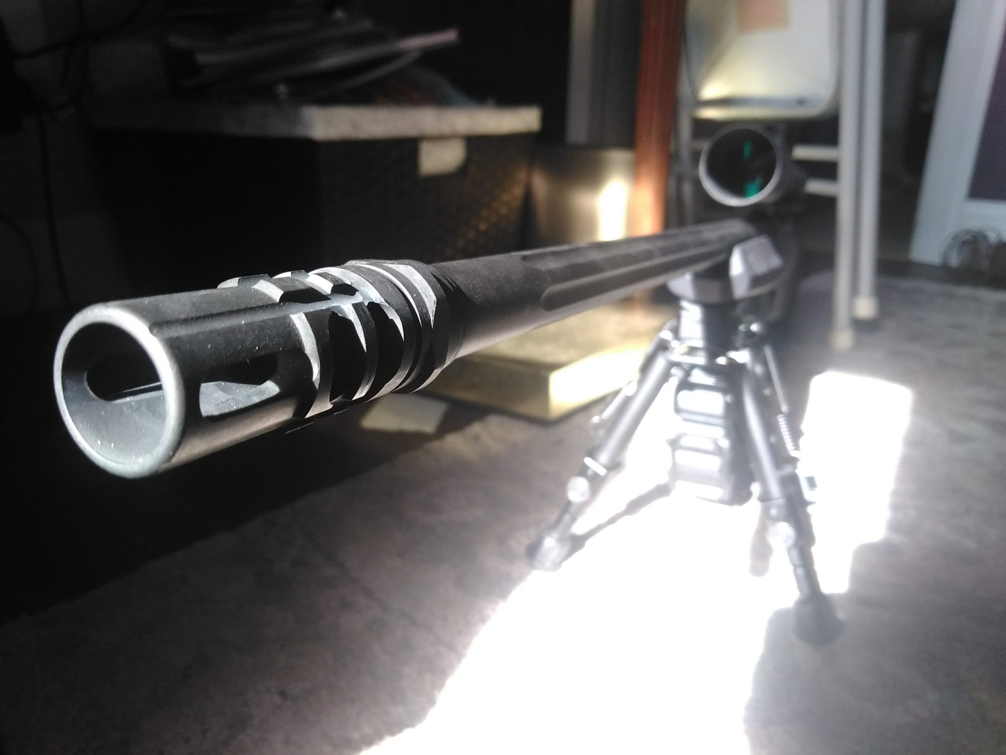

Strike Industries J-Comp (5/8x24)

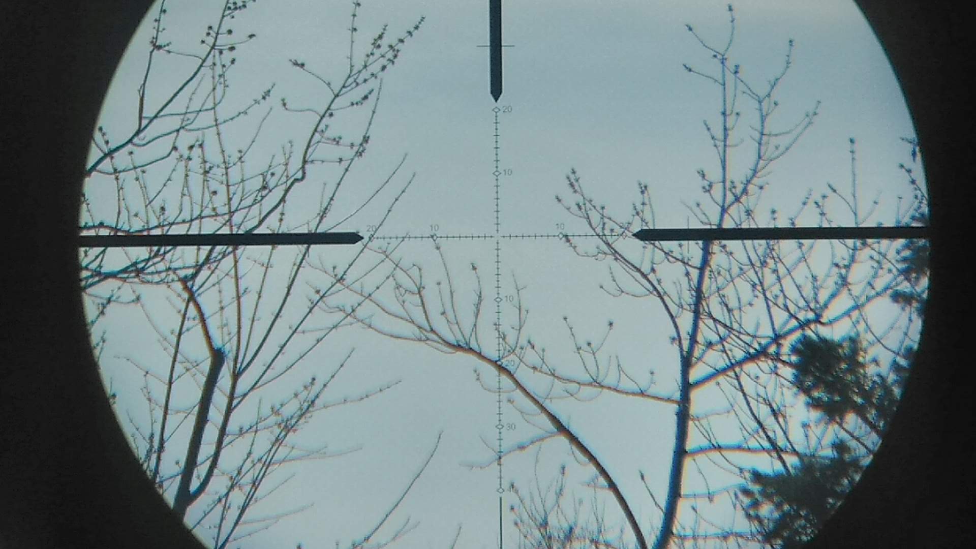

Scope is a SWFA SS 10x witha MOA turrets and a MOA reticle.

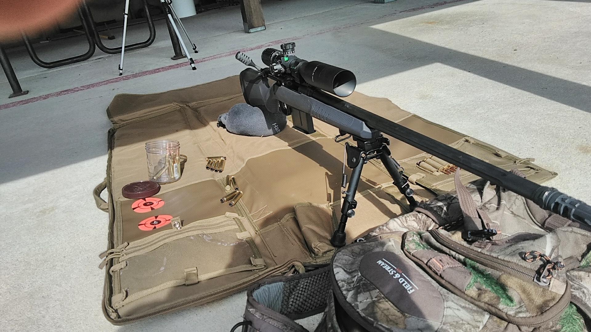

Handloads for this rifle are just incredible.
Shooting golf balls at 300 yards with this rifle is starting to get boring.?

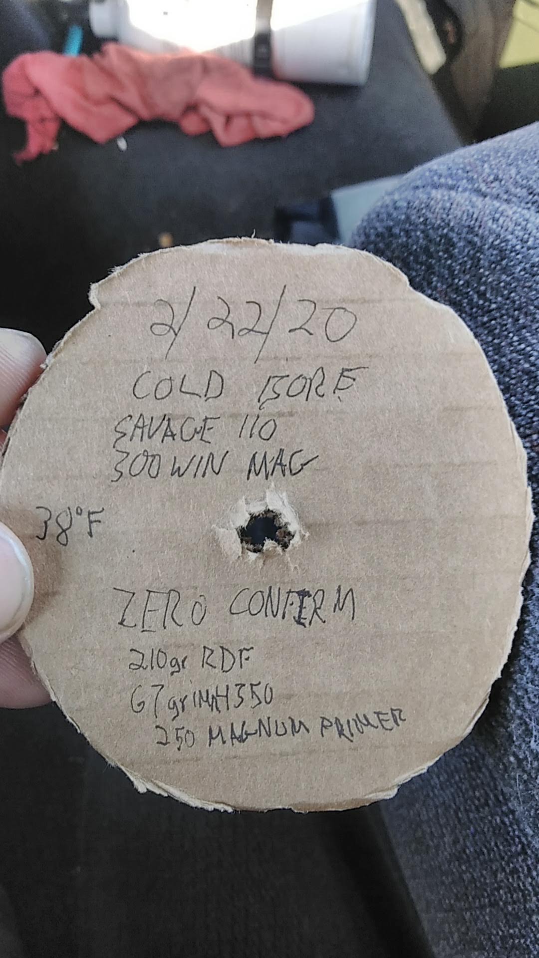

Best load for this particular rifle:
Nosler 210gr RDF (308 dia)
67gr IMR 4350
CCI No. 250 Magnum Primers
Sig Sauer 300 Winchester Magnum casings
~0.005 bullet jump (COAL: 3.600")
I don't have a Chronograph so I cant give speed of the bullet
I really like this rifle and honestly its one of my favorites.

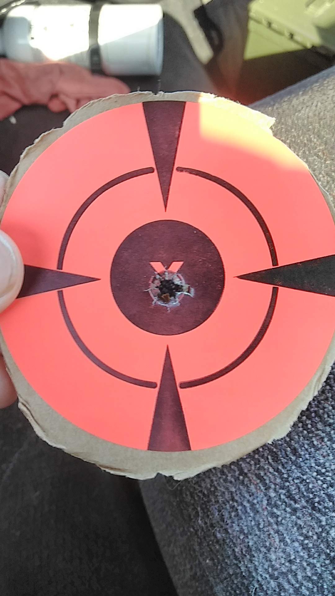

This shot was taken at 100 Yards just to confirm cold bore zero.
