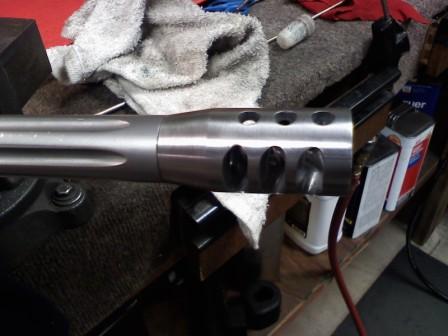

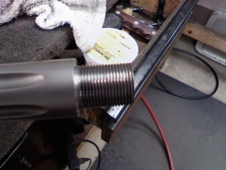

    its not fancy but It works great and is fun to do with equipment I have laying around the shop. did this a while back on my 338rum sendero.

    It shot very well, It too some recoil out and made things LOUD... I like it..

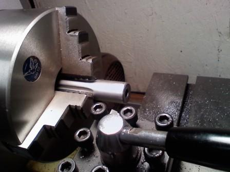

    I took and cucked u the brake and found my center line of bore. I then used the dead stop on the lathe to hold a drill bit. Then opened it up to .368. installed the brake and triple checked the center line to make sure everything was straight and centered.
    I'm not a machinist by a long shot but I'm learning.

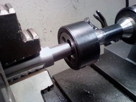

    How did you indicate the barrel using a 3 jaw chuck and why not single point thread? Bores are rarely concentric with the barrel's OD.
    While I agree single point threading is better if you indicate the bore then turn down outside concentric with the bore a die can be used to cut threads quite well if held properly. He also gave a large amount of wiggle room on bore size as he is .030 over bullet diameter which is alot. I run my brakes about .010 over bullet diameter as the more it is the less efficient the brake works.

    To start, don't ever use a die to thread it. If you like what you made, start marketing them. Problem is a kajillion other people are doing it. If for your own use / customers, have at it. I gave up making brakes as every swinging dick makes them. They have the monthly payment on the CNC macheens and I buy them for cheap. Scope rails, same story.

    Notice I didnt say this was the right way to do it but I would like you to tell me what is unsafe about it? I know it is not the proper or correct way to do threads on a muzzle but I don't understand the unsafe part. Save your smartass B.S. for someone else and if you know your shit answer the question. I wouldn't ask if i wasn't wondering if you saw something in those pics I didnt or what would make you say that. Again, not the way I do it or was taught to do it but i didn't see it as unsafe...maybe not proper but not unsafe.

    The sad part is those die cut threads look nicer than some single point threads that come out of some shops.
