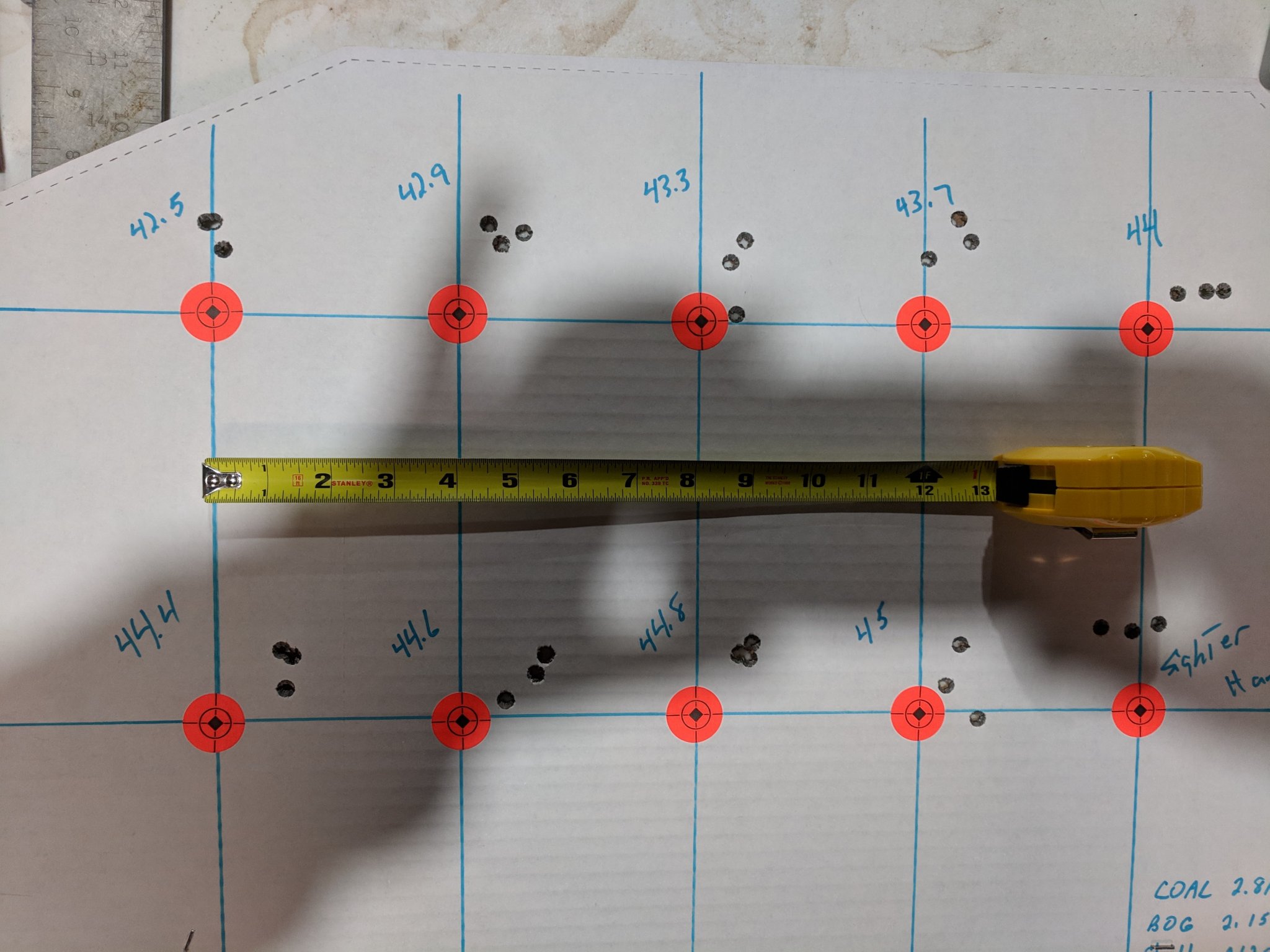

I received a reloading setup for Christmas and loaded 30 rounds with Varget and 175gr Hornady BTHP. Went out today and shot an OCW. I think I know what I am looking at forresults but would like some input on where you would start for load development and fine tuning. Worked up from 42.5 gr to 45gr. My next outing I was planing on Loading 5 rounds each starting at 44.4 up to 45 grains.
Where would you look and what would your next steps be keeping in mind I don't have a chrono yet.
Your input and help is appreciated.
If it helps this was shot with the .308 RPR loaded to max mag length 2.810 once fired FGMM brass and FGM primers. Neck was bumped .0015
Thank you in advance

I like to look at group location. Compare group location from one load to the next and if they are in the same location, take a look at group size of each load. If there's a small-ish group along with another group printing in the same location I'll fine tune around that load recipe.

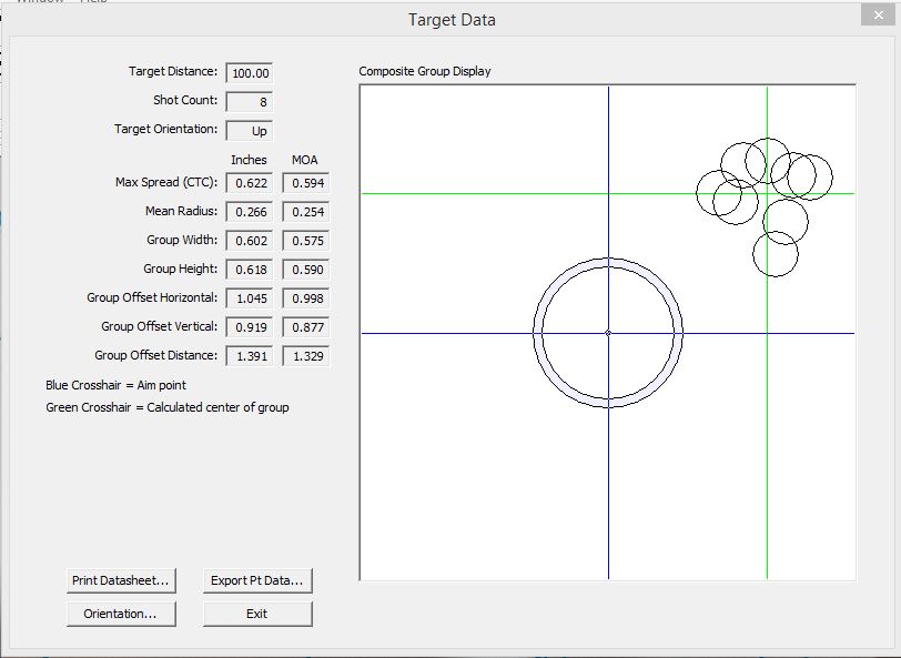

Thanks to all who responded! I suspect the 44.6 grain was pointed out because the group falls within or close to both the 44.4 and 44.8. When I take the target data and use a composite group I get approximately .903 MOA between the three. If I exclude the low shot at 44.6 ( I know that was a bad shot and all me) it drops the composite group to a .594 MOA.
As for the seating depth test; this first round of testing was at max mag length with the stock RPR mags. I know I can get mags that will accommodate longer lengths. Would you start at max length and go shorter? I do have a comparator and can measure to the lands would you start there and how much would you set the bullet back from the lands?

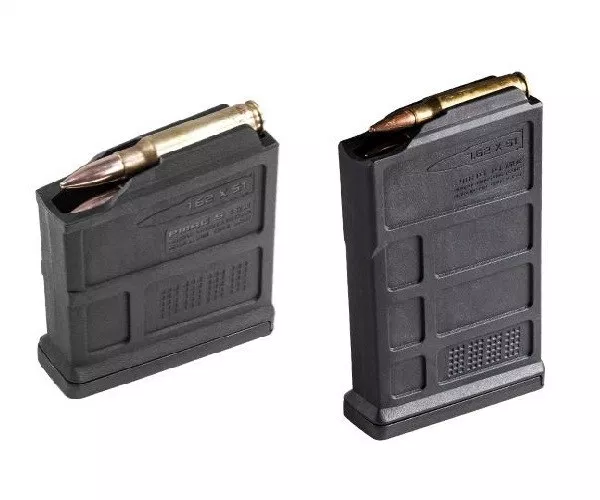

The stock RPR mags are awfully constrictive, Get the AICS style magpul mag and youll have much more real estate available to you.

The LR/SR mags allow 2.830 OAL
The AICS style mags allow 2.880 OAL

Having loaded many thousands of this combo, I can tell you that you are hitting high pressure at 44 grains, maybe not max, but your primer pockets are going to open up after about 4 firings. Your target shows it also with a major POI shift. There is very often a node between 44.0 - 44.4 grains in this range. But it can be finicky, and it will cost you in brass life.
On the lower pressure band, there is often a node at 43.5 to 43.7. This give good velocity and is easy on brass and has a more consistent POI at different temps. Looking at your test, there is a very consistent POI between 42.5 and 43.7. Only a single shot out 12 is outside of a very narrow vertical band. I would not let this one single shot influence any decision making, It is the picture as a whole we are looking at.
At this stage, group size is almost completely irrelevent. You are looking for POI variation in group centers only.

Looks like I am ordering AICS mags today. This would give me .020 off the lands at max mag length.

So it appears there are two Pressure bands or accuracy nodes whichever is the correct way to word it. From the feedback it seems that somewhere around the 44.4 - 44.6 would be a place to investigate realizing that this area has greater pressure and will most likely result in shorter case life.
43.5 to 43.7 would be a lower pressure band or accuracy node to investigate. This would result in a better case life.

Good to know. I have different mags coming that will allow a longer seating depth.

Look at the scatter node at 45 grains. All you have to do is multiply 45 x .985. The calculated high node OCW is 44.3 grains.
Based on further calculation, Your low node will be 43 grains.
Would you explain more. I will definitely investigate both nodes. I would like to understand the .985 and how you came up with the 43 low node. Trying to learn all I can.
OCW nodes, accuracy or scatter are ~3% powder charge apart. Accuracy nodes alternate with scatter nodes.
A scatter node is opposite of an accuracy node and it falls halfway between the accuracy nodes.
When you find a node, accuracy or scatter, you can predict where the next node will appear by adding or subtracting the appropriate percentage to your current charge to find your next node.
Since you found a scatter node, or often times called a scatter group, all you have to do to get into an accuracy node is add 1.5% to get into the next higher accuracy node. If you want the lower node, subtract 1.5%

Using your system 43.6 grains should be a scatter node, yet 43.5 - 43.7 is an accuracy node in a multitude of rifles.
It's not my system. It's Newberry's.
Also, look at his target. Things are going haywire between 43.3 and 43.7. A lot of things affect where the nodes will end up. Seating depth, brass, primers, etc.
What I see is a single dropped shot. From 42.5 to 43.7grains, 11 out of 12 shots are within the same 1 inch wide horizontal band. You could lay a strip of masking tape down and cover all but 1 of them.
Like I said before, having shot many thousands of this exact recipe, I can say that 44 grains is getting into high pressure. There is often a high node at 44 - 44.4 grains but it will cost you in brass life. 4 firings if you are lucky.

I agree. The calculations agree. 43 and 44.3 are the nodes. I don't know what you're disputing.
Acoording to you, 45 grains is a scatter node. 44.3 is down 1.5% and it is an accuracy node. But going down another 1.5% gets you into another common accuracy node, so the pattern doesn't play out according to what you are saying.
