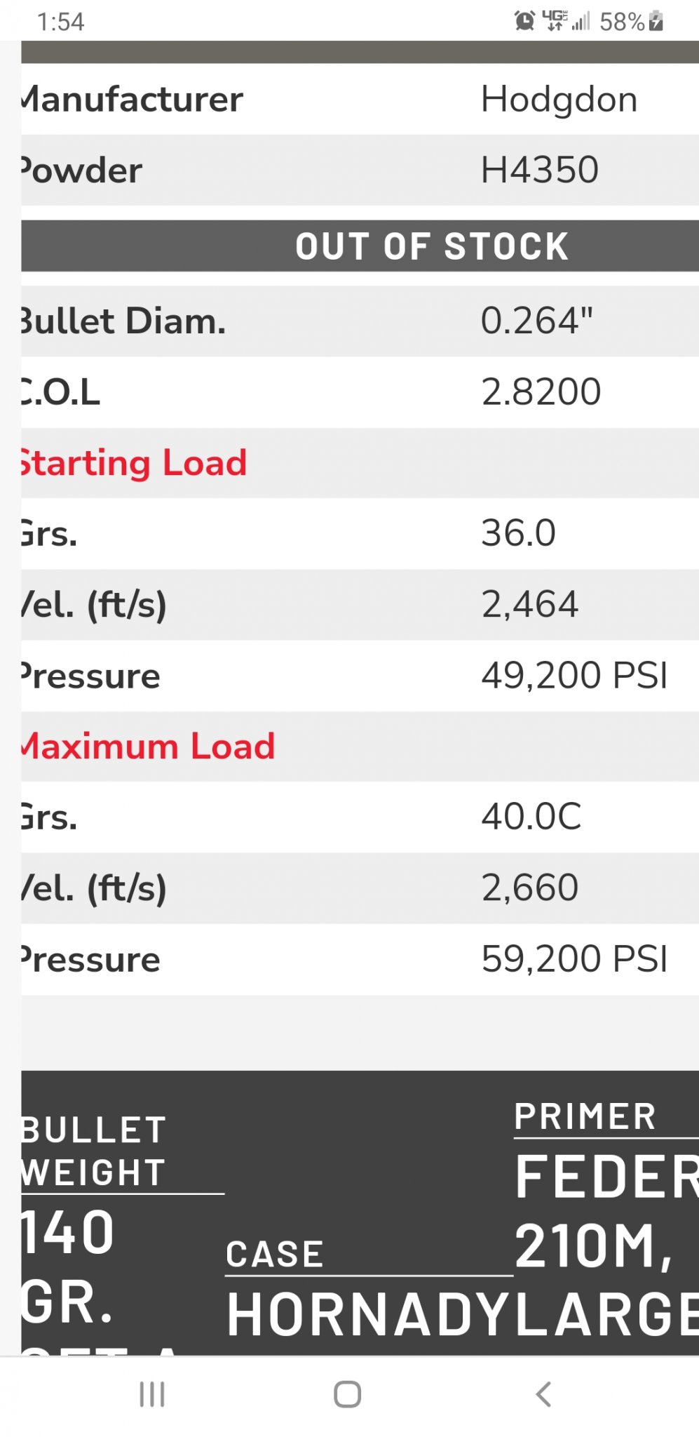

Back when I was running 6.5 Creed my normal load was too hot for using with my can. I was blowing primers out of the cases. I had to back off considerably. You'll have to do load development again most likely.
I think I was at 42.9-gr H4350 pushing 140's at 2,905-fps. I had to make a note to myself NOT to shoot the rest of that ammo with the can attached.

^ Just as others are suggesting, a suppressor adds a bit more pressure to the system. If you are running on the ragged edge before the can is added, then you may get pushed over that edge with the addition of a suppressor.
You will have to re-work a load that's safely below pressure with the suppressor. Give yourself some margin for rain, debris, etc.

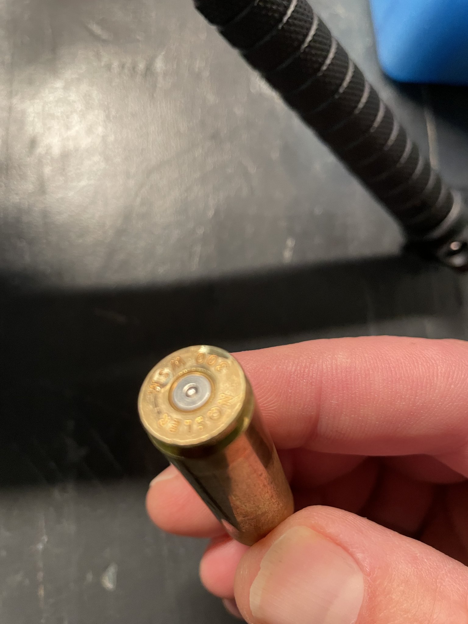

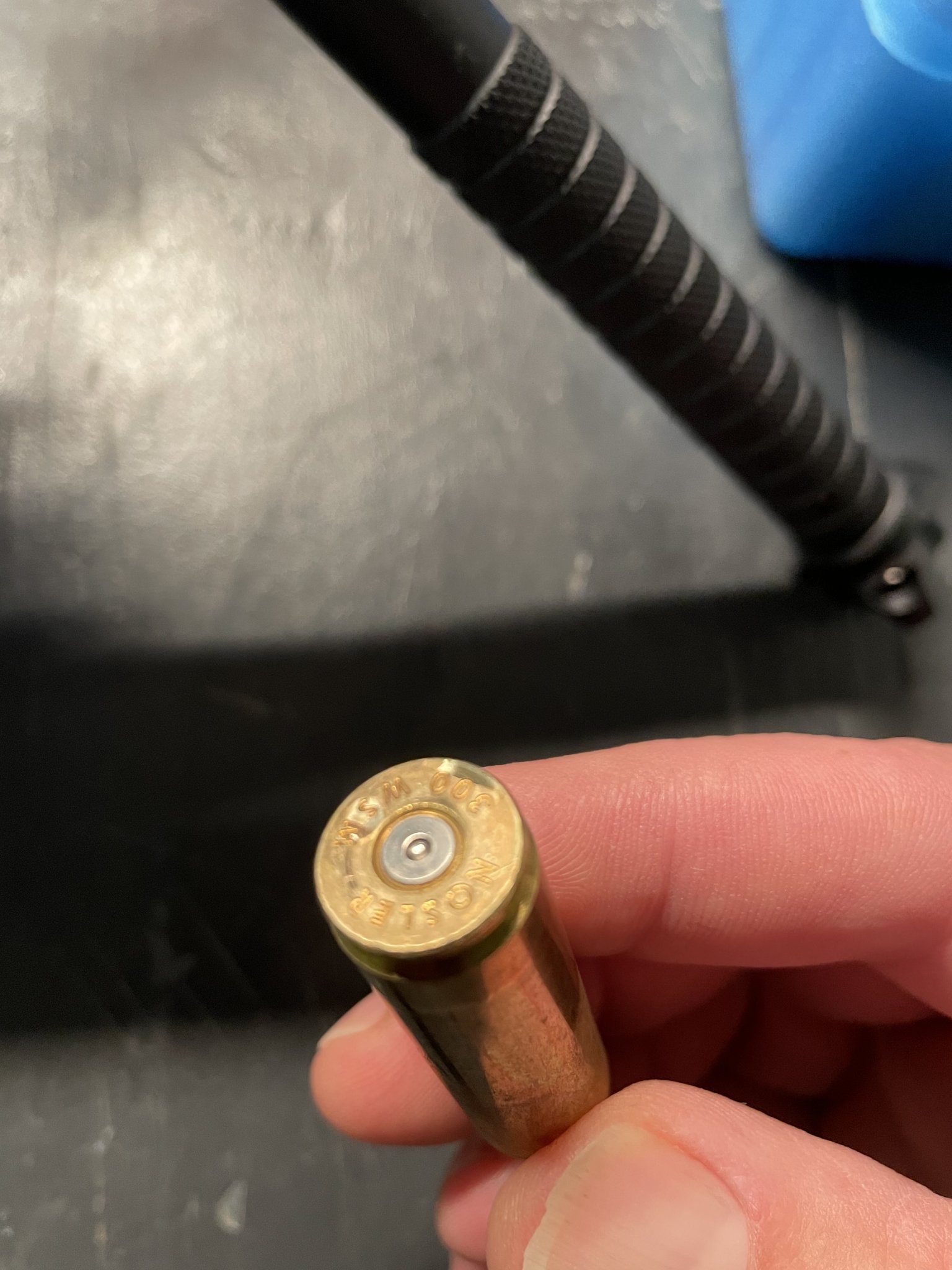

Well, had some time to test some 65 gr loads, so .5 gr below what I was shooting. Still shooting amazing, but continued to have slight sticky bolt lift. Also shot some 65.5 gr loads and many cases had no sticky lift. Weird. It happens maybe 30% of the time.
I also cleaned the chamber/throat area prior to shooting and first shot was tight lift. I don’t know. Maybe just a touch of polish with a reamer would help. Or drop the load down to 64.5 and see. Just never saw this before I started using a can. The 65 gr load didn’t have a big drop in velocity, so maybe it’s still essentially doing the same pressure wise.
My other rifle in 6.5 is fine though. No difference with that gun.
Pics of swipe marks on the tight cases. Can’t feel it with a fingernail, but it’s a slight polish on the brass.
