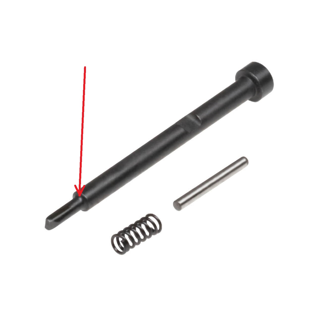

Stock up on firing pins, lots and lots of firing pins.
Reactions: cjt50
Got one when they first became available (early 2018?), been through 6 firing pins and one bolt catch. Beveling the firing pin head seems to be the fix but it'll then mushroom out with use and you get light strikes (and you'll get light strikes anyway with the stock firing pin spring and an aftermarket trigger). Shame 'cause I actually liked shooting it. I'm going to replace the upper with a build using the CMMG bolt.
They're popular in the UK and that's where all the aftermarket firing pins were being made and sold. Do you have a US source?

Wow, what’s going on with those firing pins?! A bad design or something else?
No dry fire.
I've had firing pins break in as few as 75 rds. The one that I ground the head on went about 2000 rds. but it's giving really soft hits so either I mod another one (and hope it doesn't break right away) or scrap it and do the CMMG build. (Got some new firing pins from Kriss just a few weeks ago, maybe the latest batch are better metalurgy. Really 'bout had it with the thing though.)
Was shooting CCI Standard when it was a suppressed DMRish thing, CCI Blazer now that's it's back to being a carbine.
Bad design and probably shitty materials.
Seems like they couldn't leave well enough alone and just use a CMMG-style firing pin so did one with their own dimensions.
I am breaking firing pins as well, about every 4000 rounds and I'm on my 4th. Never dry fired and only used Federal and CCI ammo in it. I was also using 15-22 mag in my DMK using the magwell adapter from ARcatch 22. Last round bolt hold open was almost 100%.

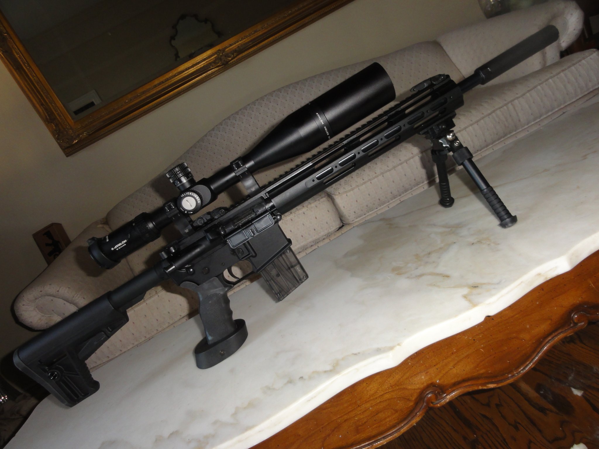

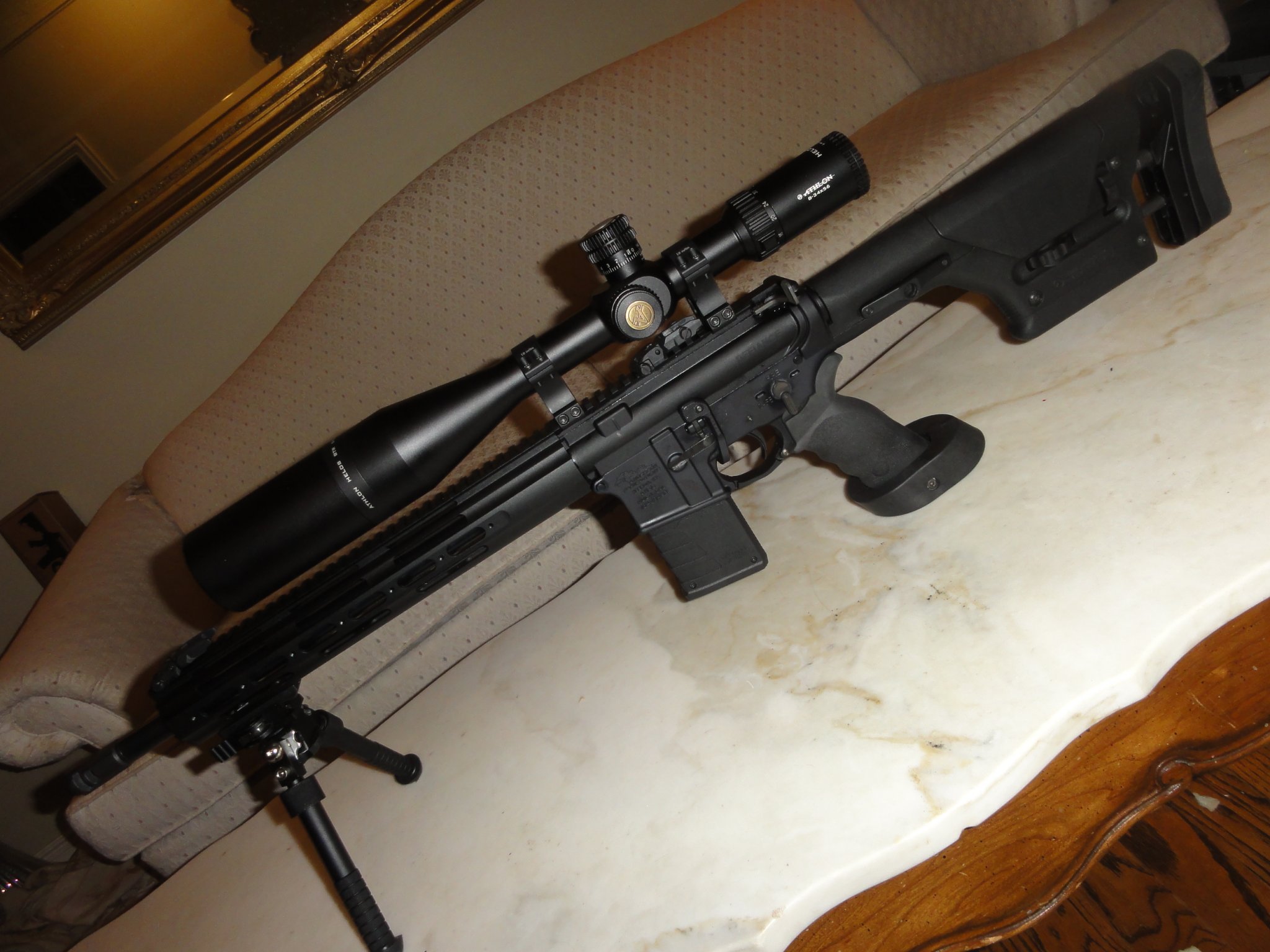

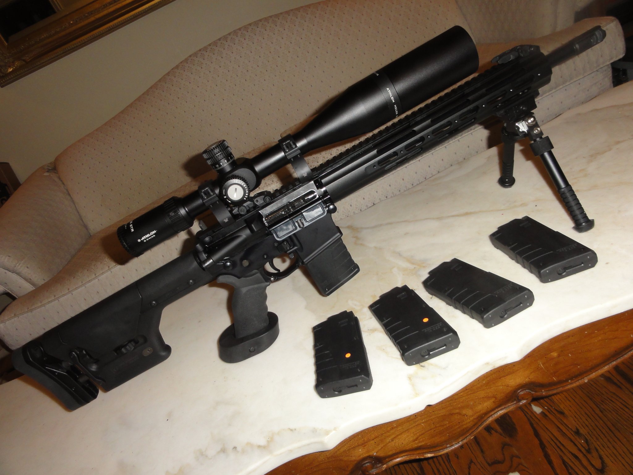

Hi Guys,
I just got my DMK and tried to shoot SK yellow and had nothing but feed issues. Just before it got got dark I tried some Federal auto match and it worked great. The SK has a velocity of 1040 fps and the auto match has a velocity of 1200 fps.
So my query is, what kind of ammo are you guys using that feeds flawlessly and gets the best accuracy?

Now that is a nice looking rig! I would love to get a DMK but have heard nothing but reliability issues and parts breaking.
I had heard that they are somewhat ammo picky even with the bentz chamber. I was going to get one to compare to my 15-22 but not based on the reviews Ive read.
Please keep us updated on yours!
I will be checking out ammo types and magazines. I just got a Black dog today to try.

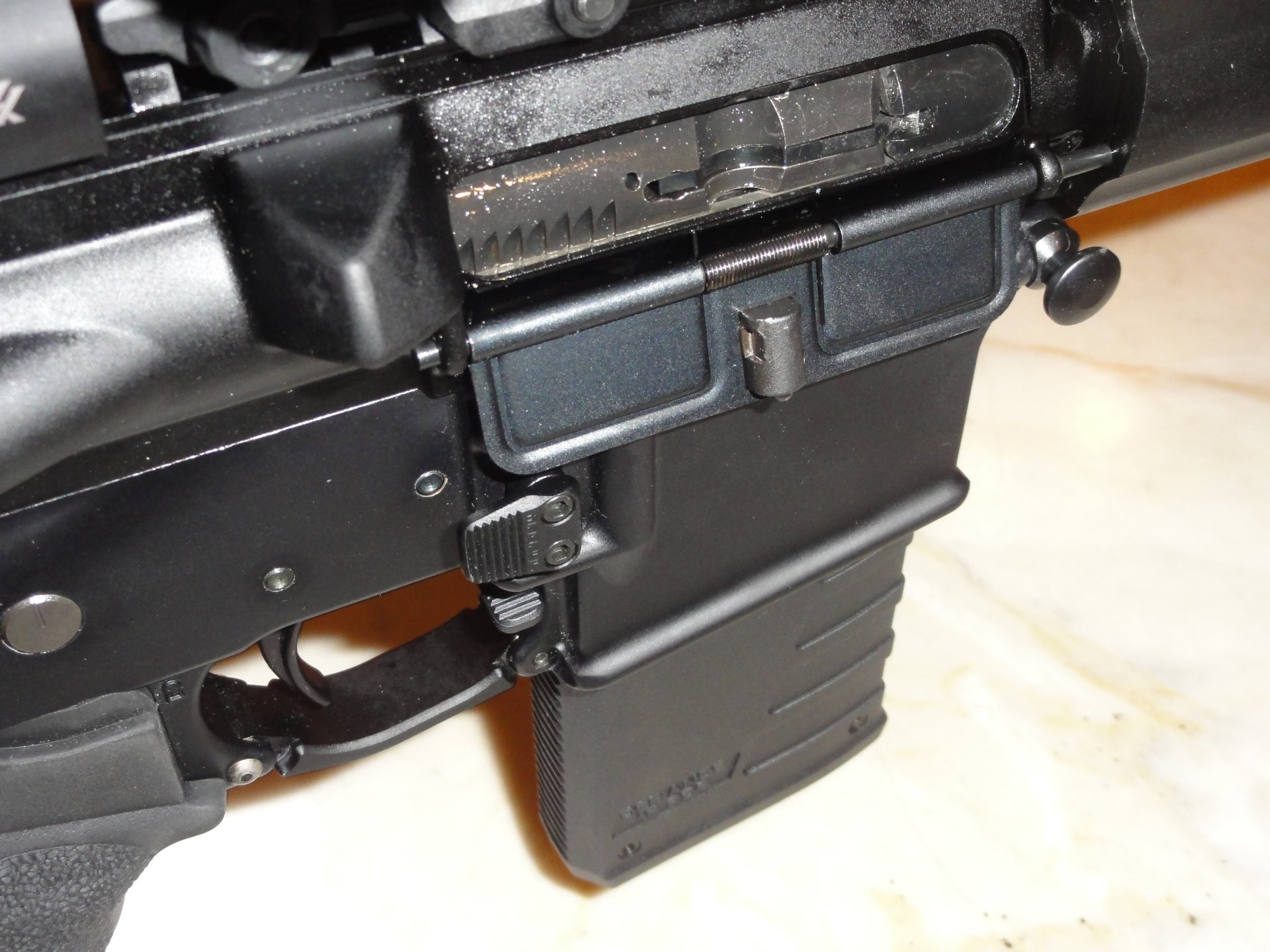

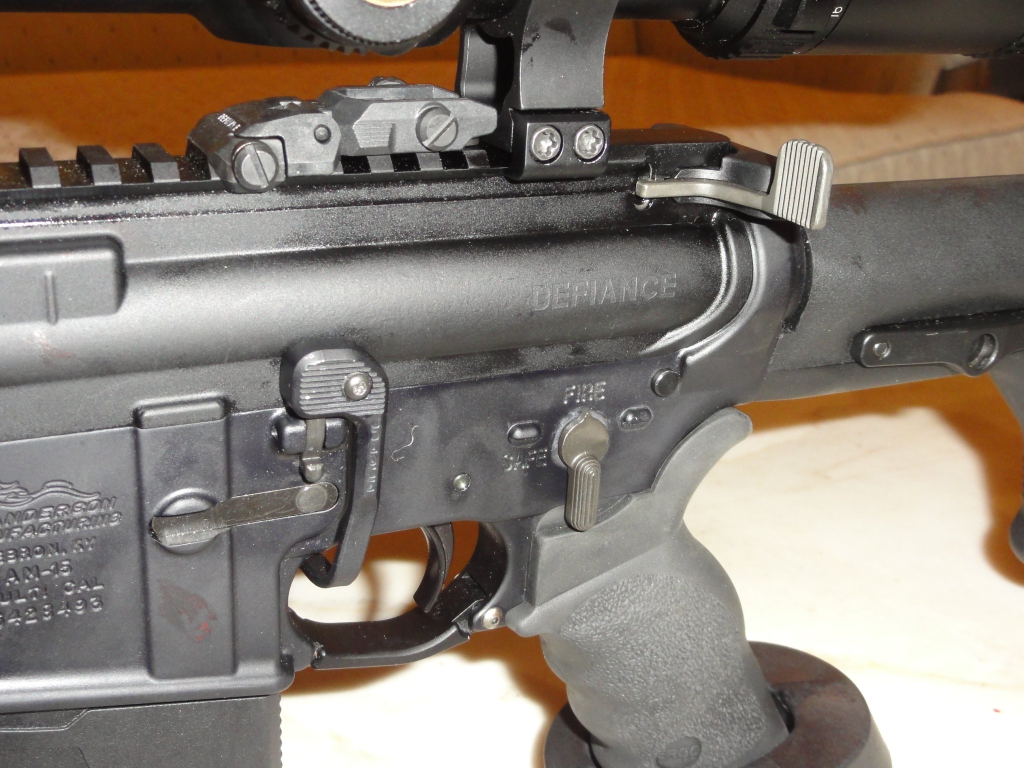

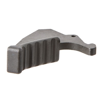

I would also recommend this charging handle latch for any AR type gun. It extends a nice amount and it has rounded
edges to relieve finger bites. It is from Brownells for about 14.00
100-015-922WB AR15/M16 Charging Handle Latch
I put my silencer and the standard butt stock back on my Kriss and I like the proportion's that the silencer gives her.
I like all of the Magpul stuff better than the factory stuff. I will be testing some different magazines starting today, Jan first. My first test will be Blackdog mags.
So far I have been surprised by the open sights. They are much nicer than the Magpul style poly sights.

Hello Glocks suck,
Did you happen to get a photo of your broken Kriss bolt catch? Do you have any idea of how or why it broke. It looks like it takes very little load.

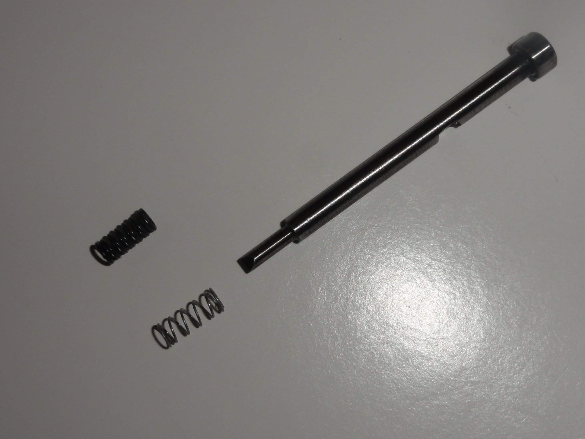

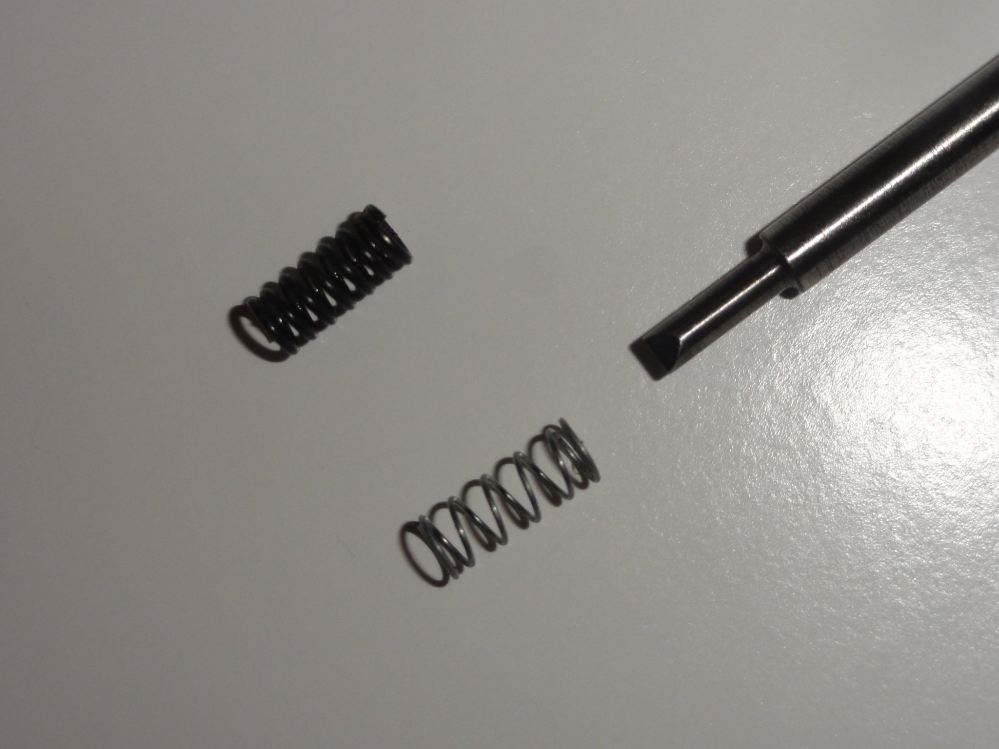

Ok.... my first attempt to resolve my Kriss issues.... Someone told me that they cleaned their Kriss like they cleaned their black powder guns, in the sink with Dawn dishwashing soap. I did that and it worked really well. I then sanded/polished my firing pin so that it moved freely in it's bore. It had more resistance than I thought it should. I also replaced the factory spring that was about 25lbs per inch and .025" wire diameter with one that is 9.6lbs. per inch and .018" wire diameter. I happen to have some .014" wire springs to try just in case.
I was shocked at the spring rate of the factory spring as it seemed really heavy.
I also used a very light coating of Moly lube followed with some EEZOX lube which is very thin. Temporarily I have removed the charging handle latch as I am trying to figure out what is keeping the bolt from closing completely all of the time. My Kriss seems silky smooth now both assembled and as sub assemblies.
I also have my Magpul lower on the Kriss upper that has a Geisselle SSP trigger rated at 2.0 lbs. The Kriss is a totally different gun with a premium trigger in her. I also removed the Kriss "bolt catch" and put it in my Magpul lower and it functions perfectly. As soon as I can cut some threads from a new buffer tube, all of these changes and magpul parts will end up in the Kriss lower.
Tomorrow I will test it all out with some Wolf match target ( 1050 fps ) which seems to work well.

Tried Wolf (1050 fps) ammo today and my Kriss doesn't care for it. It does however like Eley club ( 1085 fps ) and
SK Long range match ( 1106 fps ). It appears as though all I need to address is the bolt catch. It is sticking in the down position when I have it in my Magpul lower.
I will start doing accuracy testing as soon as the weather clears. I would like to note that I would like to stick with sub sonic ammo to keep the noise down. Any Kriss may work fine with high velocity ammunition.
Anybody with a Kriss find it's favorite ammunition? My feed issue is nearly resolved but my Kriss is not accurate with HV ammo.
I have been shooting the Kriss without a bolt latch and it works better for me being able to use the right or left side to charge the rifle.
Still working on my DMK. I have the feed issue worked out and she now eats SK ammo and the like. No more does she need HV ammo to function. I bought an adjustable JP trigger because my Geissele SSA wont work. Temporarily I have taken the safety out so that it does not interfere with the trigger. The trigger is still a heavy 3 lbs. but very short. I will get back to working with my SSA at a later date. Sadly her accuracy still sucks even at 25 yards. I would prefer to not install a KIDD bbl. but I will probably try that as a last resort. All of the Magpul stuff works and makes her more fun to shoot.
The weather is about to break and I will spend more time with her soon. She is the only semi auto that I own and she would be a lot of fun if she were accurate. Her magazines are a pleasure to load. She is easy to clean which is good because she gets filthy quickly. I bought Yankee Hill pull pins but they are not really necessary.
Has anybody had better luck than I ?? Anyone with any ideas?
I spoke with Kriss regarding the feed issue and they said it will be a 4/8 week turn around.
I got my Kriss Pic rail today and it is aluminum and is of good quality.
Wish me luck

Hi, any idea where I can find the spring?

Hi, any idea where can I find the lower rate firing pin spring?
