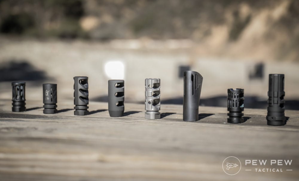

Muzzle Device – Hellfire linear flash suppressor
You probably dont need that. Muzzle device will change if you run suppressors, in the mean time..a VG6 or a precision armament M4-72 if you're looking for "flatter shooting" or recoil reduction. No muzzle devices help with noise other than suppressors.
good data in some of these on muzzle devices:
Good luck, continue to ask plenty of questions.
