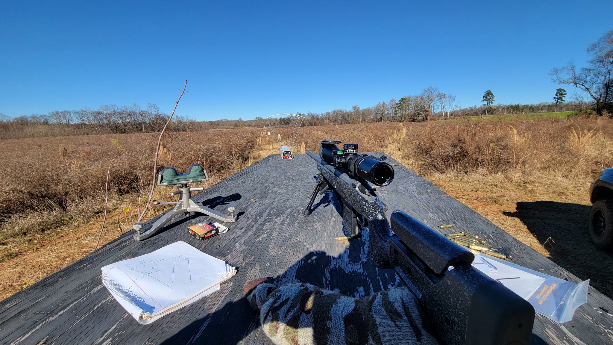

This was the first time I've Shot past 400 with this rifle. I've had this rifle 3 years but haven't spent enough time behind it and am still getting used to the ergonomics(I'm a seasoned 3-gun shooter and used to an AR). I've shot a 5 shot .44" group at 100yds with this rifle but have not been able to do it constantly. I'm pretty excited to have shot out to 780yds and I'm looking forward to going again. :)
Temps were in the 50's and crosswinds up to 12mph or so.

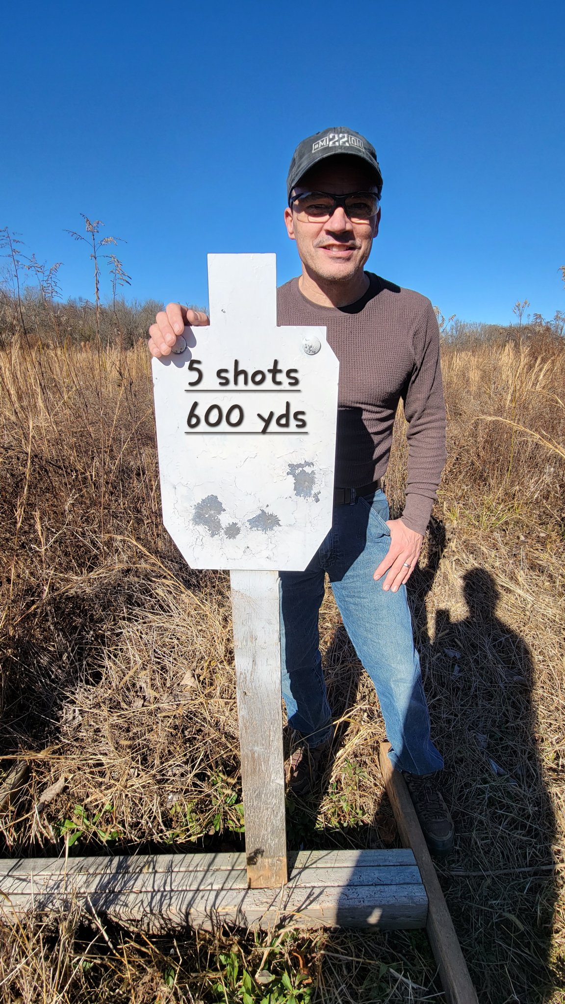

I verified velocity is around 2710fps. At 600yds I was about 1MOA low(can see evidence on the BC plate). I added an extra 1MOA to the Strelok data when engaging the 780yd plate and my elevation was pretty close. Wind was a challenge and 2 of my 5 shots went off the 780yd plate to the right.
Question:
1. To correct my Strelok data for my actual experience, I slowed the velocity down to 2660 fps in Strelok to account for the 1MOA adjustment I had to make. Is this a good practice or should I adjust another value? Maybe my Chronograph is a little fast.
Thoughts?

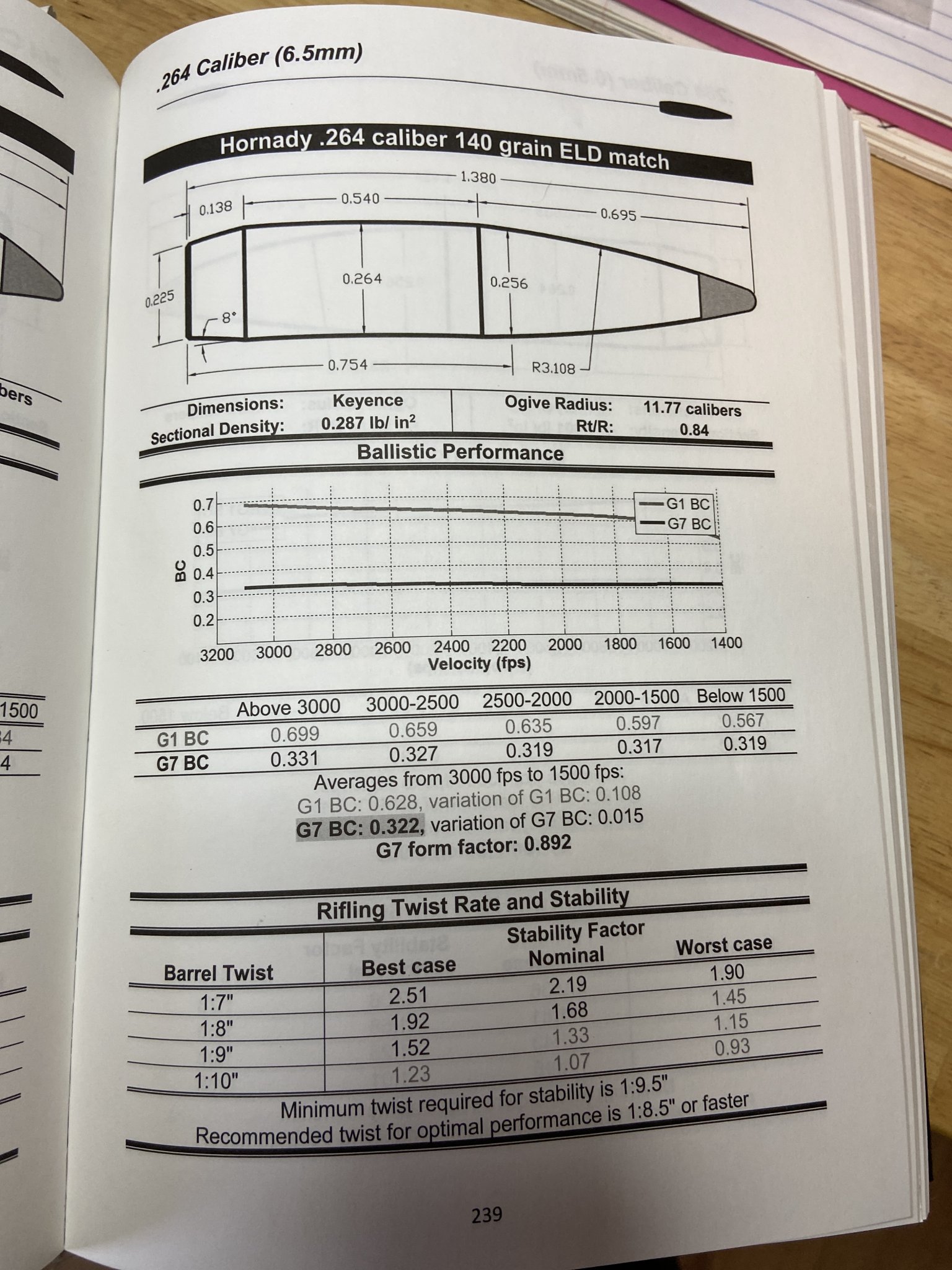

What they taught us was if I’m understanding you correctly knowing your bullet date is correct, in our case we used the average from a. 5 round group with the Chrono. The correct way is to take the shot and then dial elevation for correction and Andrea into the app to true it up so that the adjusted elevation becomes your correct number and then you do this for every distance so we went 100 200 300 600 700 800 and 850. Then we made dope charts with the finished results that said in my case I didn’t have an issue till 700 yards, beneath that the numbers were amazingly dead on , but when I went for the 800 shot I had to add almost 5 or six mills to correct it. I was using 175 grain match round, and then I save that and change the bullet to the 168 grains that I had and this is 308 I’m talking about but at any rate when I ran through the course again with the late around in this instance the numbers are all matched up except the 400 and to be dialed up to in the 600 was similar so as you know every different round needs to be tested again
Adjust velocity to 600 adjust BC after that
Reactions: rybern
Thanks for the responses. .322 is pretty darn close to the .326 stated on the ELDM box but it is interesting that the Hornady loading book shows slightly different.
