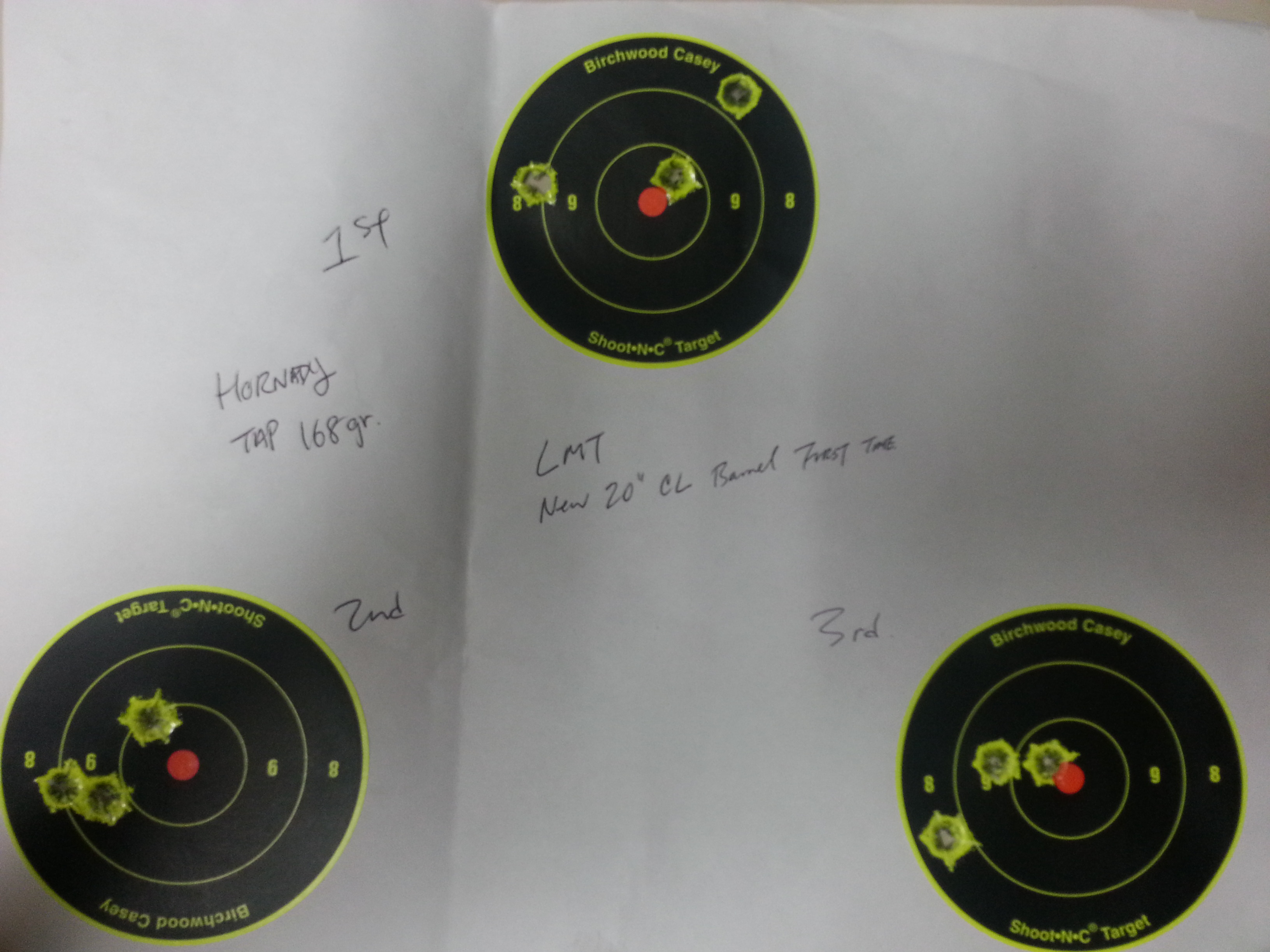

First of all, i'm still a rookie and I do still have a lot to learn.
Changed to the 20" CL barrel and went for few groups.
100 yards prone , atlas bipod, badger dog bone bag.
The groups is similar to my 16" CL
Yes, it is in 308win.
I also tried 3 rds of blackhills 168gr at the end of the day, but I shot a 4moa group!!! It was really ugly. I will try few more range time with hornady then try the blackhills again.

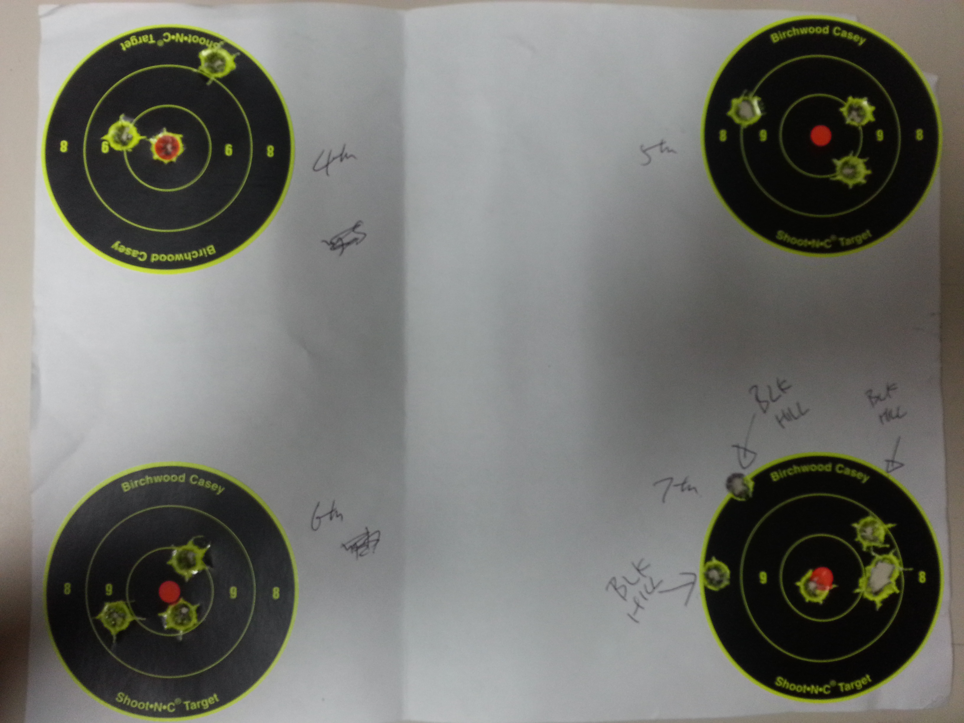

My groups rest of the days
Last groups I tried with blk hills 168 hpbt. The outer shots were black hills. The closer group is hornady tap 168

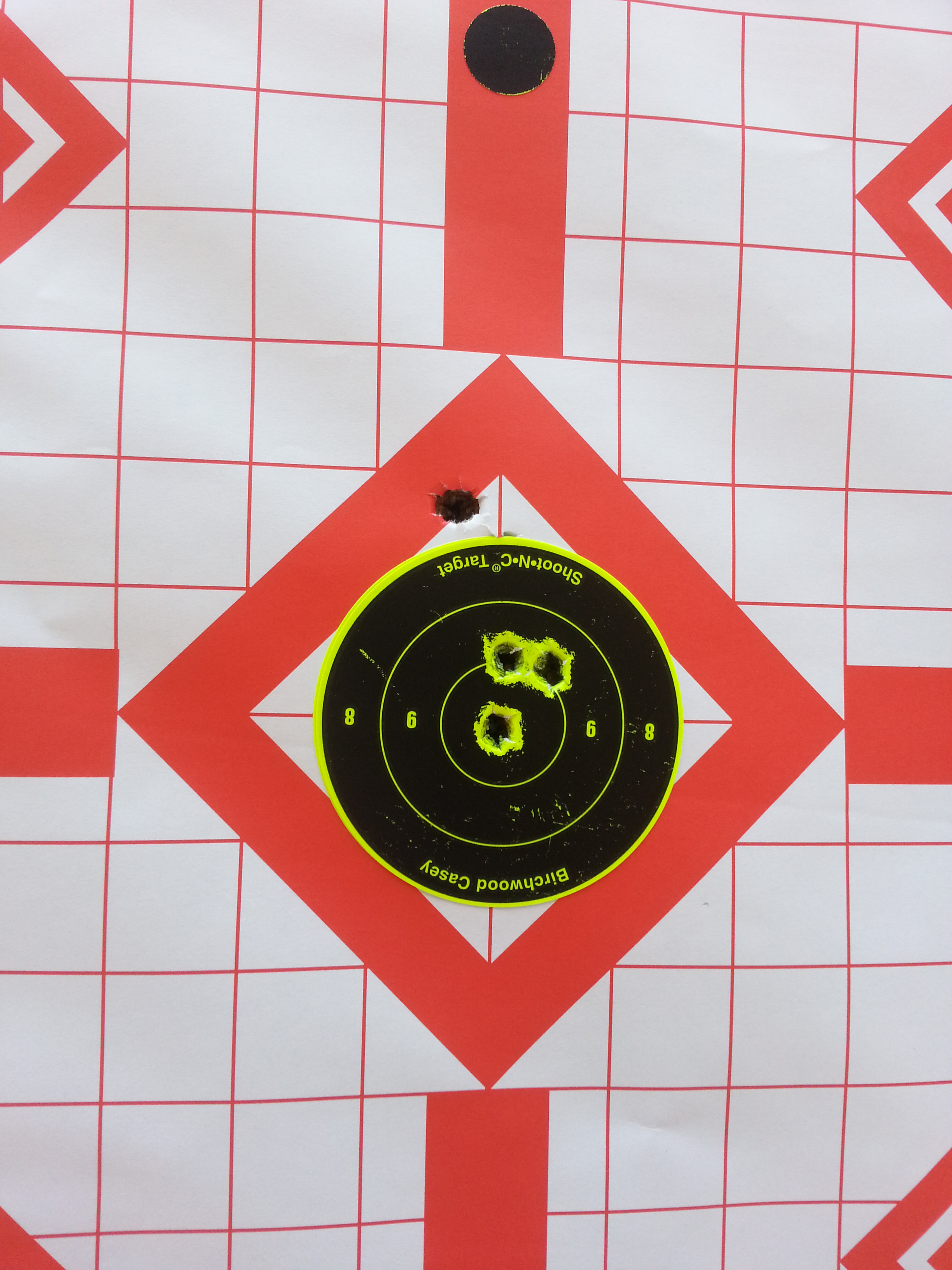

this is the group i shot with my 16CL a while ago which i had about 300rds

Thanks elfster for your tips and info
