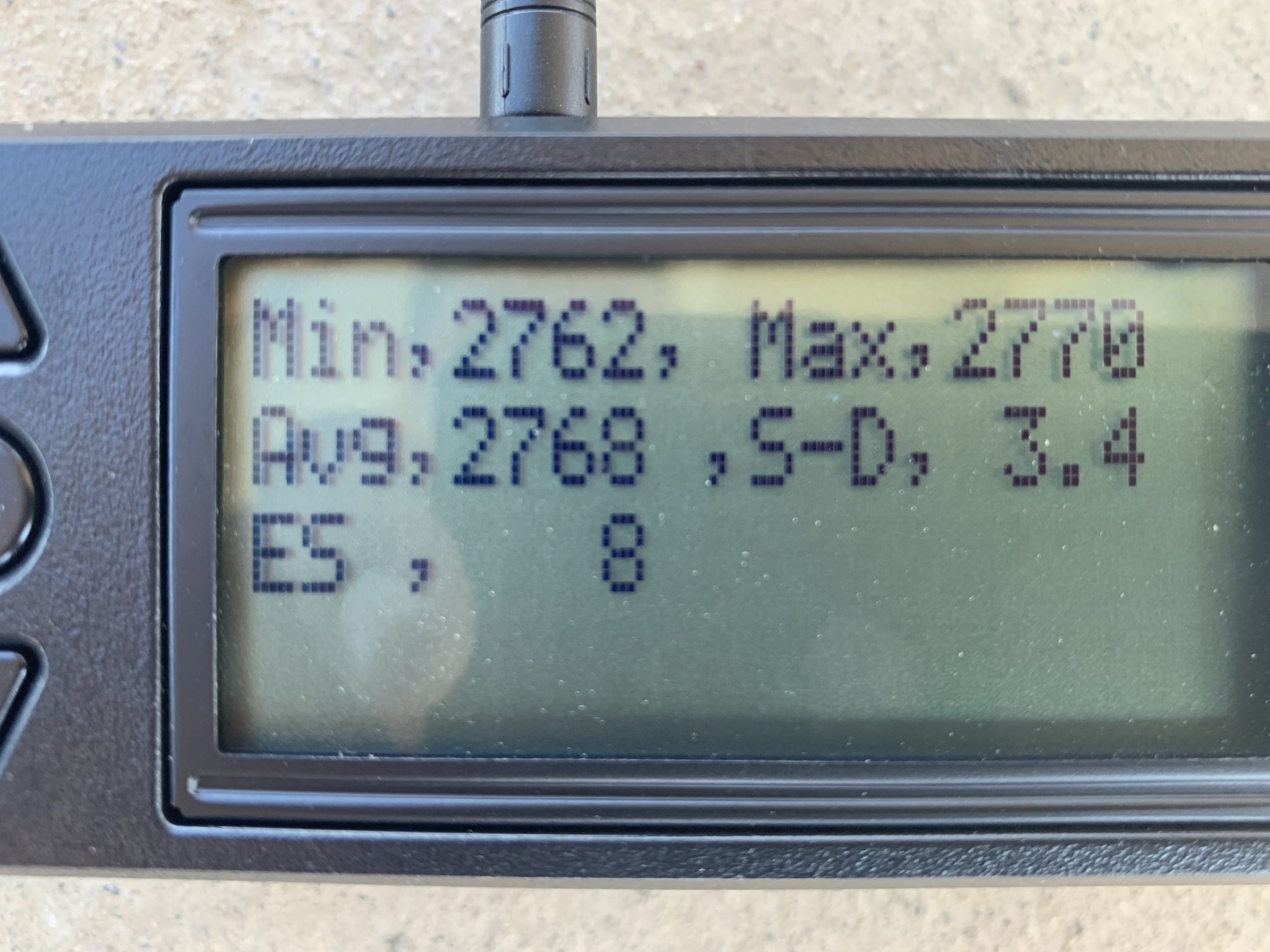

Wife got me a v3 magnetospeed for my birthday while back. Finally got it out to the range today with the 308win. This is 5 shots but was amazed at the low sd on it. Tried it on the ar and it was all over the place. Finally was getting code 4 readings that it couldn’t read the bullet. Is that because I had it to the side and not below the rifle and it was picking up blast from the muzzle break?

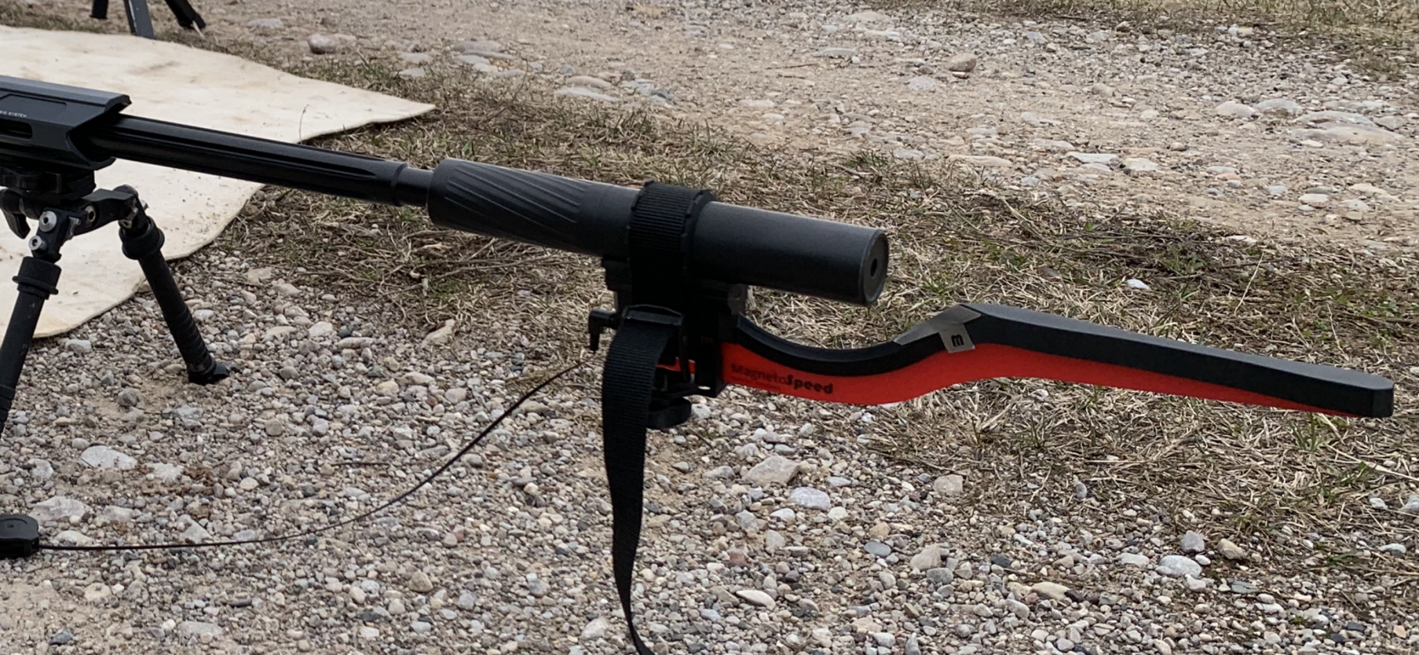

Not the best view but no issues with mine. That bar that comes with it sits on the top of the magnetospeed and the top of the bar is even with the bottom of the bore. In this case the bottom of the exit of the suppressor
