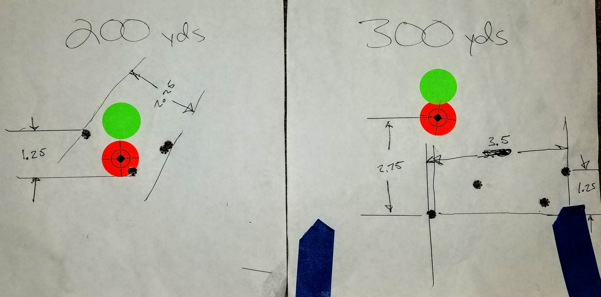

RESULTS: POA was the red dot. 6X fixed scope. I'm not unhappy with the grouping at 200 yards. Really even at 300 the vertical spread was good (just all low), and the left/right spread can be accounted for by my absolute lack of experience of checking wind during each shot. I just lined up and shot four, with the wind ranging from 0-5 from the right randomly. What surprised me was being low at 300 following the dialing advice by Strelok, since 200 worked so well. Maybe my velocity or their BC was too optimistic? Maybe I had headwind. Any suggestions would be greatly appreciated. Certainly some kind of class/training would help!

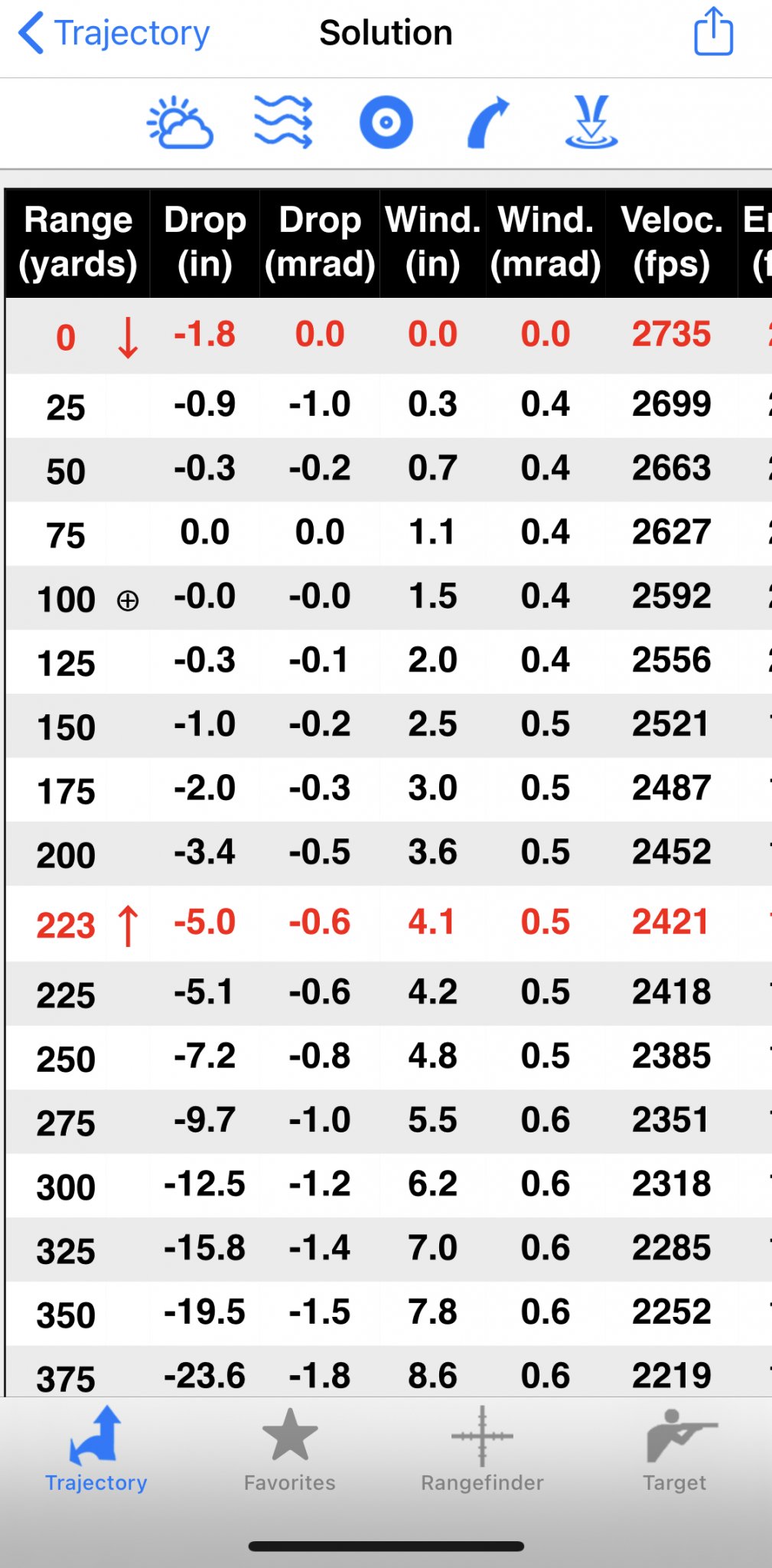

As an example, I used my Ballistic calculator to estimate what you said:
Notice that there is about 9” of drop difference between 200 and 300 yards. Did you dial 1.2 mils for 300?

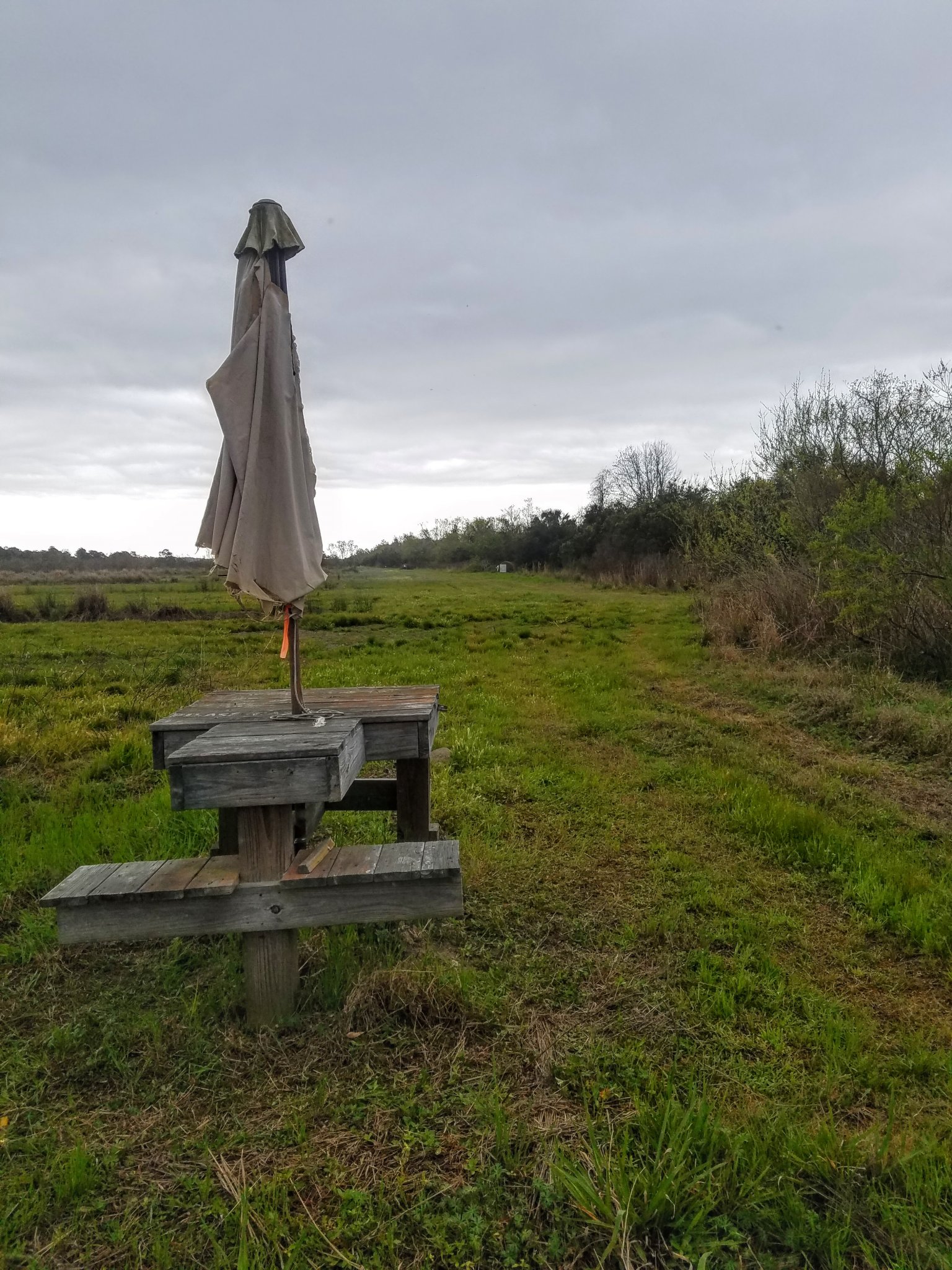

PS My little island range. I think we have about 600 yards available. Targets are along the hedge on the right. We get a bit of wind (as this is a long peninsula), but on many days it's very calm at dawn and dusk.

2730 is too fast.
and ur groups at 200 and 300 aren't round.
and it looks like ur rear ring is slammed into the elevation turret.
if u don't mind, post up a 10 shot dot drill on 1/2 moa dots at 100yards. break ur position after each shot and then rebuild it.
