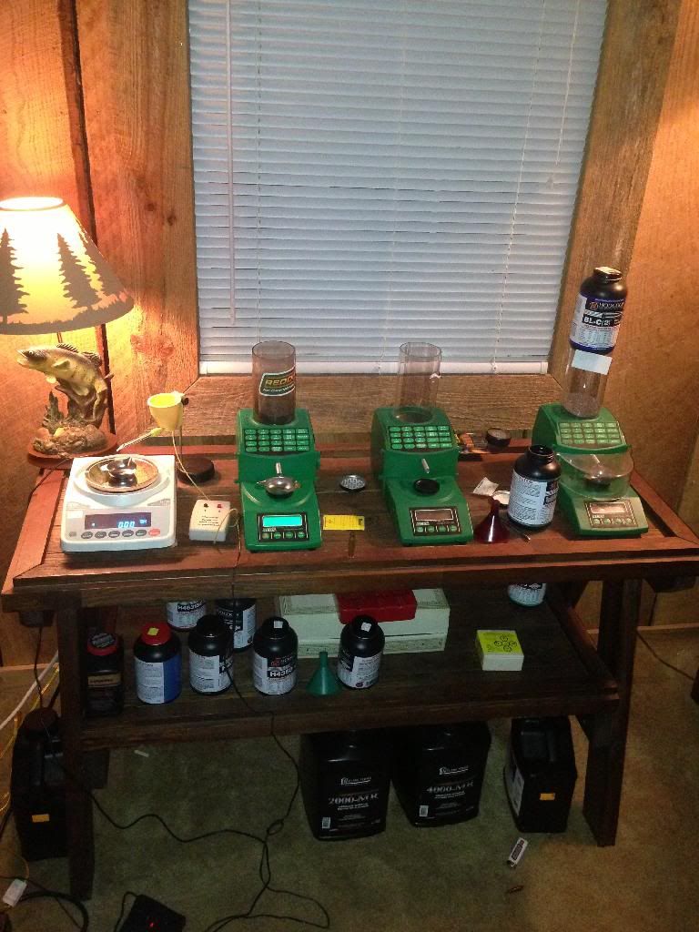

First time using Chargemaster
Yup, it is a good amenity to have on the bench. Saves a lot of labor and allows you to multitask. My friend was running 3 of them at the same time at one point, cranking out ammo like an animal.
