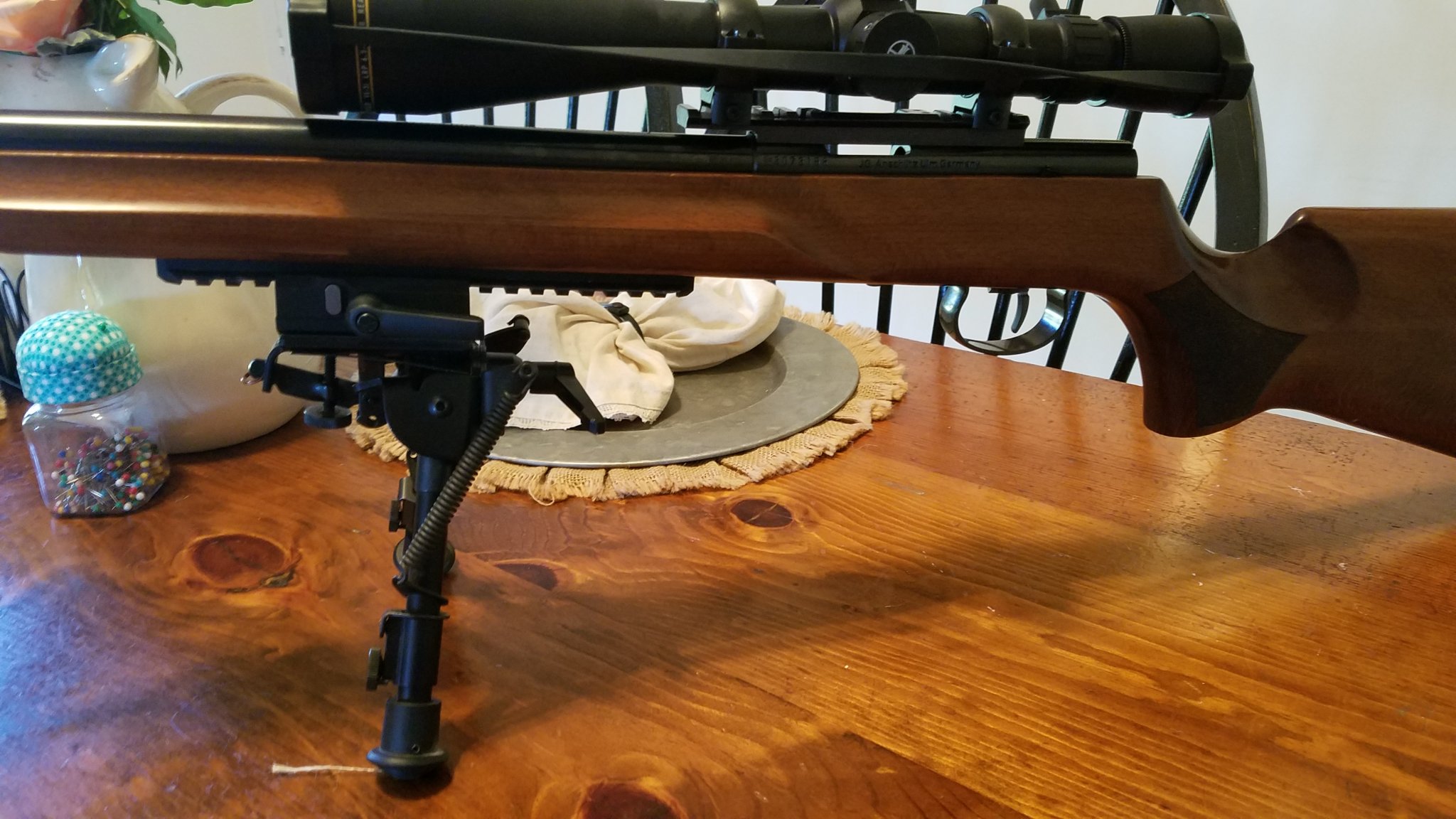

I finally found a 8in picatanny rail and mounted it to 3 uit rail adaptors now i have full length picatanny rail. I noticed if you push against a barricade the uit brackets dont want to hold well and theyll slide. So problem fixed.
