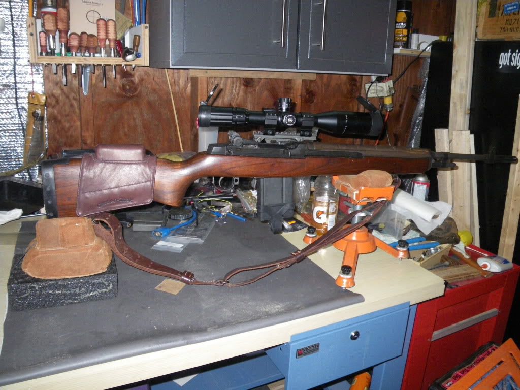

I have a 1989 vintage super match, and have been through a SA 3rd gen mount, and a few scopes getting to this point.
I went with the Sadlak Airborne mount - fit without any jiggering, but if it is needed, Sadlak will grind the mount to fit, and provides you with the pins to measure what is needed.
I used Burris XTR rings I already owned - mid-height barely cleared the rear sight.
Similar scope choice, but mine is the 3x9 FFP mil/mil version.
Added an extension to replace the buttplate - my arms are 38".
If you are out buying goodies, the Sadlak bigger mag release is nice, as is the SEI extended bolt stop - installed both when I was using this rifle in three-gun games for a while, with a Millet 1x4 DMS.
I couldn't stand to drill into the walnut of my stock, so velcro on pad by cheeknstock.
enjoy - save some $ for ammo.
