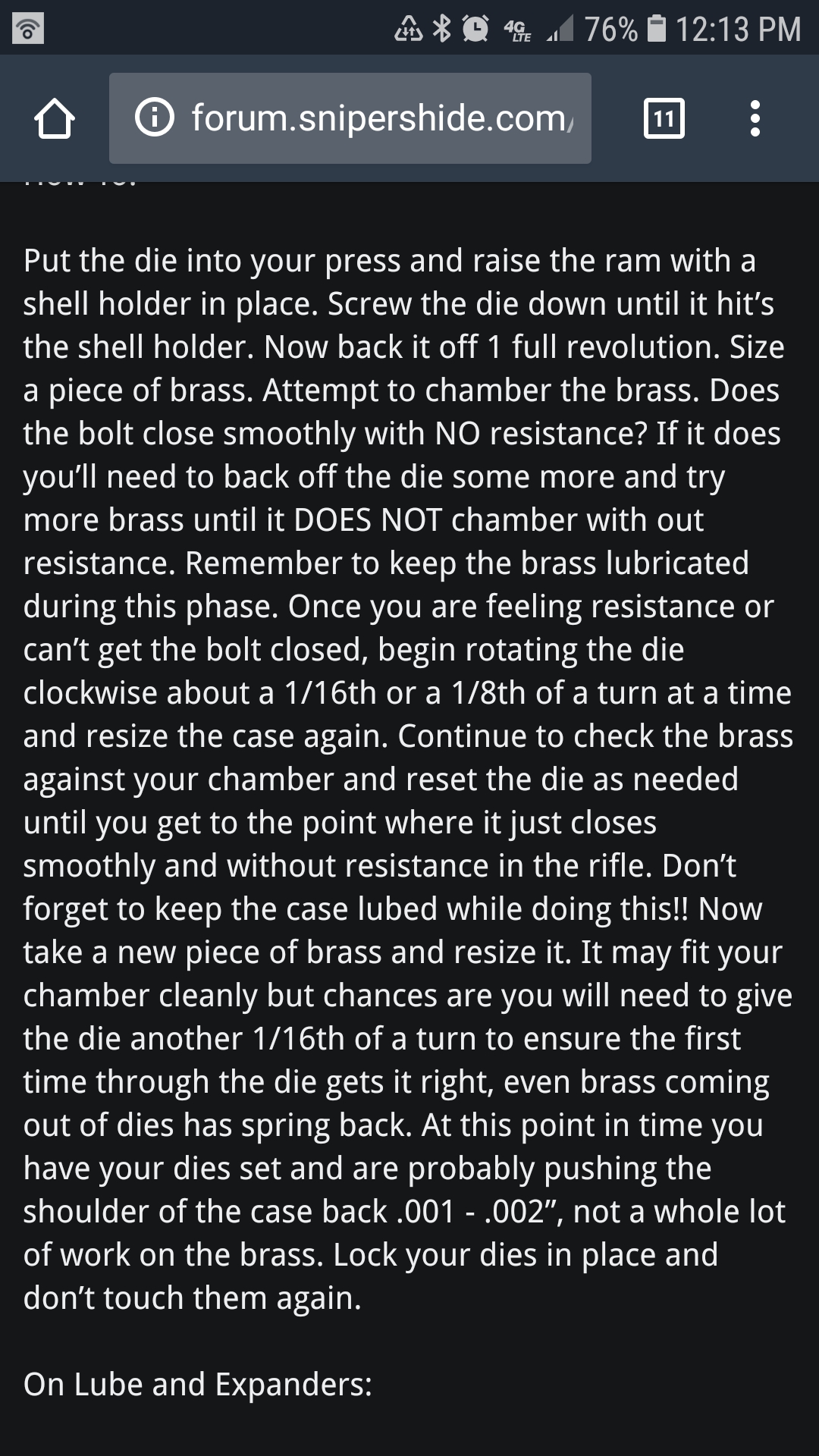

So now I'm sitting here with once fired 7mm rem mag brass and would like to shoulder bump .002".
My problem is that my brass fits fine the way it is. So, do I take the Decapping pin/expander ball out and run a case up and screw the die down till I feel it "kiss" the shoulder or am I past the point of gauging off the rifle? I like doing things without spending money on the "fancy" tools but that's more out of nissecity rather than preference but I'll do what I have to.
Thanks
